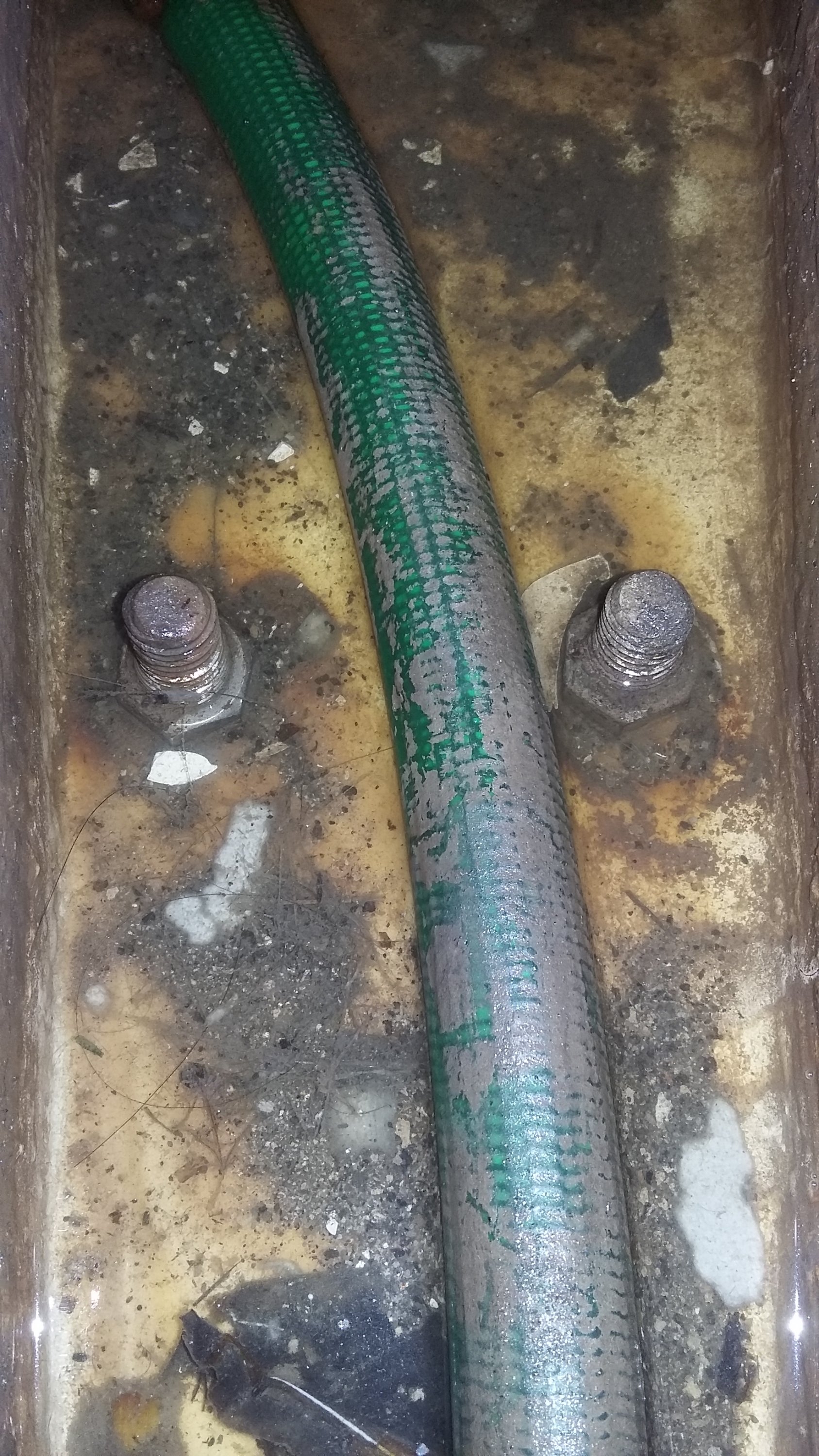

The pictures just don't look that bad. I have seen boats with much worse apparent damage that had no structural issues at all. The poster that said pictures of the inside keel bolts was right on and that would be helpful but as you have pointed out you likely don't have the experience or interest to make the call your self. The very best thing for you to do is to start getting quotes form other people. Your current yard may be the cheapest but they may also be overcomplicating the task greatly. You will find prices vary significantly for the exact same job and I suspect you will also get significantly different quotes on the required work. Personally I doubt this is a big deal, most likely tighten the bolts and reseal the keel from the outside. If there was really significant structural damage the yard should have never put the boat back in the water. More significantly they should have NEVER told you it was ok to even putt around in it. Get some quotes and compare.

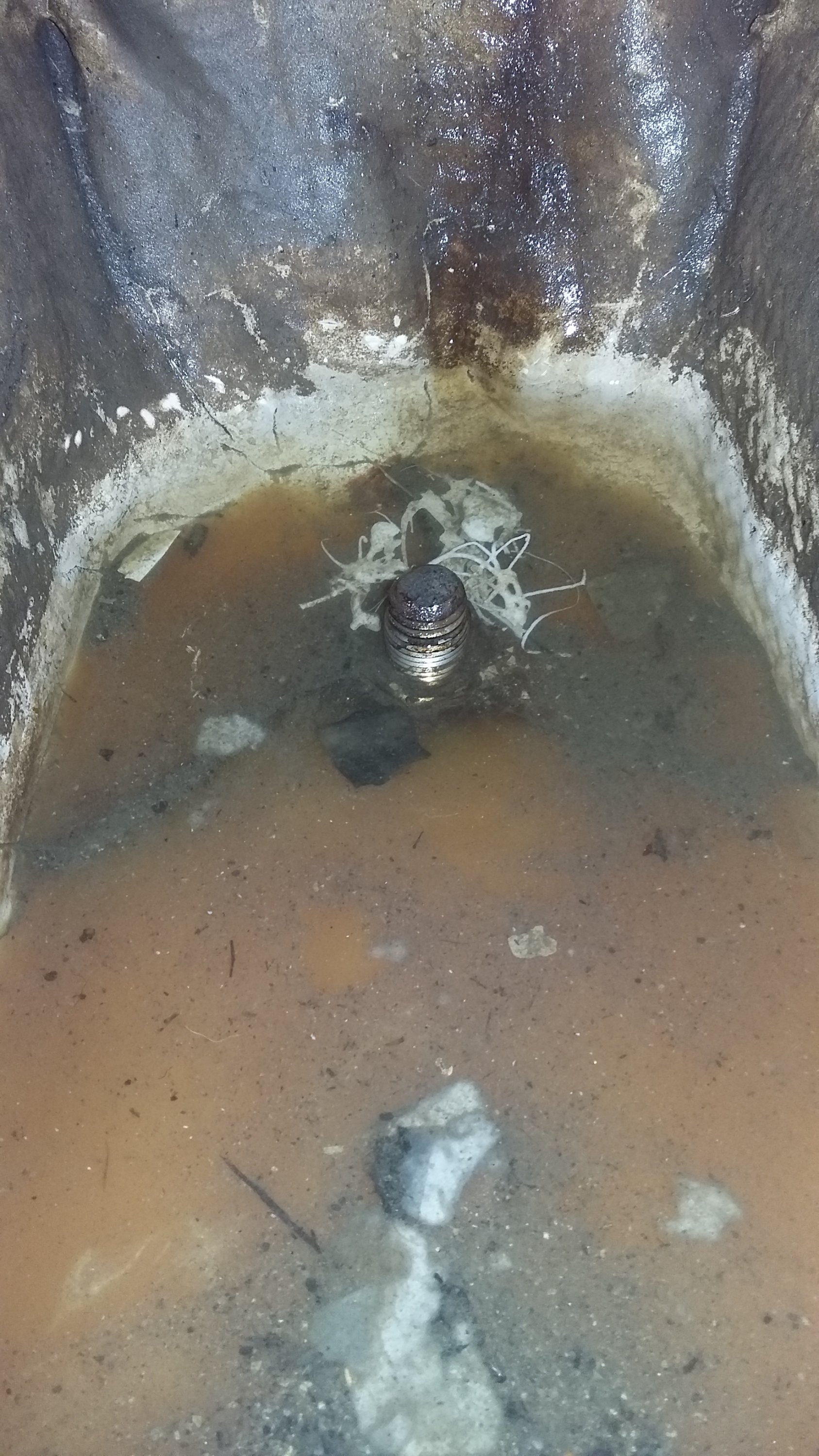

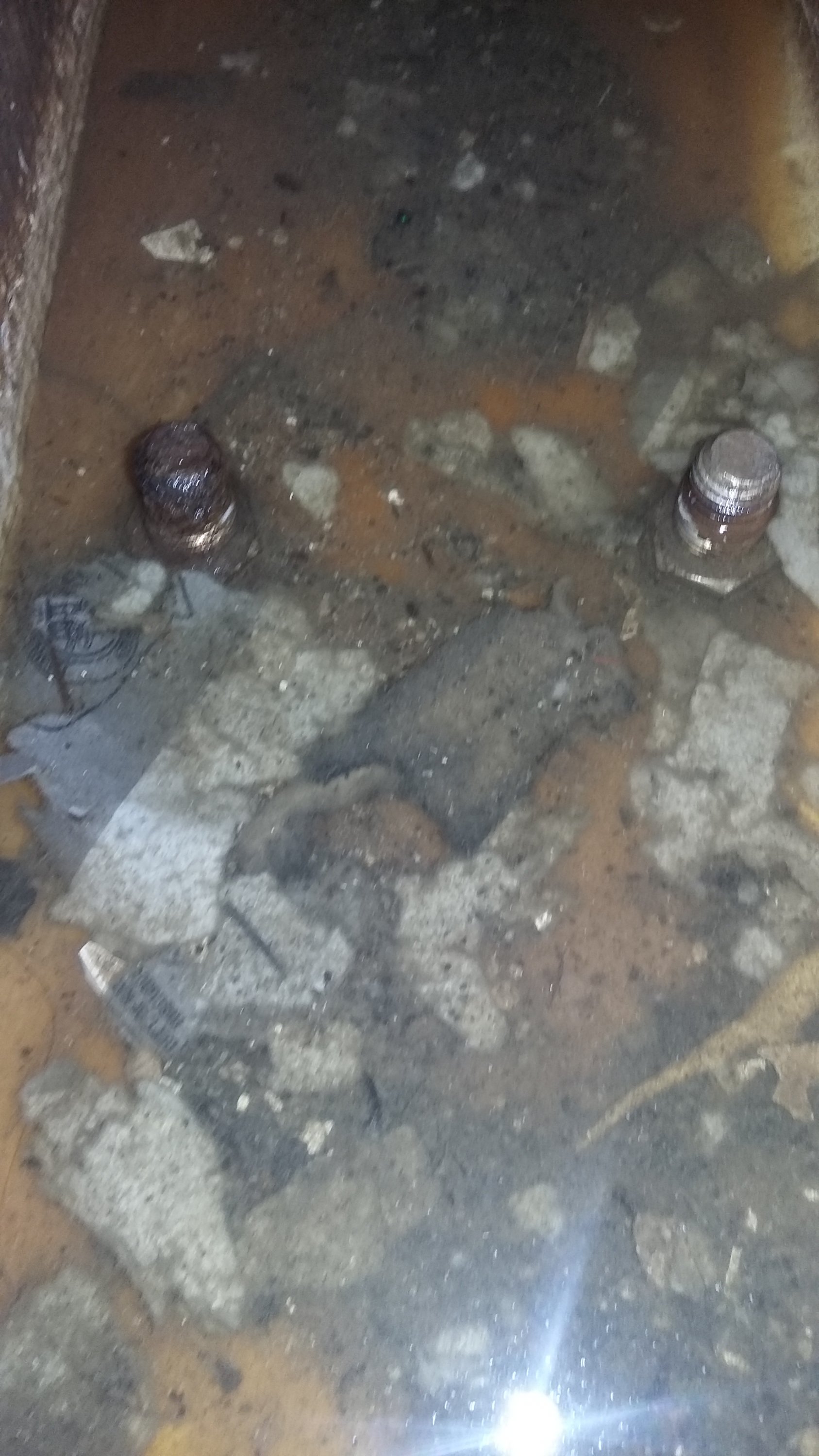

Update... the boat has been in the water several days after the initial patch. I picked it up today, hardly any water. Tried the jib first, then full sail for a bit after, and motor at full speed. No problems and no water thus far. Took pics of all 5 keel boats. They are not rusted, bent, or damaged. No apparent cracks in the glass around them, or large holes, and threads look ok. The ones in the rear and center seem to be the same height. The one in front seems to be countersunk a little burying about half of the nut. Not sure if that was existing or new, but it will need fixed. Getting additional quotes and some expert advice as possible. I appreciate most people's advice and efforts here. I will pick through what is most helpful and move forward. Thank you.

Optical illusion? My previous post was written before I saw the most recent pics. It would appear that someone has poured resin into the sump and buried the bolts - or is that standing water? The top surface should be white gelcoat, not a clear coat. If resin has been poured in, that would indicate that someone previously had a water intrusion problem and fixed it most inappropriately. All that resin, if that is what it is, should be chipped out.

I too was trying to figure out if that was resin or water. I finally concluded water. However there does not appear to be damage to the area around the top of the keel boats. If that is resin, it's not reinforced so if there was damage there, I'd expect to see cracks in that resin.

Would like to see high resolution pictures after the area is thoroughly cleaned and dried.
