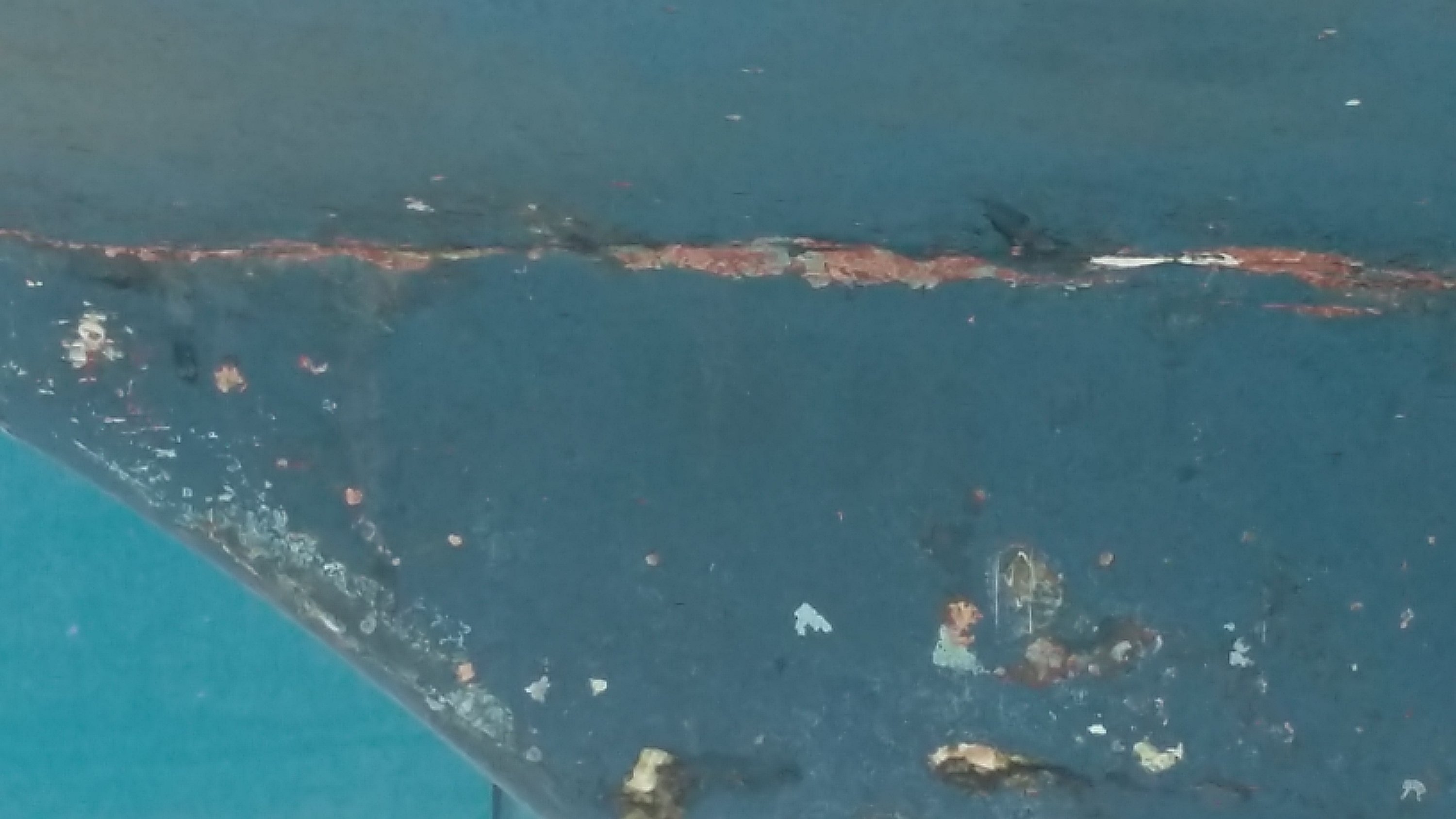

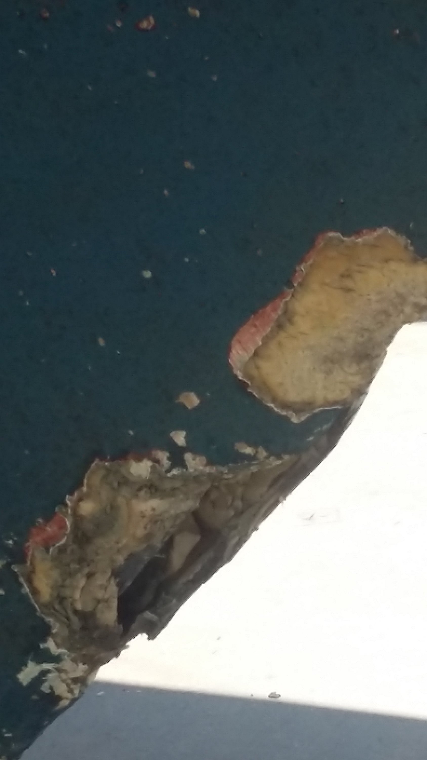

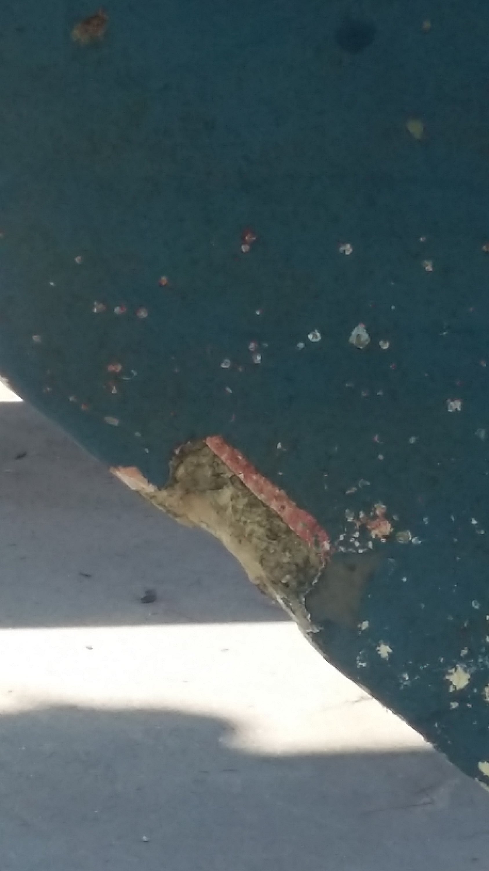

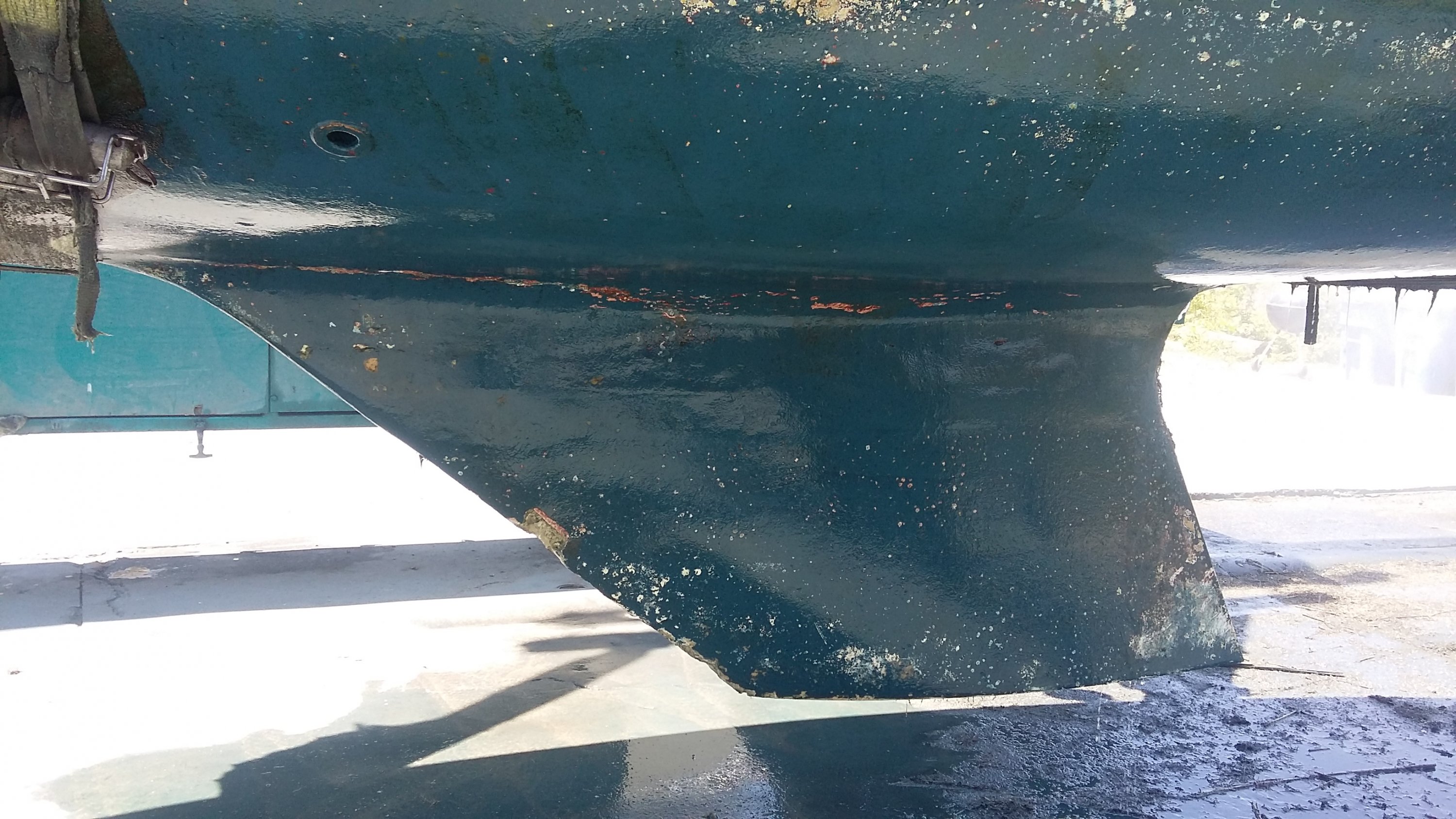

On my return, I noticed that it was taking on some water. When I got back to my marina, I had it towed to another marina for service. They took it out and found damage to the keel. It has damage at the front towards the bottom where it struck the rocks and had a spot where it was driven backward and caused a leak at the top of the back of the keel. They said that the bolts had been pushed down and to repair it they would have to essentially take it off, fix it and then reattach it to the boat. As you can imagine, they want a fortune to do it. Probably more than I paid for the boat itself. They have since repaired the leak and it's in the water, but now what do I do? Should I try to cover the cost of this repair from them and move forward or quit?

Replacing the hull is not practical. From your explanation it seems the keel bolts may have compressed the mounting base with the screw holes, perhaps breaking the beading and causing a leak. You indicate the leak was fixed, please indicate how it was done. So the keel is bent where it struck rocks, lets forget about the keel damage for now as after all, let's say, the shape of the keel is not structurally important. The important thing is that the integrity of the hull where the keel hangs is preserved, that the bolts have not been overly stretched and that their holding at the top of the keel has not been compromised. I would not think that the damage from a safety and structural standpoint should require a full costly keel repair. I would remove the bolts, one at a time, inspect it, inspect the holes, check it is strongly threading into the keel and then re-bead with a sealer and tighten to torque specs (don't know them and will let you look for them). If compression has damaged the base a little then SS washers can be used as spacer to fill the gap. I would think that retightening and re-beading the keel bolts should keep your boat seaworthy. A nick at the front of the keel may cause a tiny bit of drag and perhaps deflection but should be insignificant for a pleasure boat. Eventually the keel to hull joint underwater should be examined to see where the sealer may have been broken and re-beaded. It is easy to drift off channel in a windy day, not only do you have to keep your eye on the marker ahead but also need to look back to insure you keep inside with the marker behind you. The thing is when navigation in tight channels it is wise to maintain a slow speed. I have grounded many times but luckily with no damage and I attribute my luck to a slow speed when in proximity of the bottom.
PS. Be weary about expert opinions coming from a shop that has an interest in performing a large repair. If in doubt get a 2nd opinion from your own expert. The keel to hull joint is crucial to safety, cannot understand how a marina could do a temporary repair and let you go on your way if there was a structural damage that could have impaired that safety. In any instance after any repair inspect the keel bolts frequently for tightness.

Benny's advice is well presented. The one thing that should also be investigated is how the keel is mounted to the hull, which I presented in my link. "The Catalina Smile" is an infamous issue across the entire line of boats produced by Catalina. It has been discussed on this and other forums since they invented the internet. That's why I suggested you go to the C25 Forum. They can tell you all about how the keel connects to the hull and what is in between them based on the year of your boat. THEY are the experts in YOUR boat. Please, go there.

The marina patched the small crack at the back with fiberglass and put the boat back in the water. Everything that you have said makes sense and I am really hoping that you are correct. That would be awesome. They had the boat in the sling and shook the keel and it moved a little. Then called in their plastics guy and said the repairs would be necessary. I have attached the pics that I took while it was out of the water. They stated that I could putter around in the boat, but to stay out of stronger winds until they could schedule the repair. I would like to try your options before committing to anything further. Is it possible to do it in the water or do I need to pay to have it taken out again? There is no trailer. Here are a couple of pics. Thank you for your help.
