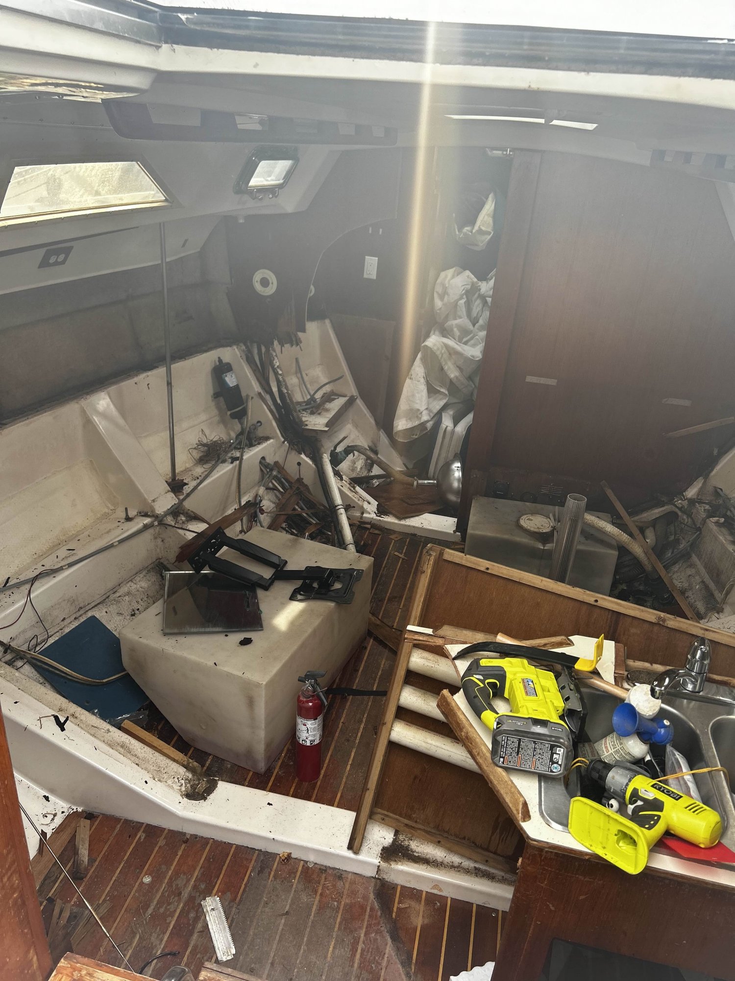

I have attached an image of the cabin as it sits currently.

Thank you!
This is my first keel boat, I have had a good few dinghy's (420, laser 2, etc). I have spent a pretty good amount of time on keelboats though which should hopefully help me with my refit journey.
Unfortunately, the mast is up which I am well aware will make my life a whole lot more difficult. I have carefully inspected the compression post and the surrounding fiberglass on the headliner for hairline cracks and deformation and haven't found anything.
My current plan is to bevel and fiberglass patch pieces to the bulkheads and add half inch marine ply to each side for additional support.
I was surprised how thin and weak the bulkheads are when I cut the mold out.

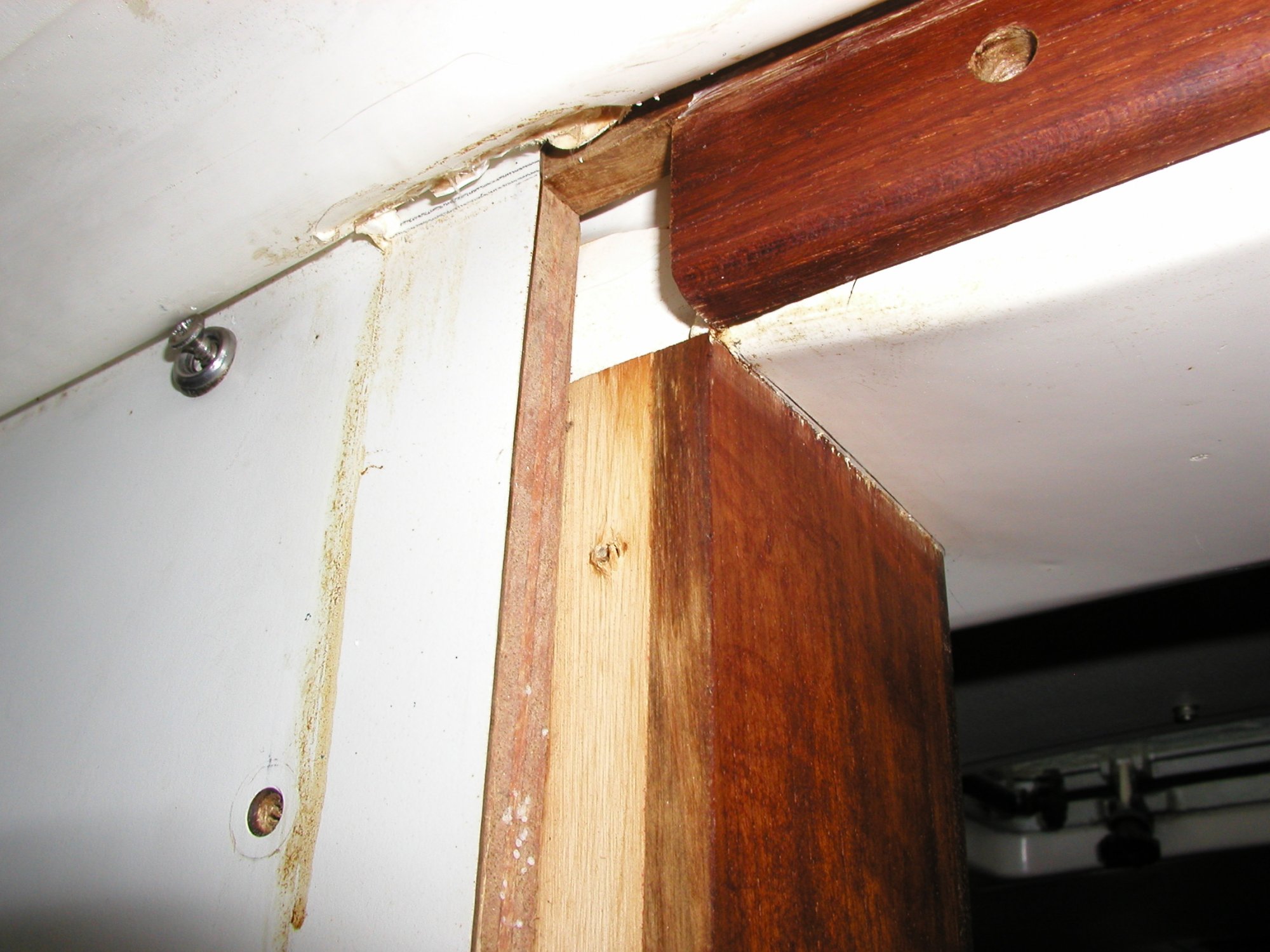

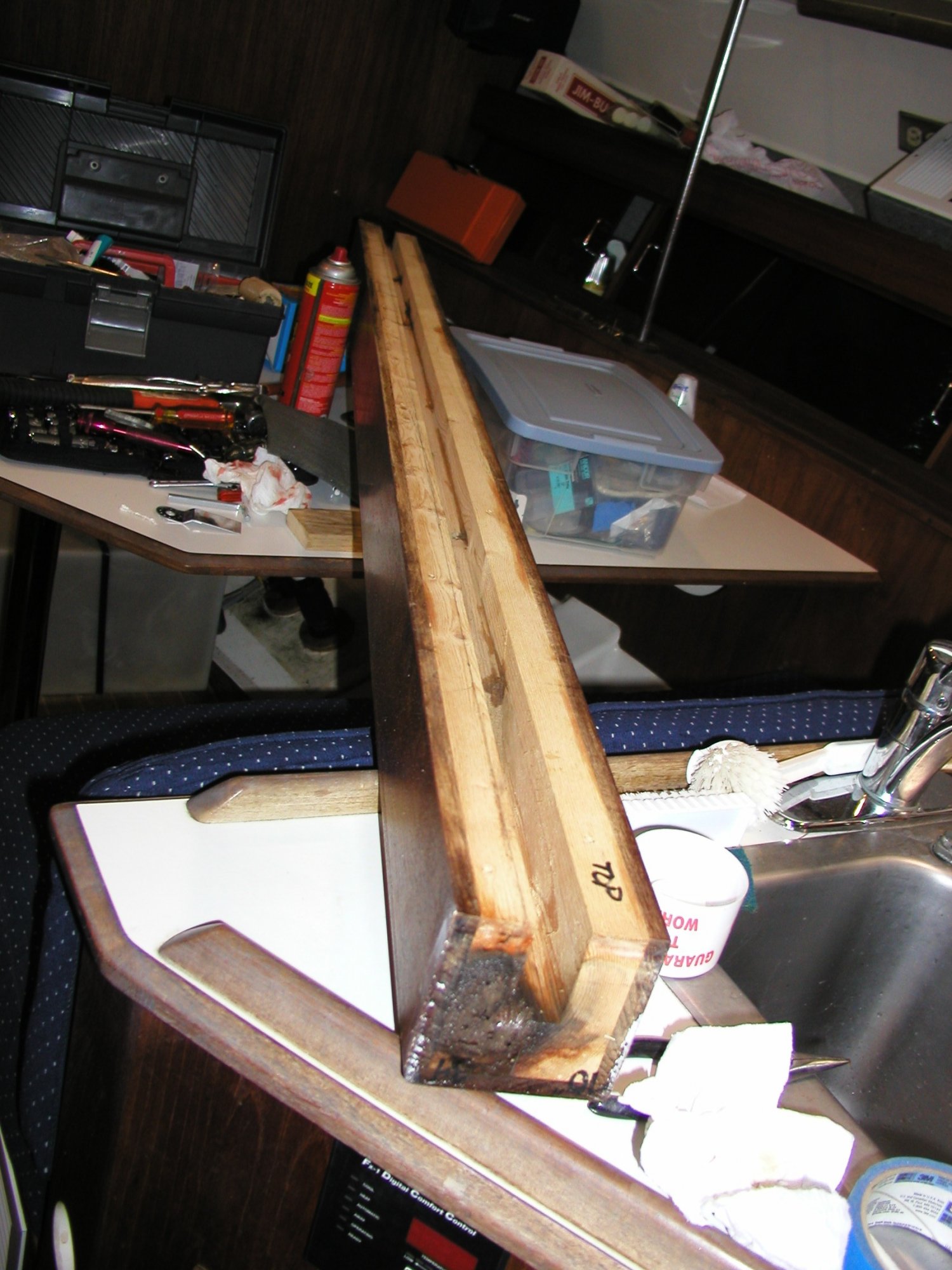

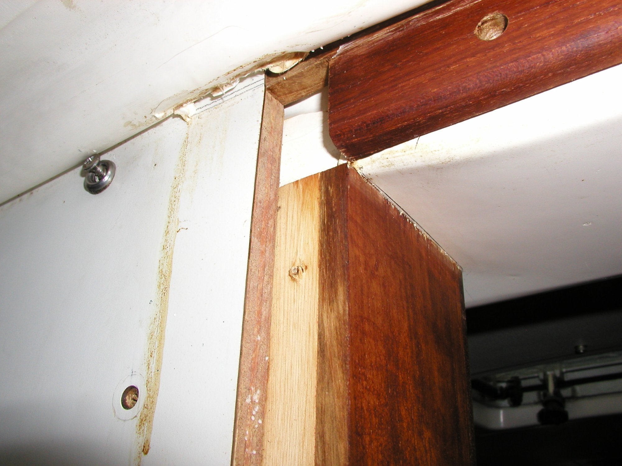

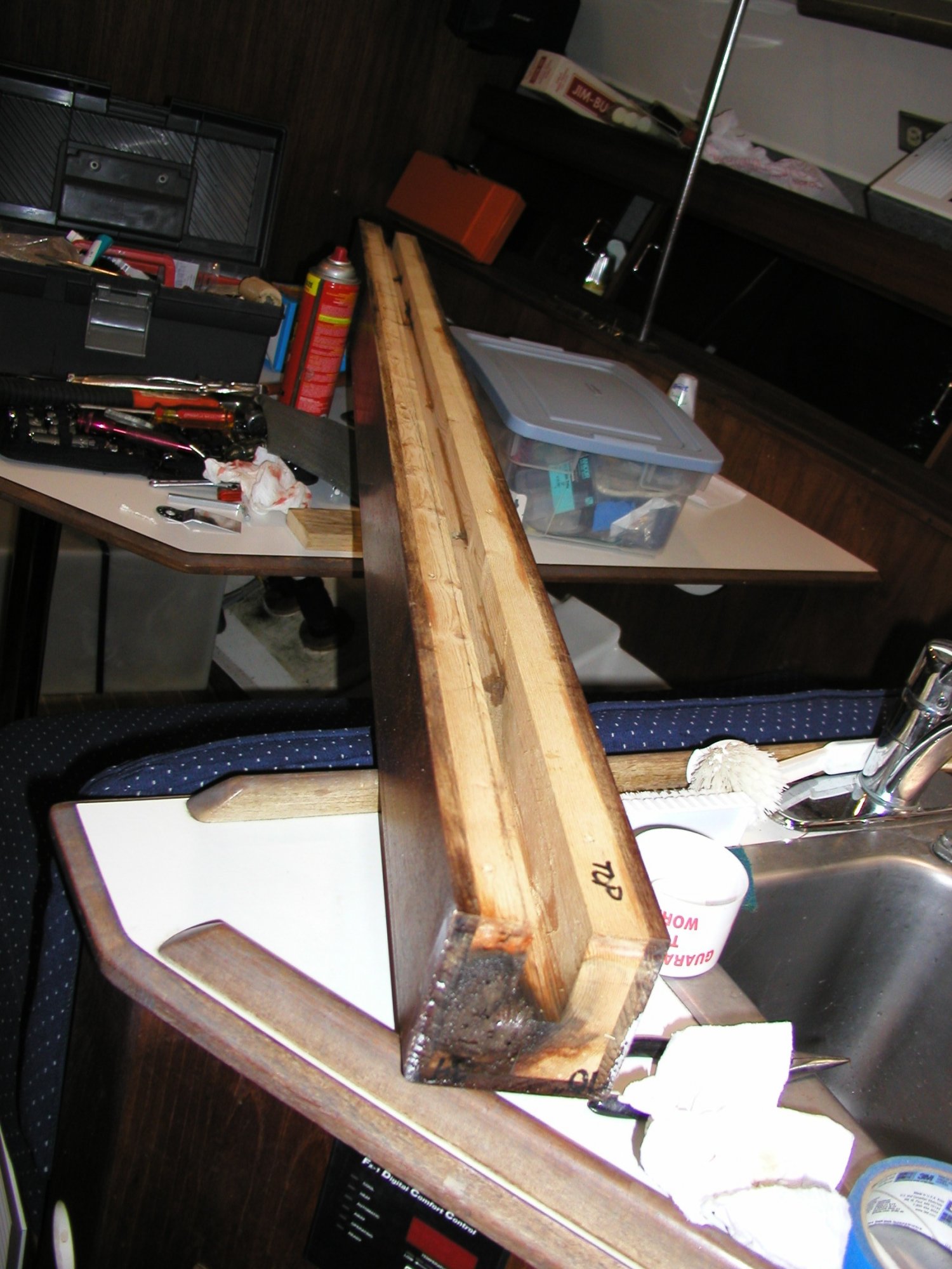

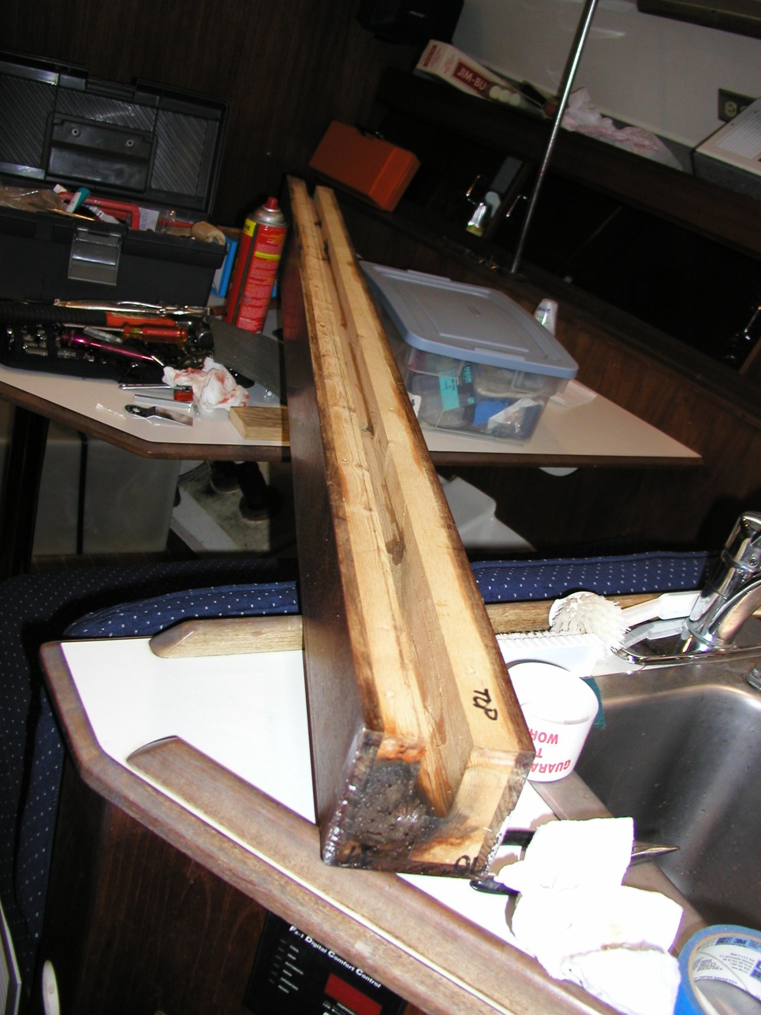

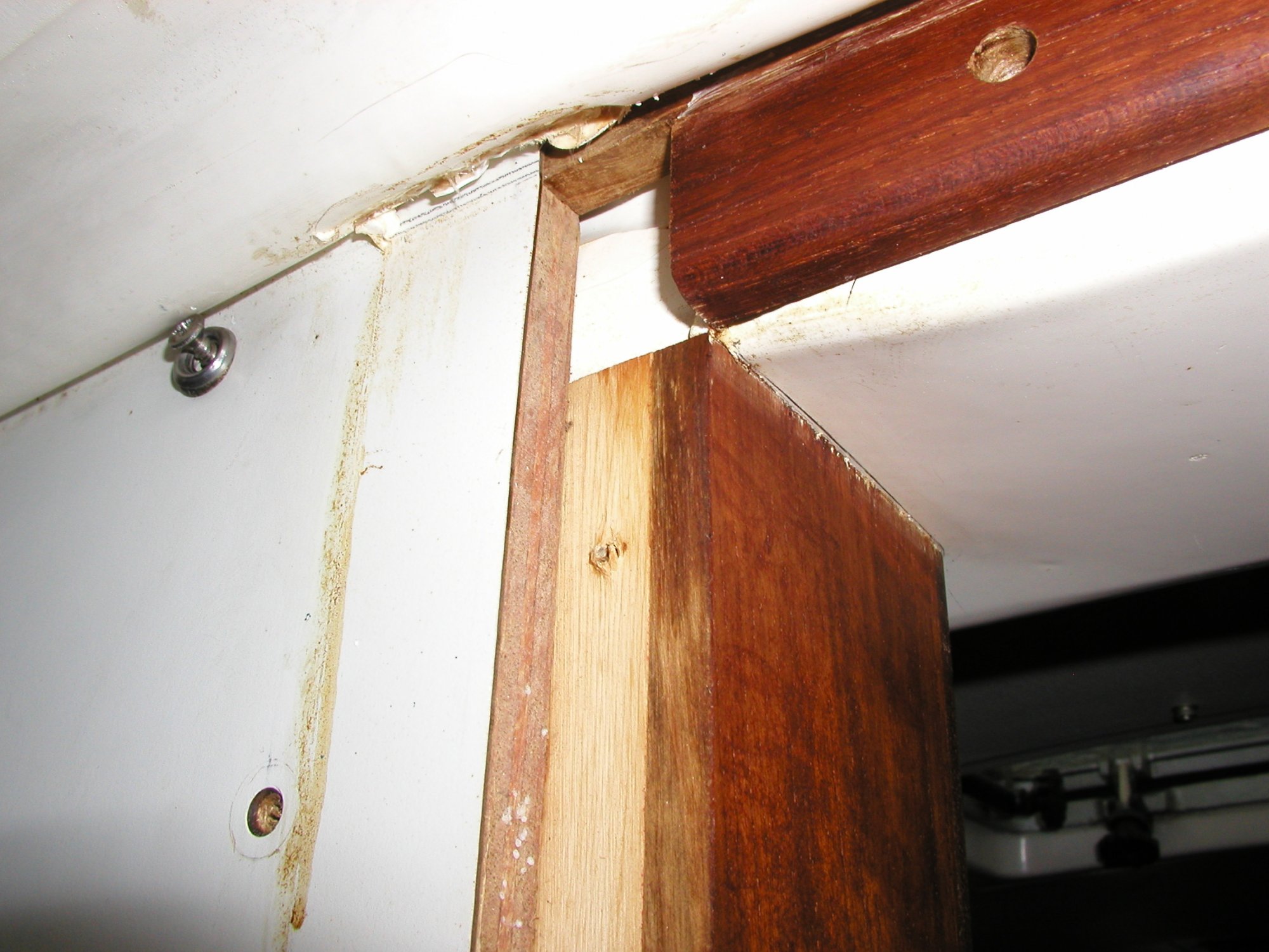

Couple of pictures.. Looking aft at top of compression post.. The bungs and screws of the cover and hinge mount plank and the plank removed. The screws that hold the bulkhead to the hull grid beams are like the one visible at top left. The bulkhead is not really structural, it is held by screws..
This the post showing the wire groove.. mine had a spot of rot in the top couple of inches

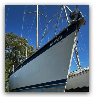

Hey everyone, quick question for you.
Has anybody tried removing the blue striping at the waterline and the toerail?
It is fairly deteriorated on my boat and seems smooth without a seam. Is it paint? I would like to try to get it off but would rather not repaint my boat as the gel coat is in good shape.
Thank you, Chloe.
24,871
It is not paint. It is a gelcoat strip sprayed into the mold at the time the boat hull was built. To remove it you would need to sand it. Then you would need to barrier coat the hull and paint the hull. It is the same material as the white gelcoat.
On the other hand, if it is just oxidized and you want to make it pretty, you could wet sand and polish the stripe smooth like you would polish a car paint job. That often brings the gelcoat shine back.
