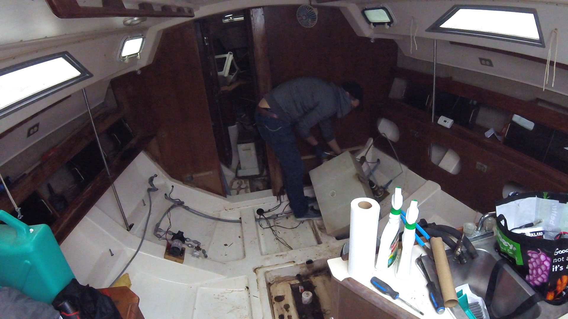

Currently we are ripping up the sole, and will be replacing any wiring under the floor. We will be cutting plywood and sealing it with epoxy or something... and then using some type up synthetic flooring most likely from Home Depot.
I'd like to tackle the false bilge issue. but currently the bilge is a block of ice due to our below freezing winters here in Halifax.

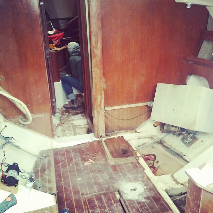

Welcome. Lots of help here. I would advise to add the potable water tubing replacement with PEX as an important modification if not already done, replacing all those compression fittings with shark bite fittings or compression rings if you have access. Replacement of all hoses more than 5 years old is important (fuel fill, exhaust, water heater, raw water, flushing, sanitary, bilge, etc).

Yeah... That's a good idea... I think we will replace all the pressure water lines while the sole is out... That makes good sense. What do you think about the stock water storage tank? My plan is to install a inspection port and scrub it out by hand. Do they have any history of leaking or being bad?

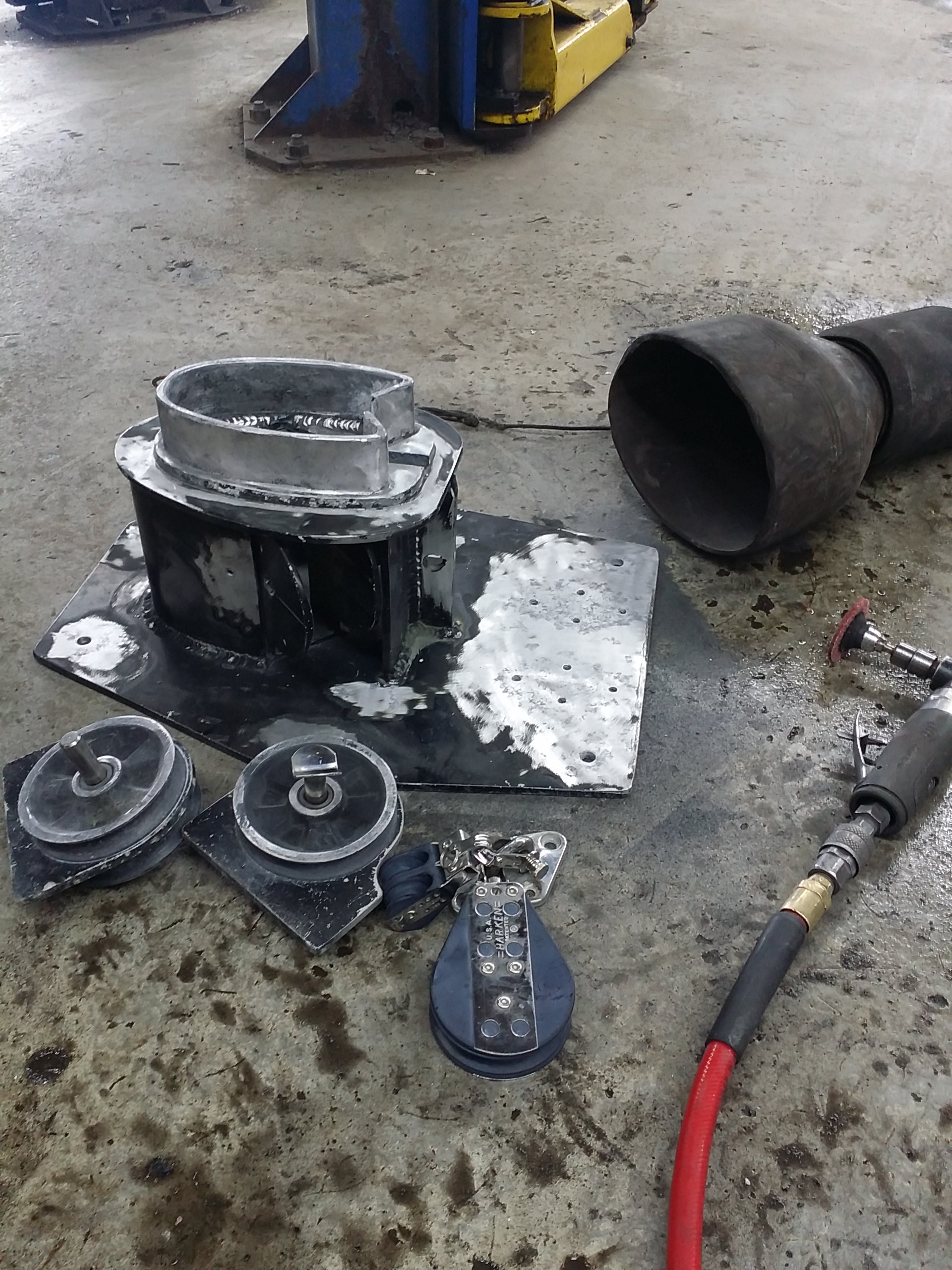

We've got the boat as far apart as it's going to get. The floors are all out, All the old hoses have been pulled, the mast has been removed. I'm going to pressure test the tanks to 3psi this week to make sure that they don't leak. Especially the black water tank as it was bypassed for some reason in the past.
Whenever this damn bilge water thaws I'll be doing the false bildge update and installing the new floors. In the meantime I'm working on the compression post, rewiring the mast and replacing all the mast lights with LED lighting.

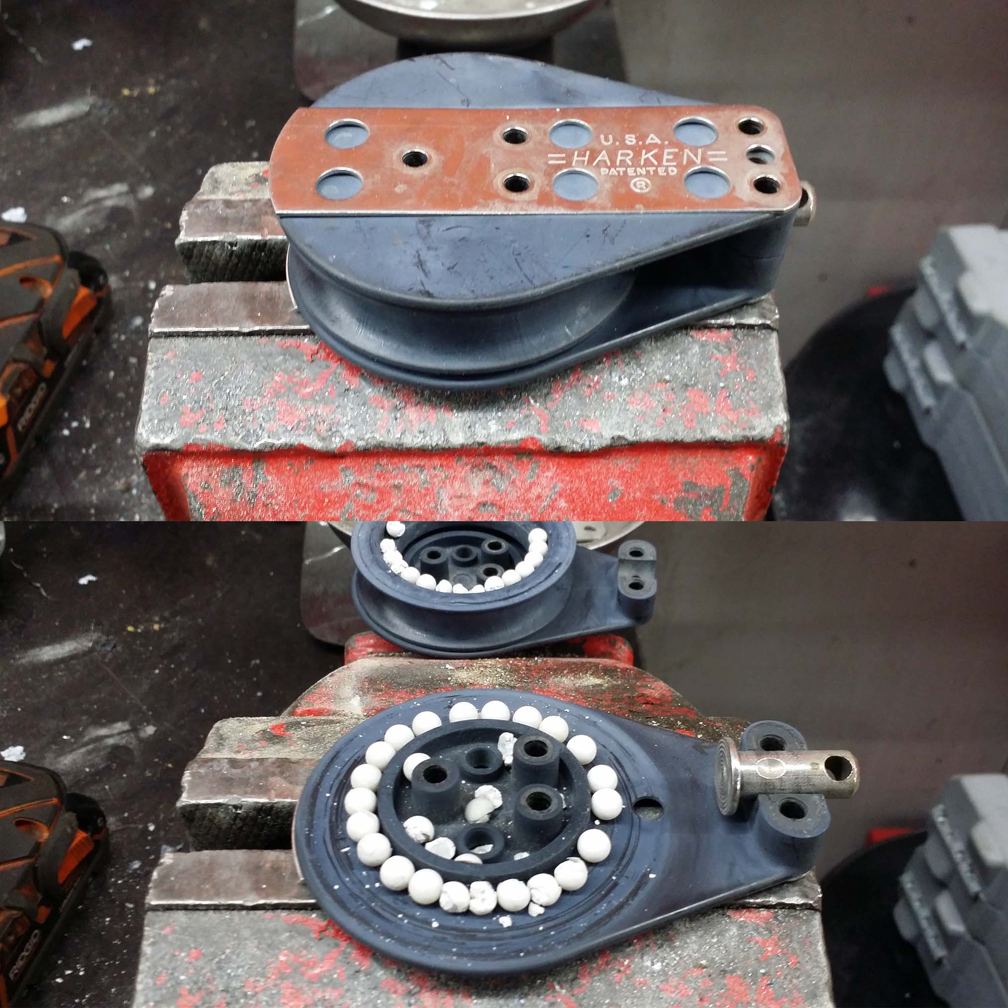

Also I found a block that the ball bearings had self destructed so i took it apart and bought some new bearings for $8.00 at the local boat store. IMG_20170328_161118.jpg block harken.jpg
