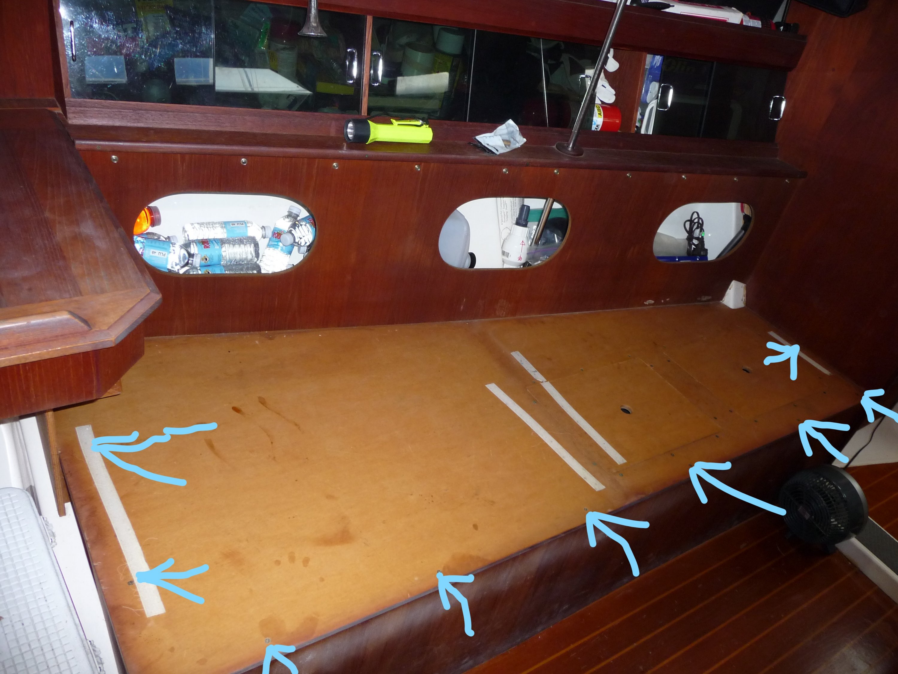

you can take the whole settee top off in about 15min.
I've looked at that settee top for a long time, and I'll be d**ned if I can figure out how to get it off. Many of the screws are accessible, but there seem to be some hidden ones in the area of the water tank itself. I can't see them, but if I undo all the screws I can see it's still securely held down in that area. It's like there are screws coming up from below in the area between the tank and the side facing the middle, and there is no way to reach in there. Any ideas?
10,131
Re: crack.. yes port side tank, inboard side .. the big flat inboard side reportedly may crack a few inches down from the top corner/edge and usually close to the middle .. it would be most probably a crack running fore/aft on the side "facing the middle"
Here is a shot of the top of mine showing the vertical screws that you can see that hold in in place.. Then there is another set of vertical screws that are accessed by going inside the storage cubbies and looking on top of the "cleats" that are screwed to the backrest with horizontal screws. There are several screws holding the cleat (square section wood along the bottom inside of the backrest wood that has the cutouts).. some of the screws are between the openings so ya have to search.. There are also a few vertical screws outboard of the cleats that hold the settee top to the fiberglass rib running fore/aft. Then don't lift the top up but wiggle it toward inboard to get the outboard part out from under the backrest wood. If ya lift it too high, it will jam under the backrest wood. The ones I pointed out are the obvious and easy ones.. the ones inside the storage cubbies are harder to get at but are reachable..
EDIT: On my 34, the screws holding thee top to the fiberglass beam are big stainless pan headed sheet metal screws and not flat countersunk brass wood screws like all the others.

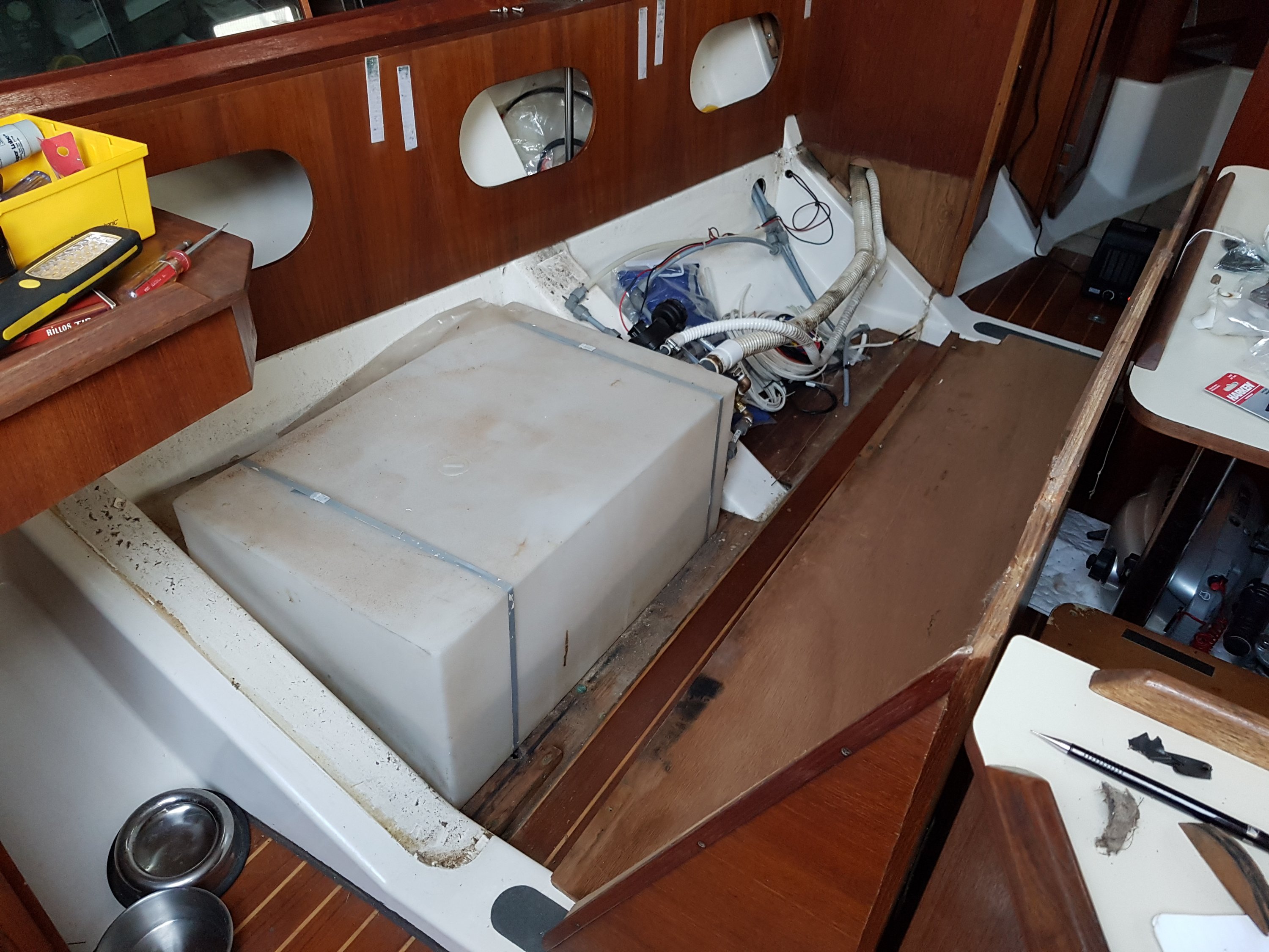

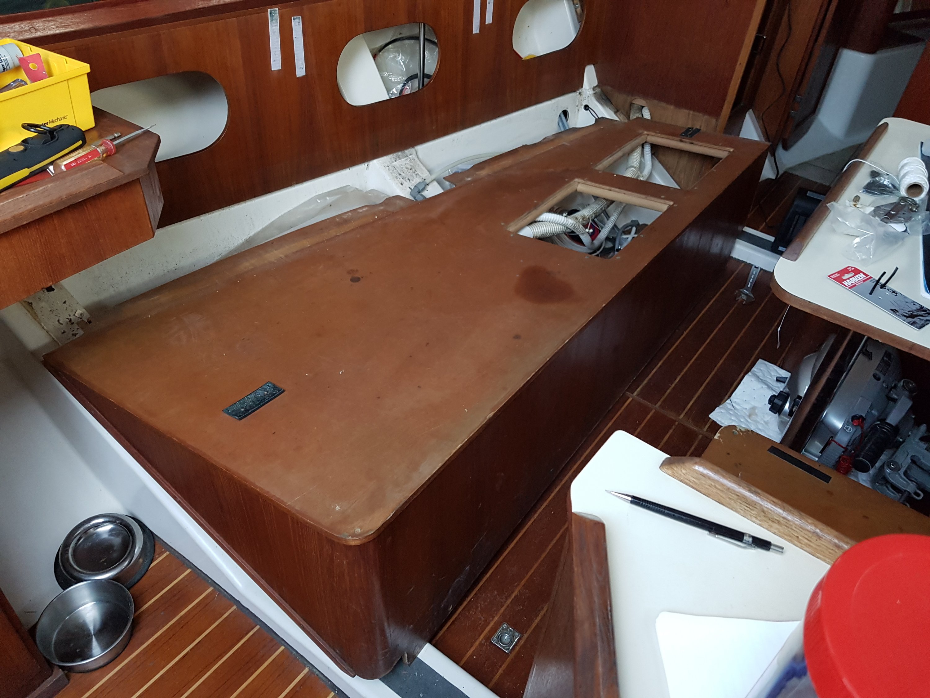

Hi Kloudie,
My boat has not a single one of the screws you point out in the picture. There is exactly one brass screw visible from the top, and it's right at the corner closest to the galley. There are screws pointing upwards through cleats into the plywood that are accessible through the access covers, but there appear to be more between the tank and the wall, and there is no way I can get my arm in there. I can't figure out how they put this together in the first place. My only guess is that they assembled the complete settee (top, side, and end) and somehow attached it to the hull liner in one piece over the tank.
This is a project for next winter now; the weather is too good now to spend time working on this. I think it'll probably come down to cutting another access port, now that I know the likely location of the crack.
As always, thanks for all your help.
Update: The settee in my boat WAS installed as a single piece, with a couple of screws into internal cleats covered with teak plugs on the bottom near the aft end. When it goes back, the top will be removable like everyone else's!
There is crack in the tank exactly as Kloudie described. About 1" from the top, roughly half the length of the tank, on the side facing the center of the boat. Based on discolouration, there is only one short stretch of maybe 1" that is actually leaking, but given the overall length of the crack it's not long before my water tank becomes a water bucket. Now the question is "how to fix it?" I'm looking for the best repair, not just "good enough". Splax mentioned Loc-tite Plastic Bonder, but how would you get it into the crack? Capillary action? The instructions say not to use it as a gap filler, which would rule out grinding out the crack and filling it, at least with this stuff.
Ideas are welcome!

Glad that ya got it off and can access the tank.. Replacement is always an option, I think the company that made the tank is still in business.. Other option would be to install a 6" or so access port (deck plate, I think Phil has some on this site,https://shop.sailboatowners.com/prod.php?14562 ) to be able to get a hand inside.. Then you can push from the inside to open the crack to the outside.. push some of the LockTite in the crack when you get it just a little open.. then take a strip of fiberglass tape and install it over the entire crack (on the outside), using the plastic bonder as you would epoxy.. Once you verify that the patch is good, use some foam bracing between the tank wall and the inboard side of the settee support to stop the flexing.. The big crack is a fatigue crack from the water sloshing around on that in-supported vertical tank wall. The beveled side (underside, outboard) is supported on expanding foam.. ya might be able to easily do the same on the vert, inboard wall by putting a garbage bag between the tank and settee support and squirting expanding foam into the bag..
