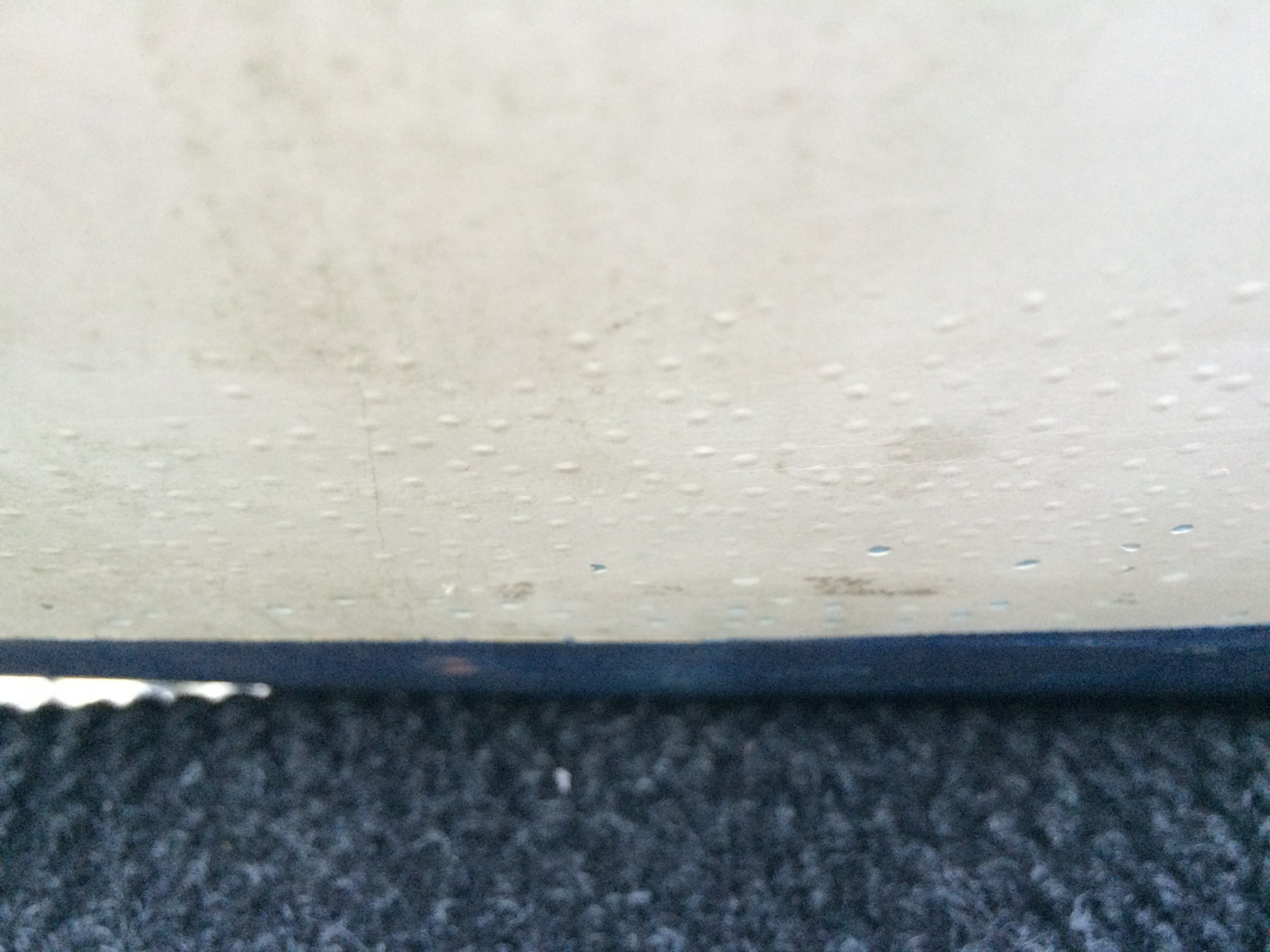

Also, is this osmosis? It looks pretty high up for that. It's near the back of the boat only on one side.

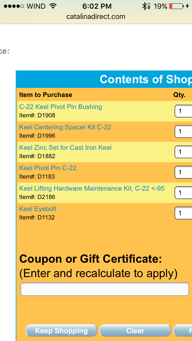

Here are the parts I'm going to order. I might not get the centering kit and make my own but not sure yet. It might just be easier to buy it.
Let me know if there is anything I missed.
I will buy the keel bolts from a local industrial supply store.

On the second pic, yes, that is a very minor case of osmotic blisters. They are very small because the water molecules are only trapped in between the gelcoat layer and on top of the fiberglass so they make those tiny bumps. Kind of like a rash or little pimples. If the water molecules were trapped deeper in the fiberglass itself the bumps would be bigger, anywhere from the size of a dime to a nickel. The bad ones (if there were any) would have a nasty sticky goo in them that would have a chemical smell if you popped them and drained them with a knife.
So what you have is very minor and really just an eye-sore. The fix isn't very hard and the job could wait until the winter or another spring. All you would have to do is lightly sand off the tops of the bumps so they all look like the ones that show blue where the outer gelcoat popped off. Clean with acetone and the use a putty knife to apply some gelcoat paste (from Spectrum Color website, $25 for 2oz jar color matched white for Catalina). You'd sand the cured gelcoat smooth (gently) with 120, then 220, then 320 wet, 400 wet, 600 wet. Then polish with rubbing compound. It will look brand new. If you have a DA sander you could do the entire hull with the 400 and 600 grit wet and buff the whole thing... Seriously, the boat will look brand new.
Like I said, that project can wait... some people wouldn't bother with it at all.

For the parts, everything is good except you do not need the keel zinc kit... waste of money. Also like you said, you don't really need the centering/spacer kit. You can make your own spacers if you have some spare fiberglass cloth scraps and some epoxy. Do get all the other parts. The bolts you need are 5/16" x 1.25 inch and lock washers.

The only reason I was buying the zinc anode is because i think there was one in it and that means a hole through the keel?

People think a Zinc will protect the cast-iron keel. The only thing it really does it make a hole in the cast iron that will eventually allow water inside and cause rust. The best way to protect a keel is to properly seal it in epoxy. If you keep the water off of it (epoxy is actually fully waterproof where polyester resin is not), then gala corrosion cannot occur. There have been many discussions throw back and forth about this topic, but I will leave it at this; just about every member here who has done a full epoxy keel restoration has opted not to drill a hole into the keel they just sealed with epoxy. Also, there is a type of zinc you can buy that has a long wire attached to it with a gator clamp. You can clamp it to the keel winch cable on the inside and throw the zinc over the side... this is about the cheapest option you can can go with that 'might' protect the exposed metals.

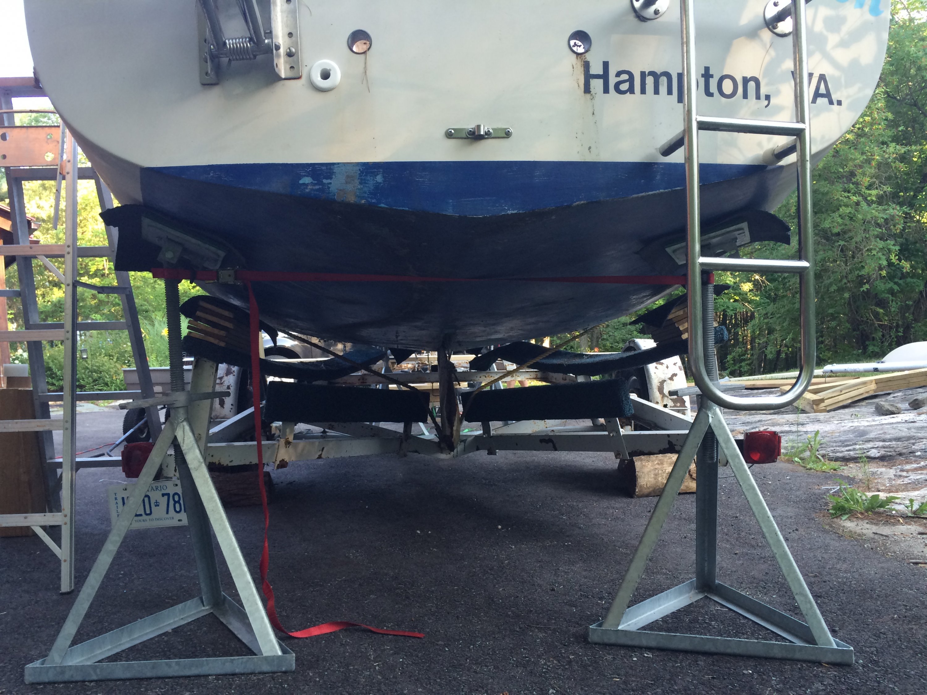

I just have a few questions on how to deal with the stands and the area under them.
Should I sand the entire boat, then move the stands and sand under the stands? Move them back and paint all coats and let it dry before moving the stands and painting the spots user them?
How long do I let it dry for before moving the stands? And supporting the boat on the freshly painted surface?

When you take the boat off of the trailer and put it on stands the rear stands should be placed at the strongest part of the stern which is right next to the transom. the forward stands will be far enough forward that you will be able to paint the entire middle section of the boat where it normally sits on the trailer bunks. Paint the area you have access to with the first gallon, this should be about 2/3 of the entire bottom. With a 1/4" nap roller you should get at least 3 coats, but you might get 4, waiting just one hour or so between coats. Let that cure overnight or a couple days is even better. When that is done you can place the boat back on the trailer. For the second gallon, have your keel and rudder ready to paint also. The area on the stern and near the bow will be a smaller area so you won't need the whole gallon, so for each coat as paint the rudder and keel. You maybe only need two coats on the rudder, just make sure you get the full three or four coats on the keel and the rest of the hull the same as you did with the first gallon.

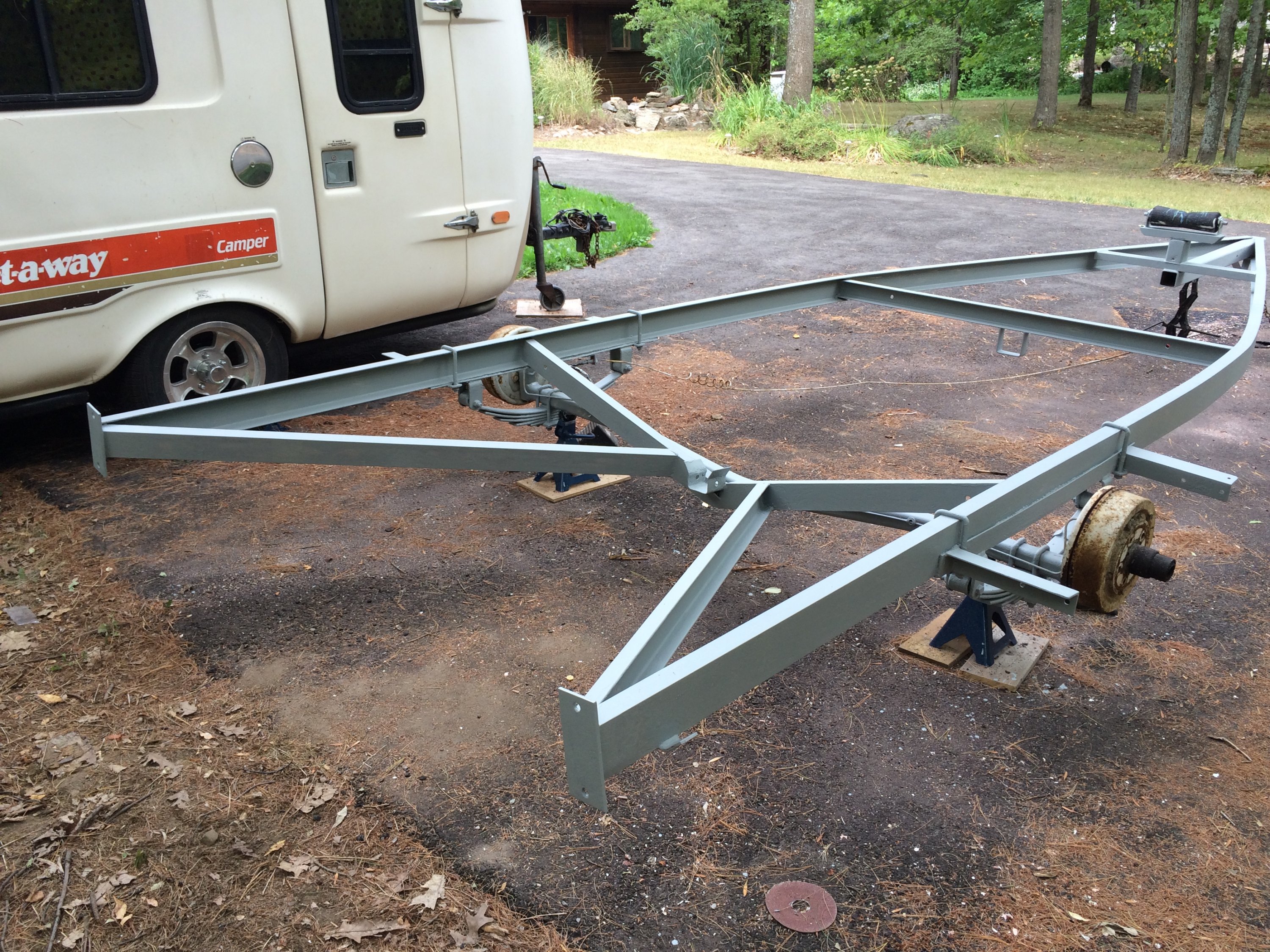

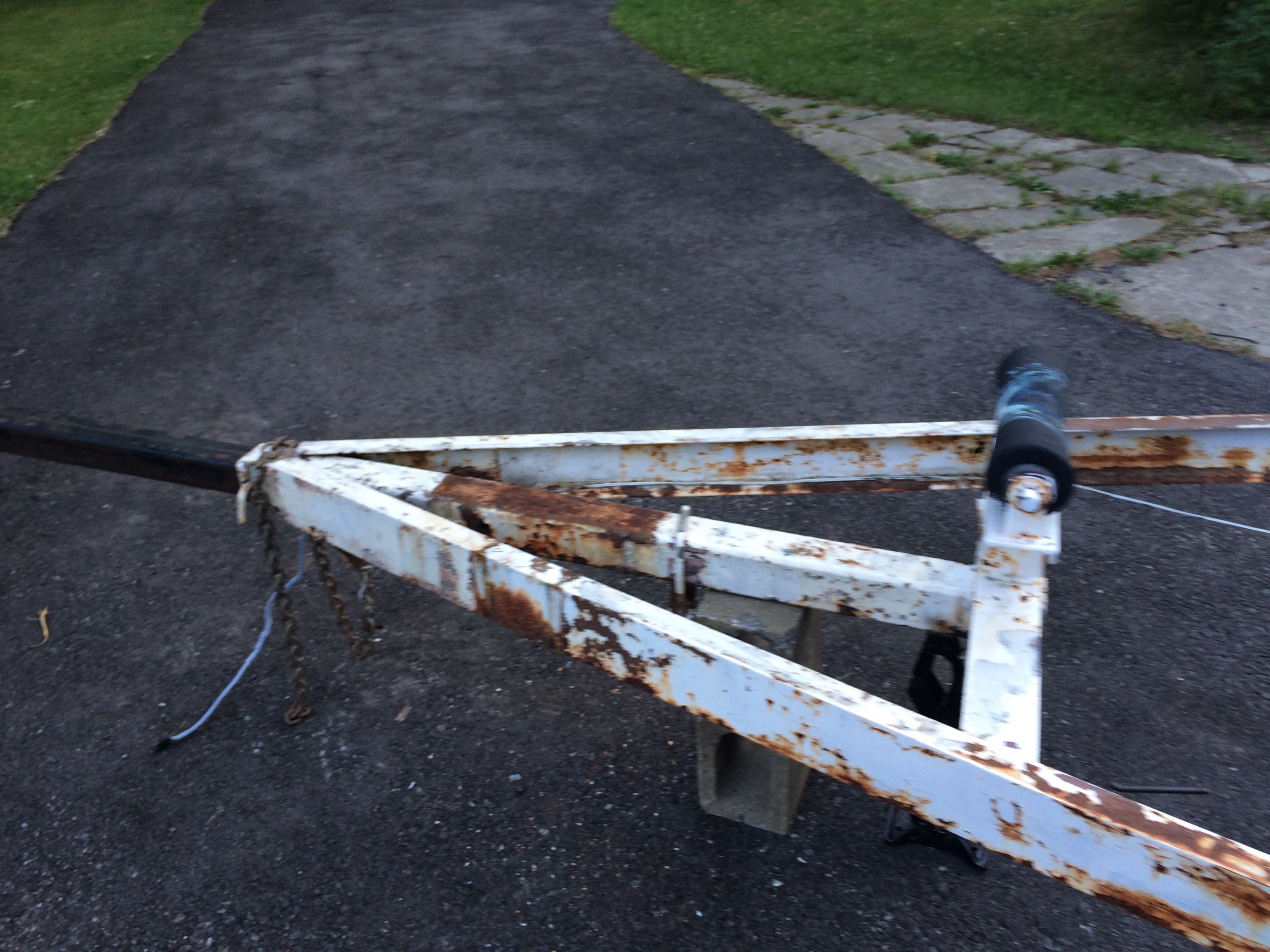

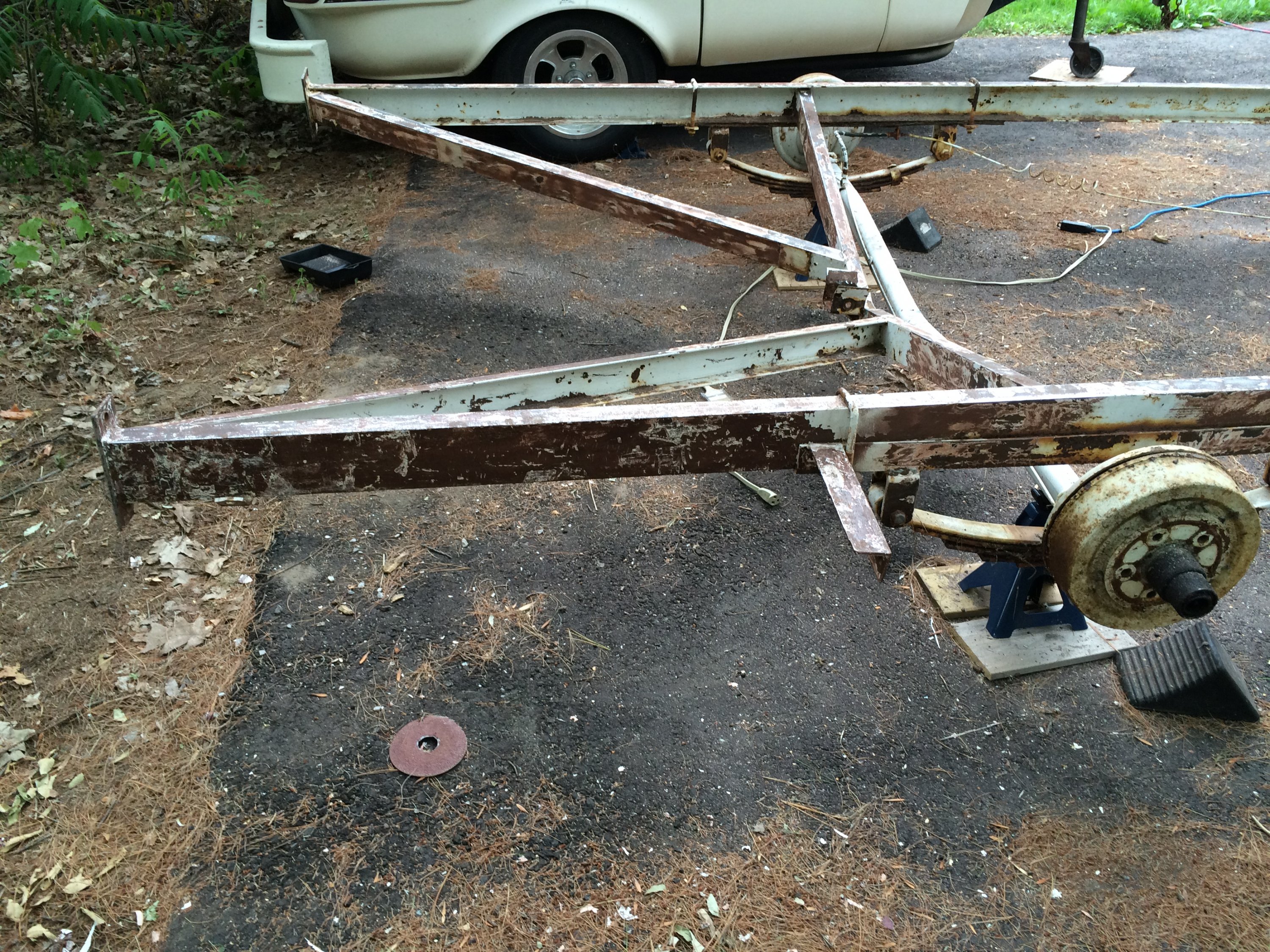

Ok thanks for the tips. Working on the trailer first.

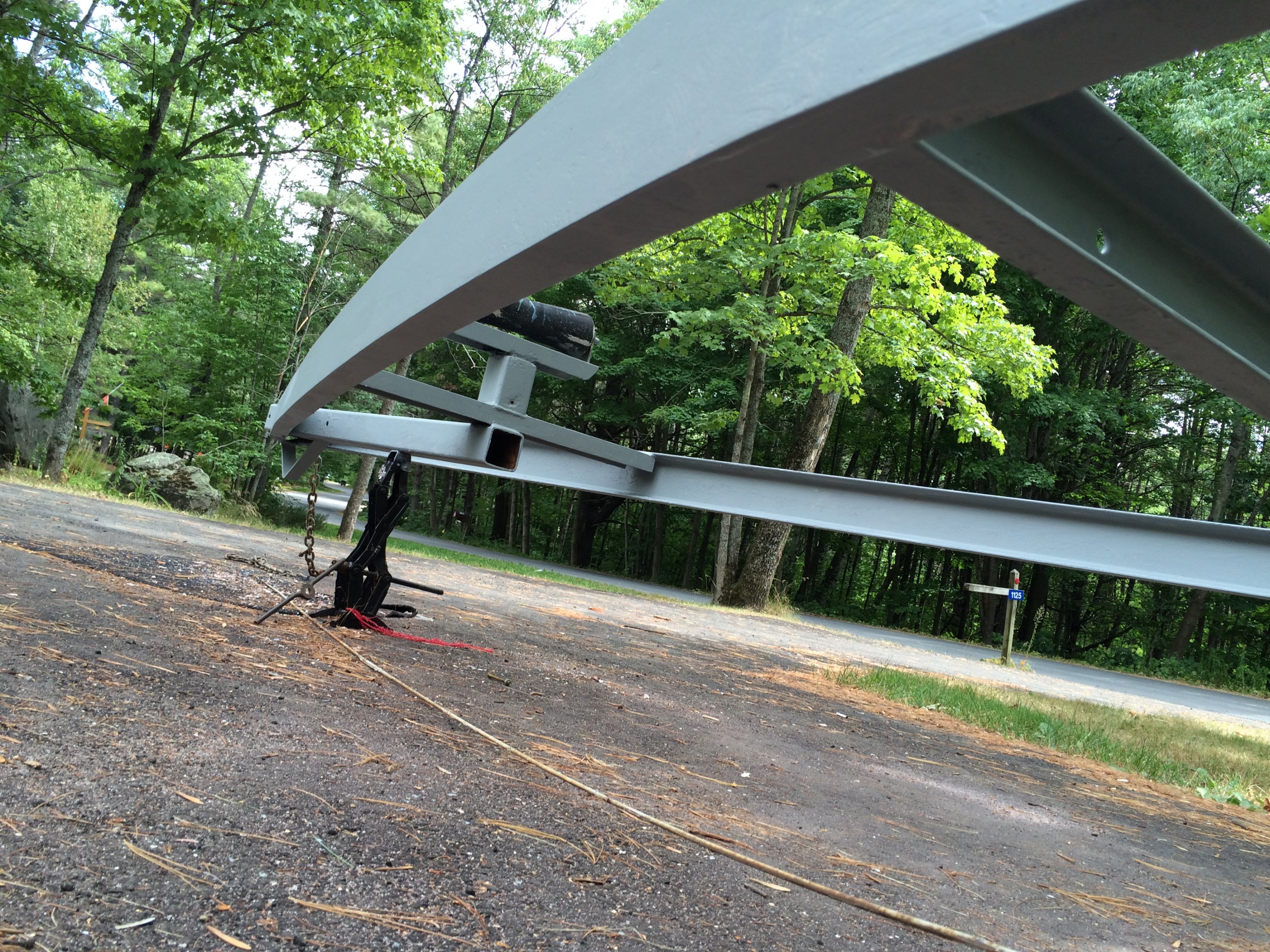

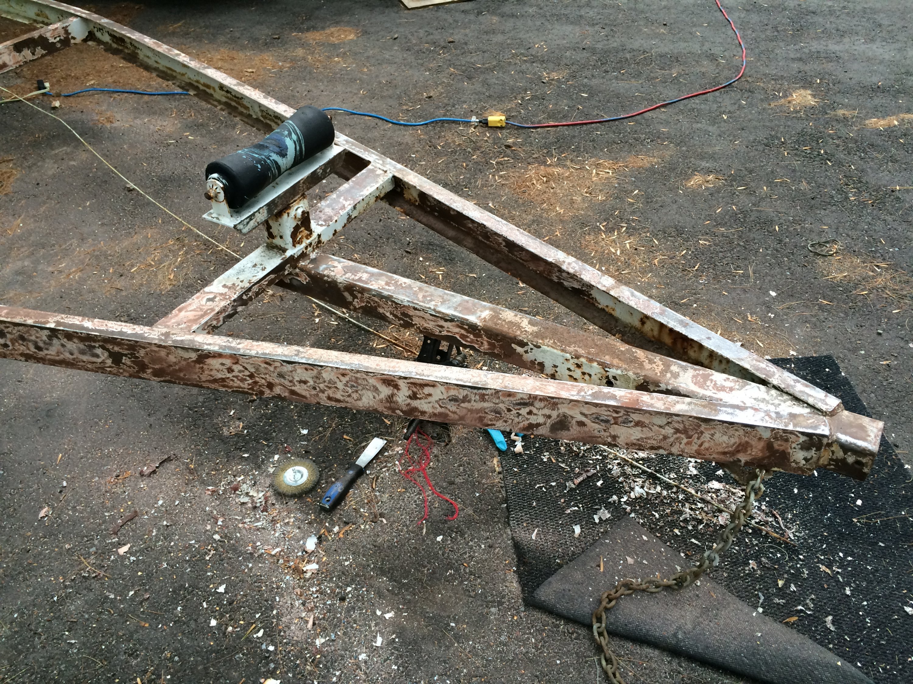

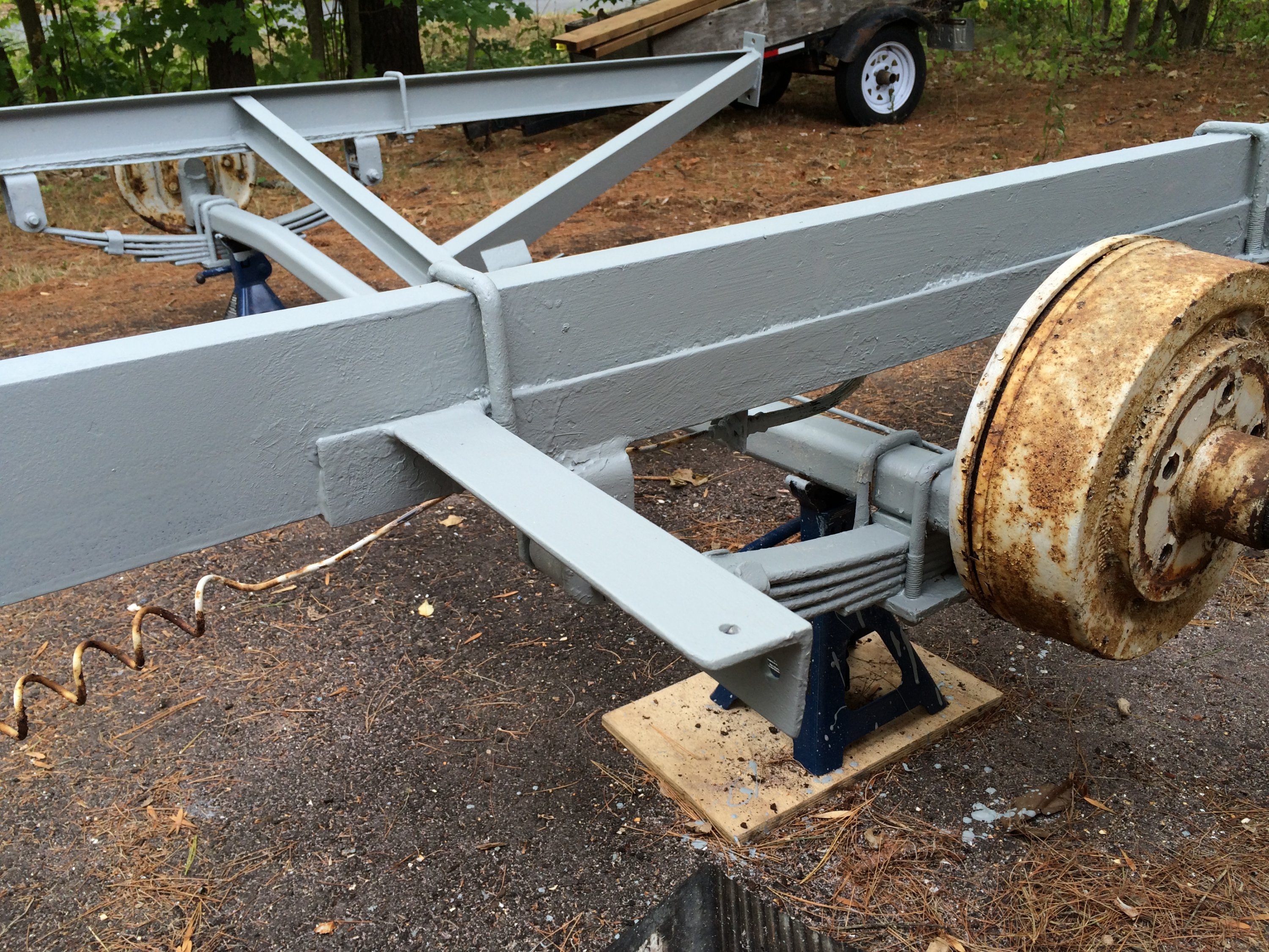

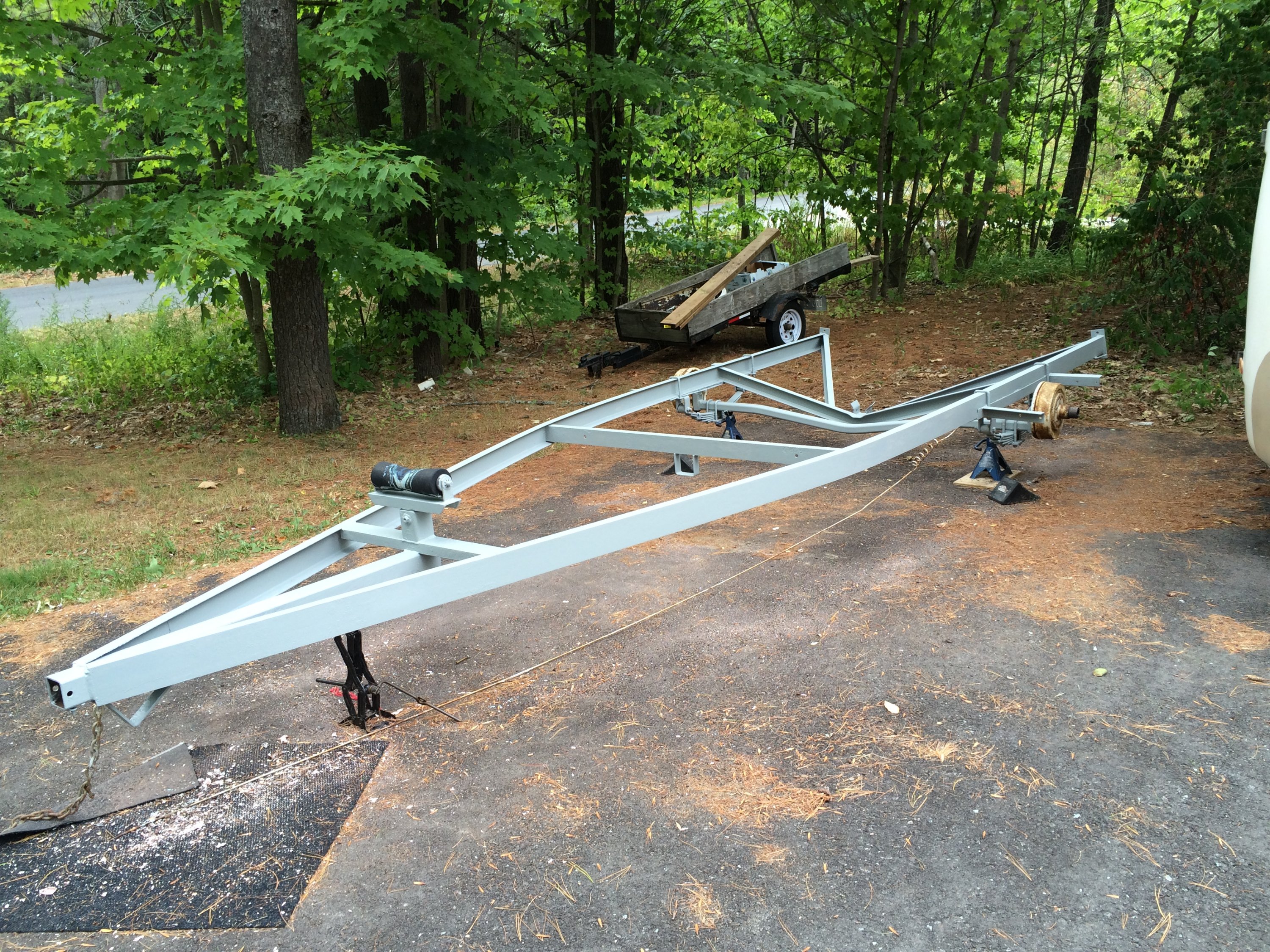

Before:
After most of the sanding but before wire brushing:
After primer:
It dried about 4-6 hrs and then it started raining. Hope it works out ok. Next Silver and black paint after a couple days to dry out from the rain
