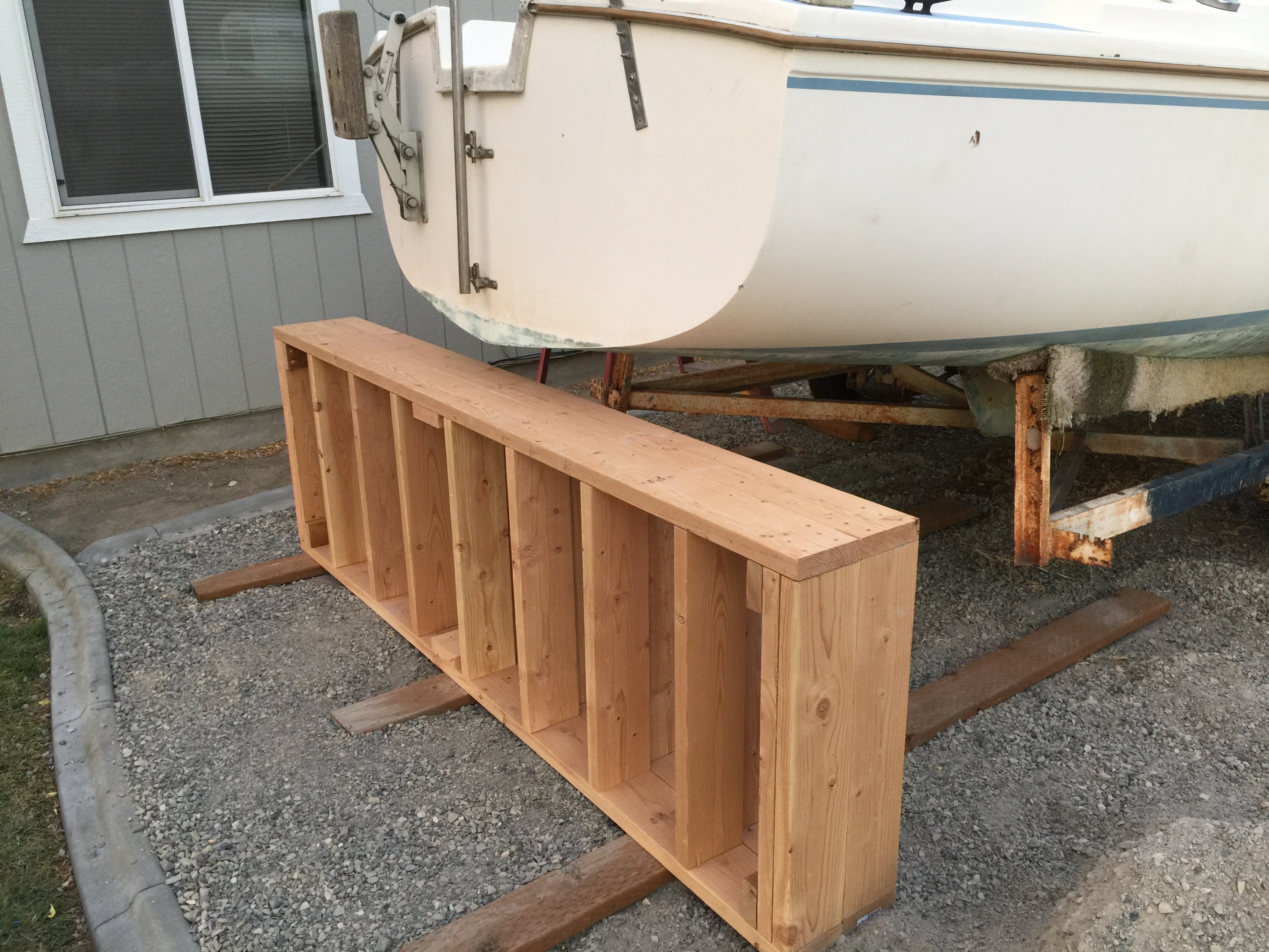

I've of people lowering the trailer jack all the way down then building a stand for the rear of the hull out of lumber. When you jack the trailer back up to hook to your vehicle it picks everything but the bow of the boat off the trailer, then you can use a cherry picker or a hoist thrown over a tree branch to pick up the front and pull your trailer out and build a stand for the front. I'm not sure this would work with the curved bunks on Catalina trailers though.

You don't need a crane, but what you do need is a 'small crane', an engine hoist or 'cherry picker'. Usually most people have a friend who is a car guy who will have one to borrow, or you can usually pick one up used off Craigslist for less than $100. You can lower the trailer tongue jack to the ground and then build a lumber cradle under the transom. There several threads in this forum where members show pictures of how they do this scrap lumber. Then use the engine hoist to come in from the side and lift the bow using the bow eye, now you can roll the trailer away. You can then build another lumber cradle for the front. also, you can use boat stands. I found a set of Brownell Boat stands on craigslist for less than $200. All the work you need to do on the trailer and the boat is much easier when off the trailer, including bottom paint every few years.

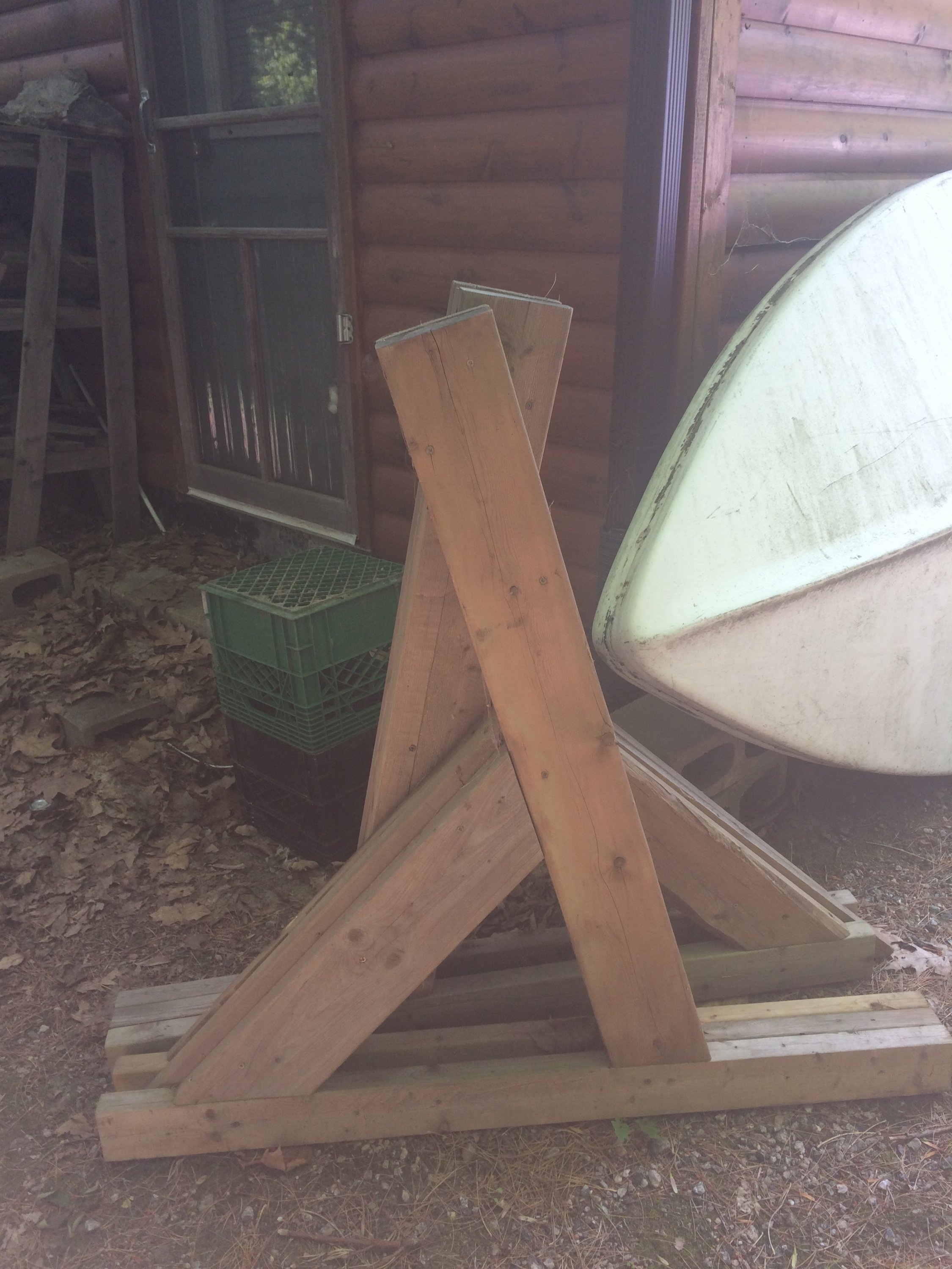

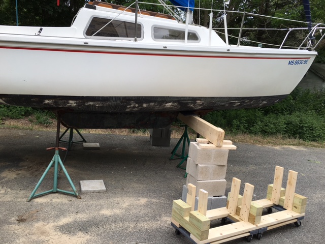

Hi Reefsider:
I toyed with the idea of the shop crane off the bow ring, but had the same concerns you do. Put two stands under the transom and two more just behind the trailer wheels. Jacked up the trailer using a farm jack and then put 2X8's on cinder blocks as shown. Pulled the trailer out by hand and put two more stands up front. the cradle followed the example of a kind soul on this forum and worked well. Good luck. [/ATTACH]

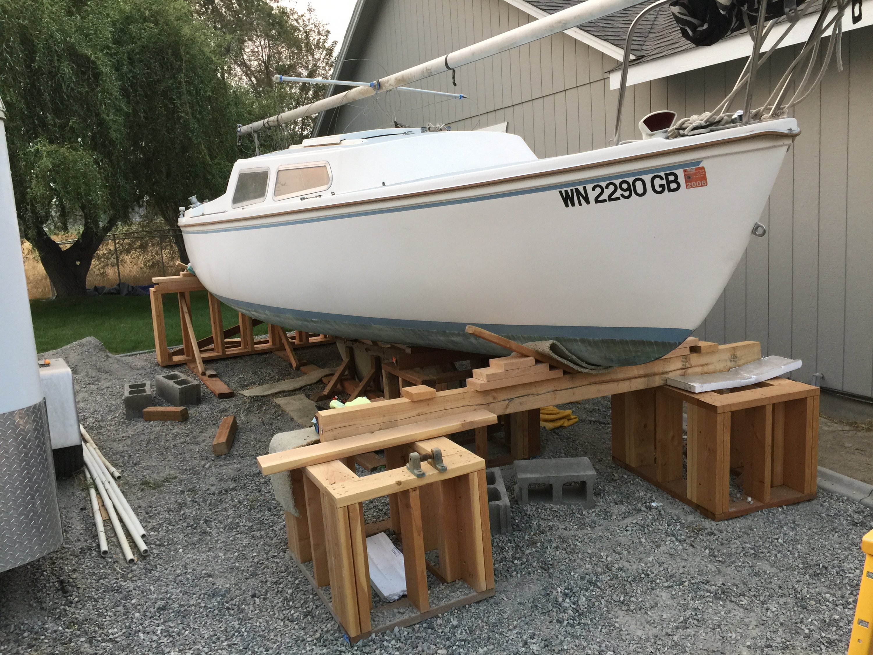

The first time I got it off the trailer ( I needed to fix the trailer!) I just used the cheapest lumber I had and could get: not a horribly elegant solution, but it was more than stout. I have since found stands on craiglist after a lot of searching-- the stands will ultimately make it 1) easier to lift in place and 2) takes up a whole lot less footprint (which is aproblem since I moved and have lost the extra storage that could house the untrailered boat for days on end.

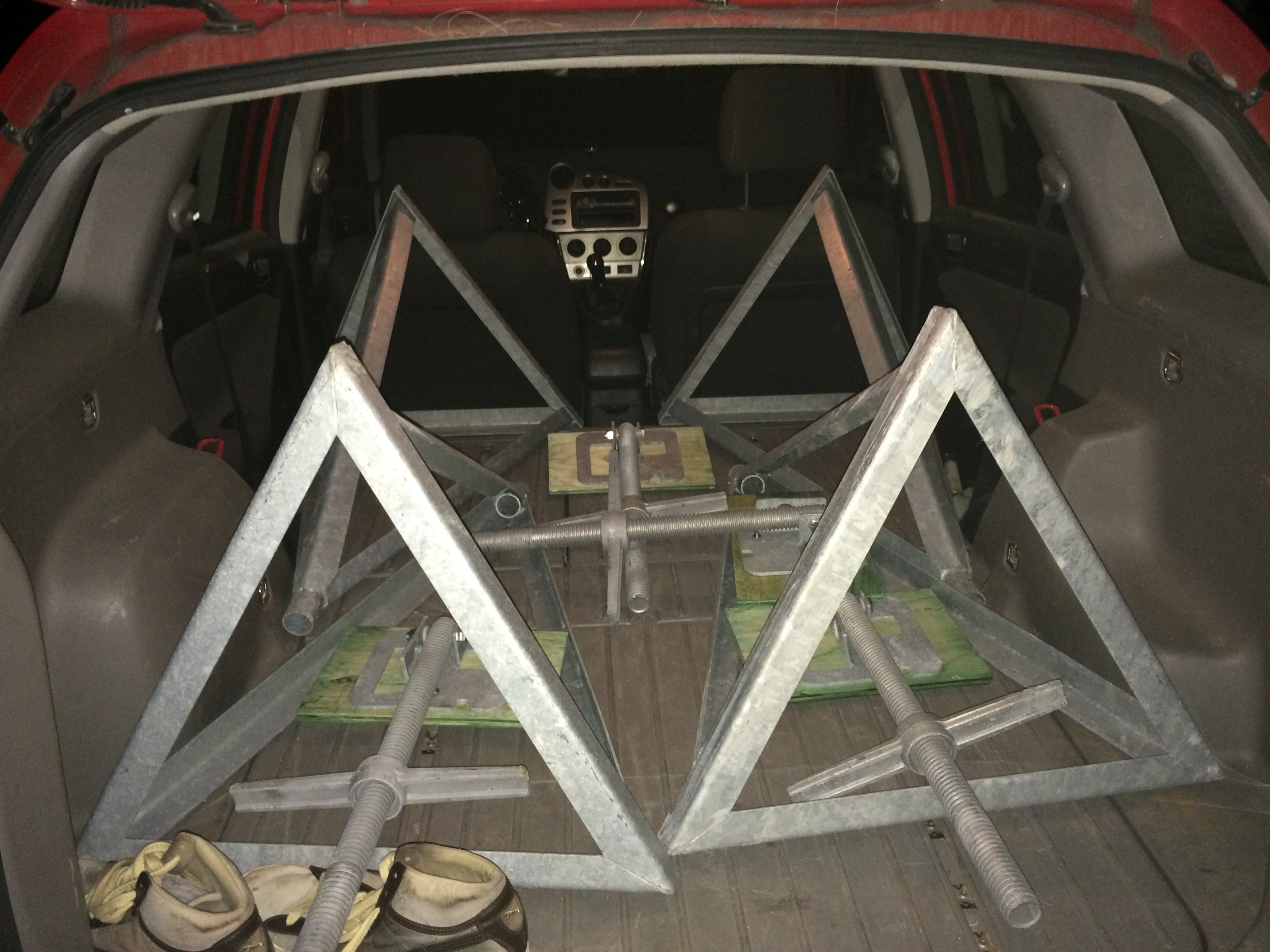

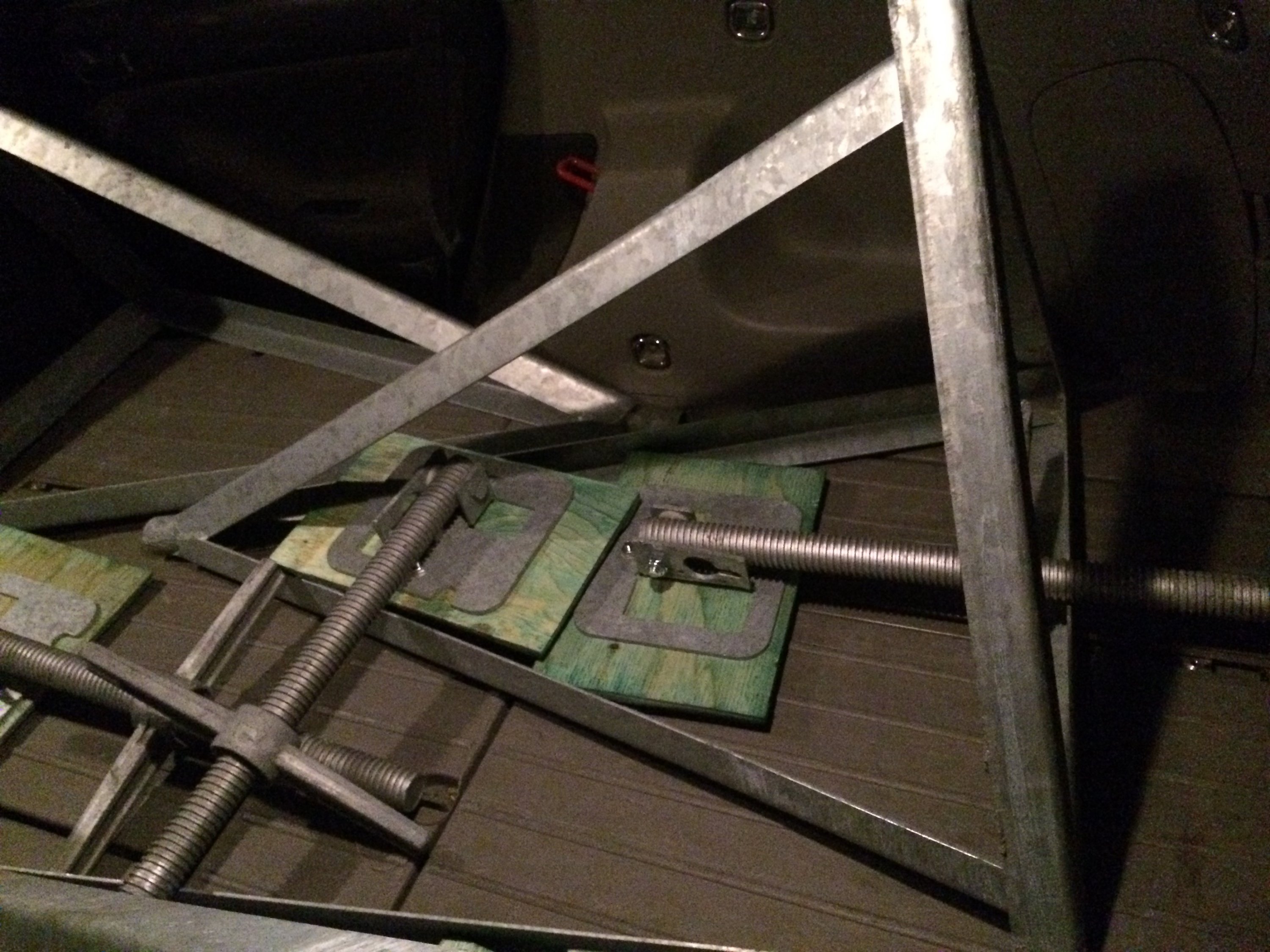

I ended up finding a set of boat stands today. I found this place Kropf Industreal that's an industrial welding outfit. They make them and sell them to marinas.
The stands are galvanized and are very nice. Good price too, about half of the best price I found calling around.
Only thing is I Noticed when I got home that I got the power boat ones not the sailboat ones. The sailboat ones are a bit too tall at 51" min compared to 40" min. The big differnence being the power boat stands have the shaft with the pad on it straight up the middle of the tripod. The sailboat ones have an angle to them. The sailboat ones are also 50% more money lol.
I'm considering returning them for the sailboat ones but I'm pretty sure I can make these work safely as the bottom of the boat is fairly flat.
Do you think they will work and be safe? I can't see why they wouldn't but I don't know much about putting a boat on a stand.
Aug 1, 2011
3,972
You run a chain between them to keep them from sliding out.

You should be fine-- I have the same and with 20 degree swivel on the head they are a great fit for the stern-- and the forward edge of the keel. I'm contemplating using two with a 4x6 cross member for the bow or possibly they will fit as is.
The lack of a fixed keel keeping the boat on a knife edge puts us in an almost in / almost out category -- both will likely work, just be judicious about placement

Ok thanks. I was going to use ratchet tie downs between the stands to keep them from sliding out.

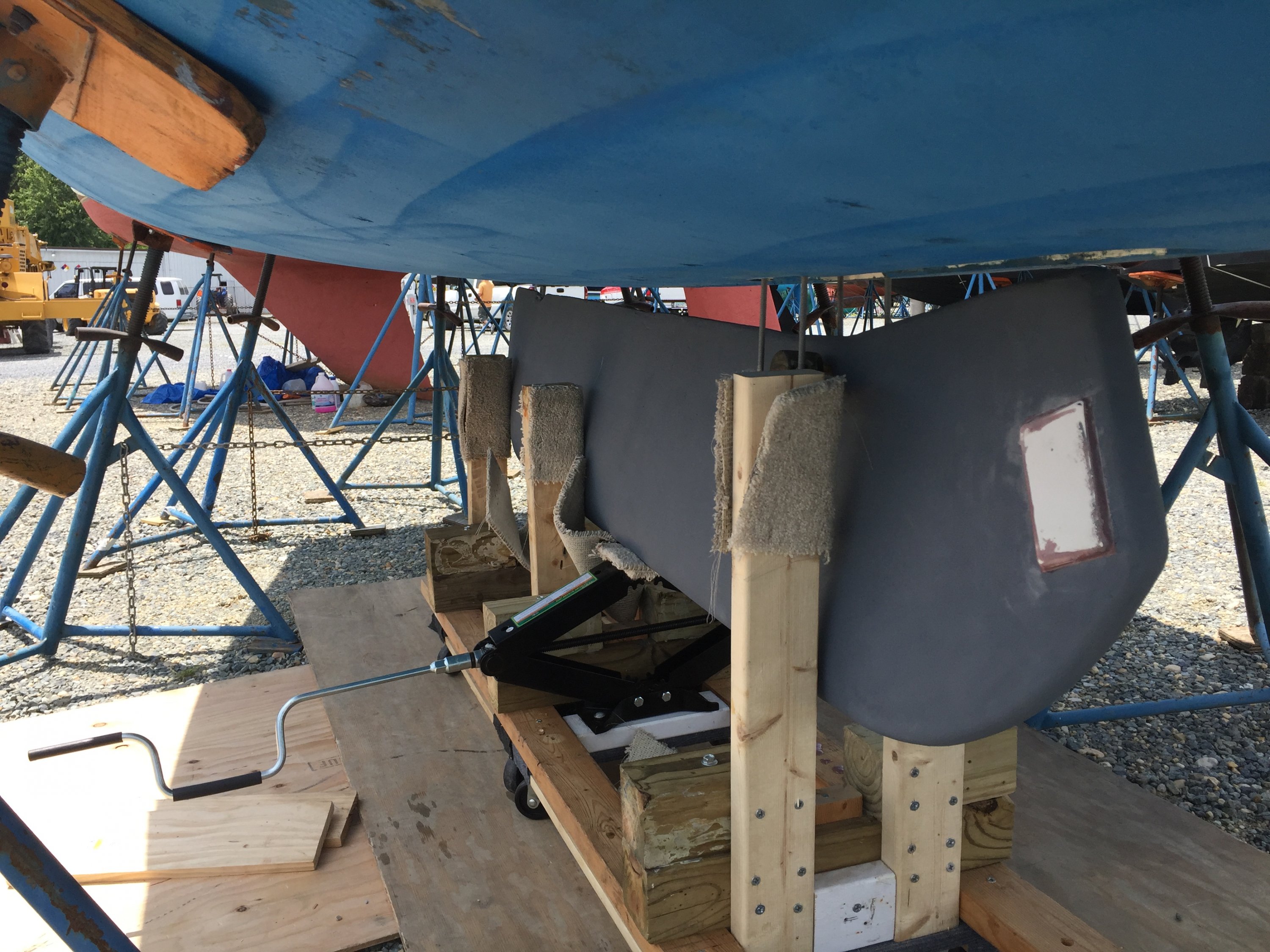

I'm building the cradle for the keel today and I'll try to get the boat up tomorrow.
Jul 13, 2015
922
Catalina 22 #2552 2252 Kennewick, WA
Nice -- yep, as meriachee mentioned there should be a chain slot on each stand that you can tension them together with , essentially counterbalancing so one cannot slip off independently.
Check out brownells they have a good video of how to do it correctly.
