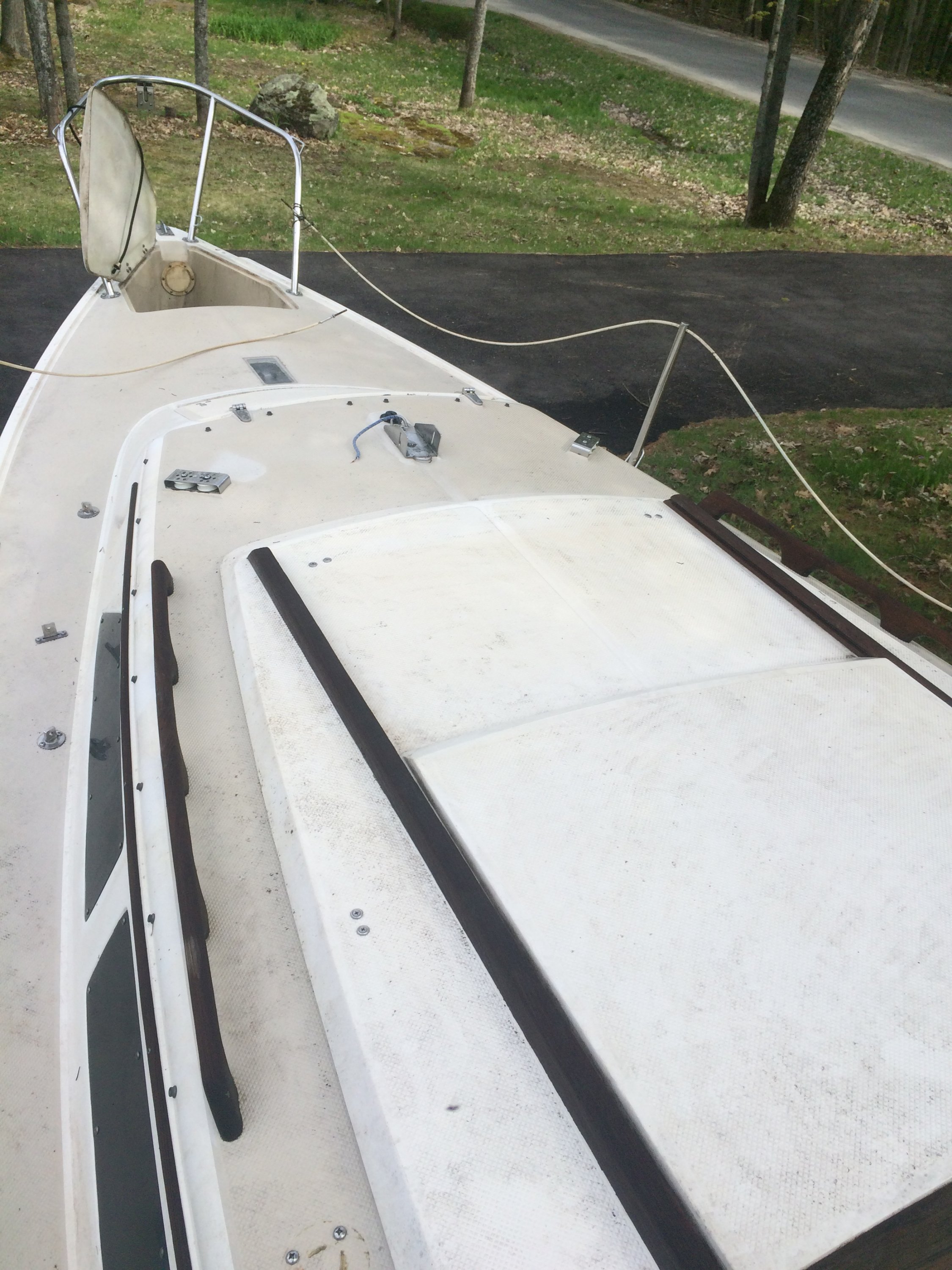

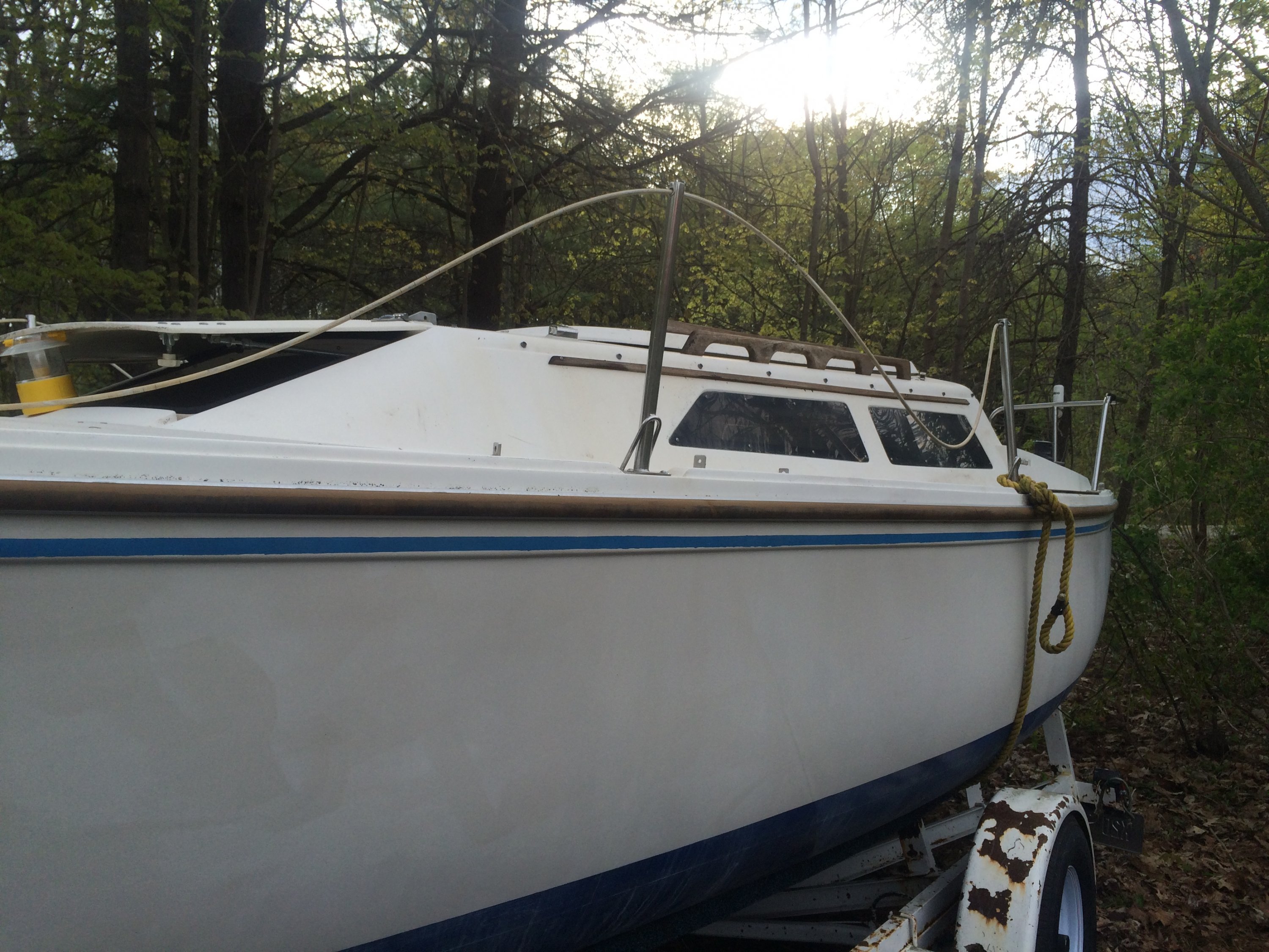

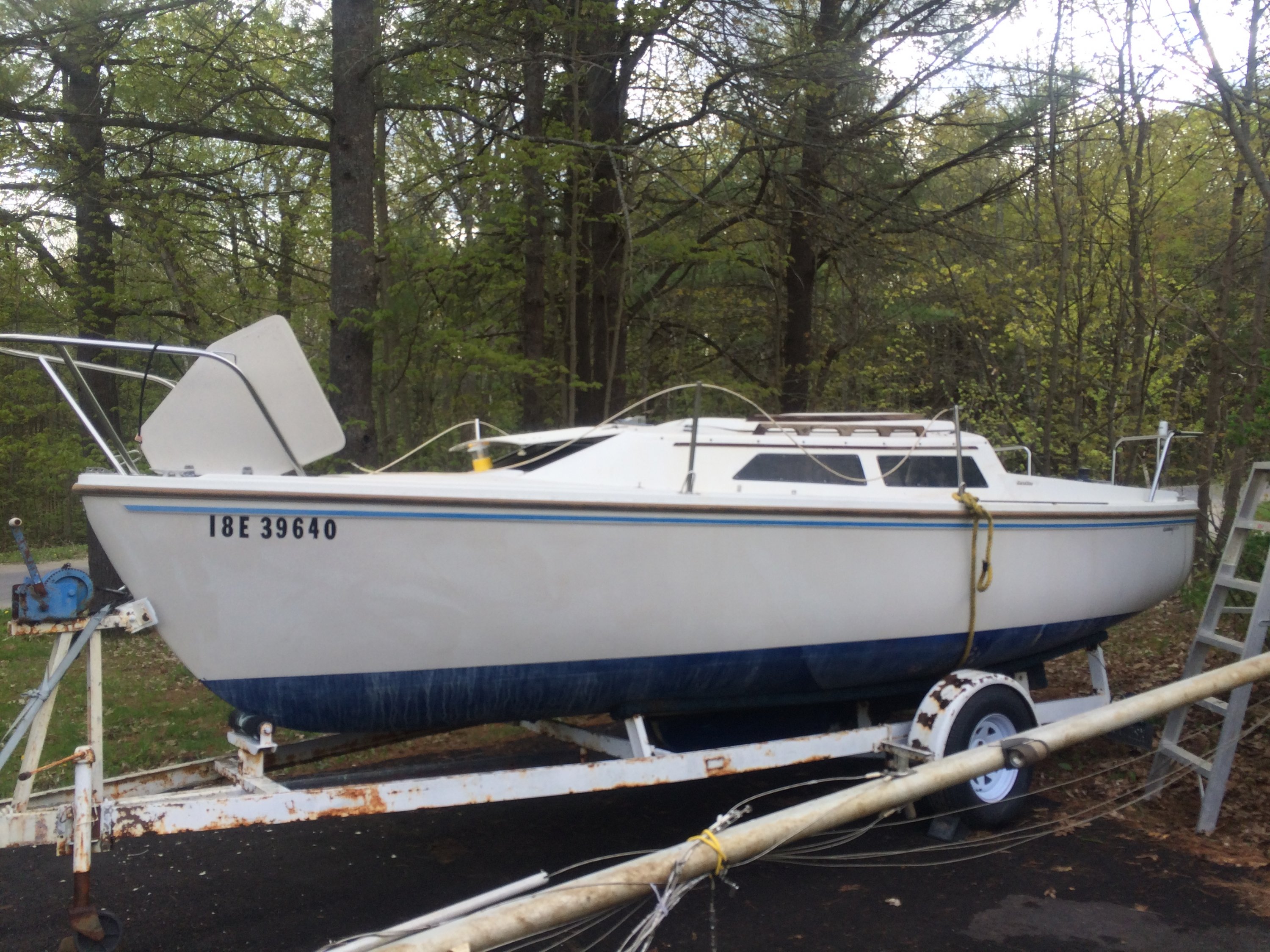

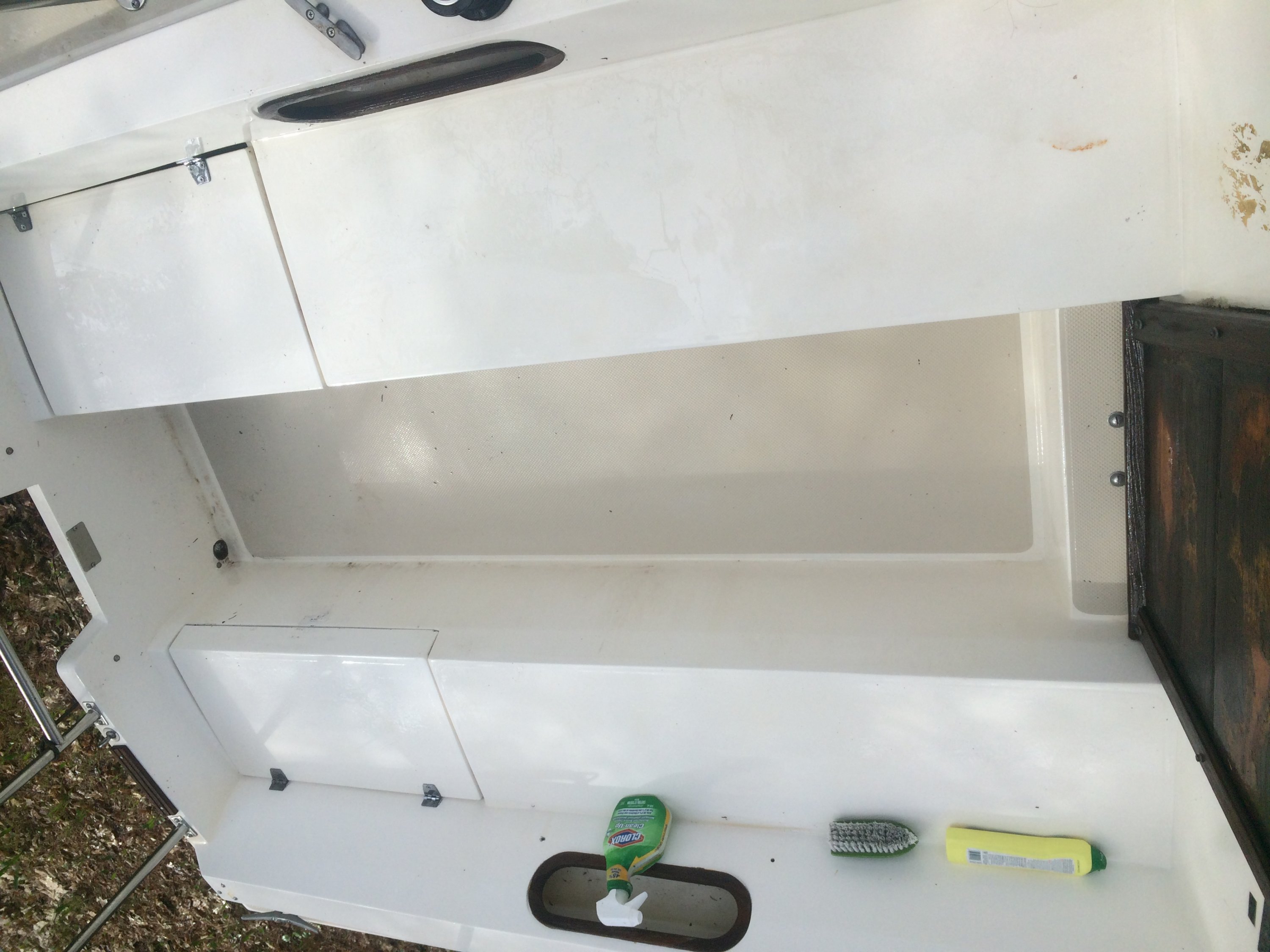

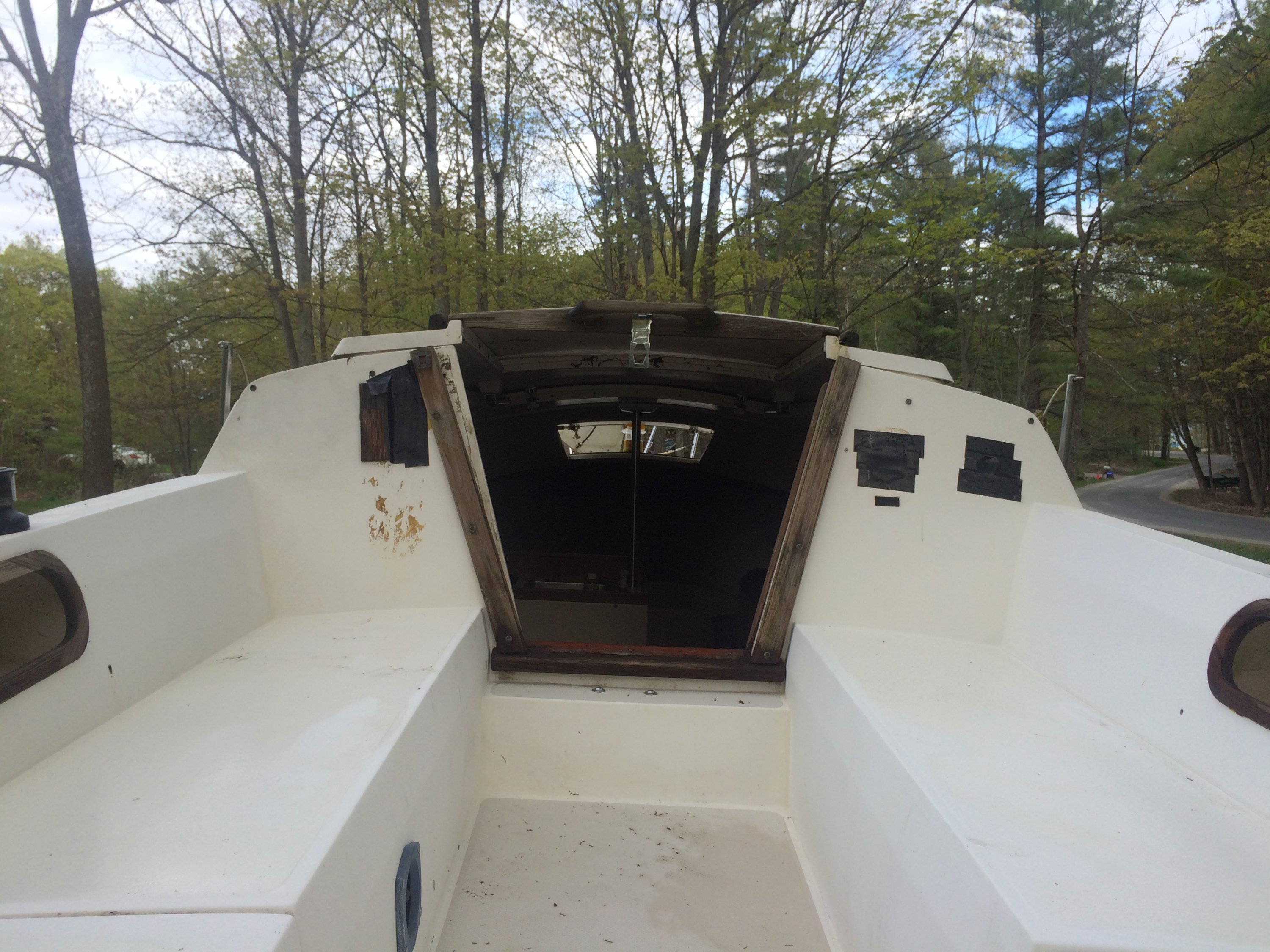

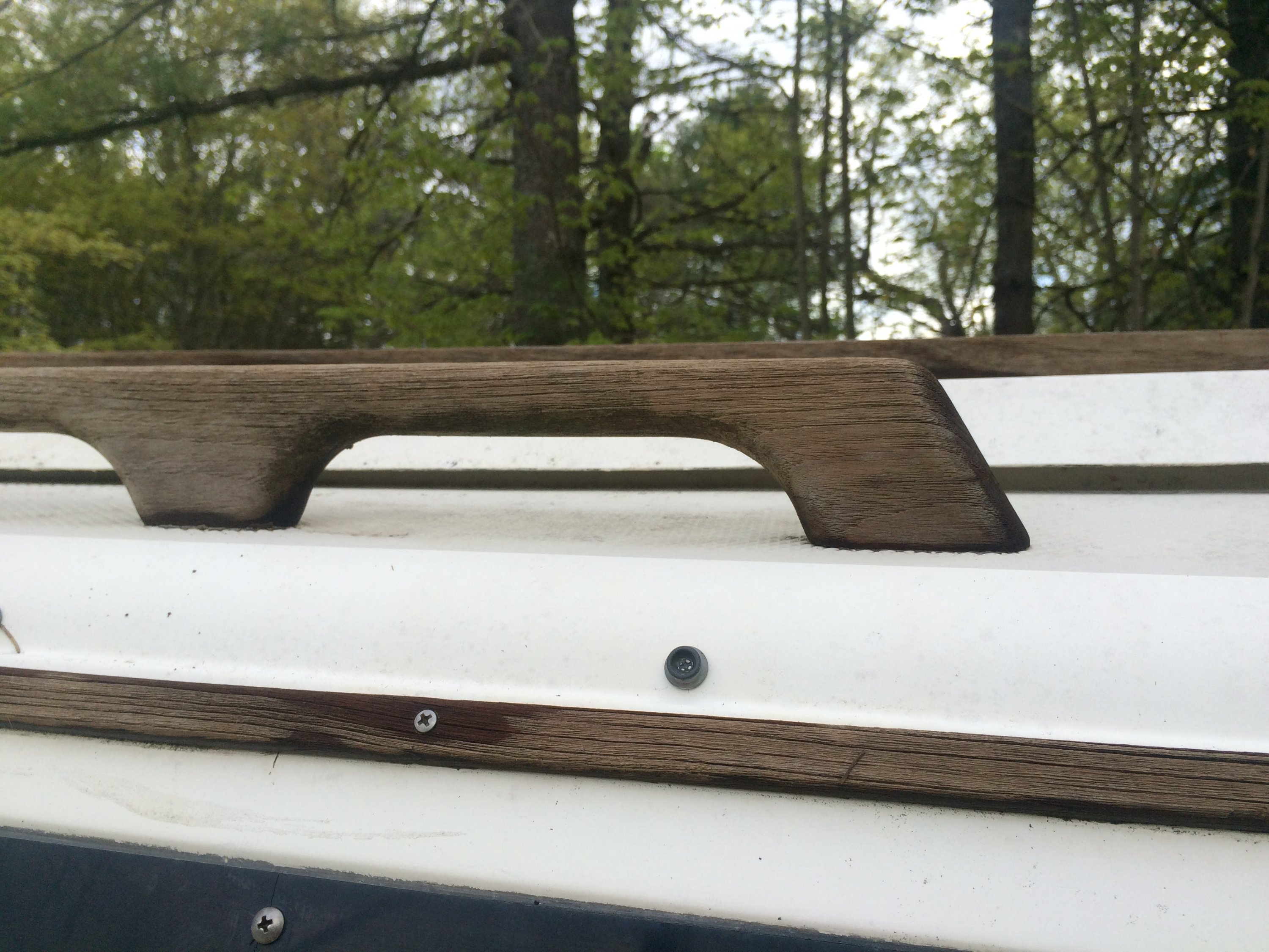

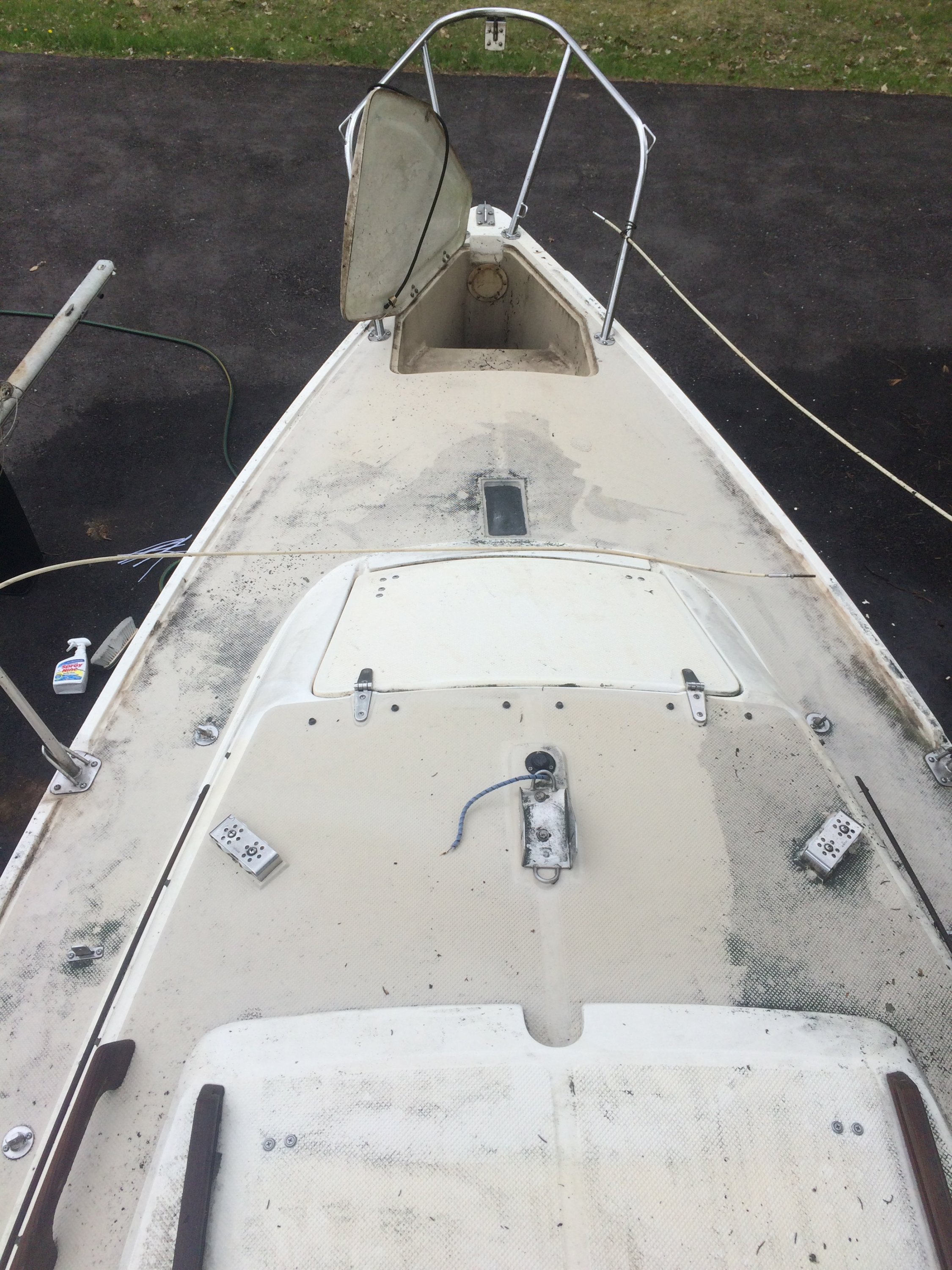

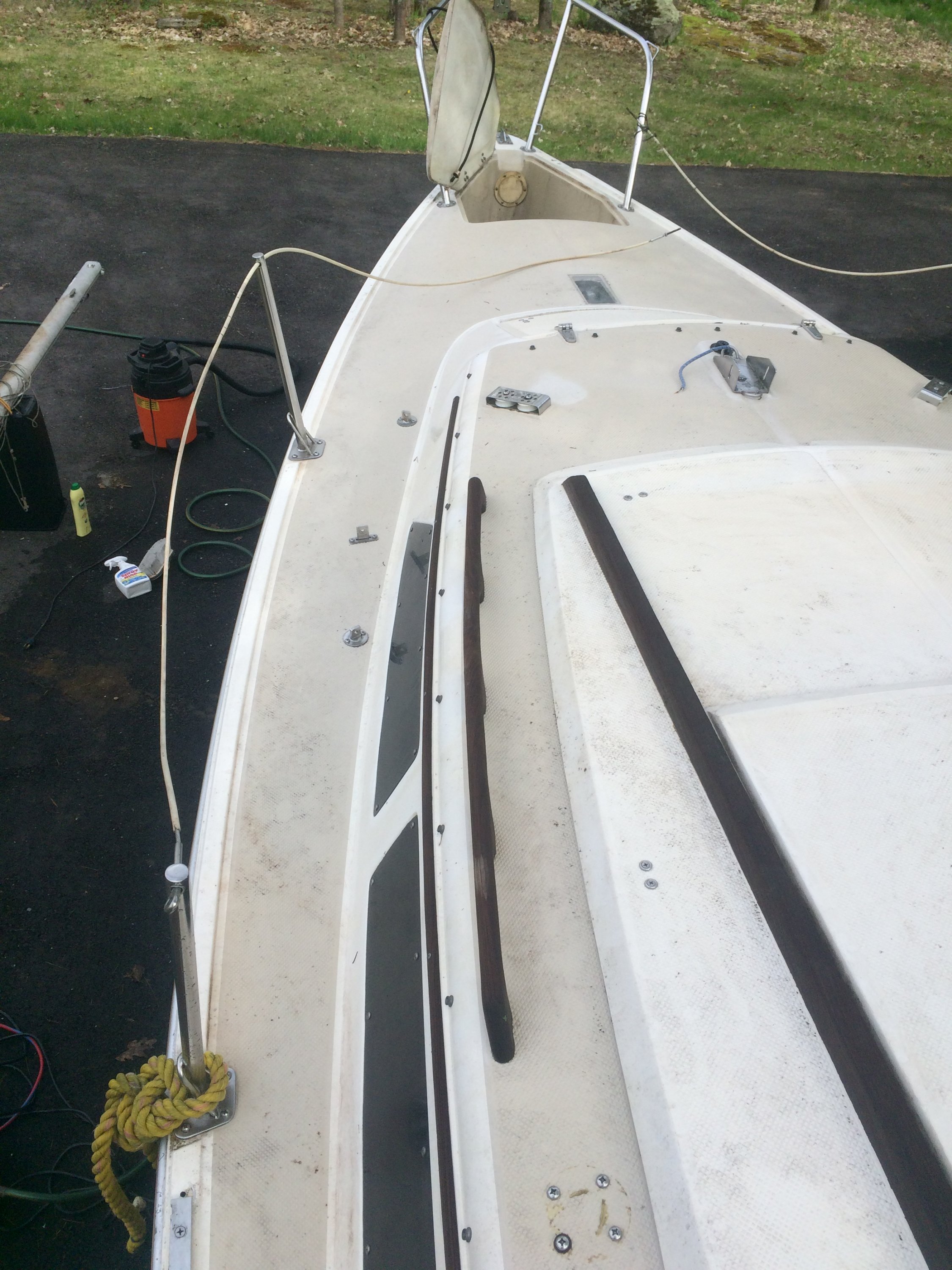

Washed the boat today with the power washer and it looks amazing. Still have some scrubbing to do but I can't believe what just a power washer will do. There was a bit of scrubbing done in the cockpit but I didn't scrub the rest at all.
I have joined the National C22 association and paid for the download of the tech file. Still need to download it though. The internet here is terrible.

Looking good !
That teak looks salvageable. :)
@CloudDiver did a post that explains using epoxy and varnish/cetol etc. To refinish teak and fill the surface.
My neighbour used that method to salvage his teak. It filled the surface and helped hold it together/prevent splitting.
Maybe some here has done the same ?
Jul 13, 2015
931
Catalina 22 #2552 2252 Kennewick, WA
definitely save that teak-- nothing that can be rehabbed quite nicely there.....good looking boat.

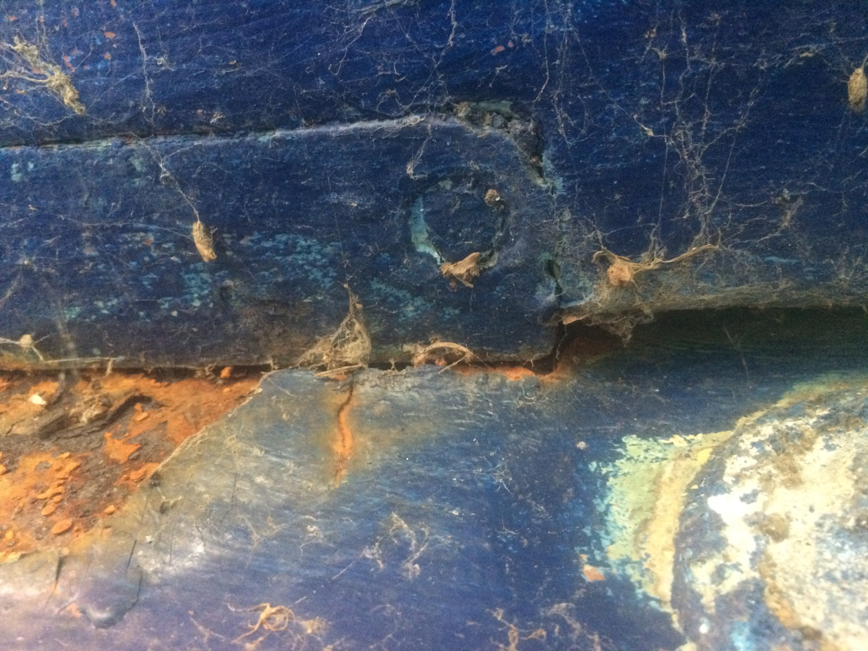

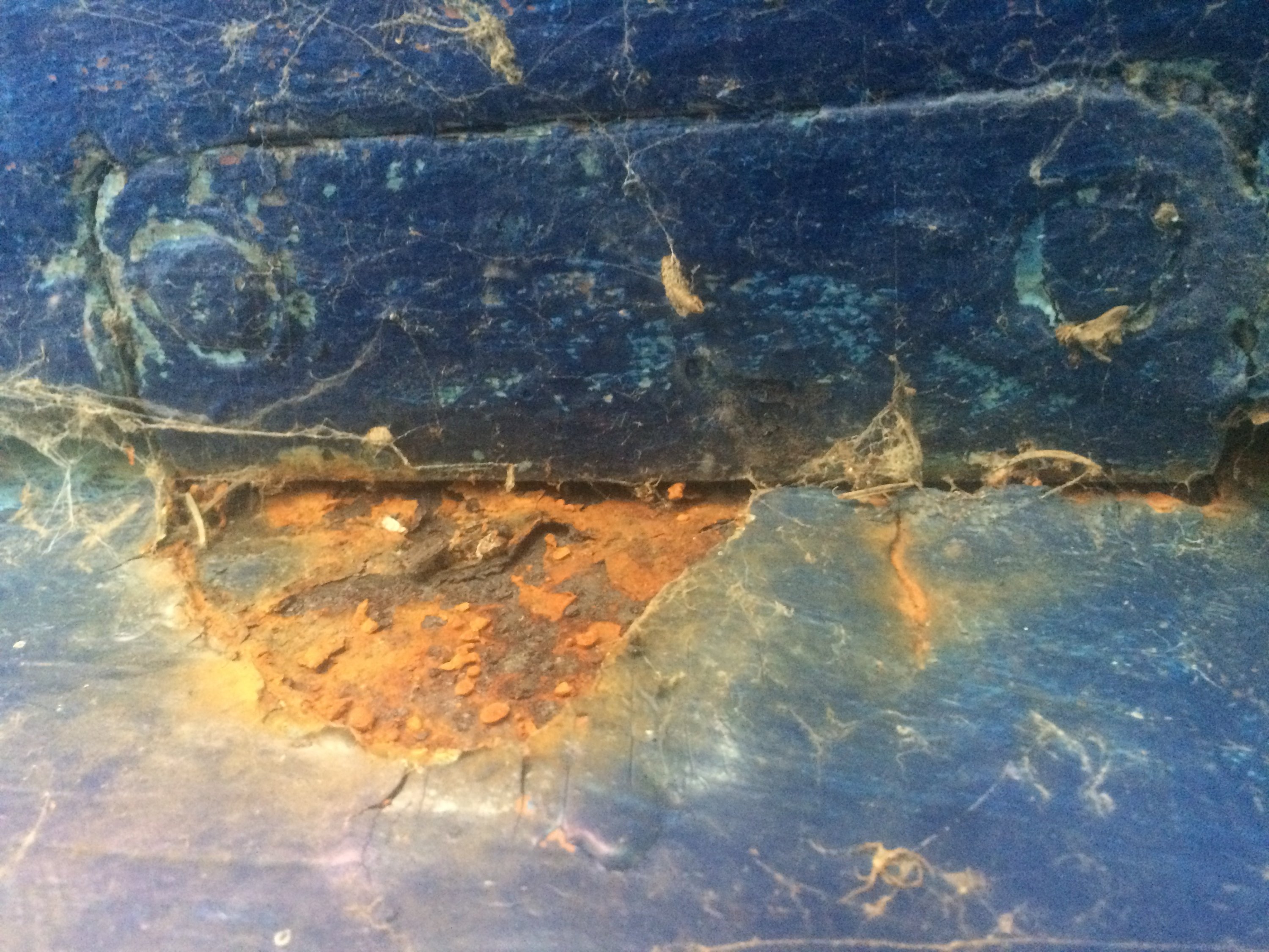

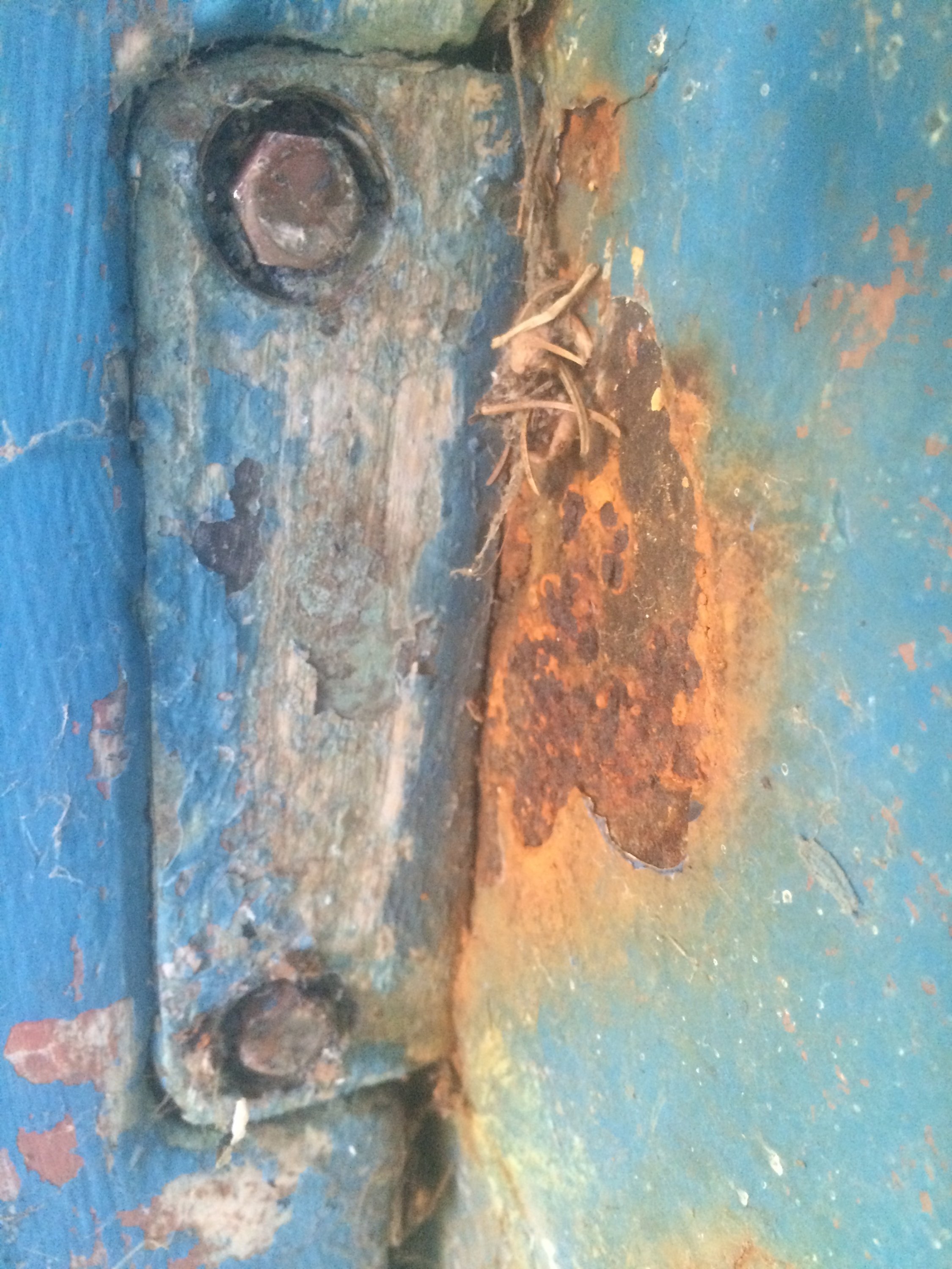

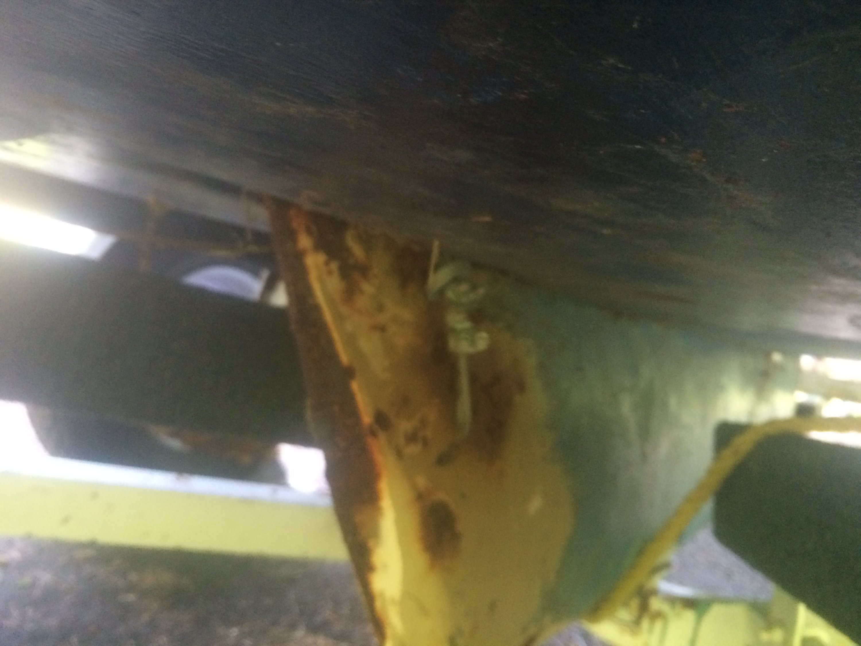

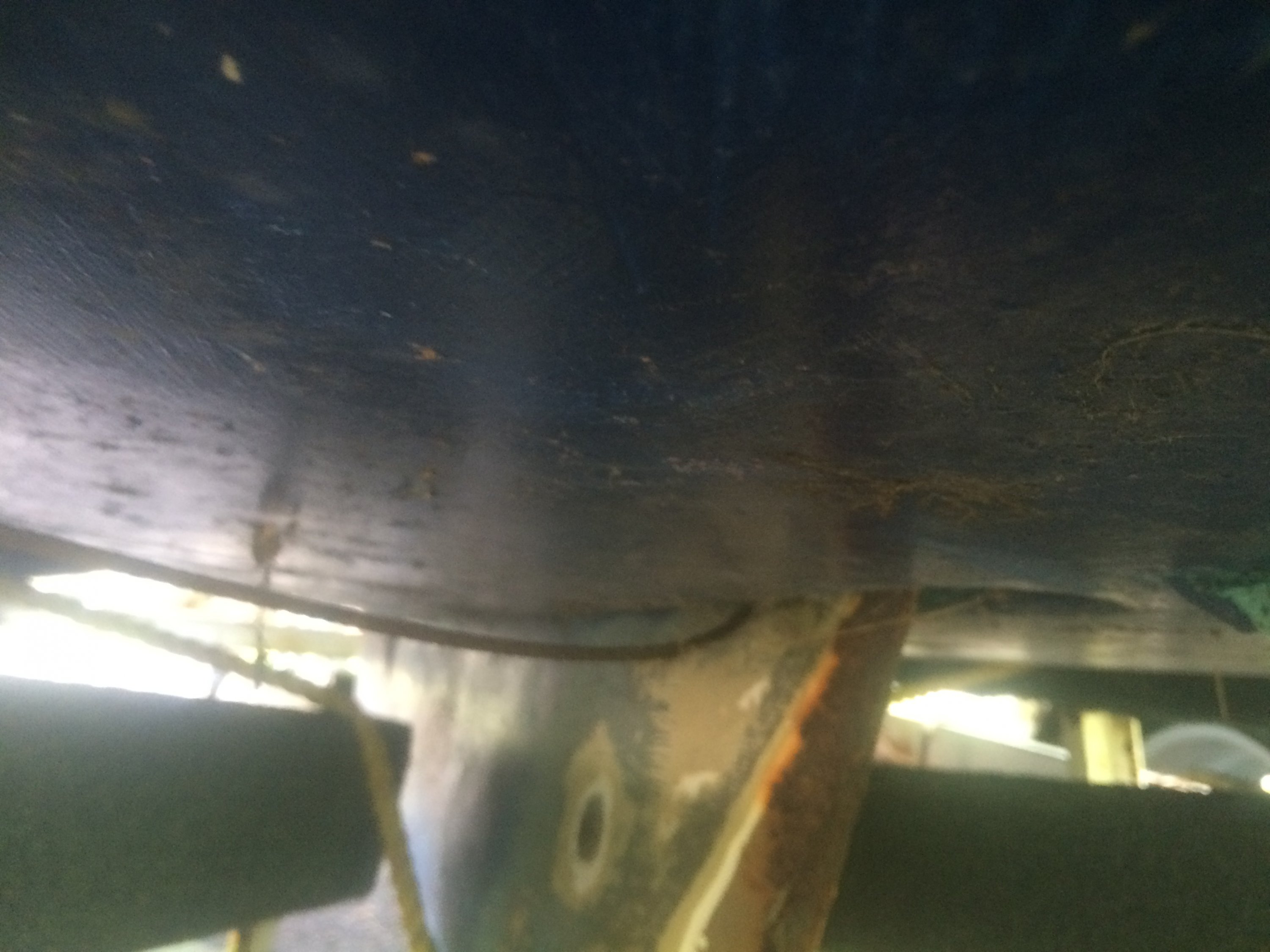

So I got underneath the boat today and got a good look at the keel and keel hanger. It looks to me like the CD oversized blocks are already in and hopefully the centering kit also but I can't see in there. I also tried to loosen the hanger bolts to make sure they weren't stuck. 3 turn so smooth it's like a fluid filled camera tri-pod. One of the bolts is very tight and I'm afraid of breaking it. I got it to unscrew about 2 turns and then went back in. The bolt is now easy to turn for the first two turns and then tight again.
Do you think this is corrosion or loc-tite? Should I try heating the bolt or just try to undo it and hope for the best?
I also got a look at the keel locking bolt, it turns but I tried to take it out and it stopped turning before I could get it out. Not sure if it's bent or just corroded.
Here are some pics of the keel hangers and a couple of the mess that's left of the lifting cable and hack job by previous owner.

Don't rush it with the keel hanger bolts. A liberal spraying of PB Blaster every couple days. Don't waste your time with WD-40. GREAT stuff, just not penetrating oil, (the "WD" stands for water displacement). Worked it back and forth like you're doing, and keep spraying them. Looks like someone filled the area around the bolt holes in the hangers with epoxy. Pick all that out to make sure you're not trying to turn the bolts against some left over piece of epoxy. But, in the worst case you break off the bolt. NO BIG DEAL! Weldments are easily replaced, especially on the new design boats like yours. The factory already knew this could be a maintenance issue and designed the interior for easy access and replacement. Just one of the MANY improvements the factory made on these models. Plan on replacing the keel hanger bolts anyway, and their replacements are not at Home Depot, Lowes, or Ace Hardware. Buy the correct bolts and save yourself problems down the road.

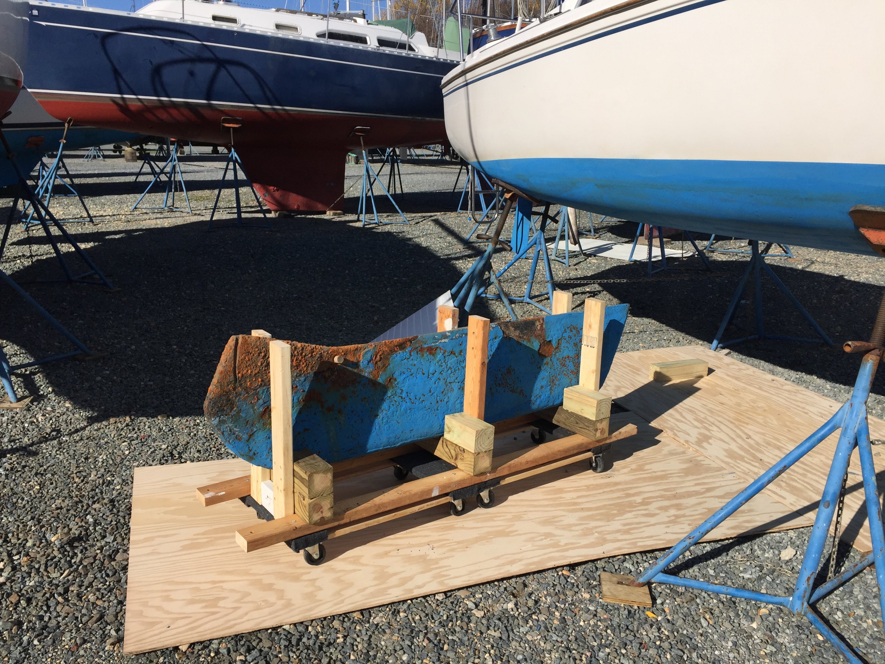

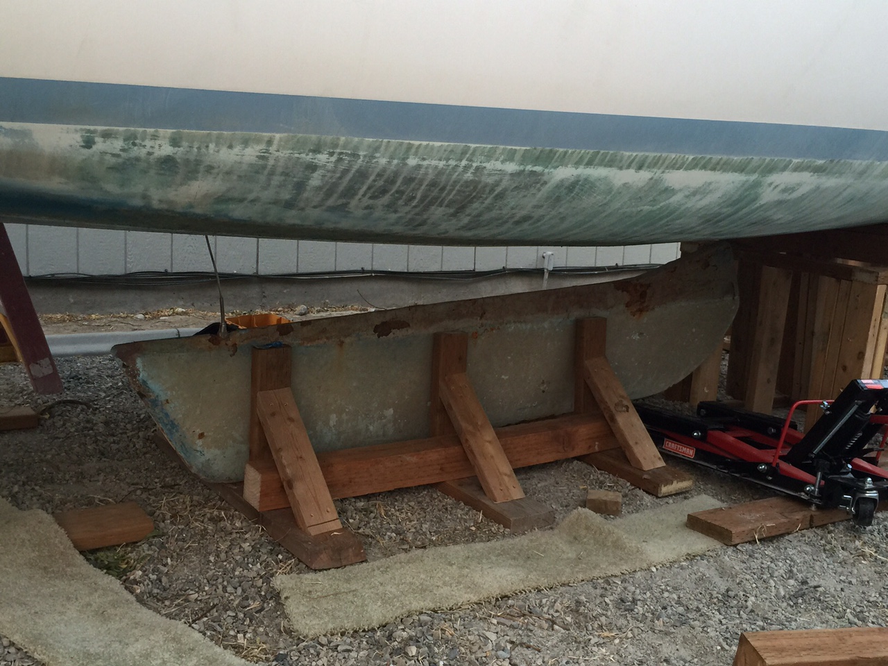

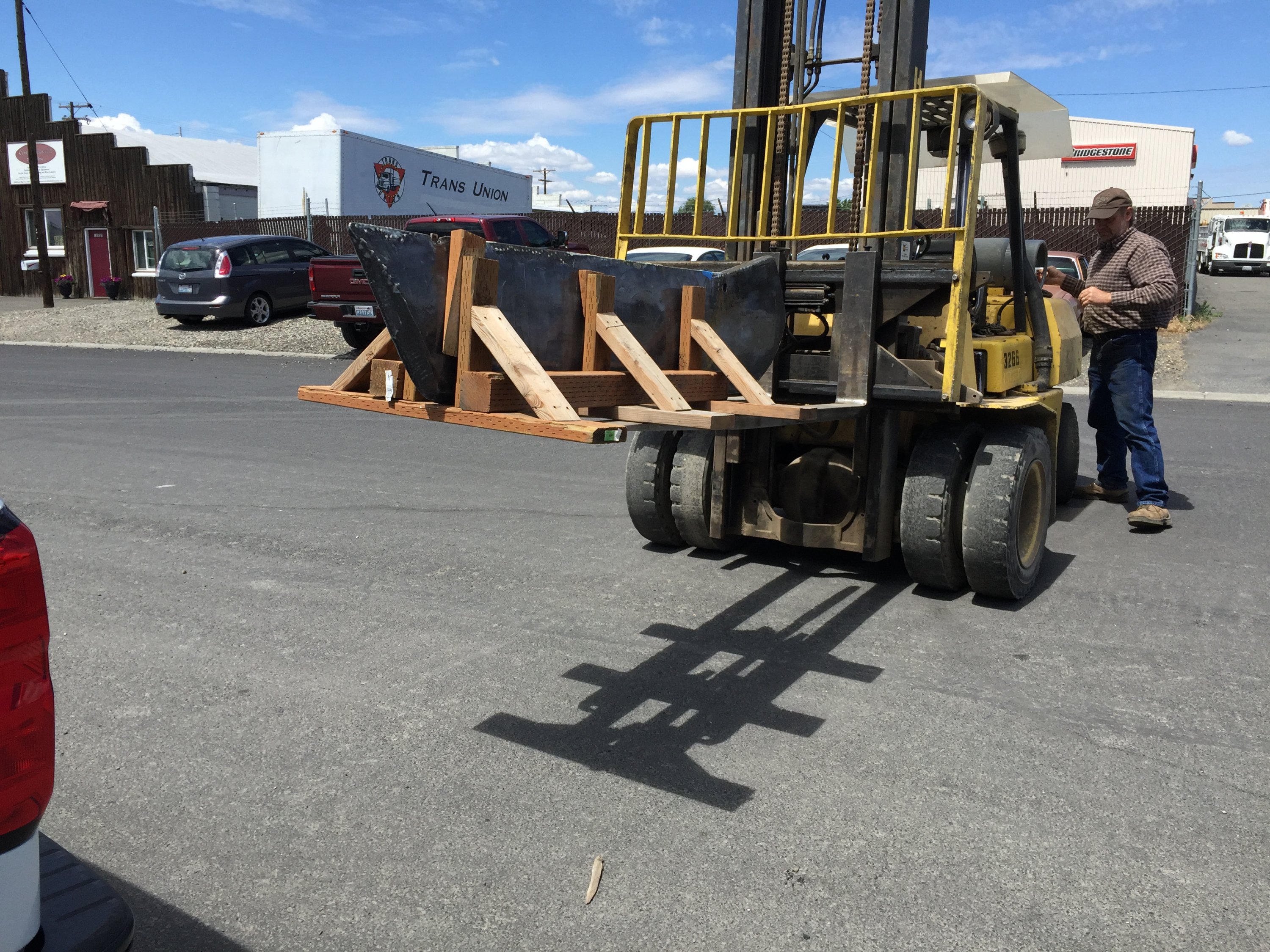

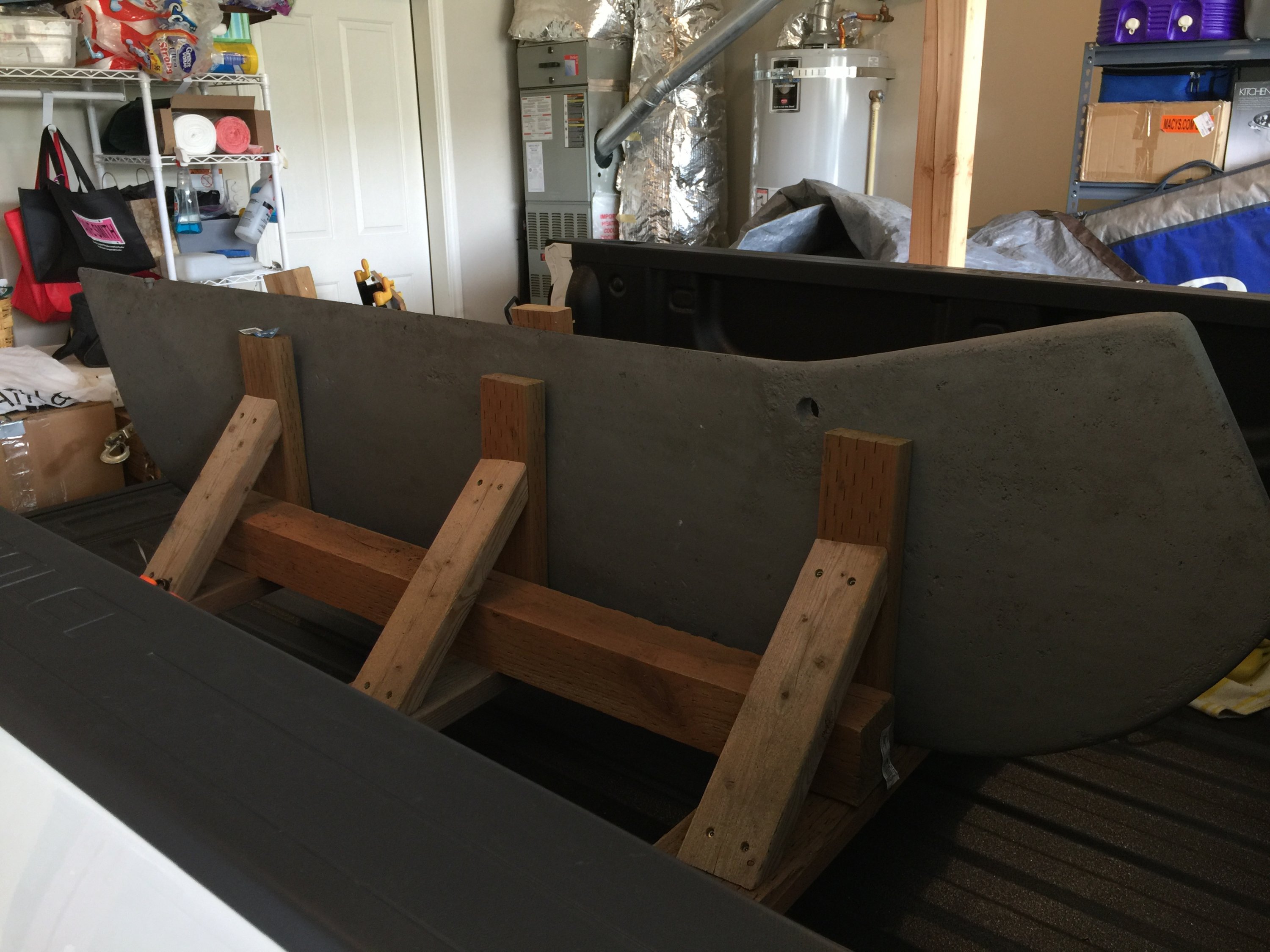

Does someone have a cradle design I can look at? It would really help me out.
Many Many good versions of a keel cradle out there-- designed for everyone's particular needs and circumstances: CloudDvier / StingySailor / RJD and many others have posted pics of theirs throughout their build forums as well.
Attached are a few shots of mine-- used scrap pieces of dimensional lumber and screws. I may add casters to it for re installation later this summer, and as you can see this one has been fork lifted successfully more than once as well.

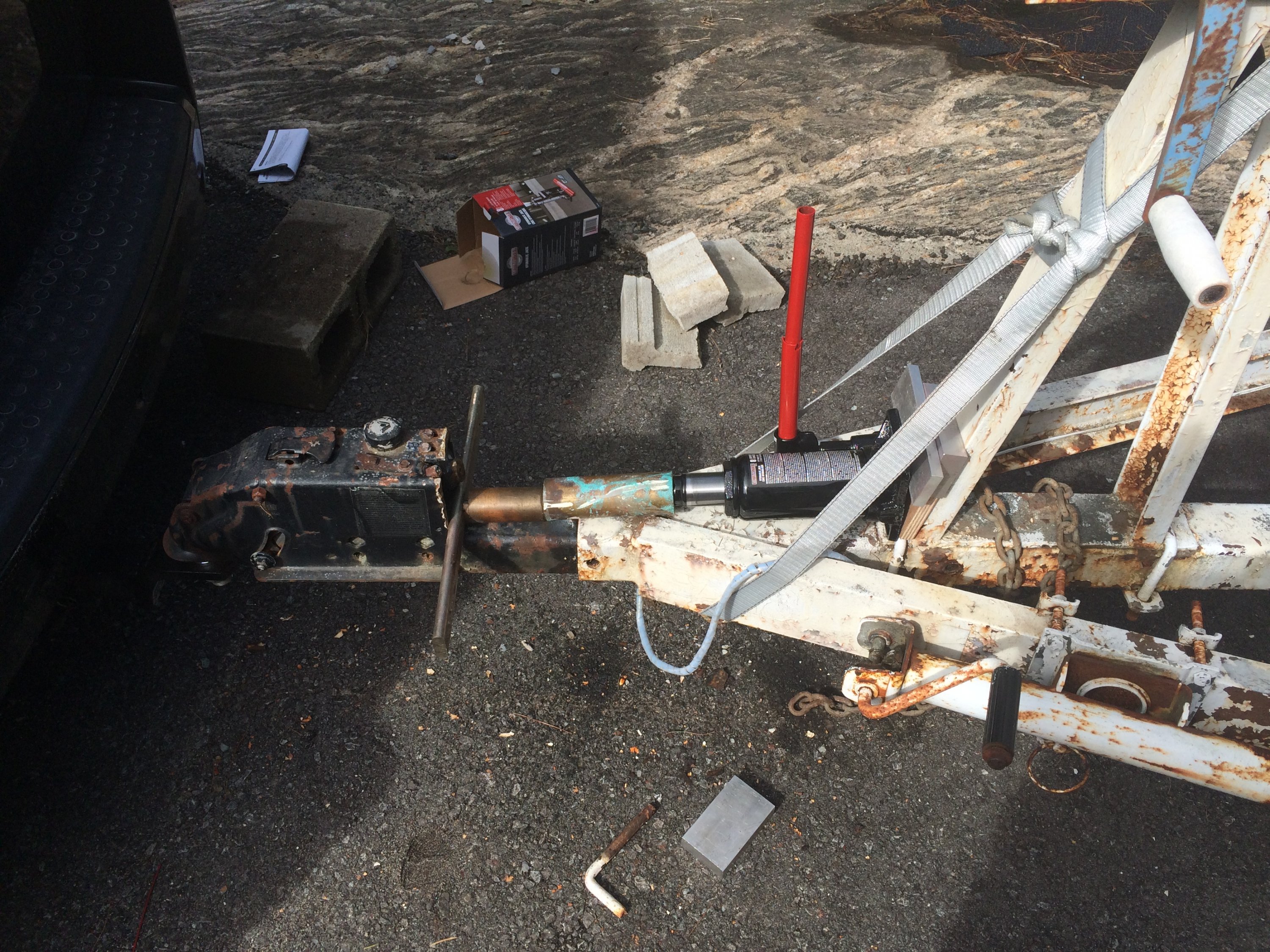

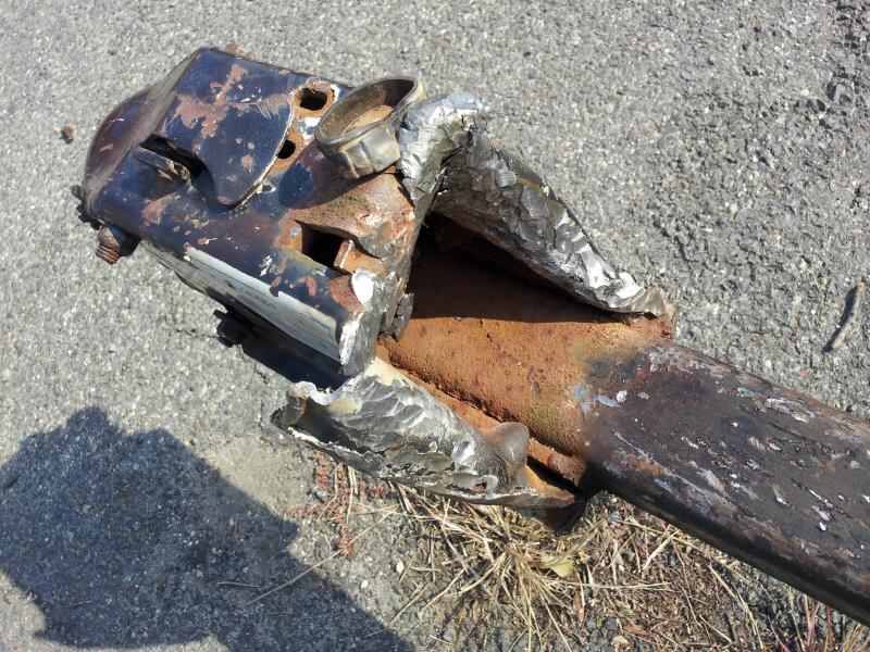

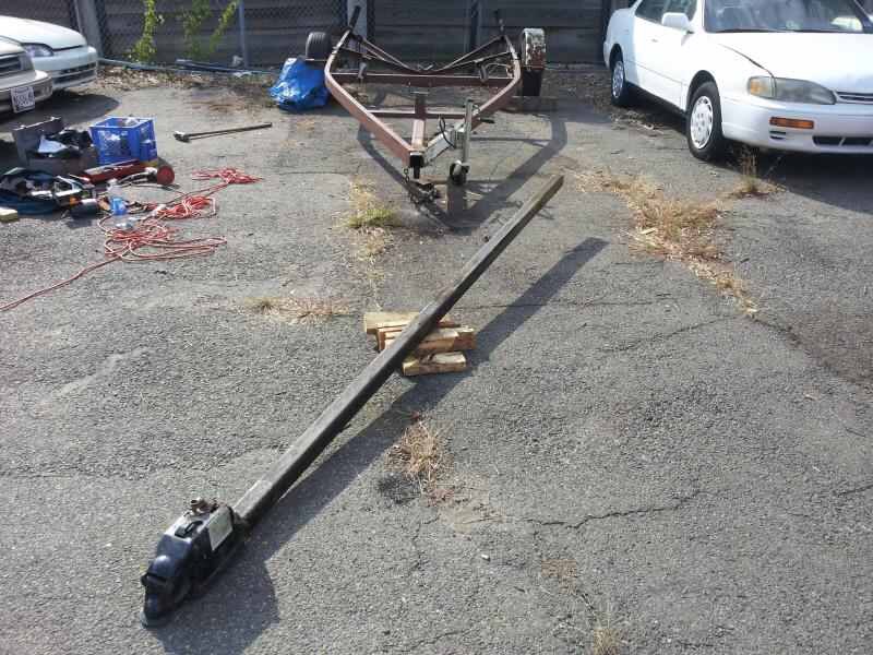

Like really stuck. I've been spraying as much penetrating oil in it for 2 days, tapping with a hammer and smashing on the brake system (which is garbage) with a cinder block then a sledge hammer.
I bought 2, 10,000 lb winch straps and used one to tie the back end of the trailer to a tree from both rear corners of the trailer. Then I used the car as an anchor and tried to winch the tongue out. No luck.
Then I attached the largest vehicle we have (dodge minivan) to the trailer and tried to pull it out with that. The wheels just squeeled and nothing happened.
I'm not sure what to do now. I am tempted to cut the extension so I can just get the jack under the front but would really prefer to get the tongue out.
I saw in the forums that others have pulled it out with a truck with the trailer tied to the tree but I'm afraid I'll break the trailer somewhere else and have a real problem.
Any advice would be really helpful

I tried heating it also but couldn't seem to get enough heat in it to even warm the tube really.
I'm thinking maybe a larger bottle jack between the winch upright and the back of the brake system with a block of wood between?
I just hooked the van up to it and went back and forth fairly with the trailer attached to the tree letting the momentum do most of the work. I got the thing to move about 1/32" lol. I am going to spray more penetrating oil on it, tap it a bunch with a hammer and try again in the morning.

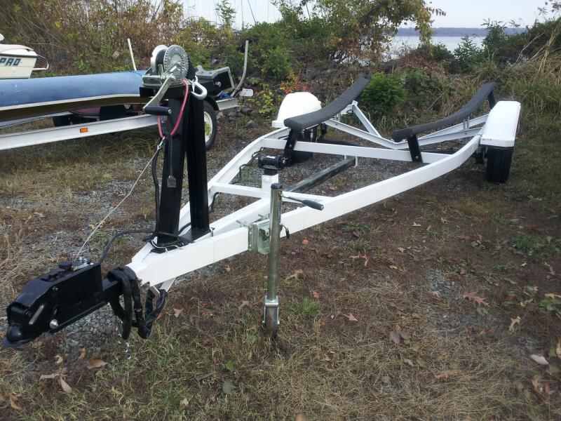

RJD
Aug 31, 2013
144
Catalina 22 Chesapeake Bay, Deale, MD
I sprayed Sea Foam Deep Creep down the aft of the channel and then lowered the trailer jack so that it oozed forward. The next day I was able to beat the extension out with a sledgehammer but destroyed the surge brake in doing so. Later had a welder cut it off and weld a new one on.

I got the tongue out :-D
I used a bottle jack against the upright for the winch and the back of the brake system. Worked really well I was surprised how easy it made the job. I had to smack it with a small sledge hammer at first. When it started moving the upright I stopped and hit it and it was easy from there on. Once it was about a foot out I used the sledge hammer from there as it was just faster. Here's a pic
