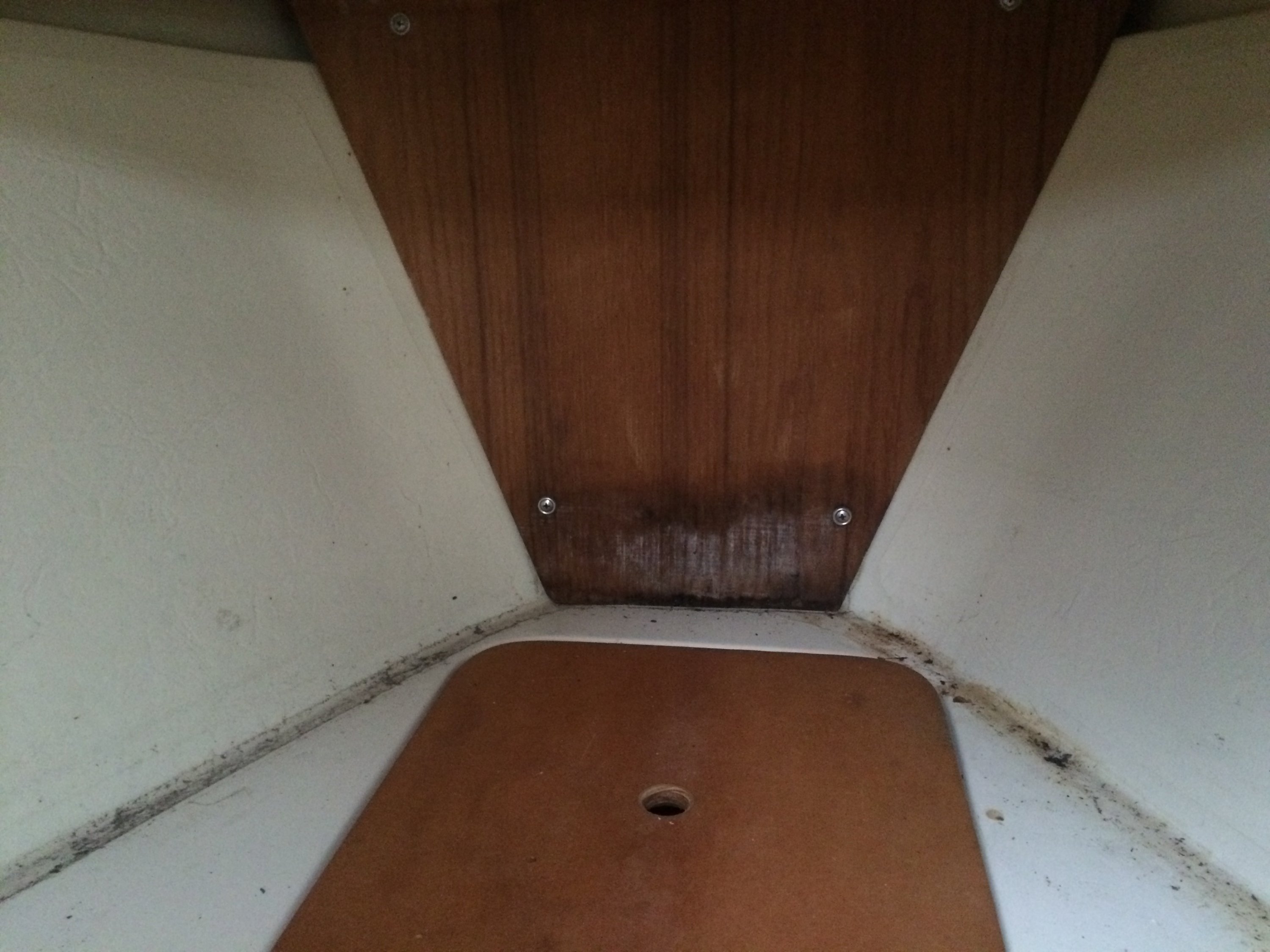

Hi, Just picked up a 1987 Catalina 22 Swing keel with pop top. I need a bit of advice as the boat is a project and a bit rough. There are some issues with the swing keel that have me concerned. I'm just getting into keel boats and thought this would make a good starter boat. I don't really know much about keel boats really but I have done some research and also have experience with small power boats like ski boats with outboards etc. Here are some of the good and bad things I have seen so far
The Bad:
- The boat was sitting for 5-10yrs and really neglected so it looks terrible and has things growing on it.
- The swing keel lifting cable system is not working. The cable snapped and it looks like someone replaced the cable but didn't attach it to the keel. Makes me think the eye bolt in the keel is missing or broken.
- The boat was in saltwater at least part of its life

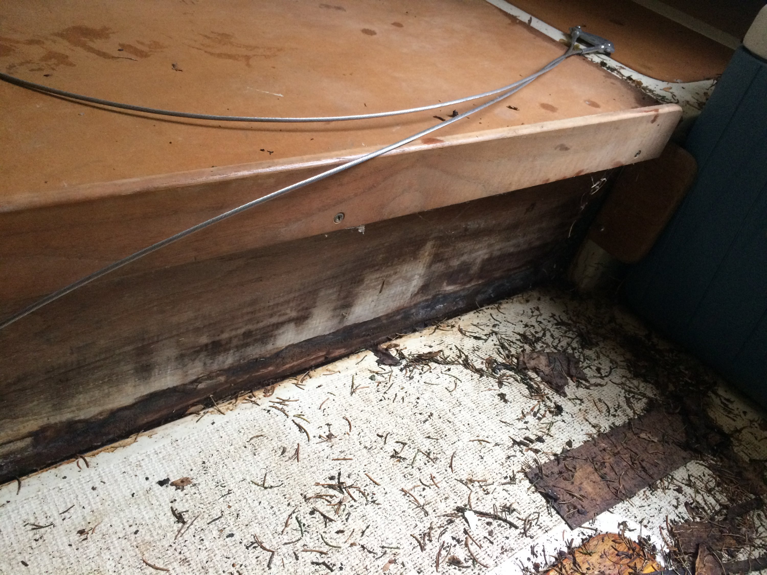

- There is some water damage to a lot of the wood partitions inside the boat. The wood outside is pretty bad but might be able to be saved.
- missing winches for the jib (only the 2 near the back are there the 2 on top of the cabin were removed)
- a lot of the lines need to be replaced or are missing
- holes in the boat where gauges used to be
- mast was stored on the ground and was buried in leaves and dirt. Lifting line for the sails was out of the mast and in bad shape.
The Good:
- The boat seems really solid. I had a 220lbs friend walk around on the deck and there didn't seem to be any soft spots or a lot of flexing anywhere. The boat isn't sinking into the trailer at all lol.

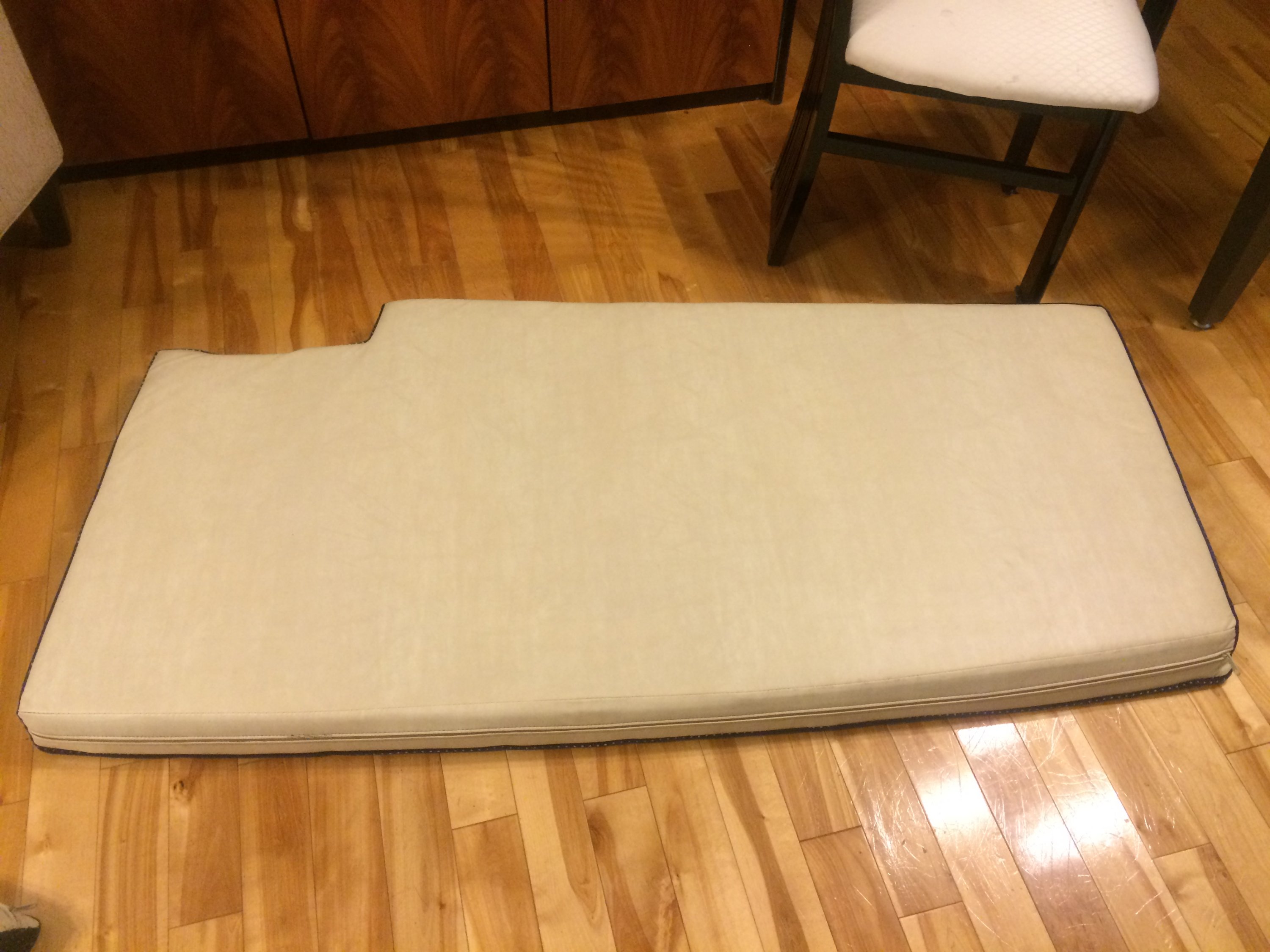

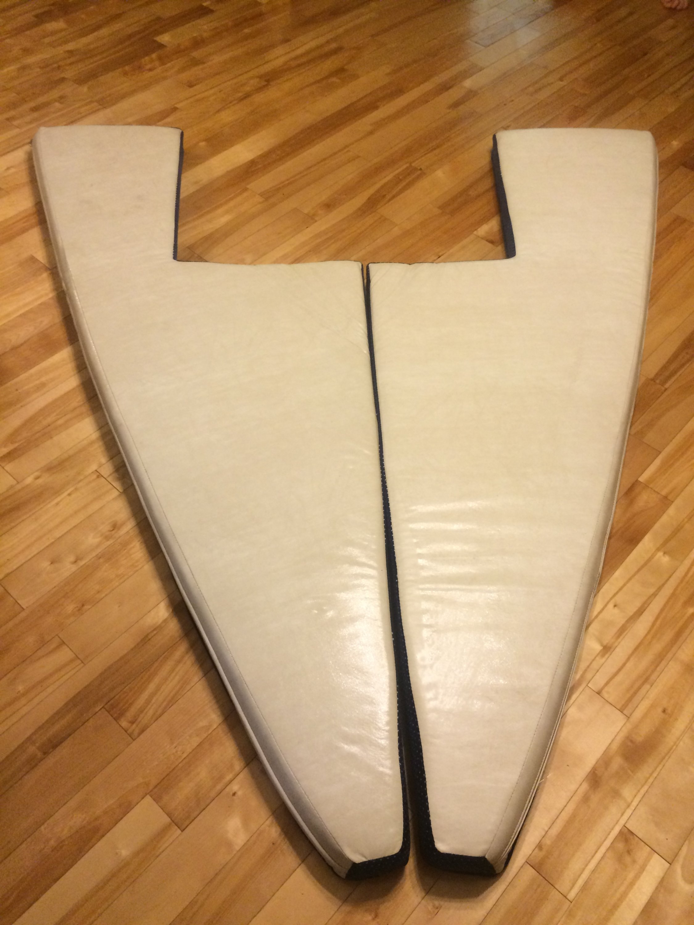

- The interior cushions are all in really good shape, a bit dirty but nothing a steam clean won't fix
- Trailer is pretty good with brand new rims and tires
- there is very little water streaks on the inside of the cabin
- no cracks, bubbles or damage to hull
I love the boat and am excited to own it. However, have some concerns about the keel issues and the overall expenses of getting the boat fixed up. I have been looking at posts online and think the keel hinge pin should be serviced as well and possibly replaced with the Catalina Direct kit that fixes the wear issues.
Is the keel repair something that I can do myself? Is it expensive to get someone else to do it?
I am capable of cutting all the wood parts that need replacing and shaping them to fit. What kind of wood should I use? Just marine plywood or is there something more specific? Is there an easy way to save or redo the trim on the edges of the bulkheads?
Aproximately much is new rigging lines all around?
Aproximately how much can I buy a new style 22 in good condition ready to sail for?
Thanks for any advice and help you can give me, it's much appreciated.

We've seen worse. Lotta elbow grease and reading up on appropriate cleaners. The teak & holly potion of the sole looks OK, don't know how that survived while the other wood got damaged.
I used to have a swing keel, but never had to service the keel wire. There are great guys on this forum who can walk you through it. The keel doesn't look all that bad.
You can get a manual online from one of the guys here or a search here or the C22 Association website and figure the running rigging costs easy.
You'll have to redo the simple electrical system, completely.

Water damage to the interior wood bulkheads/panels:
My own 1987 model had water damage to the bulkheads. It was less that yours, but I replaced them anyhow.
I gently removed the wood nosing/trim with a mallet and block of wood. I made new panels out of plywood and stained them to look similar to the original teak veneered plywood.
You should use marine grade plywood or similar that uses waterproof glues for the layers of wood.
The plywood I used wasn't marine grade, but I was told by the supplier that people use it for boats here all the time.
Check my thread for photos.
( I used the opportunity to modify the galley in my boat when I re did the bulkheads)

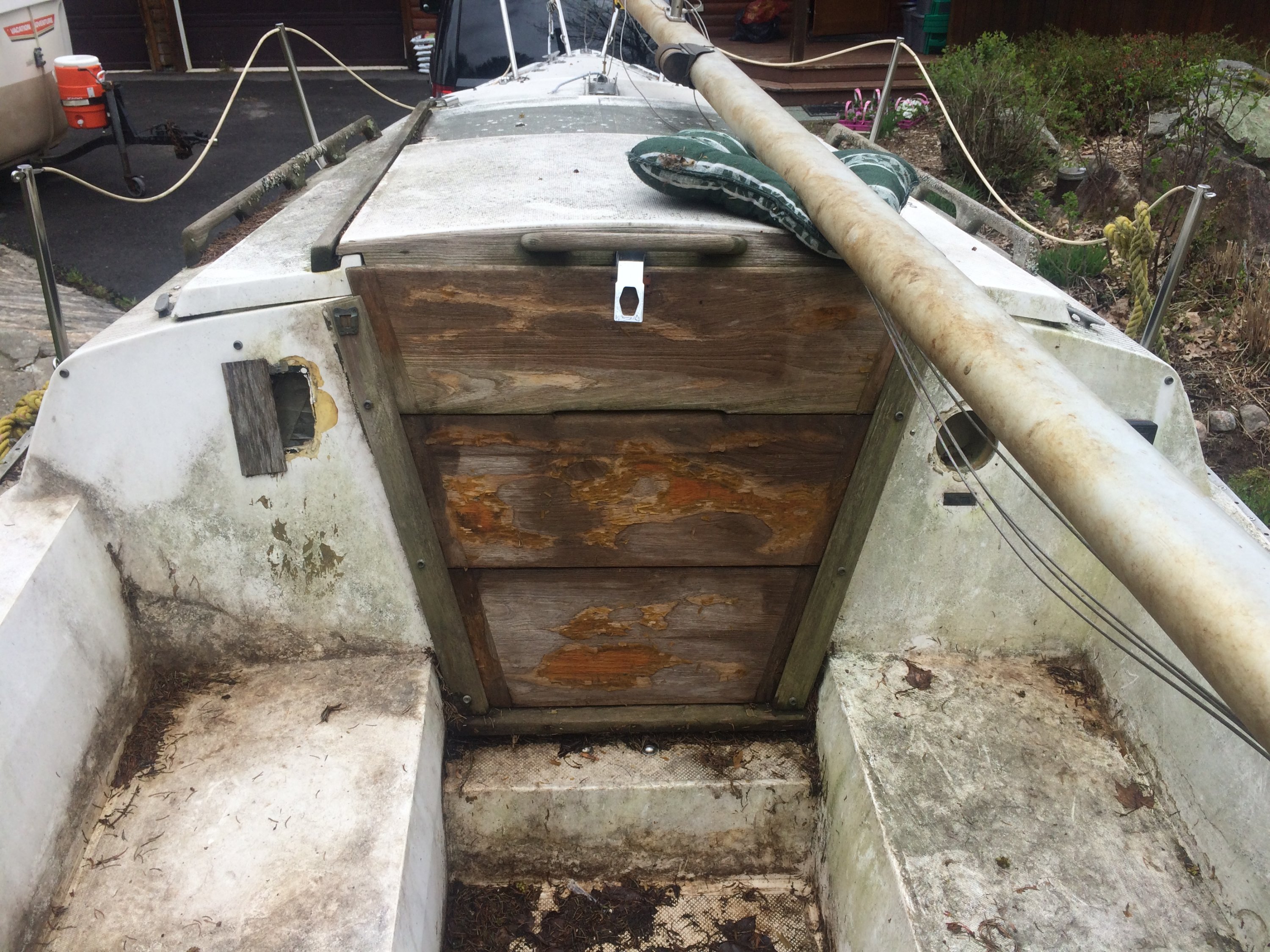

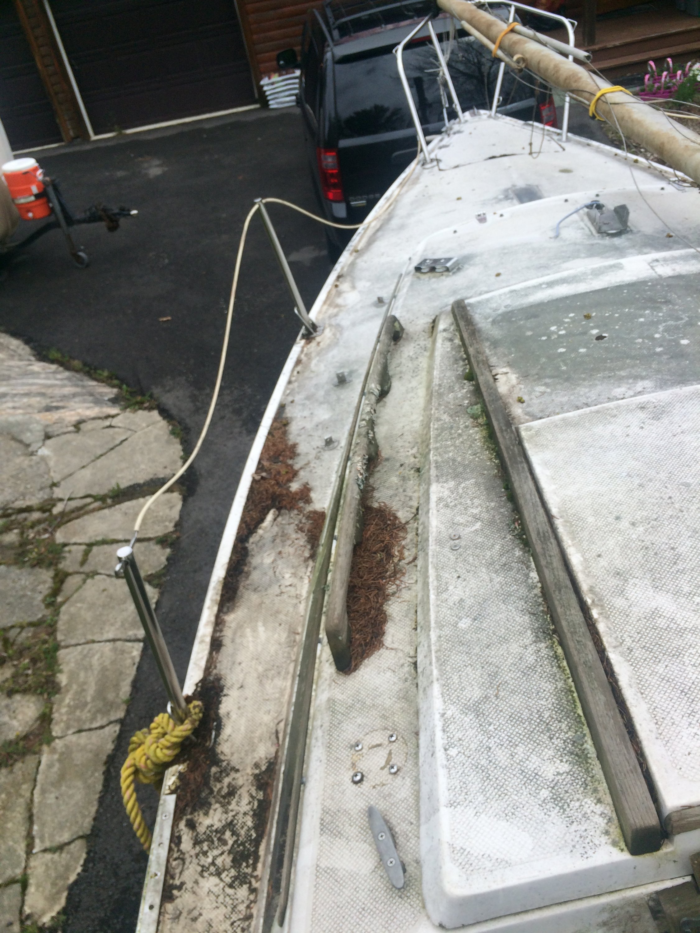

Exterior wood: It actually appears to be salvageable in the photos. As long as the teak isn't rotten, or split you should be able to simply sand it and refinish it.
The cabin/pop top winches, which are for the halyards (lines to raise the sails) could be purchased, but they really aren't needed. Many C22 owners don't use them. You could simply epoxy fill the mounting holes if you wished. (the rear winches on the cockpit coaming/sides are the ones used for the jib sheets to adjust the jib)

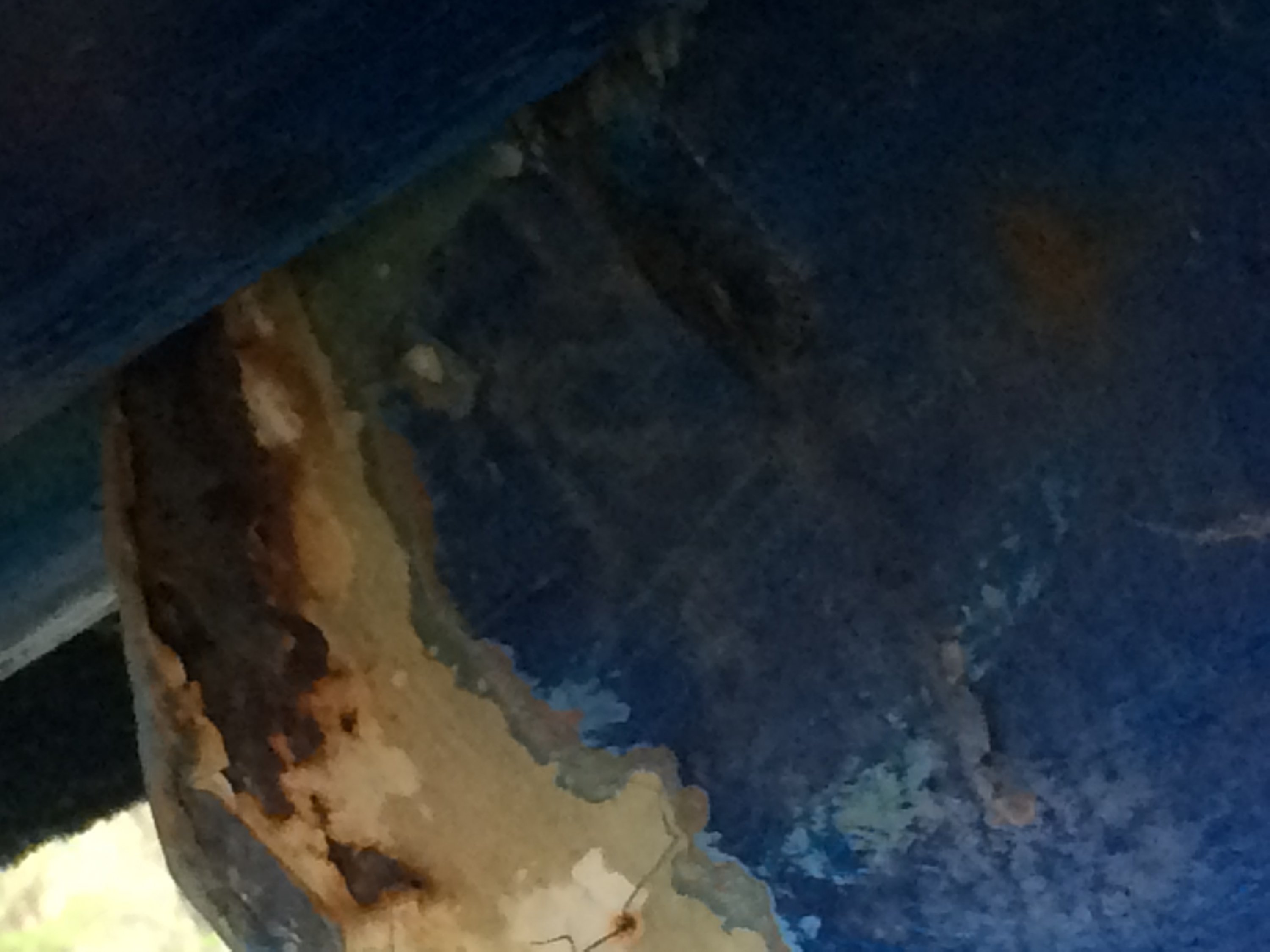

Keel:
Can't see much since the keel isn't dropped or removed from the boat.
But it definitely doesn't look as bad as some.
There are lots of thread threads here where people have repaired various parts of the keel system.
Can you post close up photos of the pivot etc ?
Deck coring:

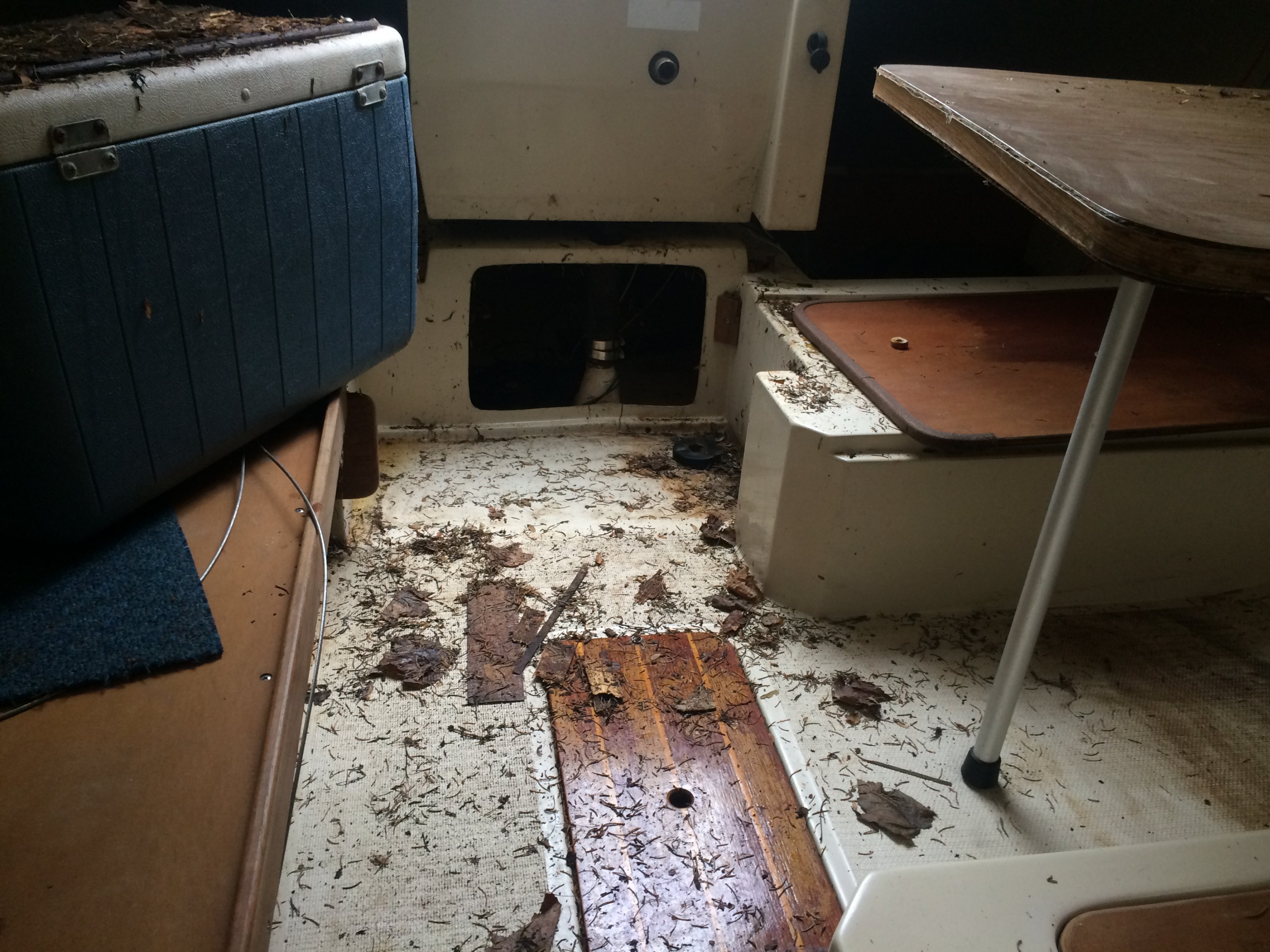

I'd be worried that the deck coring is damaged, but only detailed investigation will tell the tale.
I got lucky. Other than the sliding hatch, the core on my boat seems fine. I'm "potting" every hole in the deck, and re bedding the hardware/teak as I remount it. I'd want to do that
That small plastic window/deadlight in the deck was leaking on my boat, and it's design will trap water so it can soak into the deck coring. I'd check it out. (see my thread for some photos to get an idea of why it can trap water.)
Based on the photos, I'm assuming it was stored outside for years ?
I'd be really worried about the coring where the holes were cut into the rear of the cabin for instruments.

I'll start with two words... DAY UM!!! Is that two words or just two syllables?
First off, I agree with what everything Roy said above and thanks for the props.
Reefsider, I'm going to assume you might want to get some sailing in this summer rather than just do work like I have for the last year and some change... so here's my advice on getting the boat sail ready with minimum expense. You may not believe it, but the boat will look 1000% better after two weekends of work.
- Strip everything you can off the boat, inside and out, but its not necessary to take off complicated things like the bow and stern pulpit or any of the bedded hardware.
- I'm sure you have a Wet-dry Shop Vac... remove all the interior wood carefully, label everything. Remove everything from the interior of the boat that would be sensitive to water, and but that Shop Vac to work sucking out all that junk....
- Get a pressure washer. Not a huge one with a motor, and electric one will do fine. Something you rent for a day or weekend will do the trick. To clean out the interior use a solution of simple green first, that will get the majority of the gunk and dirt. Suck out the water with the shop vac and keep a fan going for constant air flow. Follow up the scrubbing with some bleach to address mildew because I'm sure there is a bunch. If you have stains on the gelcoat worry about it later, wiping with acetone can resolve that.
- On the exterior, it might be a good idea to tape up areas where water might get in like around the companion way. Don't worry about taping off the windows or deck hardware because with these you'll want to know if they leak or not. Get yourself 2 or 3 bottles of Clorox SoftScrub with bleach and stiff bristled scrub brush. Give a good pre rinse with the pressure washer and then go to town with the soft scrub on every surface. Let the cleaner sit on the surfaces for a while to let them work, scrub it twice... then power wash off. You will be AMAZED at how clean you will get everything. Like the interior, stubborn stains can be wiped with acetone.
- For that mast and boom that look horribly discolored... Find a welding supply store in your area if you can. Ask for a metal cleaner/degreaser/de-scaler that has phosphoric acid as it active ingredient. This is a common product that is just a mild acid solution, it is not dangerous to use just don't spray it in your eyes, LOL. Anyway, just put your mast on a set of saw horses and wet it with water. Spray the solution on the aluminum and let it sit for a few minutes (but always keep it wet), then lightly scrub with a scotch brite pad. Do this at least 3 times, the longer you let it sit and act the cleaner you will get it, just always keep it wet and fully rinse off with fresh water when done. Your mast will look almost new.
Sep 8, 2014
2,551
You'll feel way better when you have a clean hull to work with. On the interior wood you can just give it a light sanding. Some oxycylic acid (wood bleach) can help get rid of the water stains but you might not want to even bother with that if you are going to replace them with new wood anyway. as long as the wood isn't delaminated or totally rotten you should be fine. You can just put a couple coats of Cetol on it to freshen it up and put it back in the boat. Do the same with exterior teak. Only remove it if it is leaking and needs to be re-bedded. otherwise, sand it in place and apply several coats of Cetol.

For the keel, you should be able to just drop it down enough to get to all the rust spots. Wire brush them as much as possible and apply a rust-converting spray on primer. then touch up the bottom paint.

First things first: Hang onto that cooler if you can! They don't make them like that anymore, and the new ones are not nearly as sturdy. Same goes for the garbage can, if it still has one. You will never find another one like it. ;)
Then, the first thing I'd do after initial cleanup would be to remove and rebed all the deck fittings, whether they appear to be leaking or not. IMHO, that is the most urgent item on your agenda, if you are at all concerned with the long term.

@CloudDiver : thanks very much for the info, I went out today and bought some things for the clean up. Apparently Clorox soft scrub is a US thing so I got spray nine and vim cream.
Washing the boat tomorrow, it's been very cold here until today (it snowed a bit the past 3 days :0 ). After that I'm going away for a couple weeks and won't have time to re-bed the hardware till I get back.
Is there anything I should do to store the boat over the next few weeks? Maybe cover it with a tarp and leave everything open?
