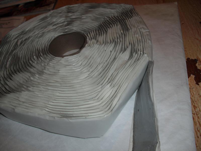

Hi Mainsail, I tried to ask about butyl tape I have from a previous job, if I can use it to bed deck hardware. I had trouble posting a pic so I did it on the discussion forum. I will try to put it here...There we are, I think I got it. Not so good on the computer...Thanks Red
Hard to tell just by looking at it. 1/16" thick works better than 1/8" and it should be very stretchy before breaking. Cheaper RV tapes are not as good as architectural grade tapes. From the picture it looks like an RV grade but really impossible to tell. All you can do is try it. Worst case you have to do is re-do it..

Well Mainesail,I normally would go with my gut, however I removed my mast this year and am planning to re- bed everything on my deck, and, after all this work, and expense I would be an idiot to cheap out on butyl tape.I ordered 2 rolls this morning.I do not mind the work, however I don't want to do it twice, thanks for your input. Red

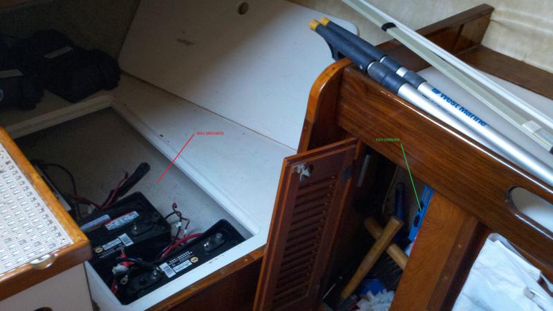

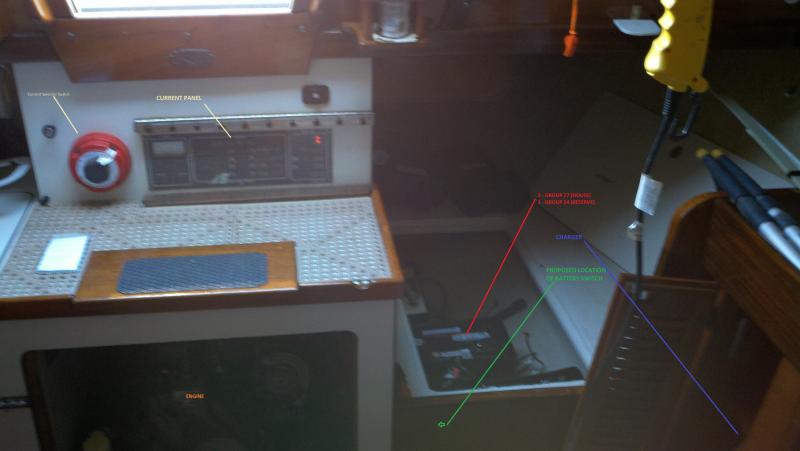

Mainesail,
As you know I'm in the middle of some rewiring this winter. Besides replacing my 28 year old charger, I'm needing to bring the battery fusing up to par. for I'll be adding fuse blocks, a positive buss, battery monitor (Victron) and a new battery switch and upgrading the wiring sizing. I'll be also upgrading the wiring and possibly relocating my bilge pump (rule 2000) since the wire run is close to 25 feet one way due to the routing of the wire.
Regarding the battery switch; the previous switch (Guest 4 position) works well but is too long of a battery run from the starter, batteries, etc when taking into account the round trip.
My question at this point mostly has to do with locations / layout. I'm looking to replace the battery switch with a Blue Seas 4 position switch closer to the battery bank. (Not sure if I need an alternating Field Disconnect) I'll be cutting a hole into the battery compartment making a flush mount installation, which puts the switch low but closer to everything it needs. Do you think the pictured location makes sense? Should I worry about the back side of the switch? The batteries will be tied down, assume there is no regulation that prohibits this since I see many boats like this.
Also, in the battery compartment I think I have enough room to install the shunt and the battery fusing under the lip of the battery compartment, next to the battery switch. This would be my preferred location since it minimizes wire runs (meeting the 7" requirement is somewhat of a bear but think it can be done).
Currently my negative bus is in the engine compartment next to the battery compartment. I'm thinking of leaving it there.
Currently my ACR is in the Battery compartment, wired with 4 GA wire. it works well and might leave it there unless otherwise need to reduce wire runs to the fusing.
The fusing and positive buss will be under the lip in the battery compartment. I got 19" on one wall and 9 " of length on the other wall to work with, with a height of 12" and about 5 " of clear space between the walls of the battery compartment and the battery boxes. I'm thinking this is a good location. Any suggestions? I only ask since I noticed you have mounted yours on the hull side.
Where the old battery switch is now located, I'm thinking of putting a teak cover over the hole to mount the Battery monitor and a Rule dedicated switch for the bilge pump.
Some side notes, I do not have external regulation, and only a 35 Amp alternator on my Yanmar 3GM. My battery compartment narrows pretty good limiting space for my 2 group 27 and 1 group 24 (reserve).
Sorry the pictures are fussy.
Let me know what you think, positive or negative.
Thanks again - Neal

Mainesail,
Great idea!
An AFD only works f you can interrupt the field wire for the regulator. Most often this will require an external reg unless you want to dig into the alt. A far easier solution to prevent fried diodes is to simply run the alt to the house bank. Fuse and a "service disconnect" switch would be needed.
Nothing wrong with that at all just protect the wires from chafe and accidental short possibilities.
7" is the suggestion but don't lose sleep over it. On many boats it is next to impossible to achieve. If the wire run is 12" and perfectly safe then put the fuse at 12"..
If it works why move it..
I've got a trick you may like and will try and upload a pic later... You basically mount an MRBF to the ACR. Kills a few birds with one stone..
If you have room that's where I'd mount it. Many compartments lack room so the hull side with a back plane can work well.
That will work well..
Your alt is a tad undersized but will work. If it fails look into a larger Hitachi like the 60A model..

Great idea!
[/FONT][/COLOR]
Your alt is a tad undersized but will work. If it fails look into a larger Hitachi like the 60A version …
I am planning to run my alt directly to my house bank on the rewire, and have been doing that for years with the ACR so I'm good here, I'll fuse it as in your example. Assume 35 amp alt would use something close to a 35 amp fuse. I'll properly wire it for a future upgrade (maybe this summer) to an 60 amp alt, but fuse it accordingly. I'm at a dock on shore power mostly so a bigger Alt never been a priority expect for the occasional trip.
As I lay everything out, mine is 12", so I won't lose sleep.
Think I know what you mean, never thought about it but I guess you need to protect the wire from the ACR to the reserve battery both ways - meaning a MRBF on the ACR and the reserve would cover this. I'd like to see your pic either way.
off to Genuinedealz to order some wires...
