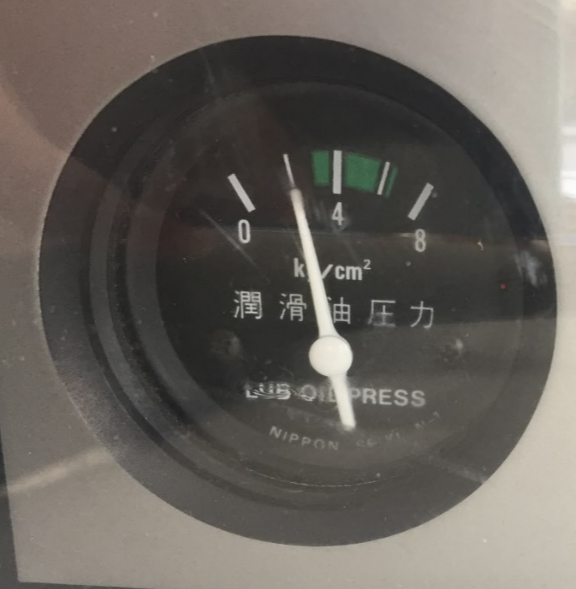

I have the same engine as you have Terry on my Passage 42 (4JH2-TE Yanmar diesel, 93). Does anyone know what the oil pressure range should be on this engine. Found the service manual on this site, but it does not say. The gauge reads low 2 kg/cm2 at idle and almost 3 at higher RPM's. Not in the green area, but no alarm. The green area of the gauge is from 3 to 5. It has 15W-40W oil in it 3/4 full. Do I have anything to worry about? Should I increase the oil weight to say 20W-40W to increase the pressure? Recently purchased the boat and figuring things out.
Thanks for the help.

Hi Jeff,
The first thing I'd do is verify the accuracy of the gauge, ideally by unscrewing the pressure sensor at the engine and screwing in a known-good gauge. If the readings match, then you can take steps. If you can't or don't want to do that, at least confirm that the electrical connections between the sender and the gauge are all in good shape.
