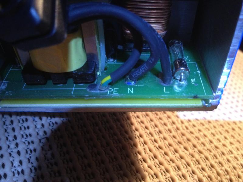

Hi MaineSail,
We are installing a Victron Blue IP20 15amp universal charger. It arrived with what appears to be a European plug which isn't a big problem since the plan is to hard wire the charger in. The hiccup we have is deciphering hot/neutral and ground on the board. Victron's english documentation leaves a lot to be desired and support even less so. So the question is do you have any idea which is which in the attached photo?
This is replacing an old ferro-resonant charger and naturally the goal is to do it right the first time.
Thanks,
SC

sailcruiser said:
Hi MaineSail,
Thanks,
SC
Well after more time with Google it appears the Dutch use the following:
PE=protective earth
N=neutral
L=hot
Does this look correct?
SC
PE=protective earth
N=neutral
L=hot
SC
Yes that's correct.
L = Line or Hot
N = Neutral
PE = Earth Ground or Protective Earth Ground
