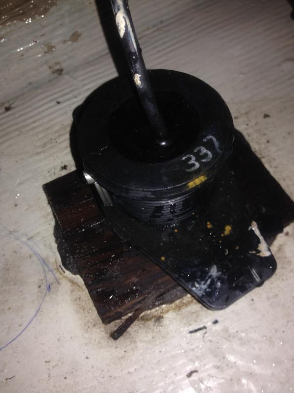

Got it MS. So have you ever seen a shaft log made from a thru hull fitting? Is it ok to double clamp the stuff box hose to a thread?. It seems to fit fine and does have the screws to keep it from turning. The problem I am going to have getting the fitting centerline lined up with the center of the skeg so the shaft is down the middle instead of angled port or starboard.
The thread provides a red carpet for water to get around the hose end. That is, unless your hose seats all the way to the bottom of the threads or you otherwise fill in the threads, there's a continuous, unblocked path from the wet side to the dry side.
The PO covered the threads with 5200 and slid the hose all the way to the nut....plowing a mound of 5200 along it's way creating a seal between the hose and the thru hull nut. I had to slice the hose length ways to get it off.
