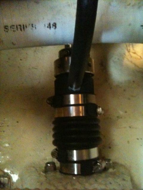

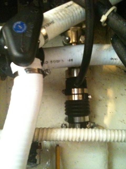

Motor Alignment when PYI dripless shaft seal is installed
Mainsail, I have a question. I need to re-align my Yanmar 2gm now that the boat has been in the water since April as I have vibration at 2200 rpm that I would like to eliminate. While on the hard, I installed a new shaft, coupler, strut and cutless bearing. The motor mounts are good. As expected, I found that the PSS with its recoil against the stainless rotor, applies too much pressure against the coupler to ck alignment. If I undo the bolts to the coupler from the output flange, the recoil presses the coupler hard against the output flange so that I can not get a feeler gauge to to determine if I have a mal-alignment. If I back out the set screws from the rotor to relieve the pressure against the bellow of the seal enough to back off the coupler, I will get water in the boat. So, when you have a dripless seal, how do you re-align your motor?
Feb 6, 1998
11,724
Actually the PSS applies the PERFECT amount of pressure. It is too light to cause any "out of alignment" to be masked/corrected and enough so you can accurately check the alignment without creating this pressure manually. If you can't get a .003" feeler in anywhere then your alignment is spot on. Run the feeler 360 around the flanges and if it slides in at any point there is your issue. Do not loosen the set screws on the rotor or you will need to replace them. Those set screws are a one time use. The shaft is far harder than those 18/8 volcano head set screws so after tightening them once you simply throw them away...
A vibration only at a specific engine RPM, like 2000, is often engine related not a shaft or drive-line issue. Alignment issues tend to get worse as the RPM goes higher and you rarely work through them...
jsgonz
Nov 28, 2008
49
hunter 28.5 Longbeach, Mississippi
The new coupler has an outpointing ridge in the center that is the male so to speak, to the output female flange and fits into the indented output flange that locks them into a fit. So with pressure, the two are unable to slide apart. So I think I am not getting a correct assessment of the alignment. When I loosen the 4 bolts they stay locked together. The vibration is greater as the rpm increases. I do remember that the alignment on the hard, was not intended to be precise. Do you think then that I need to get them apart? I do have spare set screws.
