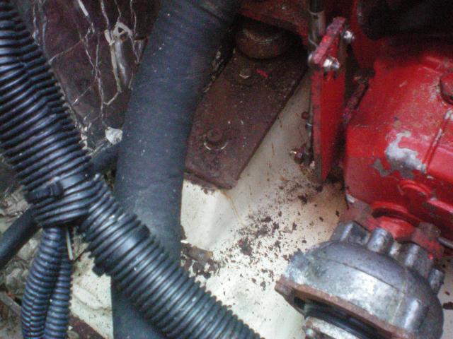

Motor mounts etc
Here is a picture of the supports for my motor, a betamarine 10. I'm not sure of the term really but I mean the metal bars that the motor mounts bolt to. The aft ends are pretty rusted. Enough that large flakes have come off. The front ends are almost rust free. The motor is only about 5 years old. Can you tell if this is a serious problem brewing or is this just par for the course? Should I try to remove this rust and treat with anything?
Nov 22, 2008
3,562
Endeavour 32 Portland, Maine
If I understand you correctly and you are referring to the metal plates which are attached to the to the of the fiberglass engine beds, yes, you a have a very serious problem developing which will need attention within the next 5 - 10 years. If you want them to look better and buy yourself a little time, look for stuff in the hardware store called "Naval Jelly" (Loktite makesa version). Wire brush as much loose stuff off as you can, then apply the jelly according to the directions, and follow up with Rustoleum. I suggest brushing rather than spraying.

If it is going to be a serious problem in 5 to 10 years then I won't panic. Preventive maintenance is a given. Any chance that rust converter might loosen the rust under the bolts and therefore cause things to start shaking even sooner? What would be the signs that I should have this looked at by someone professional ASAP?

If it were mine i would not panic but i would replace the metal. Having the mount come loose would result in more serious damage and costs. I would also look for a water leak. probably someting is keeping the metal wet. maybe the shaft is dripping a bit to much and slinging water arround in the engine room. Go down and look arround with the engine running and in gear ( with help on deck). Look for any water leak and fix that too. you may have someting dripping you dont know about.
good luck, its not as bad a job as you think.

another idea would to use a product called corroseal, great paint that will greatly inhibit rust. popular in restoration and comercial steel boats. you would need to clean them up first then coat the plates.
