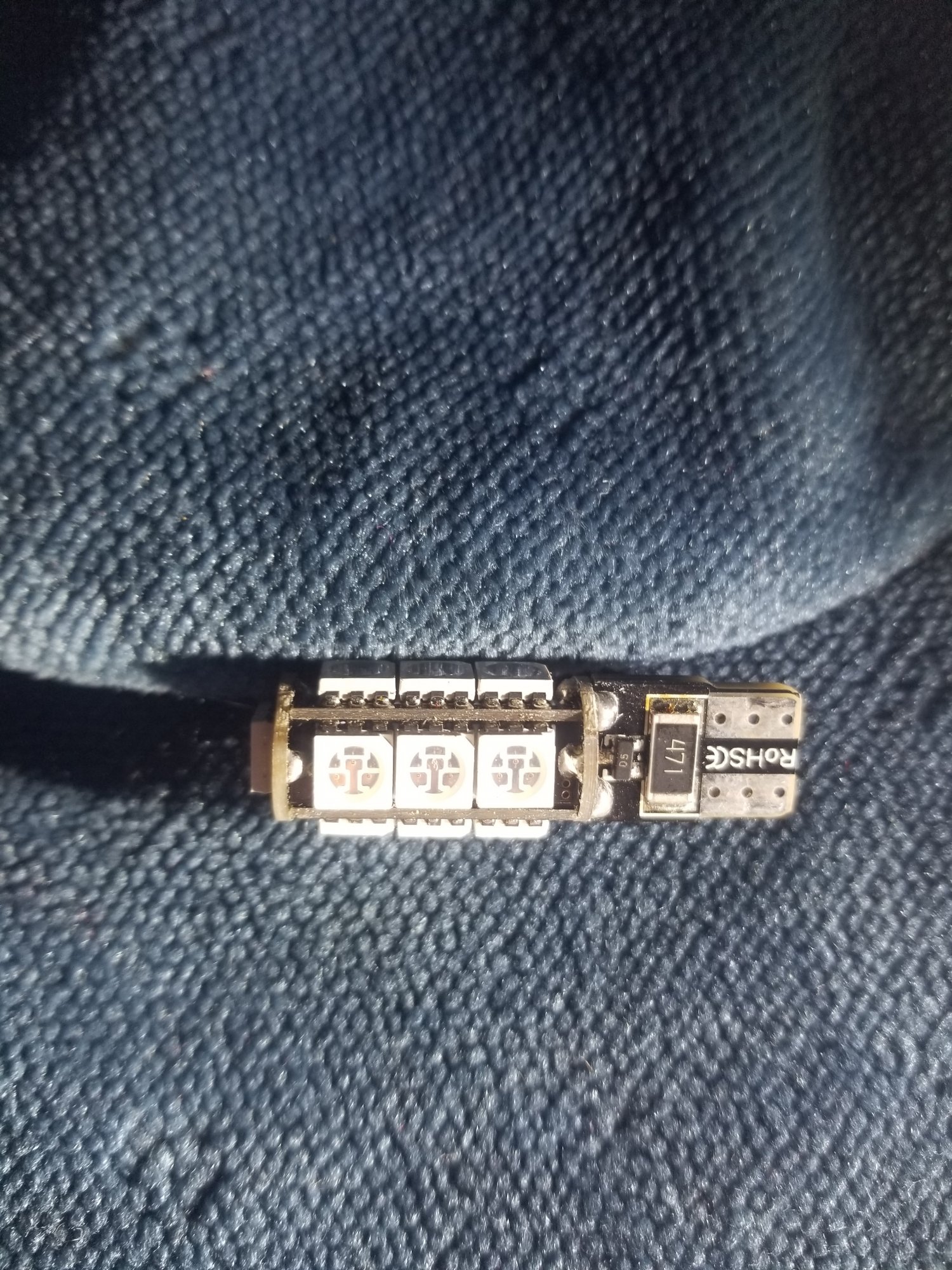

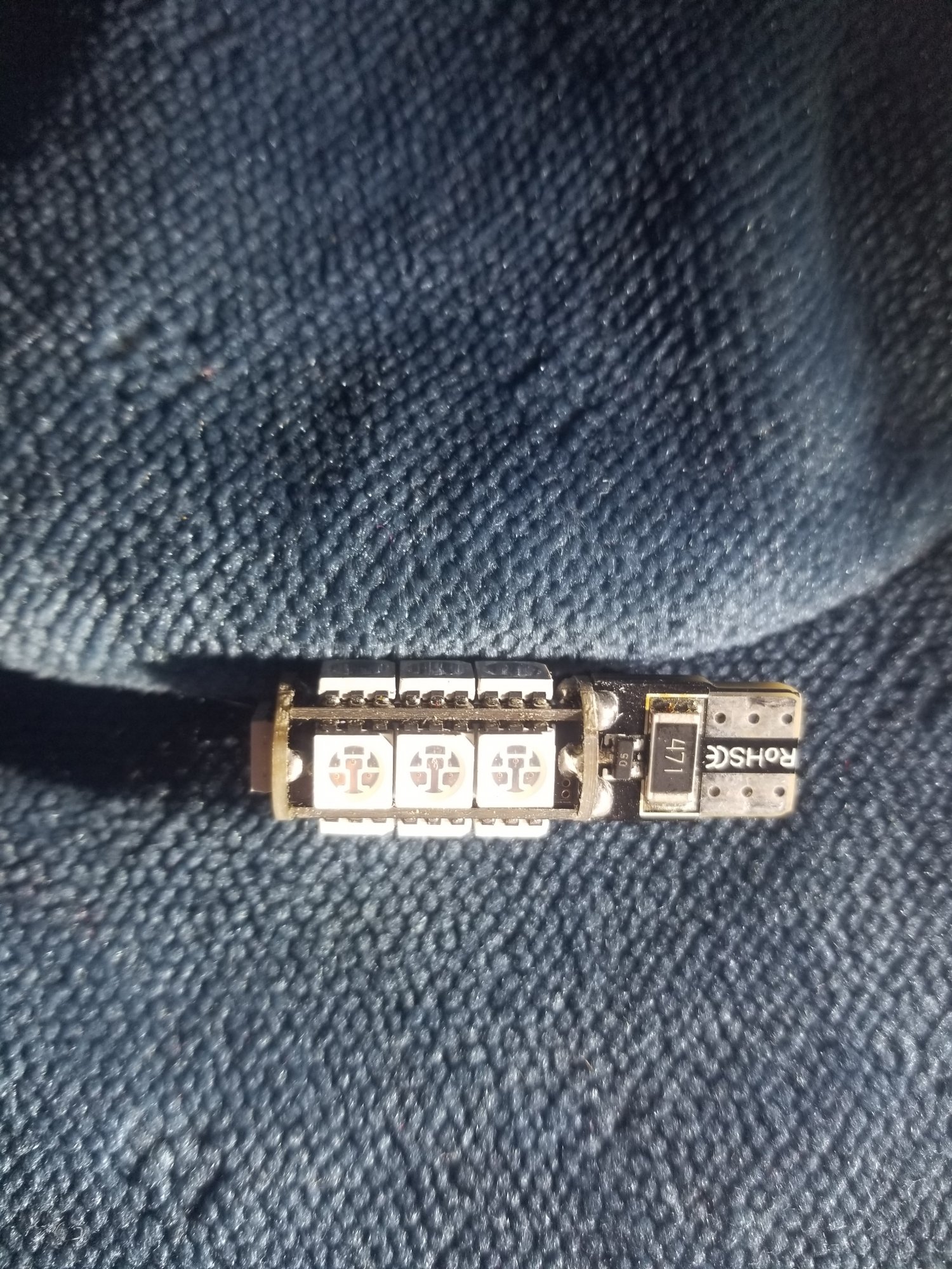

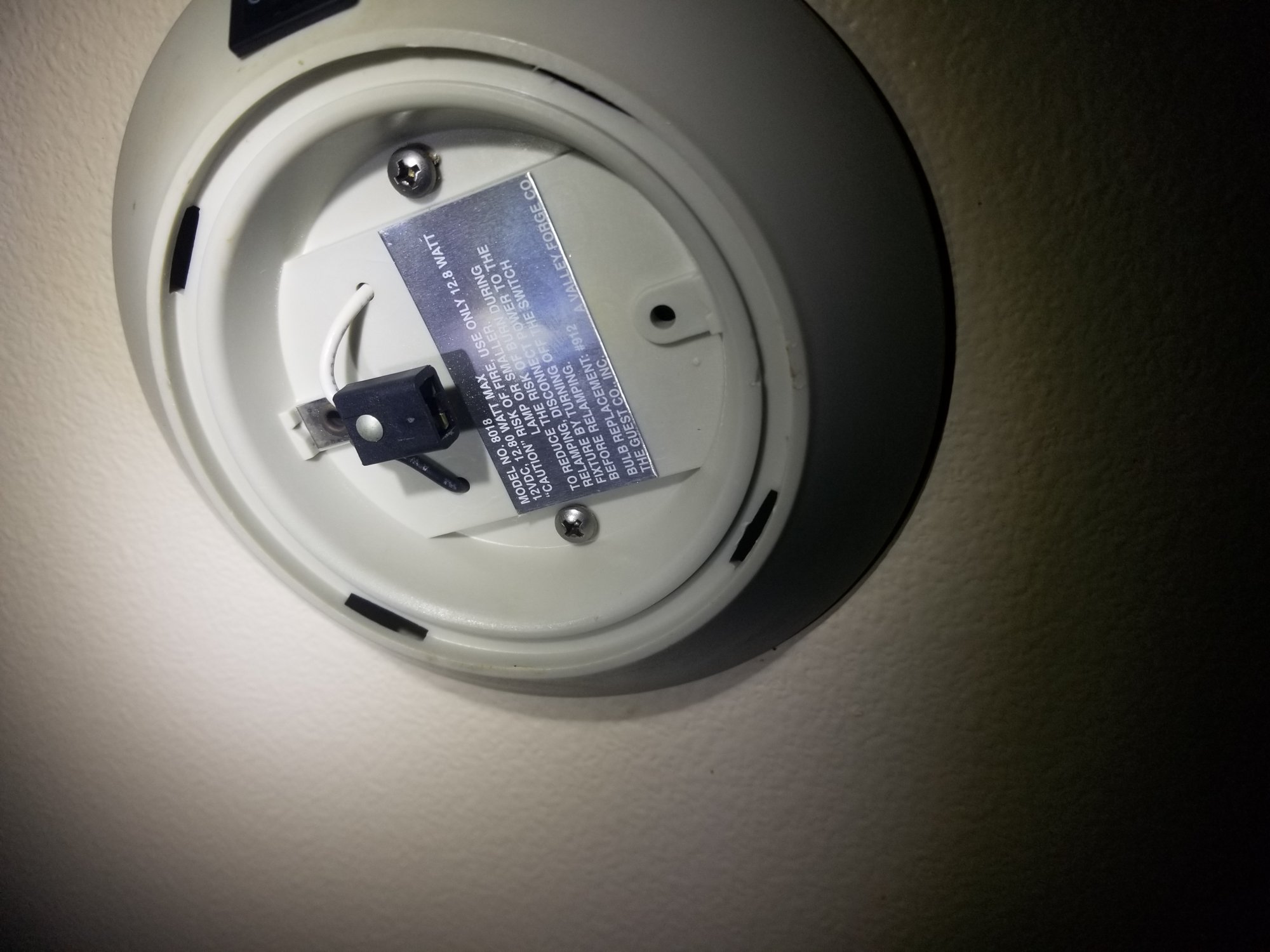

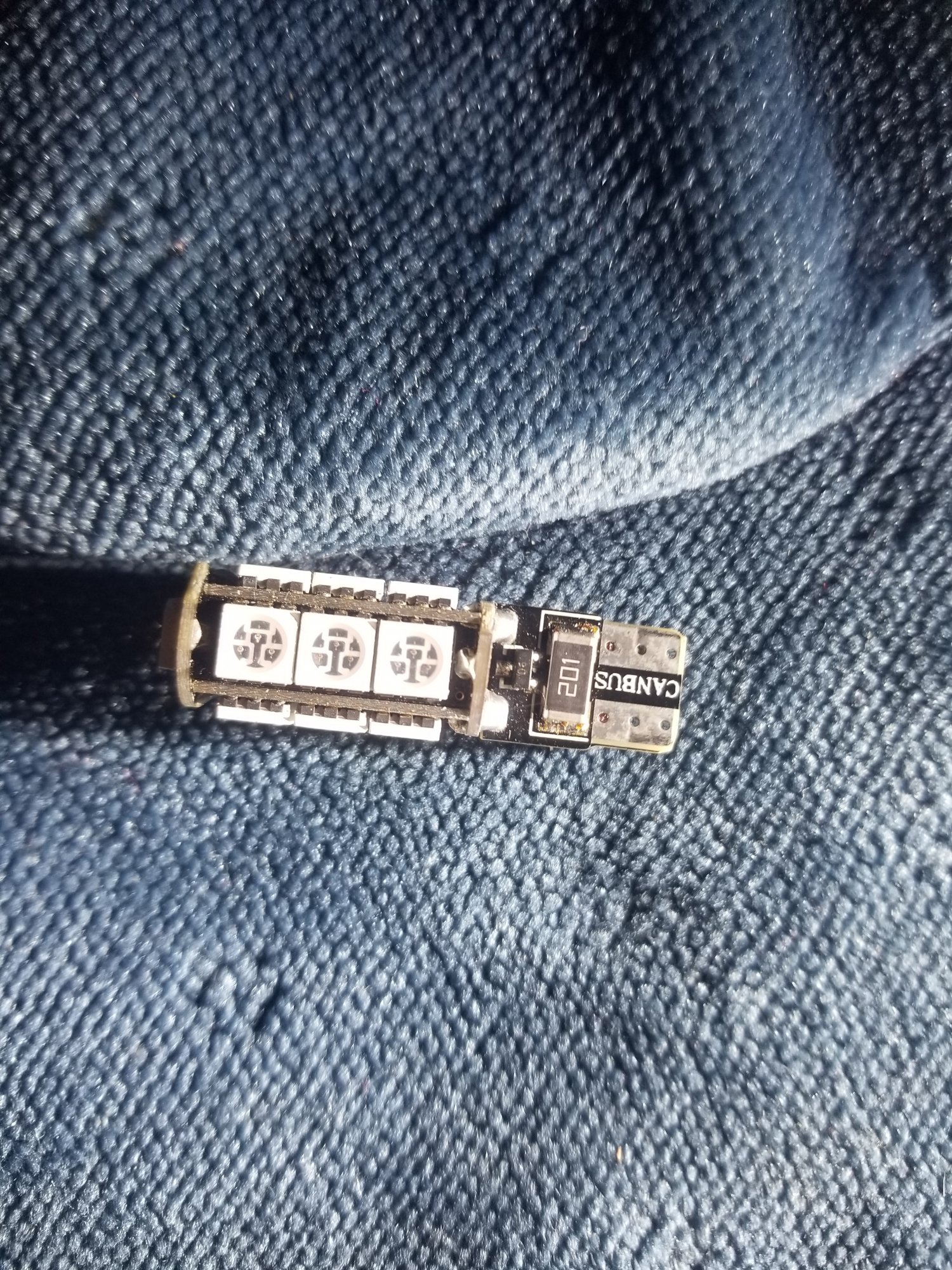

Sometimes the LEDs can be changed from red to white and back…red is good for preserving night vision.…not so great when you are not sailing though.
You might try turning the power switch on and off twice in quick succession and see if the lights change color.
In my old O’Day 322 salon lights, some of the fixtures have a second socket for a small red bulb, these are in the head, galley and over the nav station. All the rest are just single bulb fixtures.
If you need to change them, lots of options on Amazon, or a quality LED store like MarineBeam. And the SBO store may carry something that fits those fixtures.

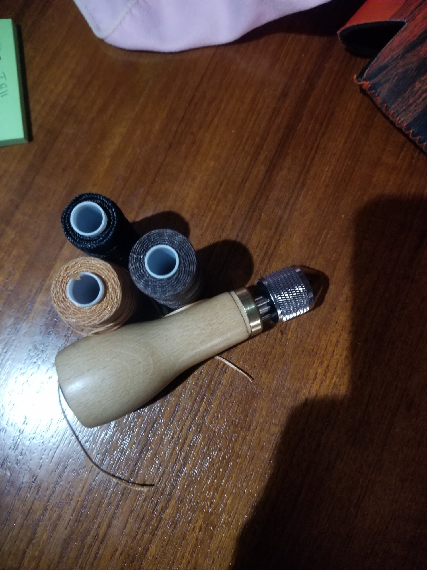

next question is what is this used for? I suspect sewing something.
It is called a Speedy Stitcher…allows you to repair stitching in canvas, Sunbrella, etc.
I have 2 and always keep one on the boat. It doesn’t make a pretty stitch, and it is very slow, but it can save the day if something tears.
Takes some practice to use it… you should practice some before you actually need to stitch something :)

P.S. As mentioned by other posters, that is a sewing awl. I've used mine several times over the years. Very handy for small projects. Most of the time I use a waxed nylon twine for sewing canvas and other heavy materials. Regular polyester thread works great for clothing, etc. For those projects, pick up a sewing machine needle, which will fit into the awl chuck. Calling it a Speedy Stitcher is sort of an oxymoron, IMHO.
