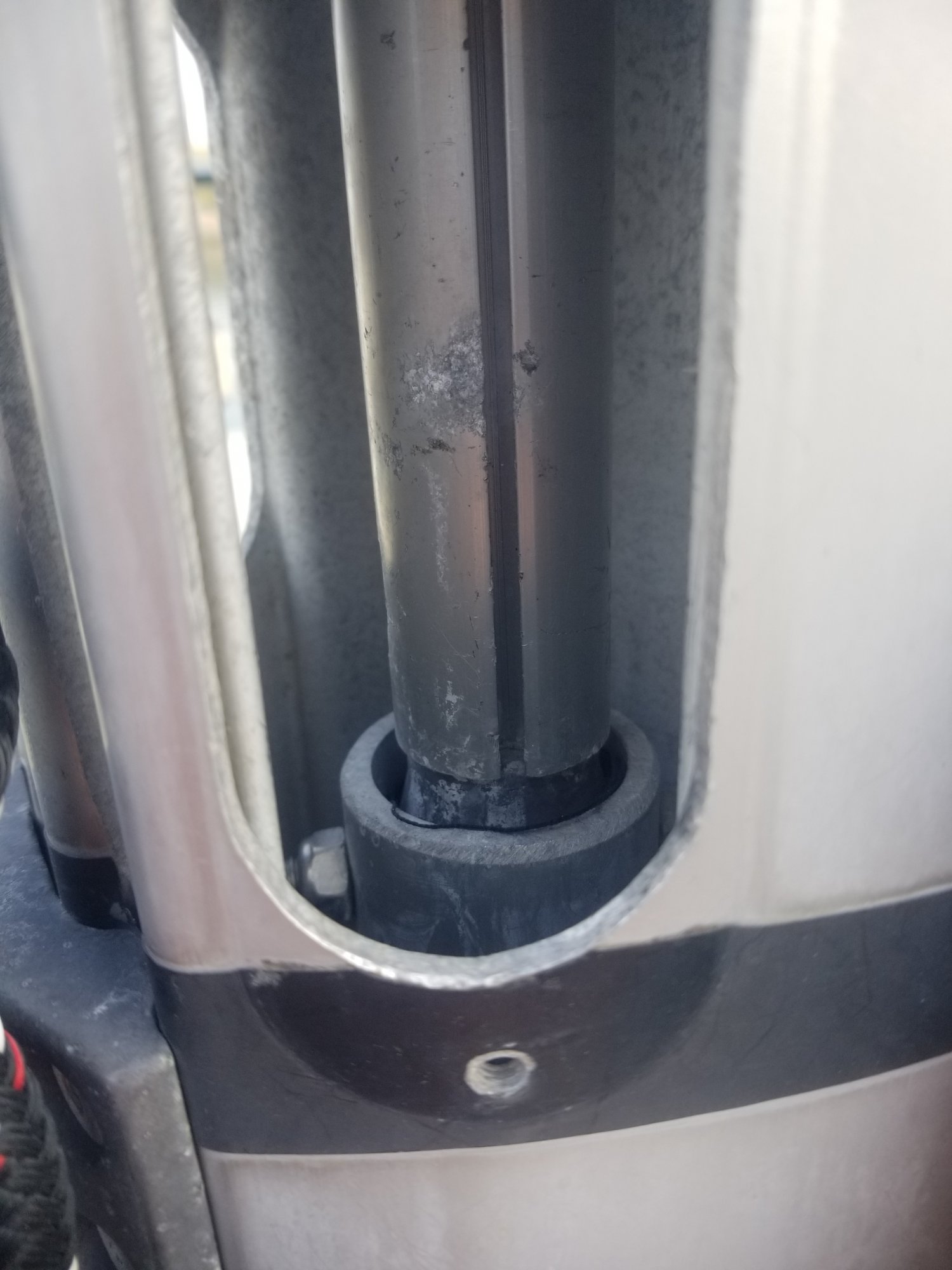

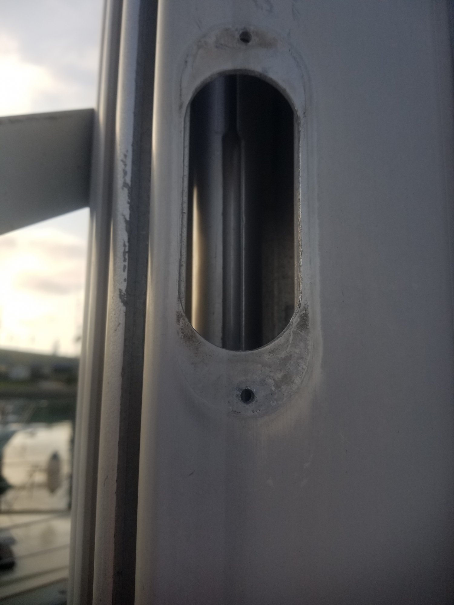

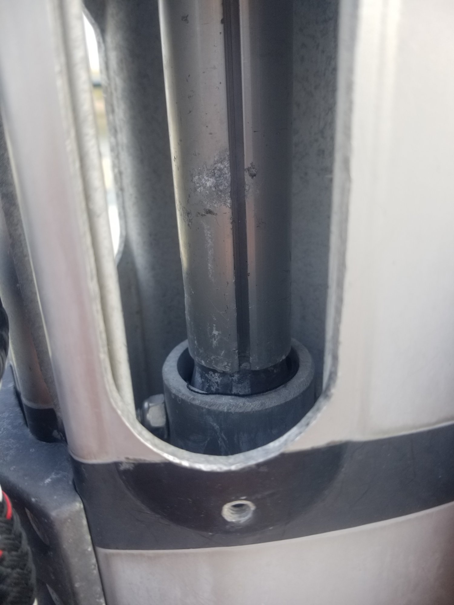

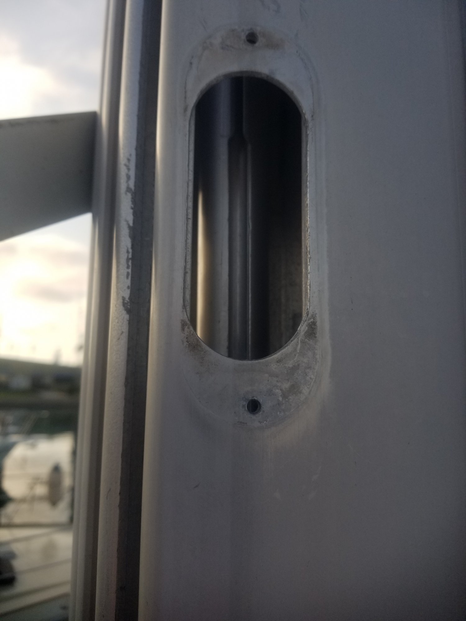

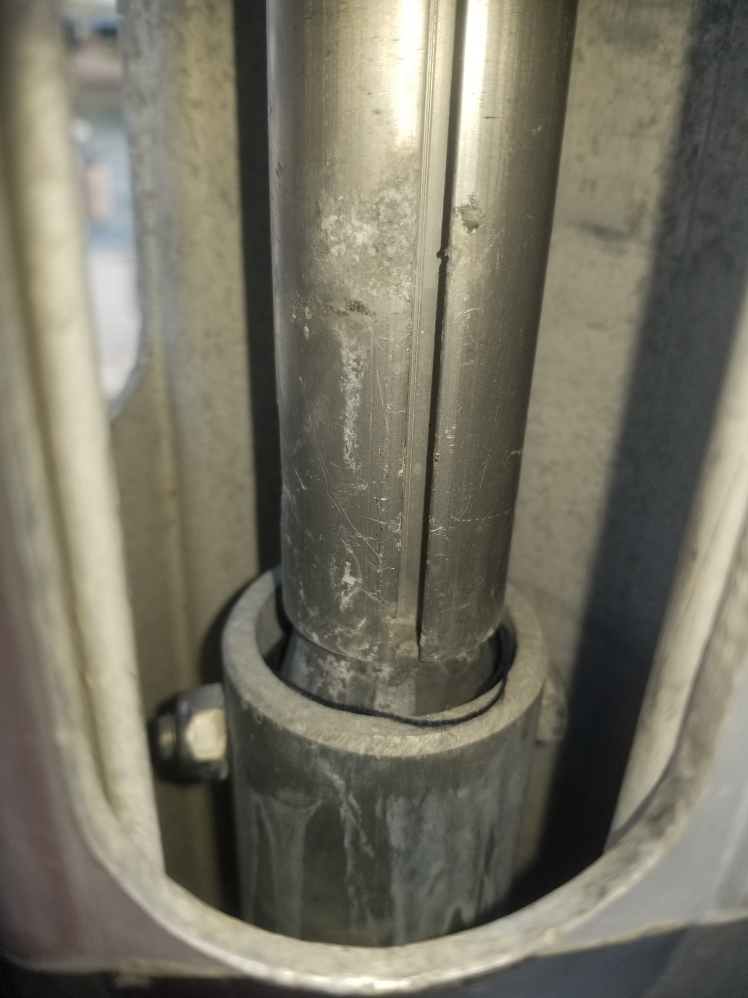

Okay, got a new question for ya'll. We had a rip in our main sail so we pulled it down and fixed it. Now I am unsure as to how I am supposed to get the luff cord into the furler. Shouldn't there be a wider portion of the channel where I introduce the cord?
23,930
Is that where you pulled the sail out of the furler? If so that is where it goes back in.
Just for grins, have you checked the furler to see if the other side has a slot?
If that is the opening, then take the hoist slow so you can hand feed the sail into the slot.
Oct 26, 2022
53
Hunter Passage 42 Cape Marina
I did check the other side :D. The problem I had was that when I finally got the main completely unfurled; the luff cord was not in the slot or it pulled out when I unfurled it. The cord looks to be in good shape so I suspect that someone got it furled without pulling it in the slot but am not sure.
  • Wow
23,930
I did not know that was possible.
And the luff tape is in good condition?
Does the luff tape look to be the correct size? It will fit into the slot?
23,930
The image you posted looks to be at the base of the mast. Is yours a Selden mast?
Oct 26, 2022
53
