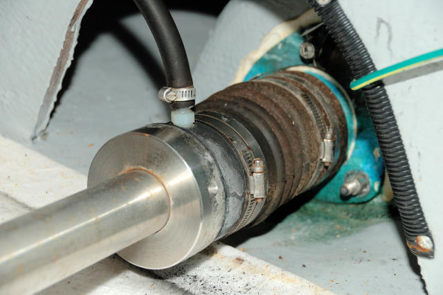

remove the bellows; loosen 2 set screws on each side and tighten nut a half turn and retest.
I think you’re combining two different types of glands there. A standard stuffing box has no set screws or bellows. A standard one is rings of packing held inside a nut, with a second nut just to retain the first.
A bellows and set screws are used on a dripless shaft seal. In some cases compressing the bellows a little more may help with those. Always replace the set screws with new ones rather than reusing though.

May I suggest a full stop here. As @Davidasailor26 and @Kings Gambit have said, you most likely have a mechanical shaft seal and not a packing gland. We need a picture before I think anyone should say anything further.
You are dealing with something which has the potential to sink your boat very quickly. Chances are the seal is 26 YO. As you saw in @Kings Gambit 's link, the entire seal should be replaced every six years. If the bellows fails, grab a life jacket and hold your nose.
Perhaps it's time to realize that you know just enough about sailboats to get yourself into a lot of trouble. If you don't have previous experience with boat maintenance, you may want to find a competent company in your area who can provide stem to stern maintenance for a time AND doesn't mind you looking over the mechanic's shoulder to learn what he's doing. Don't get tied in with a dock ape. Most mechanics who are good like to show what they know.

Here is a video I made that may help demonstrate what I referred to as a “standard stuffing box”…
Here is a video of my new Volvo Penta dripless stuffing box…
If you have bellows, disks and set screws, you probably have a PSS dripless system (which I have no experience).

@hatchclan As advised. Stop.
Words used about boats mean certain specific things.
We often ask the sailor to post pictures. The reason I added the link in my first post was the pictures on the site. If you looked and the system on your boat looks different it would trigger a statement like “That doesn’t look like my boat”.
I would encourage you to post a picture of the parts you have on your boat identified as the “packing gland”. Then we all can more safely share ideas that you can decide your hand skills can solve or you will seek marina worker assistance.

lol, yes it is, thank you. The survey report indicates a small leak. The surveyor recommends attempting to tighten first.

I don’t know whether the PSS bellows can be safely adjusted in-water or not. If the bellows are of unknown age and the boat is hauled I’d say it’s just a better bet to replace with new than wonder about the age and condition of the old.

And it is a PSS dripless.....according to the surveyor.
I don’t think that there is any way to tighten a PSS seal. Unless the clamps aren’t holding the bellows tight or the bellows aren’t compressed enough…
but there is no packing nut to tighten.
