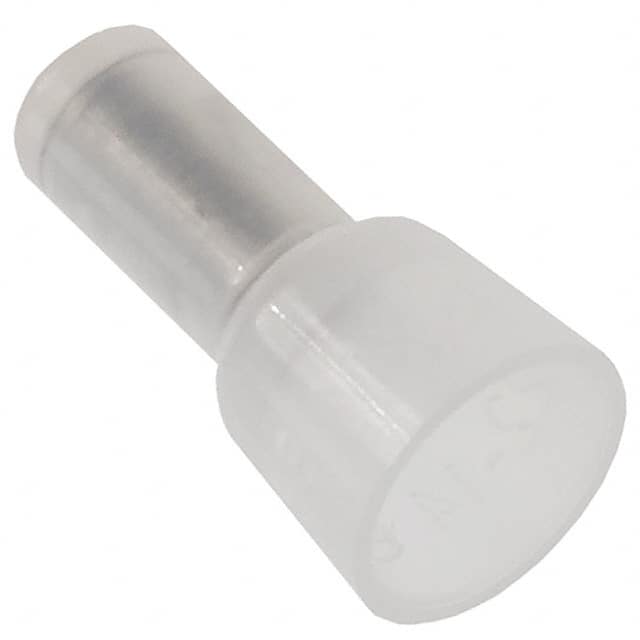

For crimp connections, if you have vastly different sizes of wire, like your 12AWG to 18AWG, a good solution is a pigtail crimp connector. You just twist the wires and crimp on this cap. It doesn't lay in a harness as well as a butt connector, but if works. You can get them at Lowes of Home Depot or Ace Hardware, et.al.
