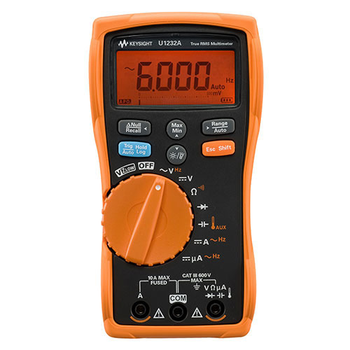

all vessels and cars need a simple test light like this. they range from $2.00 to $22.00 . a few yards of wire will make it longer. start at the battery and follow the electricity through the system.
or you can upgrade yourself with one of these. following electricity is not hard. it's easy, it's sorta fun like a puzzle. it's part of running a tight ship. come on DOG, you can do it.
lake erie sailors are bad ass. we are can do people.
you da DOG :)
i don't sail without a test light in my tool box
