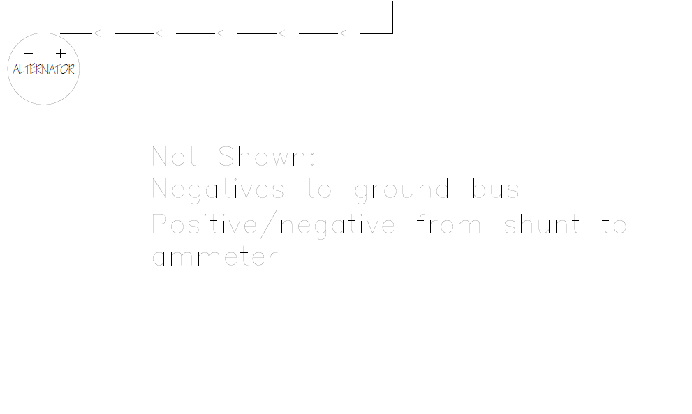

There's something seriously wrong with this. I recommend you do a good visual inspection, literally trace the wires out from every connection, and draw a schematic diagram of what you have.

I drew a block diagram before I started. I believe I attached to my original post. There's a copy of it in the desk of the nav/com station. But, every time I look at it I'm not seeing anything wrong with the diagram. I could be staring the problem in the face and not seeing it. That's the problem with being too familar with a system. You see what you expect to, not what is actually there.

I just downloaded the schematic; it's really tough to view; part of it looks like this:
jviss
Feb 5, 2004
7,090
Tartan 3800 20 Westport, MA
I went over the drawing, nothing unusual. It would be helpful to show the grounds; on my boat there's a lot going on with ground, including shunts, etc.
Based on the symptoms you describe I guess battery two is not connected at the ground end.
Can you measure across battery two with your voltmeter, and then from a ground to the positive terminal, with the battery switch and combiner off?

I think you need to make a new wiring diagram to show how it's hooked up rather than the way you think it's hooked up because it seems to me you can't just add an ACR without changing some other circuit so it does not conflict somewhere.
If you can't read voltage on your battery when the battery charger is not turned on then you are reading the voltage from the battery charger not from the battery.
I don't have ability to make up a new drawing at the moment. The original is a CAD file. That file and AutoCAD are on the home computer. I'm at the boat on a laptop.
Look at the drawing as it is. There are 2 positive buses in the compartment with bank 1. The right hand bus is all incoming charge sources, the charger and alternator. The bottom bus connection goes to bank 1 battery. The connection at the top jumps the buses. The second, left hand, bus is all outgoing positives.
Now eliminate the positive from the charger to bank 2. The ACR is connected to the top connection of the left hand bus. Jumper from right hand to left hand to ACR 'A'. The bank 2 positive that was connected to the charger is now connected to ACR 'B'. Additionally, a 75 amp fuse was installed between the alternator in and the right hand bus.
From all the drawings I found on Mainsail's Marine How-to site, the ACR should be correctly installed.
The distribution panel's voltmeter is wired to read voltage at the battery as per Blue Sea's instructions. As with bank 1, bank 2's positive to the voltmeter connection is at the positive bus of bank 2. A switch at the panel allows me to check the voltage of either bank 1 or bank 2.
