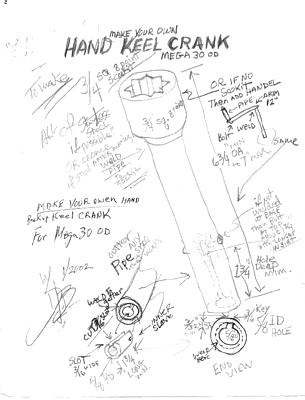

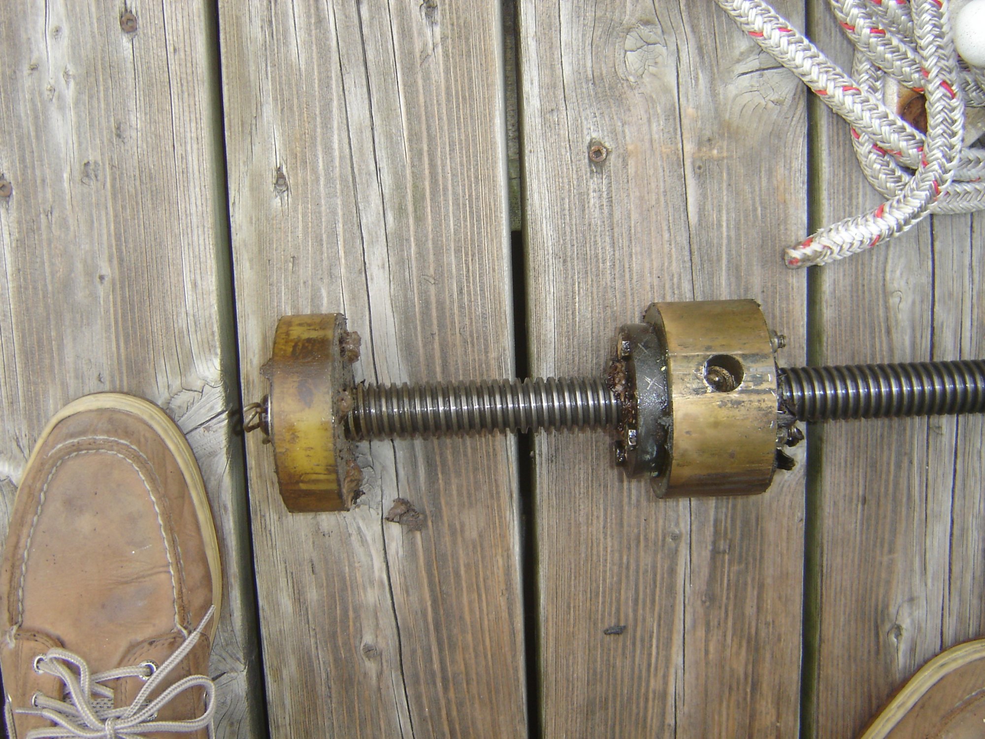

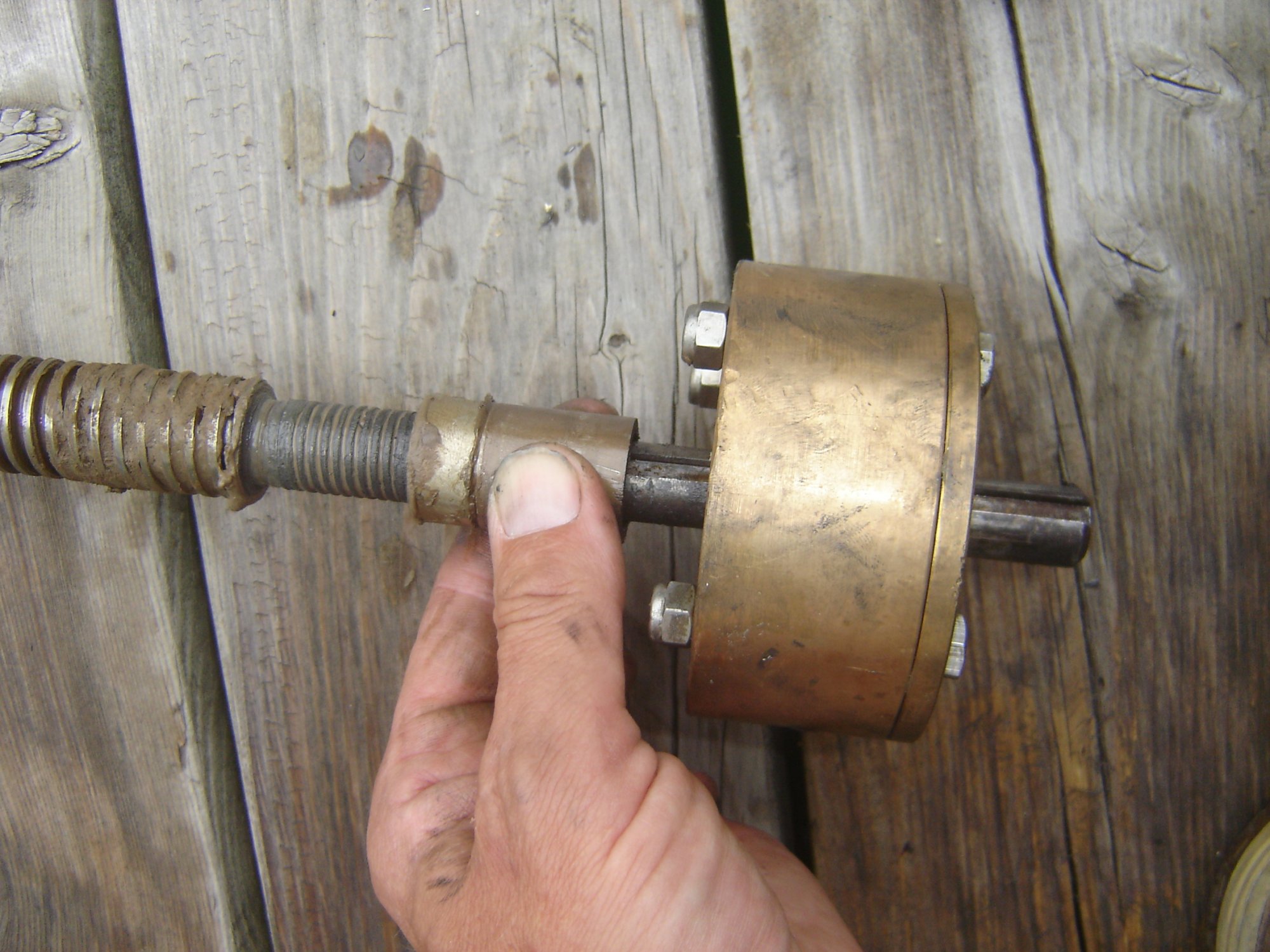

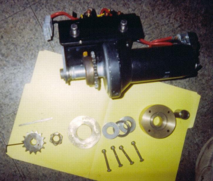

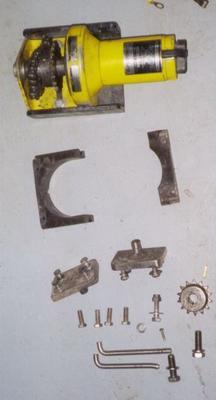

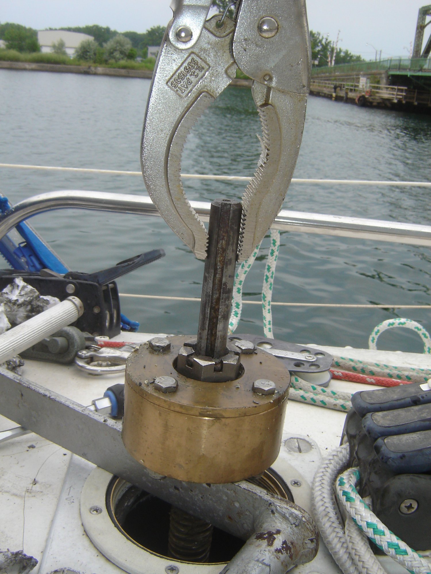

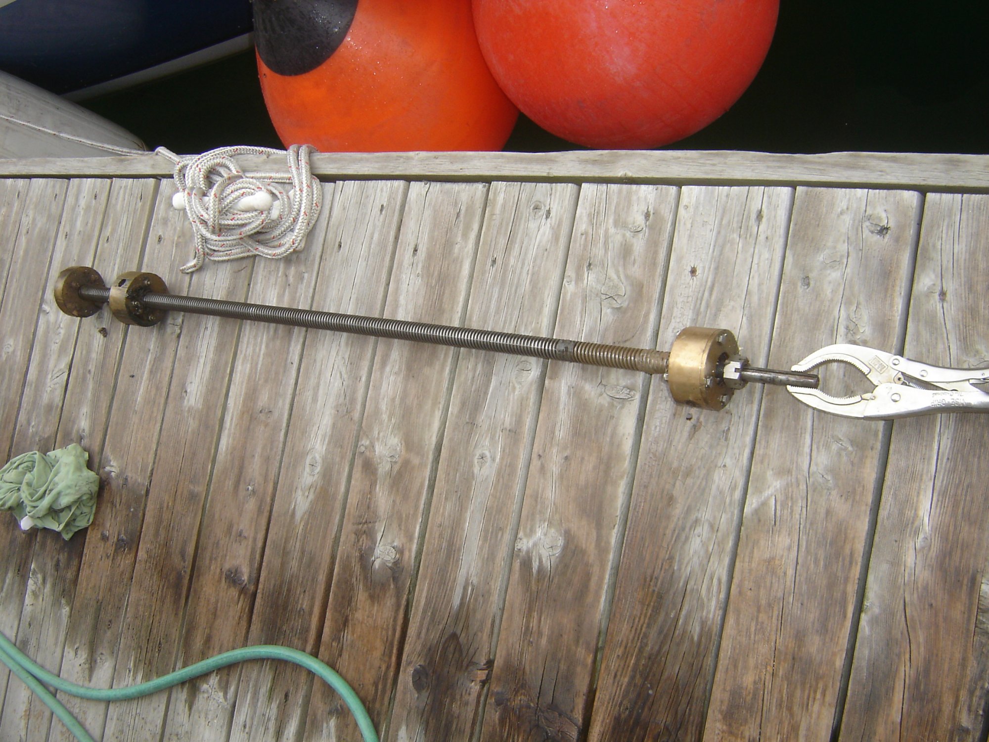

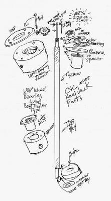

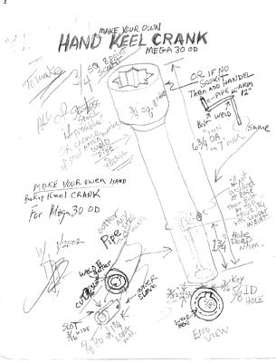

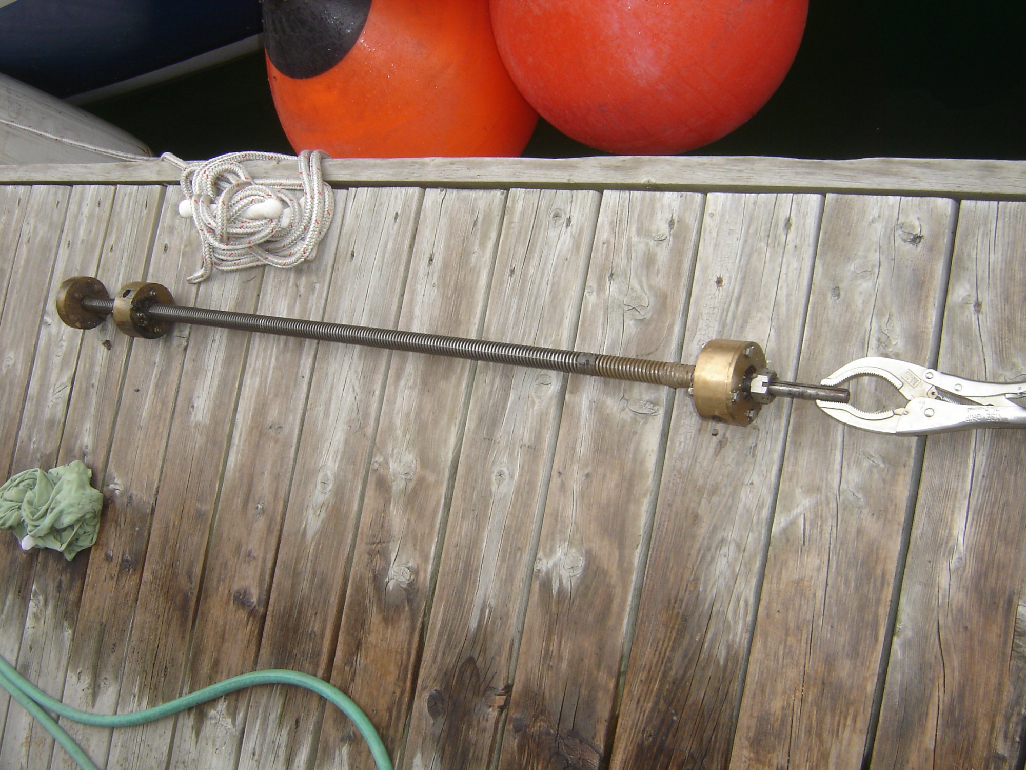

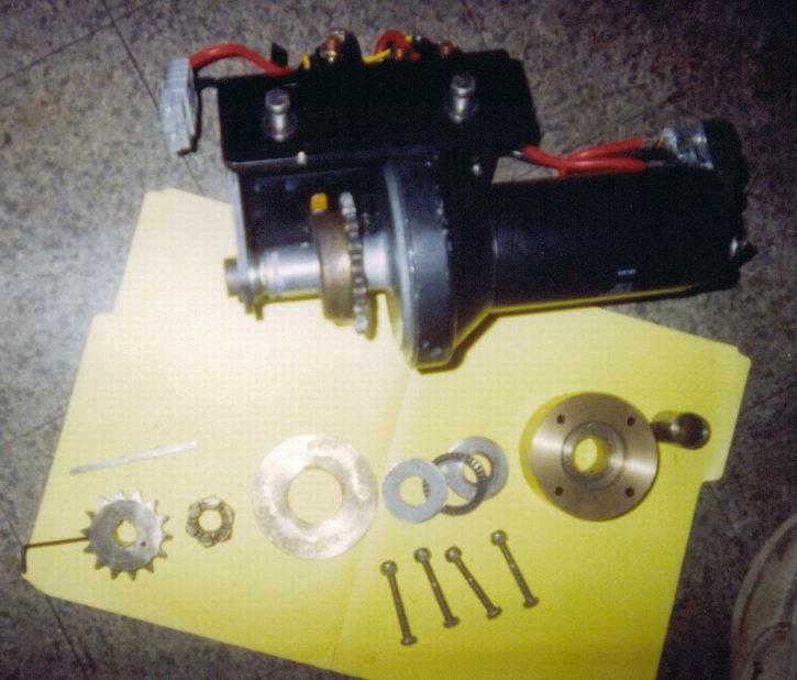

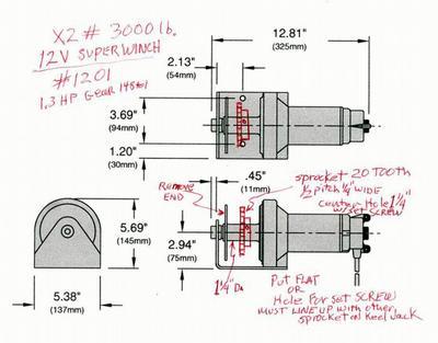

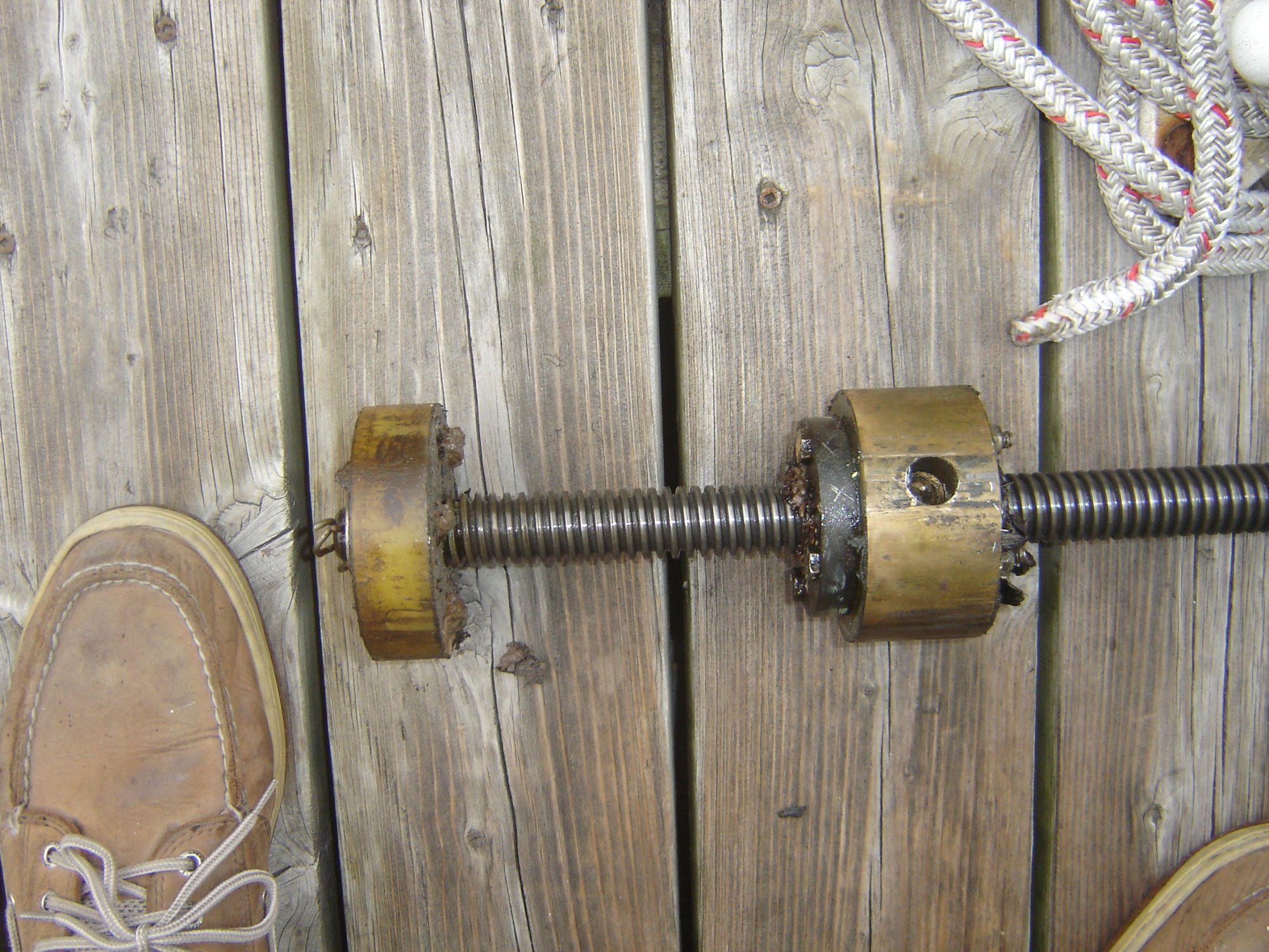

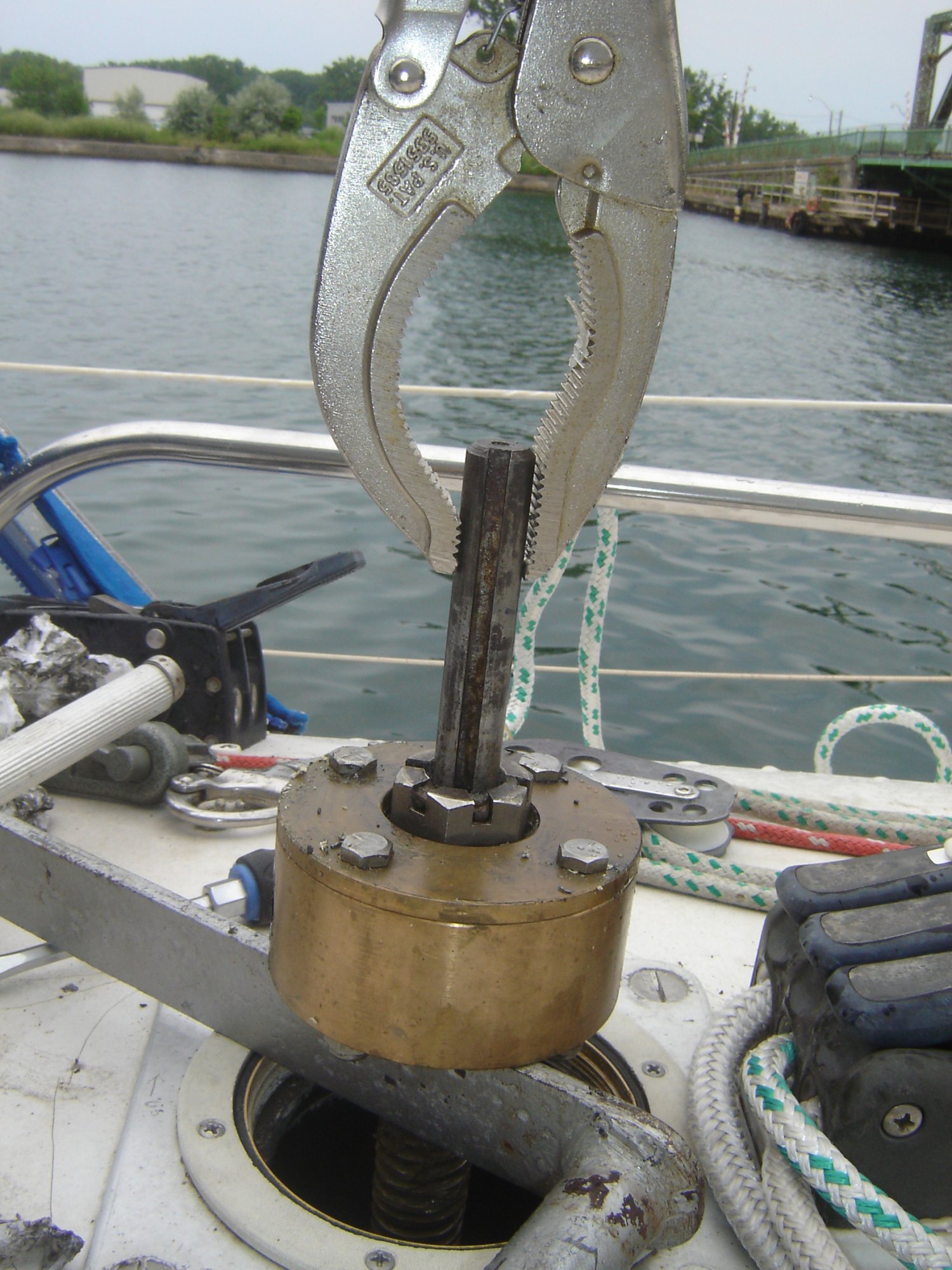

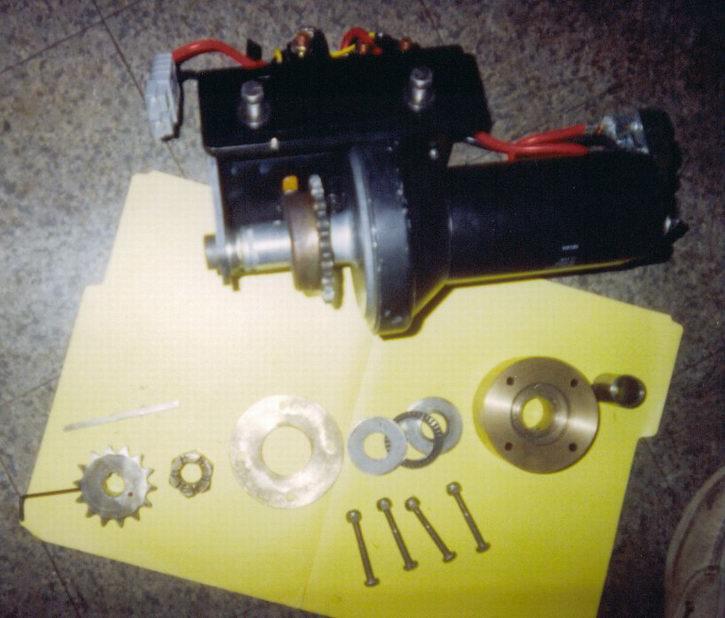

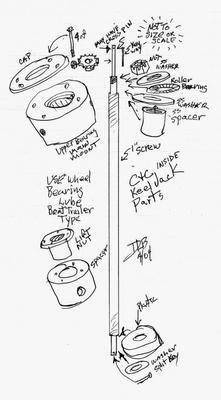

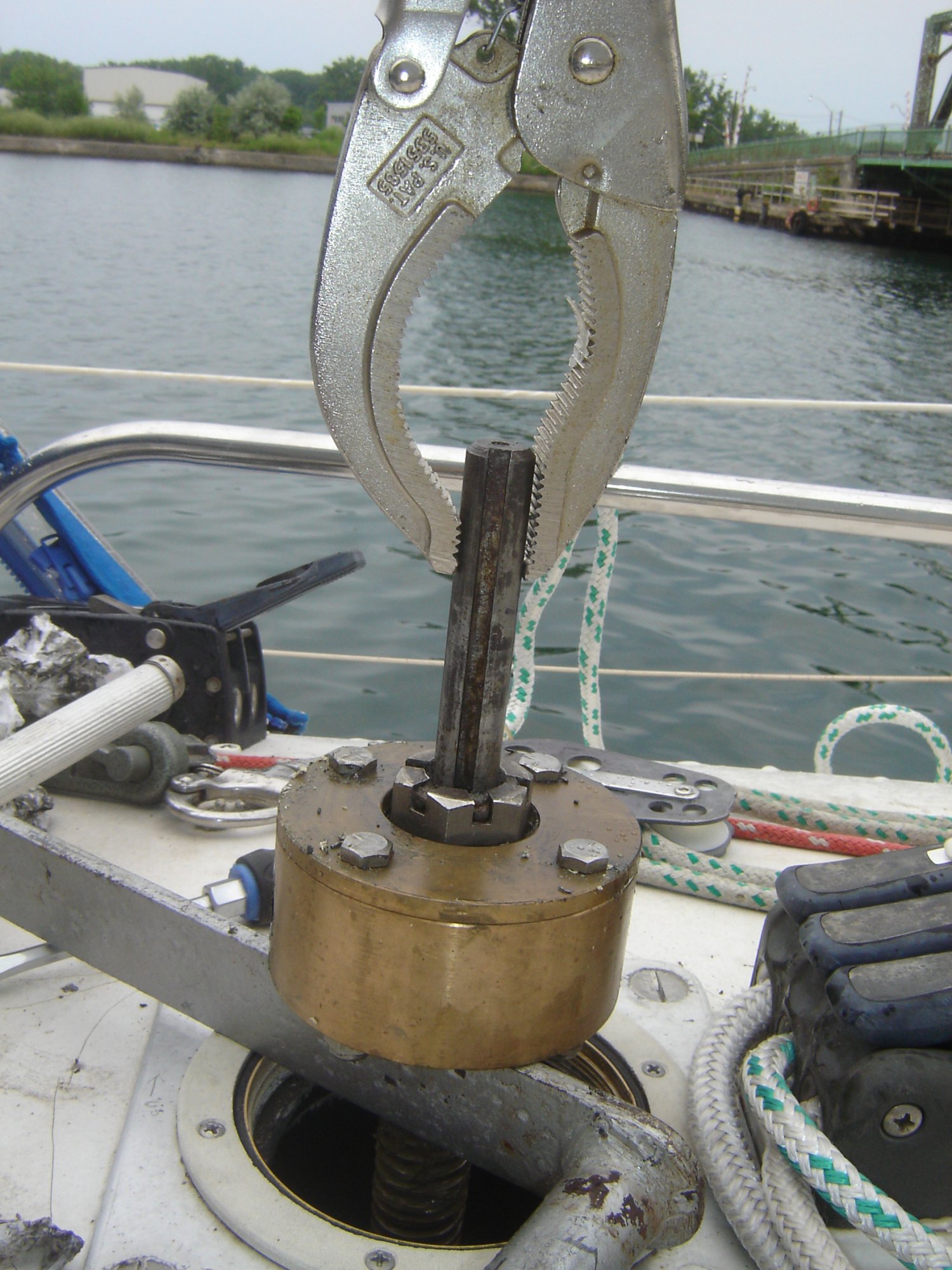

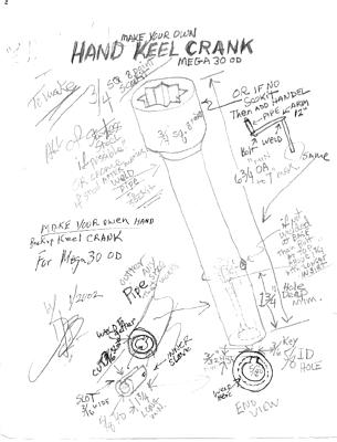

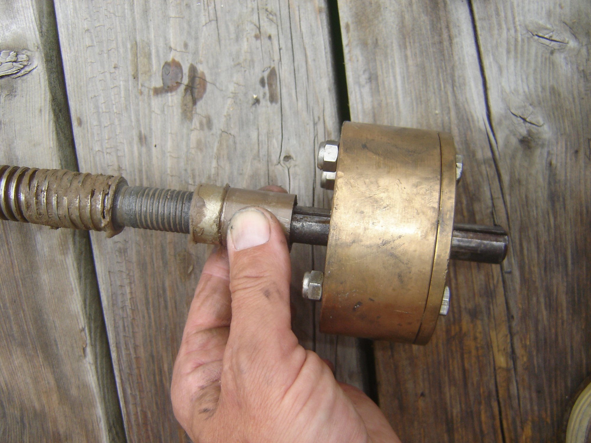

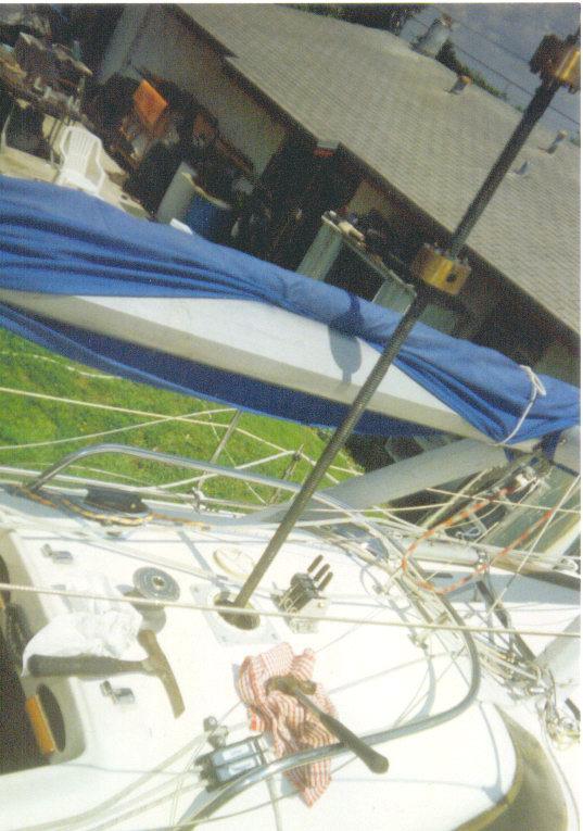

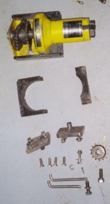

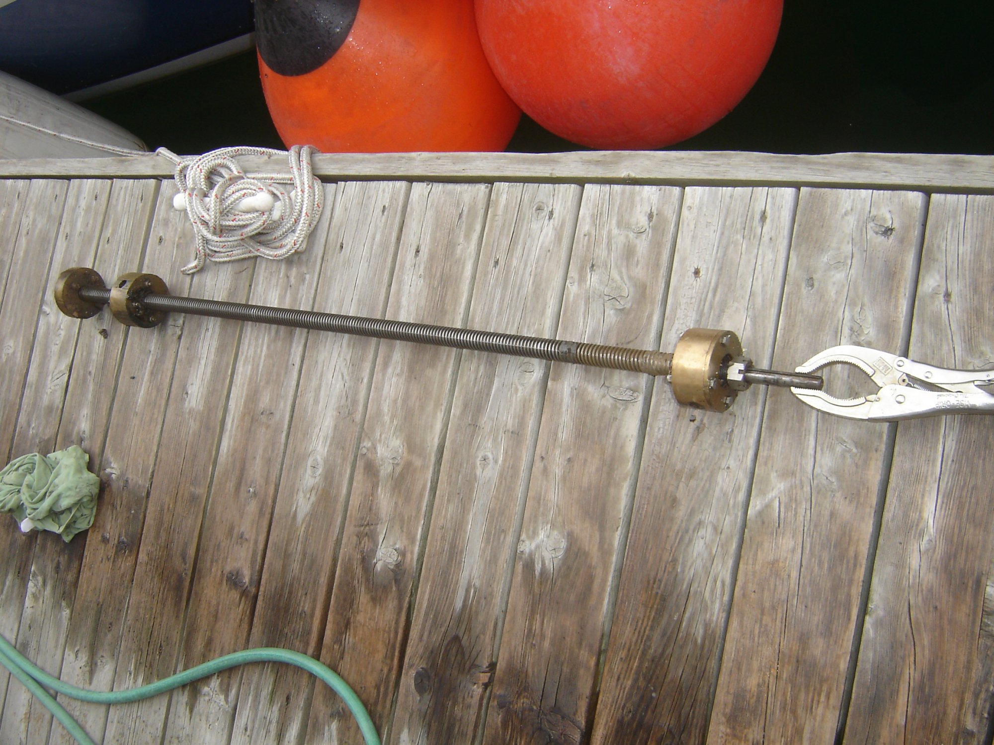

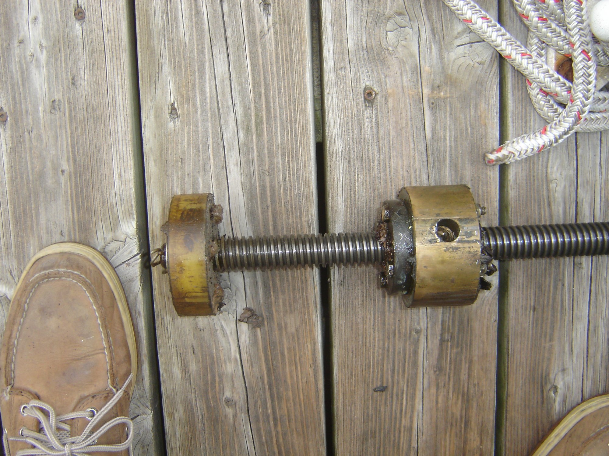

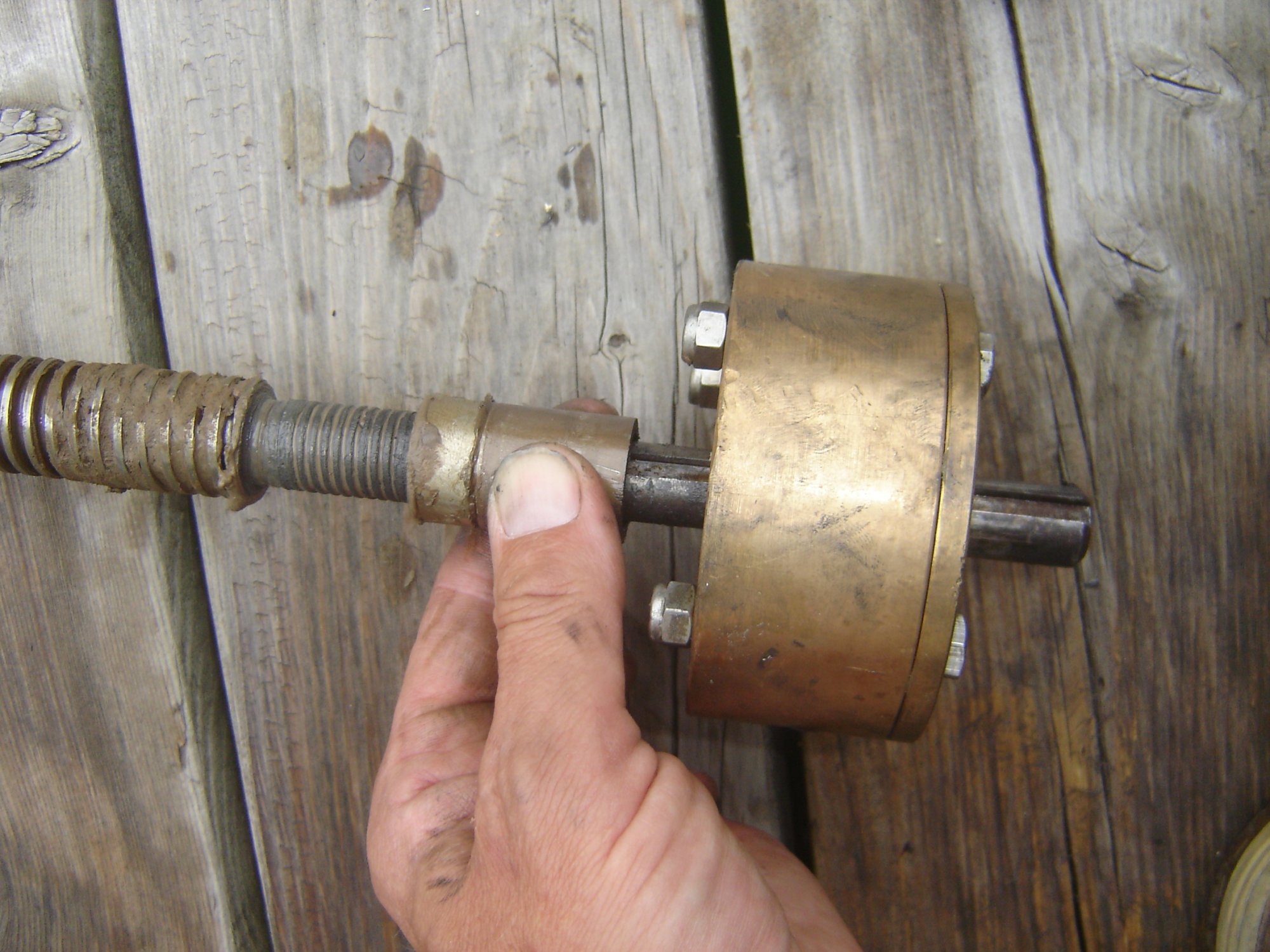

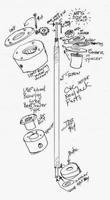

I am having great difficulty raising and lowering the dagger board. Does anyone have any advice on rebuilding it? And I would like to add the electric motor. I would also like to know if anyone has added a j-sprit to a c&c mega.
Feb 11, 2012
271
C&C Mega 30 Long Point, Lake Erie
I have some photos, drawings etc. that I saved from another old Mega 30 site.
Let me know if you would like me email them to you.
Paul
Mar 20, 2015
3,306
C&C 30 Mk1 Canada
If there isnt a huge amount.. Maybe post them here on on the internet archive so they will be available long term.
Feb 11, 2012
271

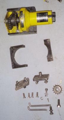

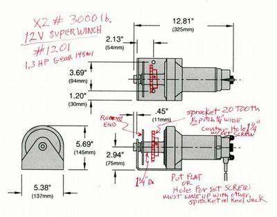

Do you know where to buy a keel motor?
I believe you can buy them off amazon...
They are also a popular winch in the off-roading industry. You can get one from a Hully Gully, Power Garage, Etc.,....or I think even Princess Auto them at one point, possibily online.

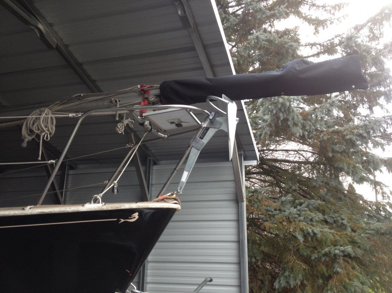

Paul, I looked at a Mega 30 before buying my C&C27. One of the deciding factors was the look of the boat, I wouldn't use the "U" word for the Mega but I never really appreciated the look... until now. :wow3: you turned an ugly duckling into a beautiful swan!!! You had a great vision and followed through on it.
