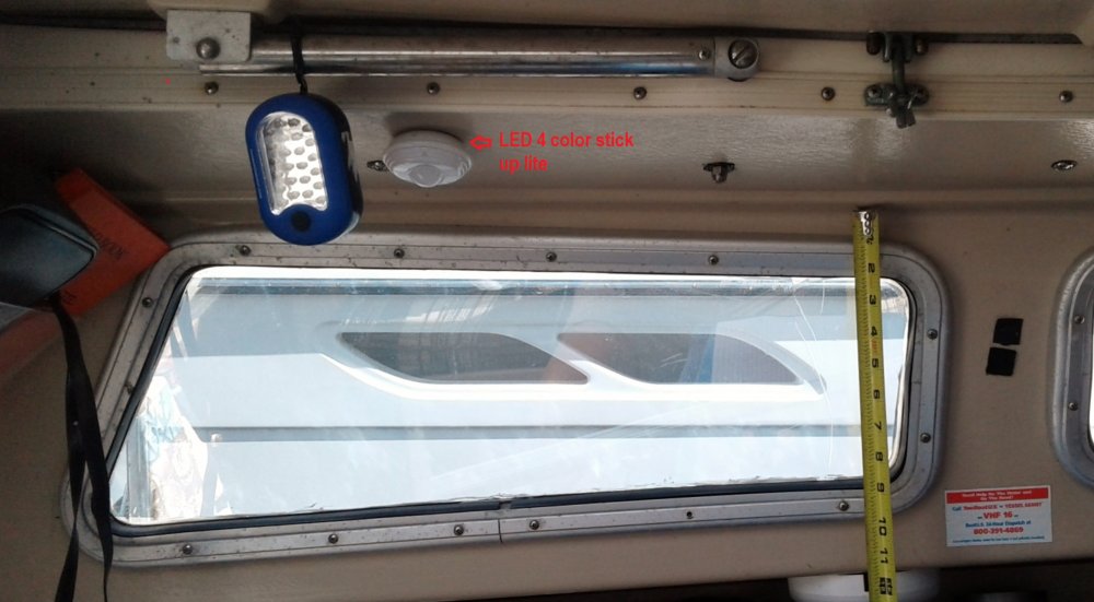

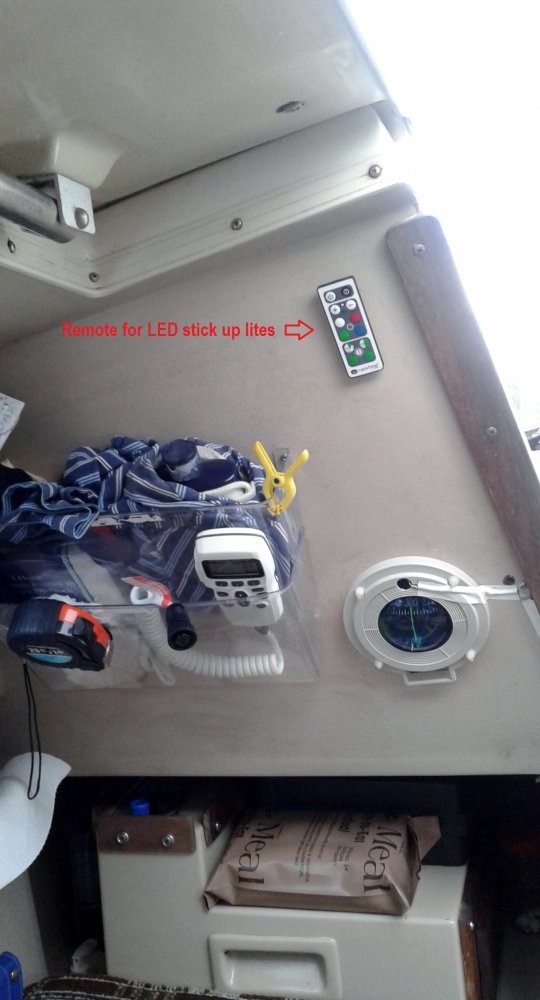

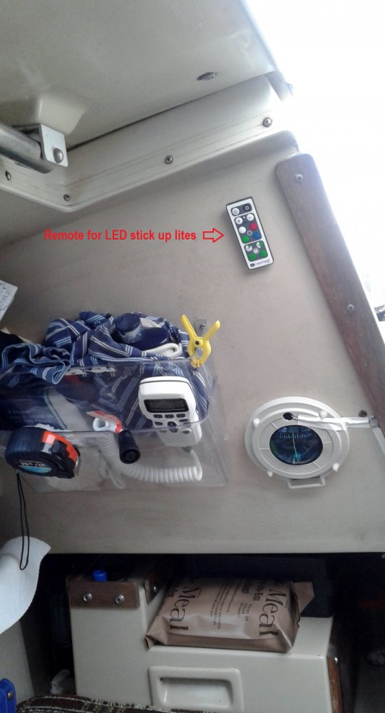

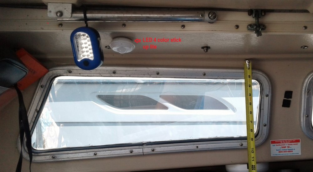

Ok So here is the explanation for the remote on the bulkhead. Found a 4 lite LED stick up set in Sam's Club, has batteries included, 4 lites, stick up pads and a remote. The remote can change the color to white, blue, green or red and dim them as well. Only real trick is wipe down the mount surface with acetone to get a good stick. If problem area I used a pair of stick on velcro pads in one spot. Backup is since the light unscrews from its back plate with a twist you can even put a small short screw in to hold it up. I put one over galley, one over nav station, one over forward dinette compartment on port and last one over my hear area on stbd setee, nice lite for reading. Each can be turned on individually too by just tapping until right color is on. Location of remote lets me reach in at night and put all lights on low red with a click.View attachment 154526 View attachment 154527 View attachment 154528
Just grabbed some of these. Like the idea of reaching in and turning on some light. Very convenient.
Feb 9, 2020
12
Catalina 22 Louisville Sailing Club
I just installed the same lights yesterday. I like them. I also just ran LEDs like on Stingy Sailors. They provide great working lights in the boat. Can't wait for weather to allow me to get her on the water.

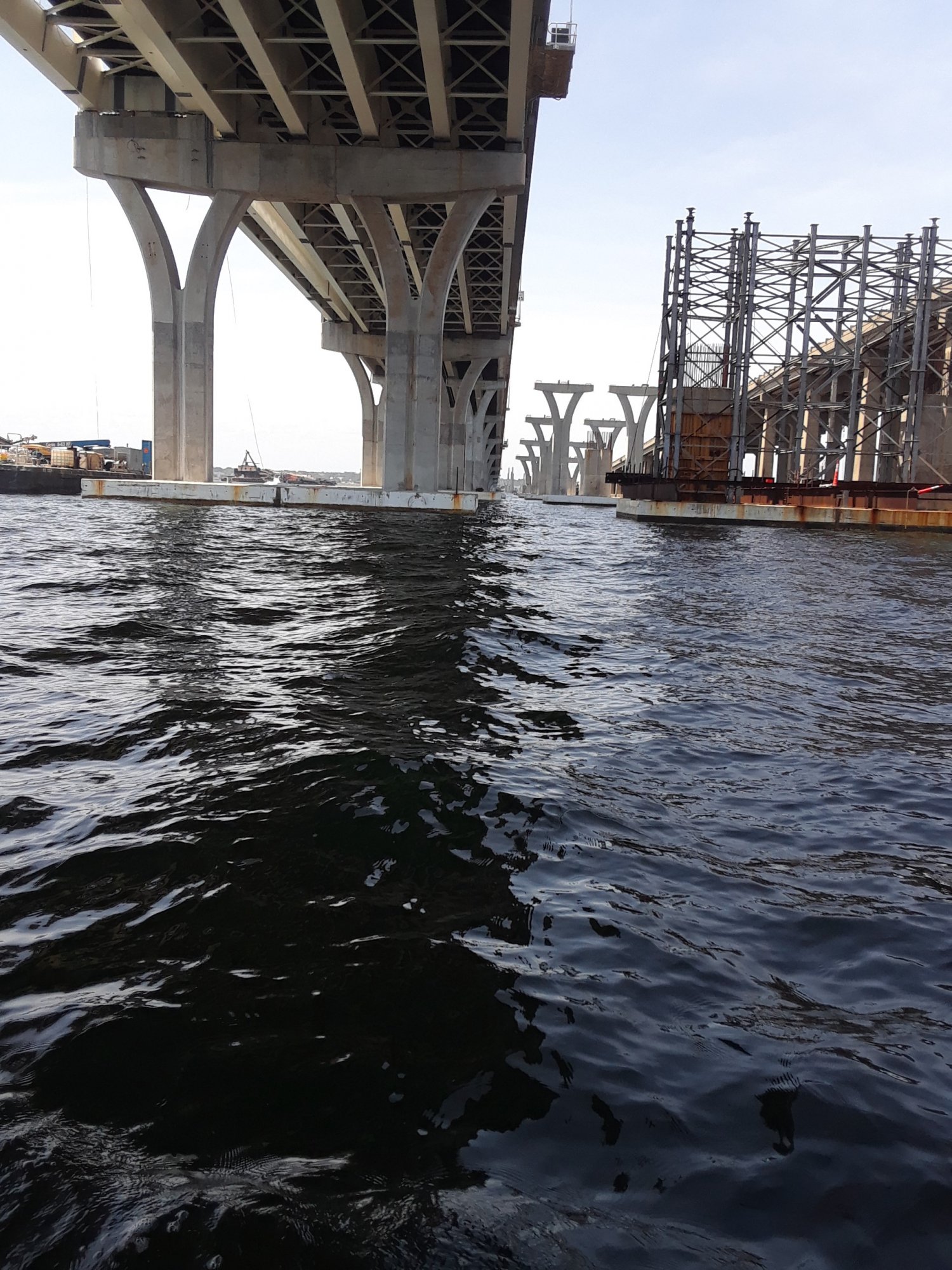

Update on sail pro, went out for sail other day, worked fine, runs good under load and even restarts on second pull when you need it for a bridge break, like under this sort of bridge, where you have an old span, a new span and another completed span, all of which screws with the wind in the passage thru, hence the motor in idle just in case.

13,096
Wow... that definitely looks like a place I'd keep the motor running on idle. It is not hard to imagine things going sideways fast.:yikes:

Yep, wind from south at 10 knots, under bridge becalmed then wicked north gusts at around 6-10 knots, then when thru back to south normal. weird!

Jack,
Appears that new bridge will open up additional cruising north of the old PB bridge now that mast clearance will no longer be an issue. Never was able to sail Escambia Bay nor East Bay when I used to charter there.

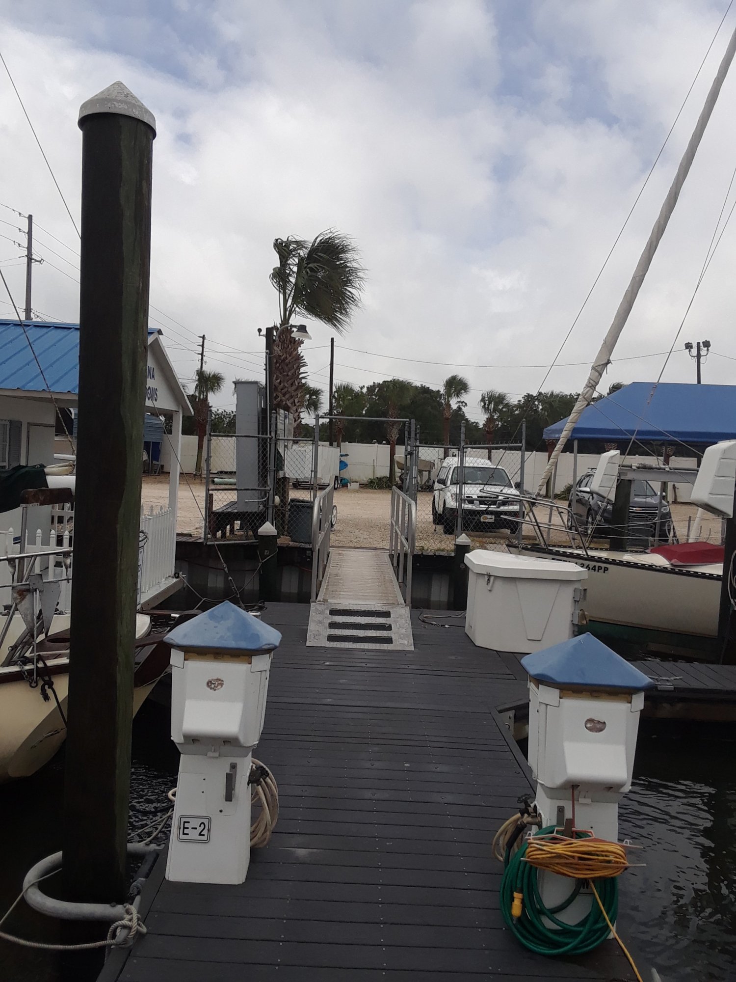

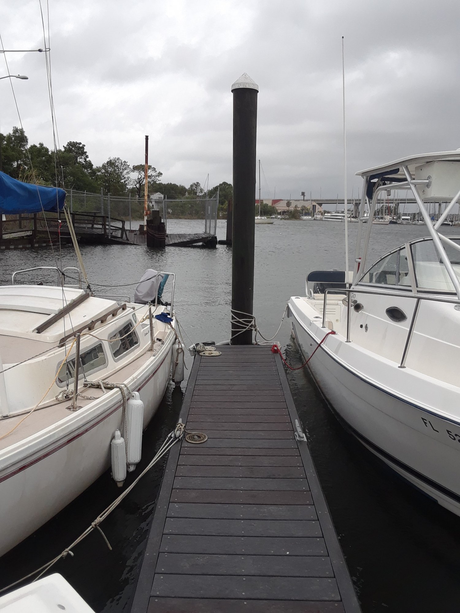

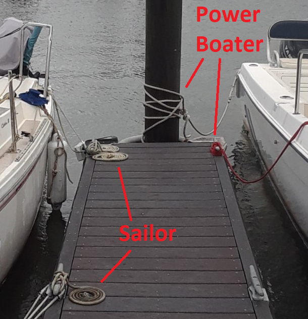

Quick prep for T S Cristobal, It is in Gulf now for about 30 hours, so being NE of it , we already got the feeder bands and wind and rain from it. Surge looks like about 2 feet so far based on pix below of level ramp to dock that is usually at 30-40- degree slope. Boat is double fender-ed and tight against the floating dock, only problem was had to move the next guys stern line up the post that the floating dock ring rides up on so it would not foul. Why some of these clowns have not figured out how the floating docks work is a mystery. Too much boat not enough brains.

Unbelievable! Think that I would have Harbor master explain to him how it works!! Jack, is that Marina on Bayou Chico?
Sep 14, 2014
1,297
Catalina 22 Pensacola, Florida
Yep, Yacht harbor marina in Bayou Chico. Recheck this morning, now uphill walk on ramp, that line was taut down into the ring on the finger pier. I untied it and tied it to the perfectly good cleat you can see near the stern of his boat. What a jerk!
