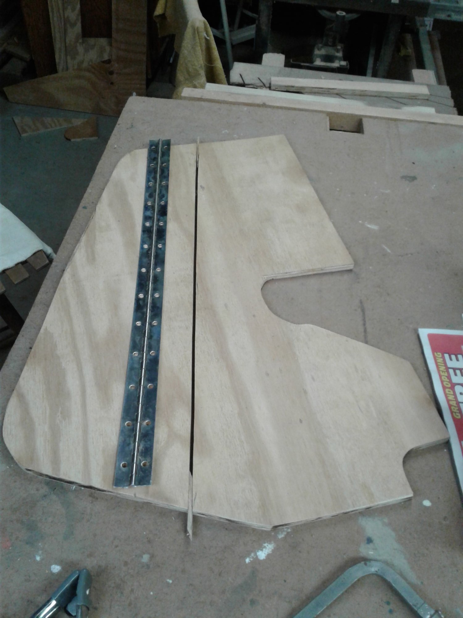

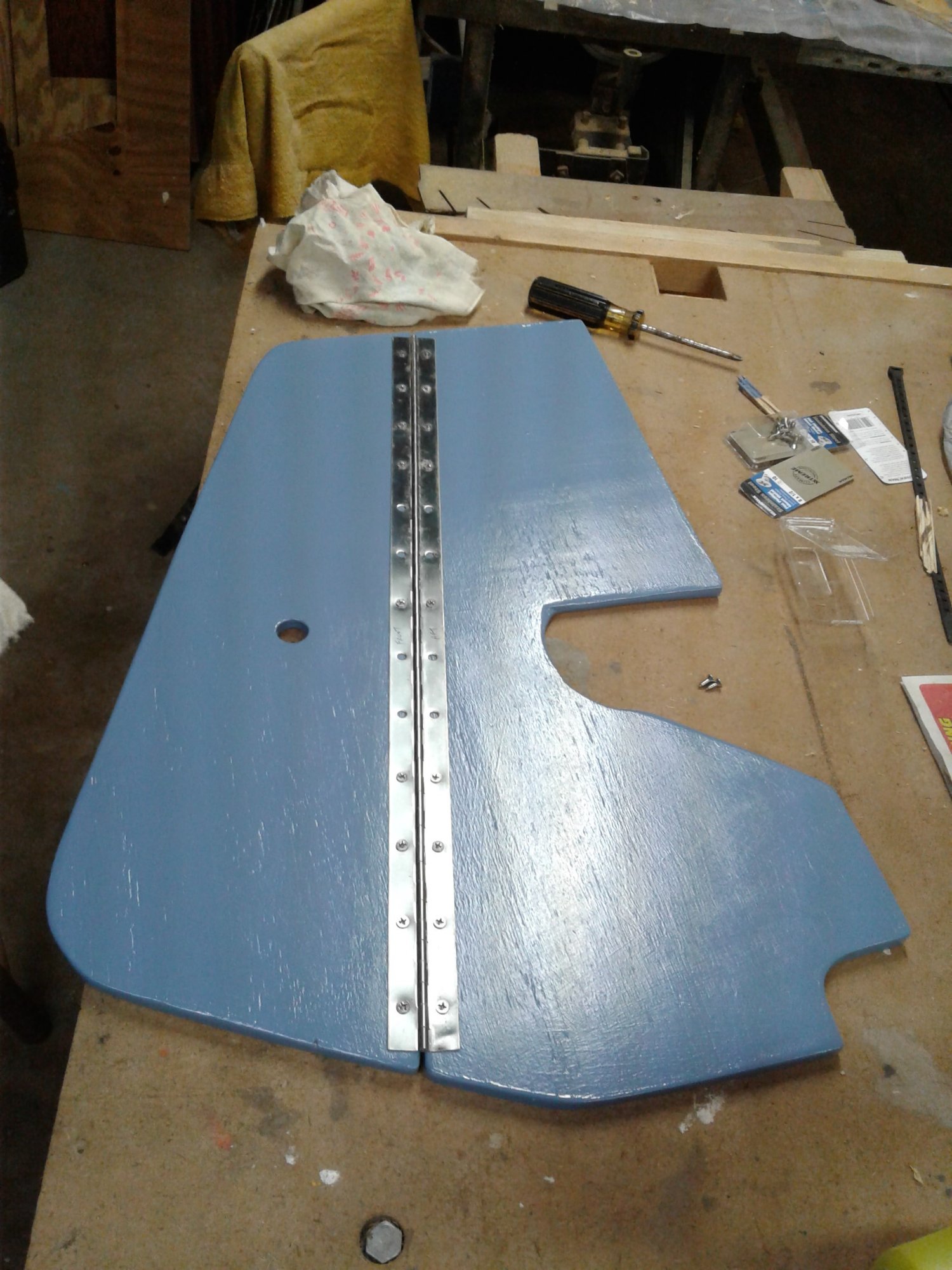

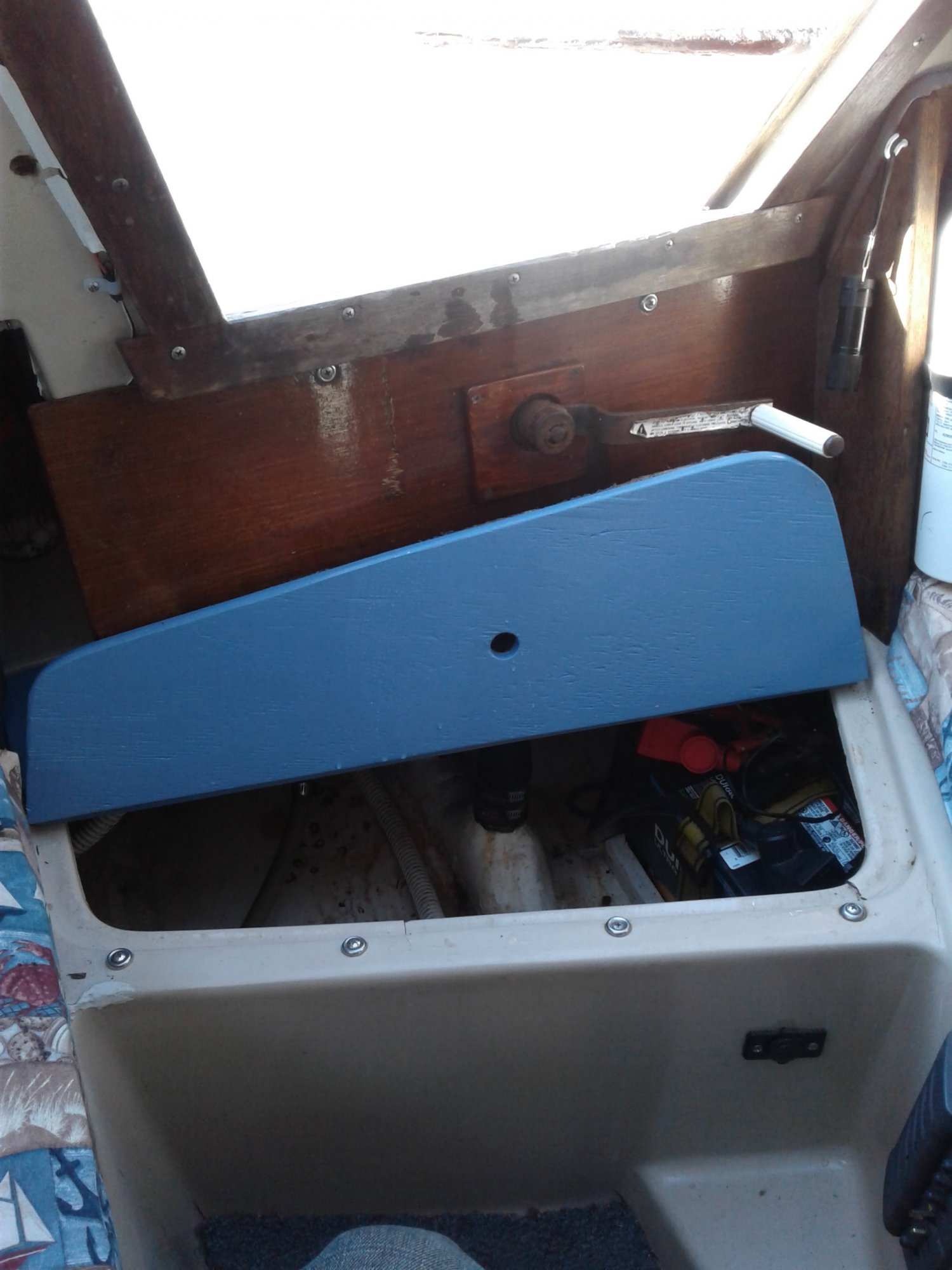

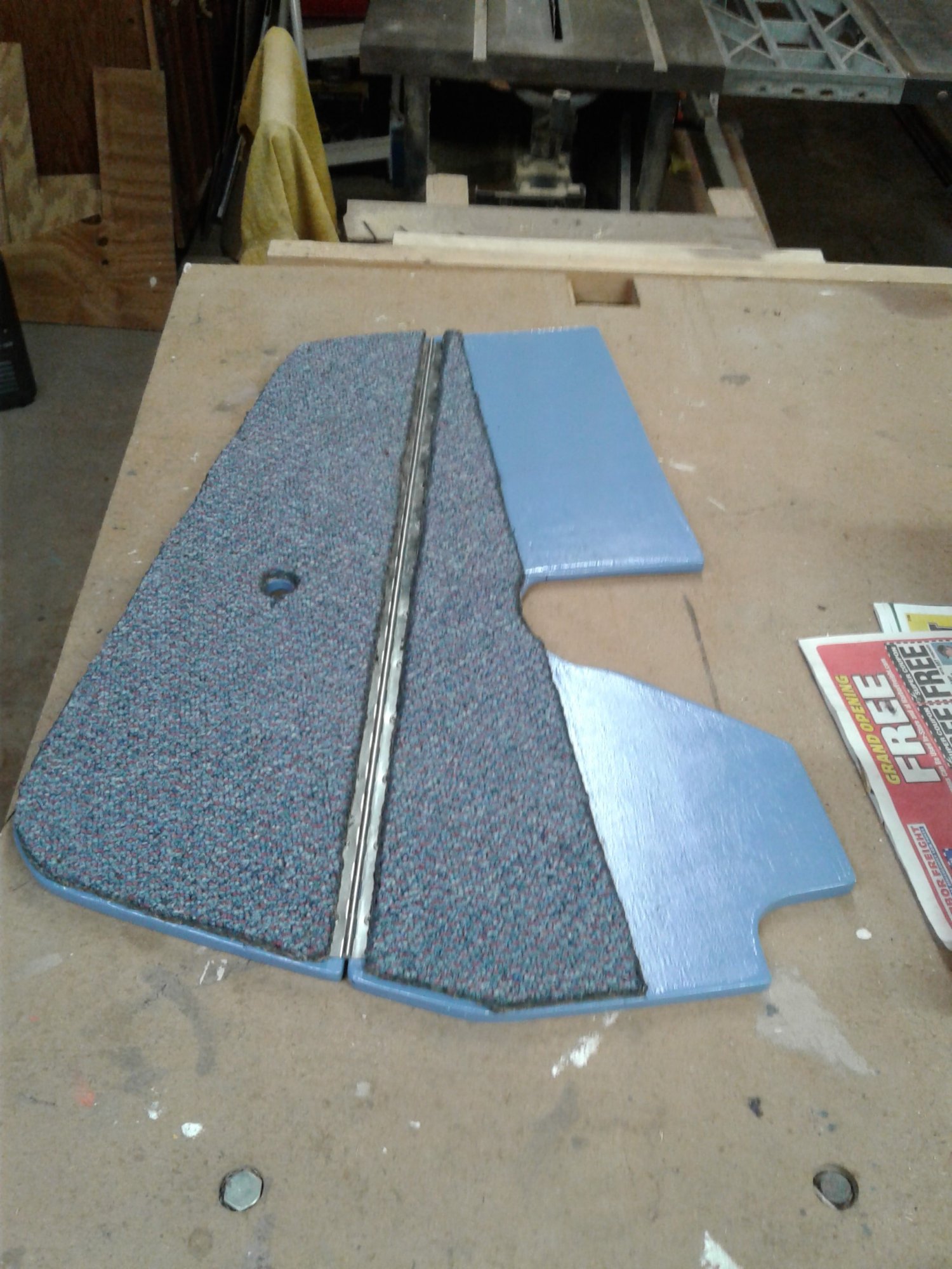

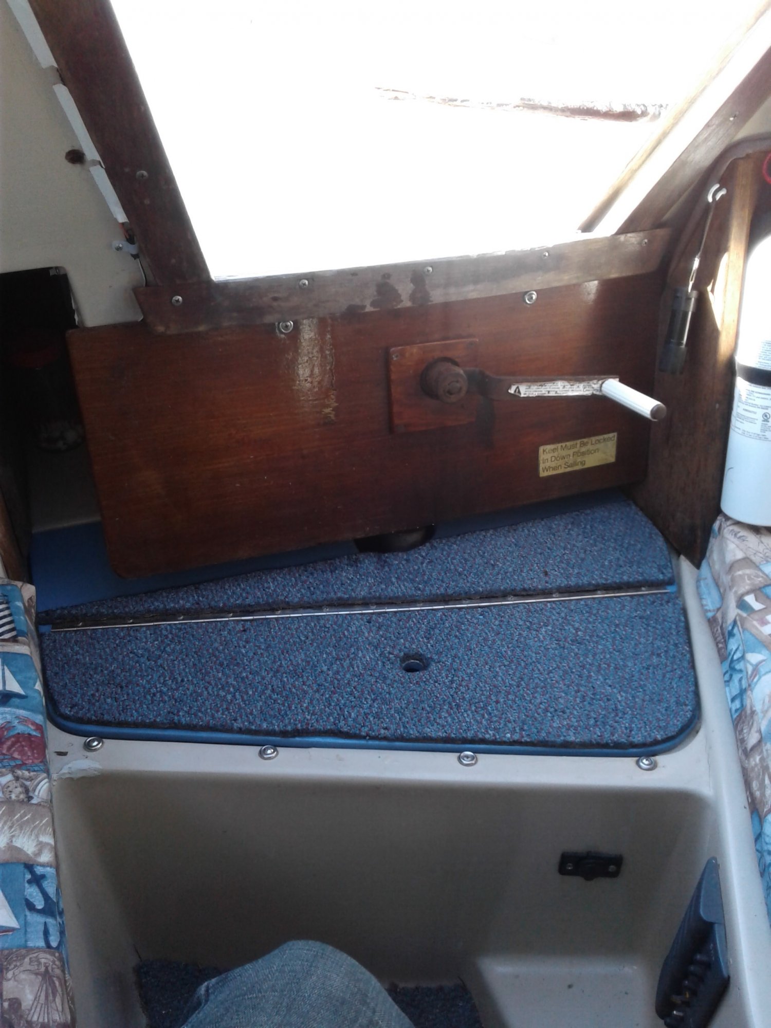

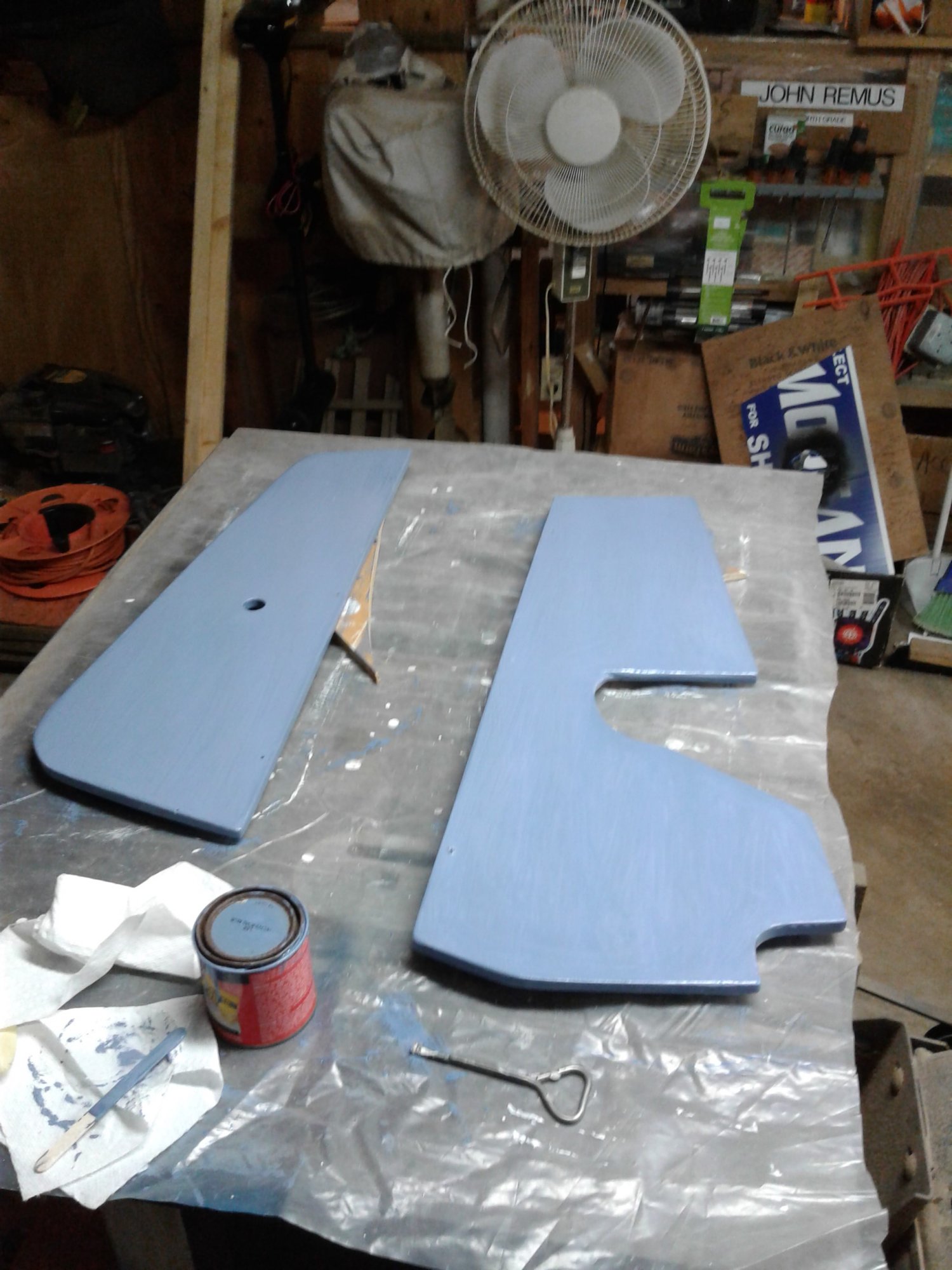

Might have forgotten to post this modification of entry step so can see battery, bilge without having to remove step. Piano hinge down midline. Finish pix below, step by step available on request.
AaronD
Aug 10, 2014
774
Classic Yachts 26 Newberg, OR / Shelton, WA
Was that not a stock feature? Ours has a similar piano hinge, and I always guessed it was original. But the hinge and the step are both aging, and I know I'll have to address it someday. So "Yes, please!" to your step-by-step instructions.

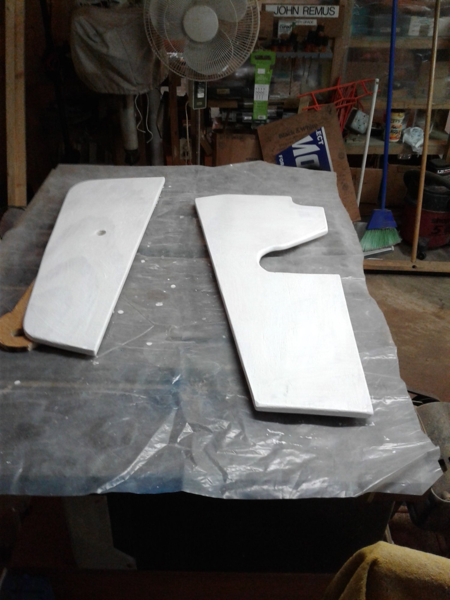

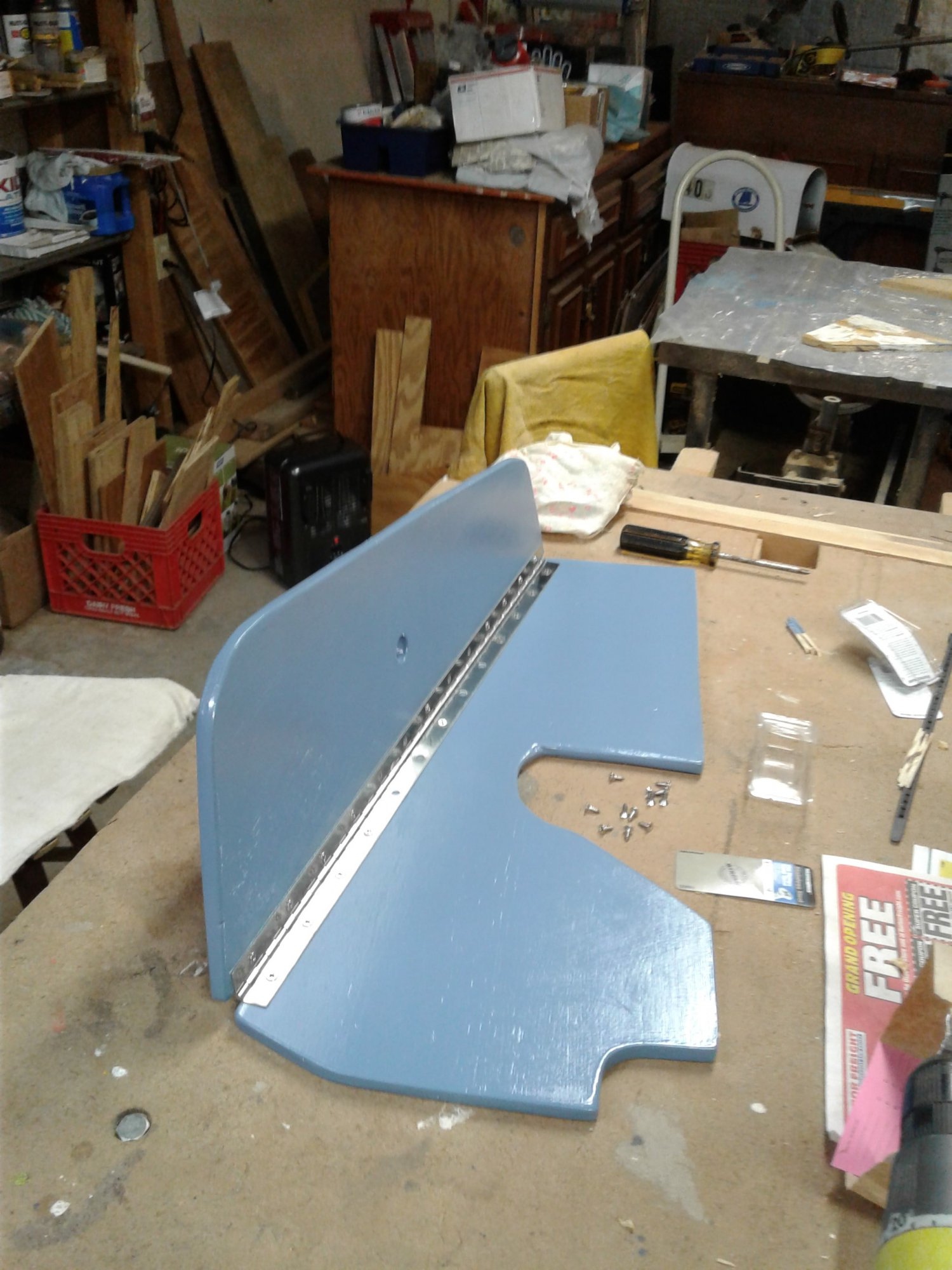

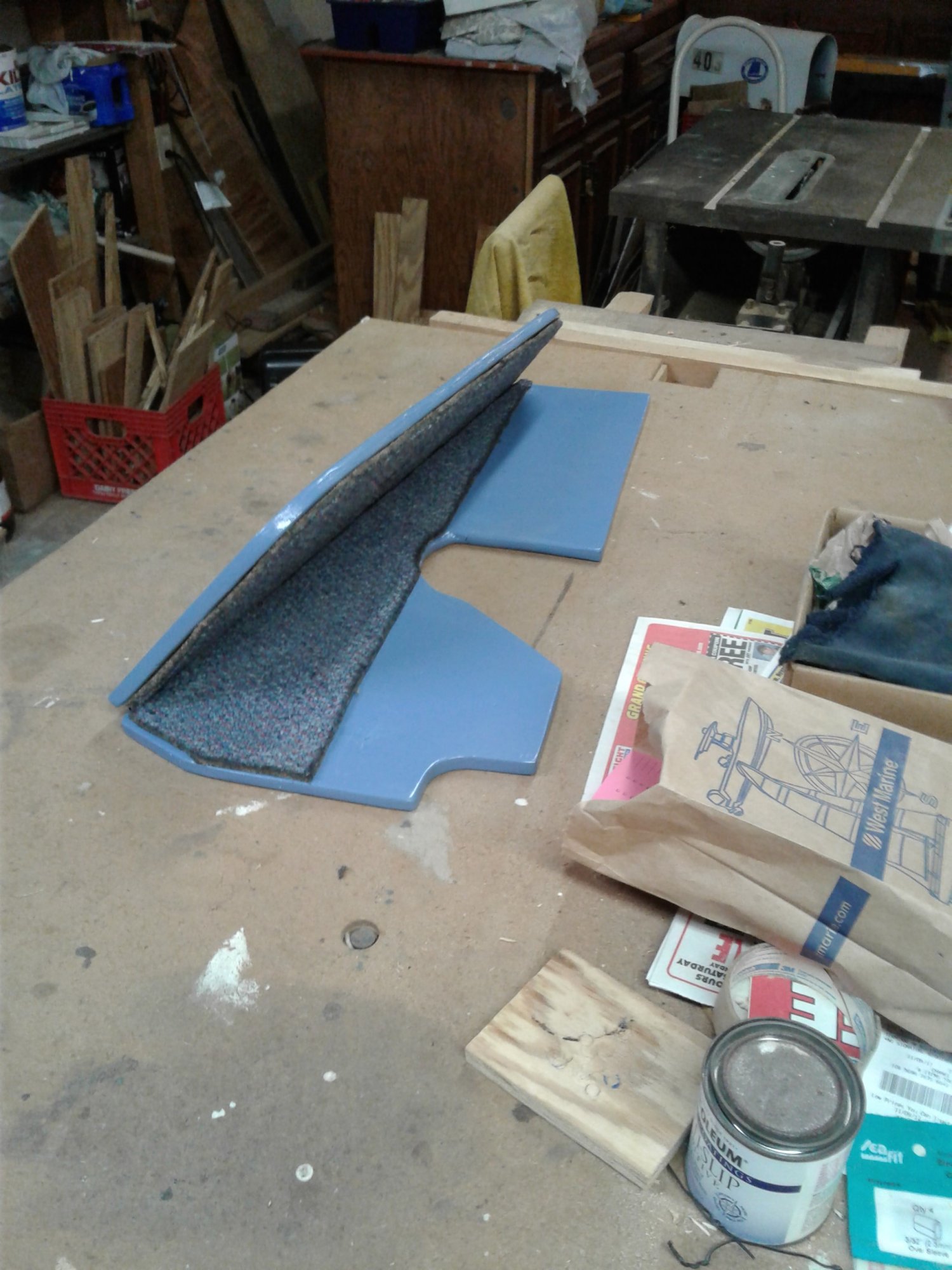

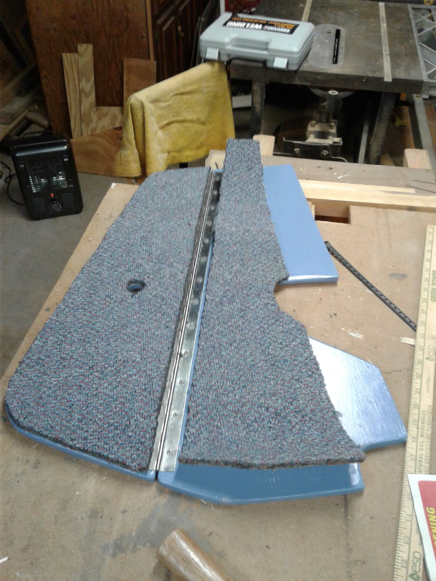

Not standard that I have ever heard of., but have seen various iterations posted. My original step board was badly damaged and beat up so replaced it in process of producing the hinged version. Steps seen below:
Carpet matches floor carpet in cabin.

Feb 28, 2022
213
Catalina 22 12482 Champaign-Urbana, IL
That's a really great idea. My board is really awkward to get out. I think when they installed the fire extinguisher, they put it too low so it blocks the board.

Yep raise the extinguisher, dont want any impediment to reaching down into bilge, battery area etc.

Also if you have to remove the step board it is much easier folded and pulled out then as one piece.

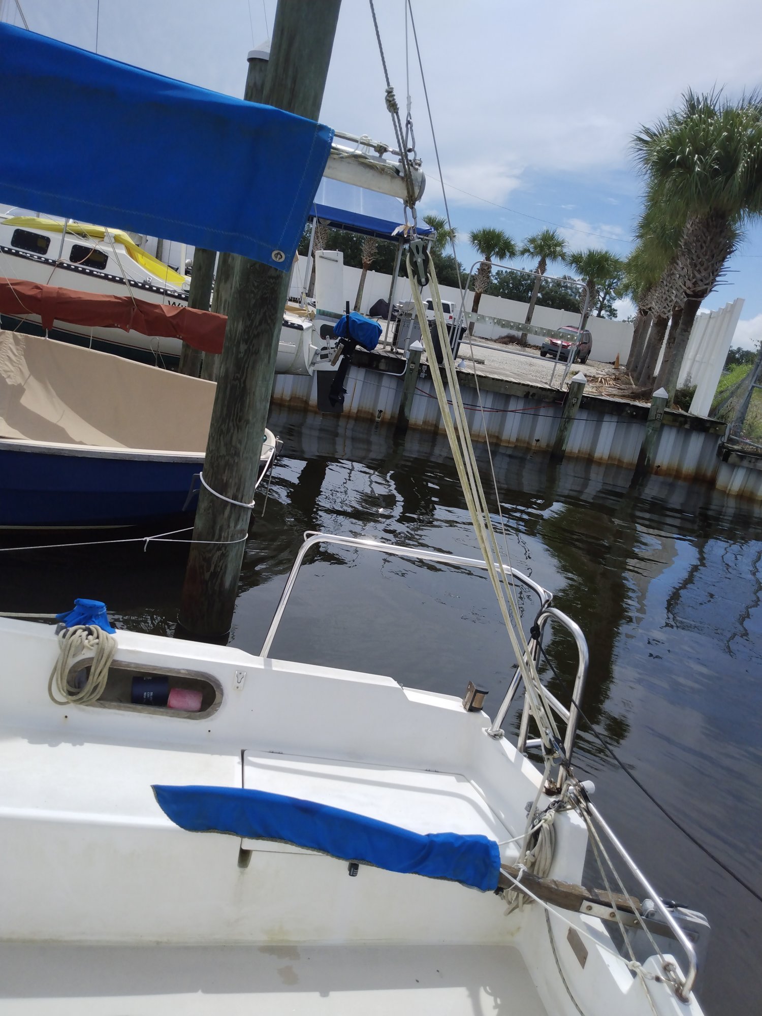

For those seeking ideas, here is my 4 line mainsheet setup on my 83 cat 22.
