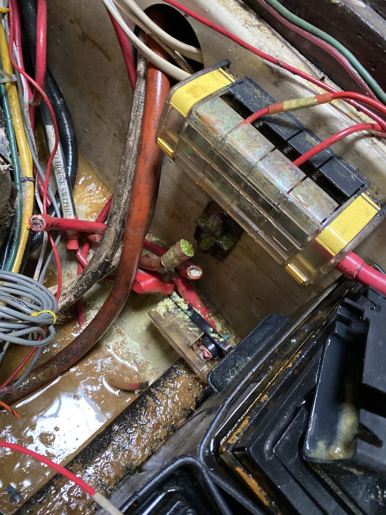

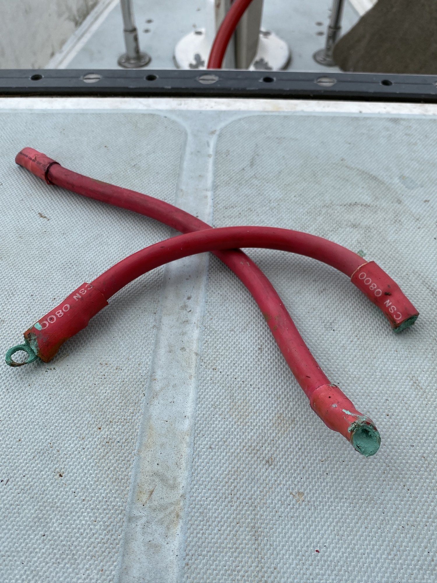

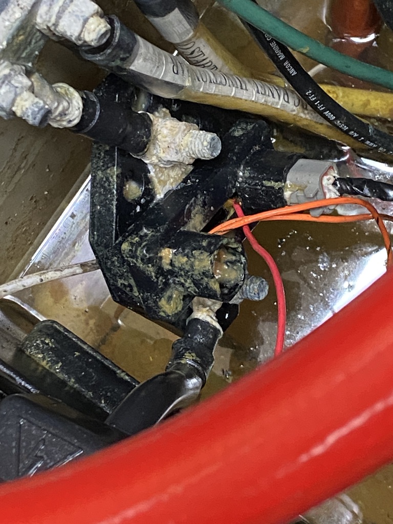

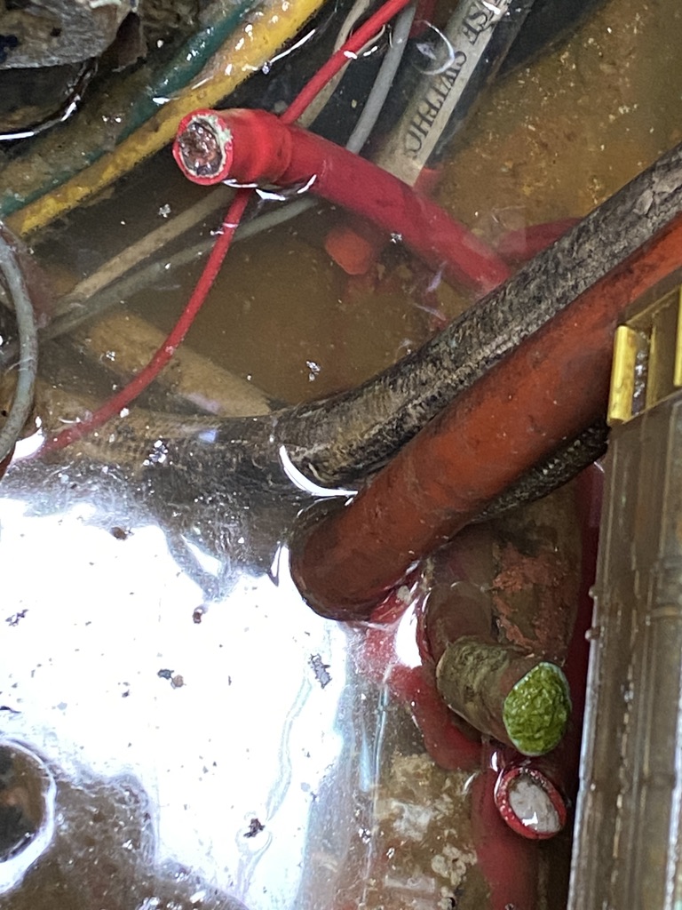

The conductivity of salt water is really destructive.
These images are of the Positive power cables. When the water flowed up and over the batteries. They shorted out and burned off the lugs. The Blue Sea power busbars were destroyed. New electrical cables are in the near future. At the least I will have the sizes. The silt/mud is an annoyance. It is everywhere under every thing.

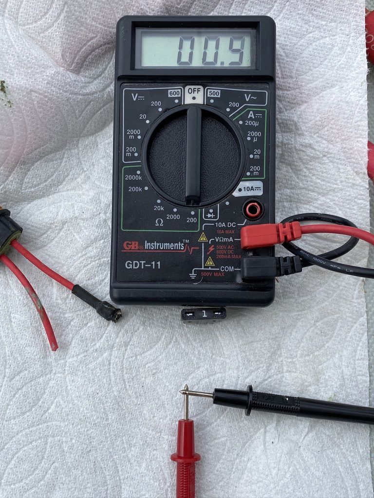

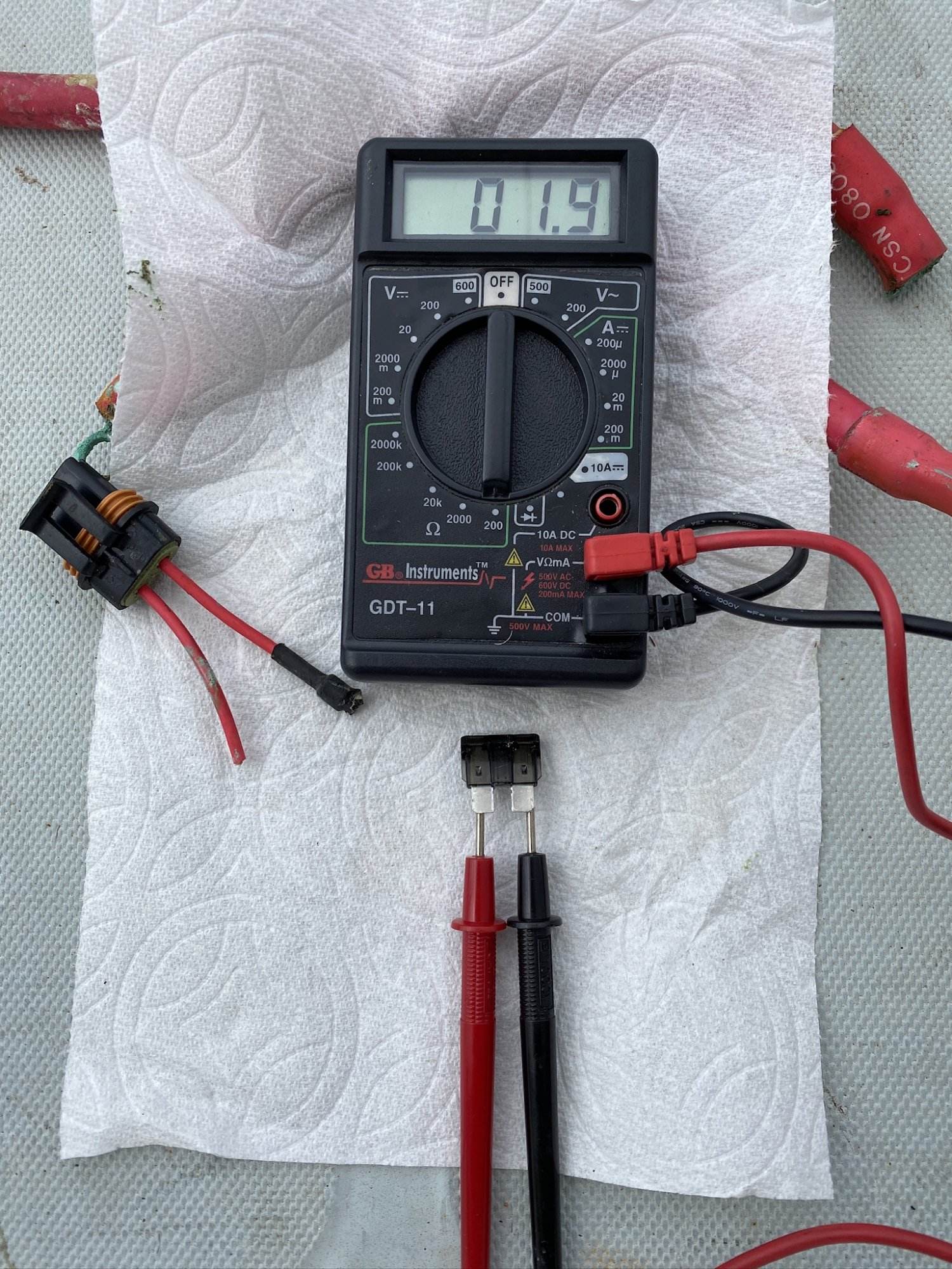

I thought this was interesting. The fused cable connectors were destroyed in the electrical soup. Yet the 1 amp fuse is still good.
