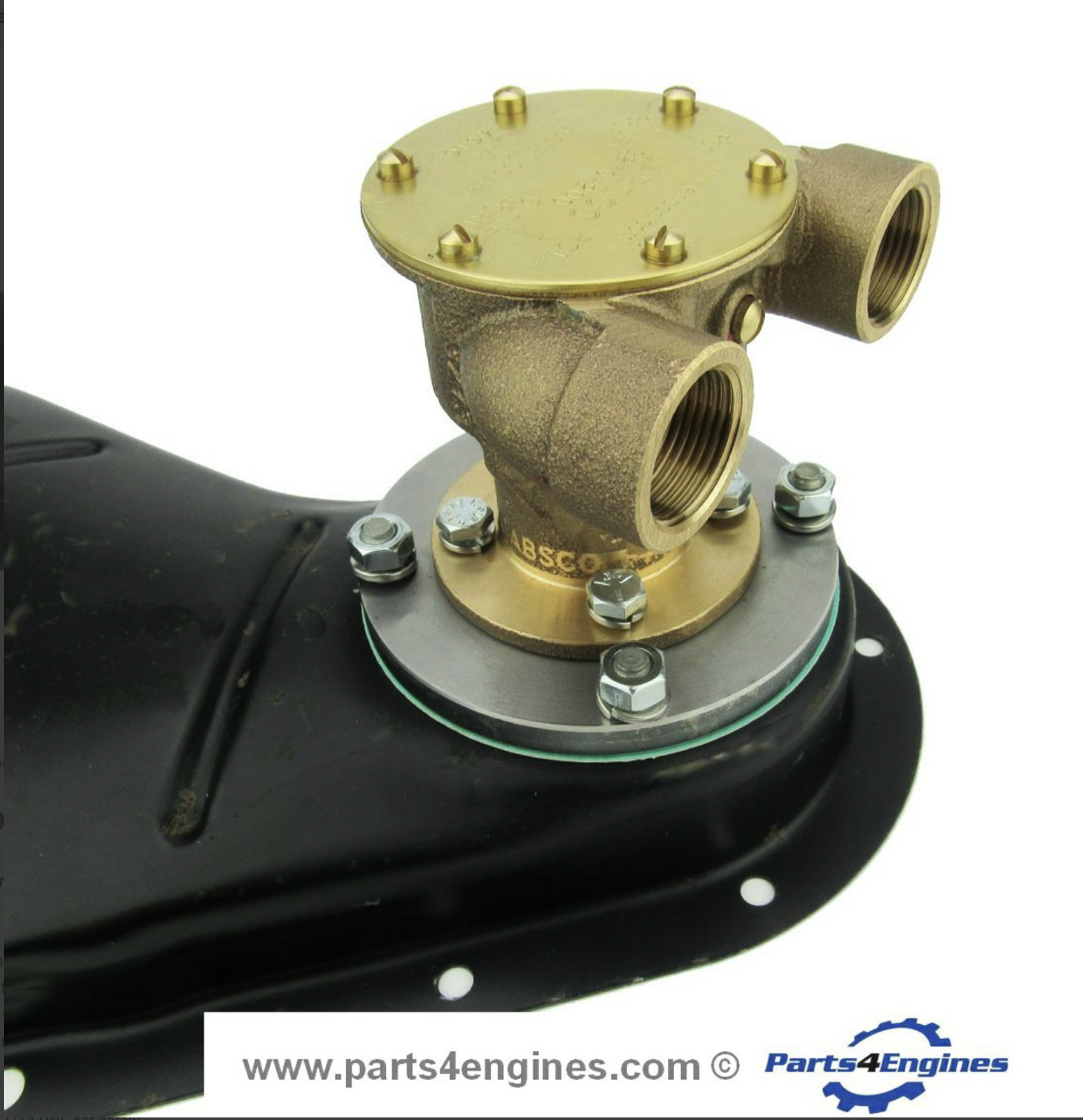

Just for info on his water pump.

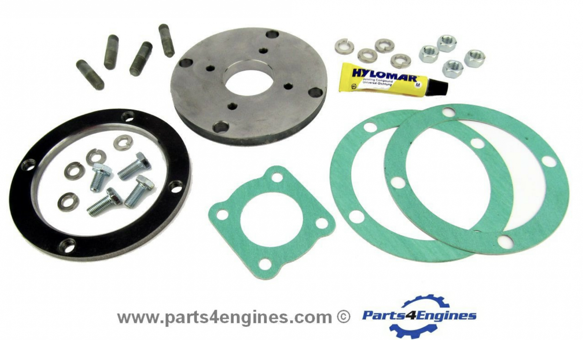

Gaskets

At this point why not just buy and slap in a new water pump and then rebuild the old one at your leisure and save it onboard as a spare?

At this point why not just buy and slap in a new water pump [$475]
His issue is the Sherwood G65 water pump Lip Seal.
I helped his search and found one for $25.
Lip Seals wear out over time.:mad:
His impeller looked good.

Other parts in that pump also wear out over time, which is why carrying a spare for that particular item isn’t a bad idea if one is planning to go cruising. Hence, my suggestion to slap in a new pump to finally get the engine operational and rebuild the spare at his leisure.
But at $475 not the cheapest option.
