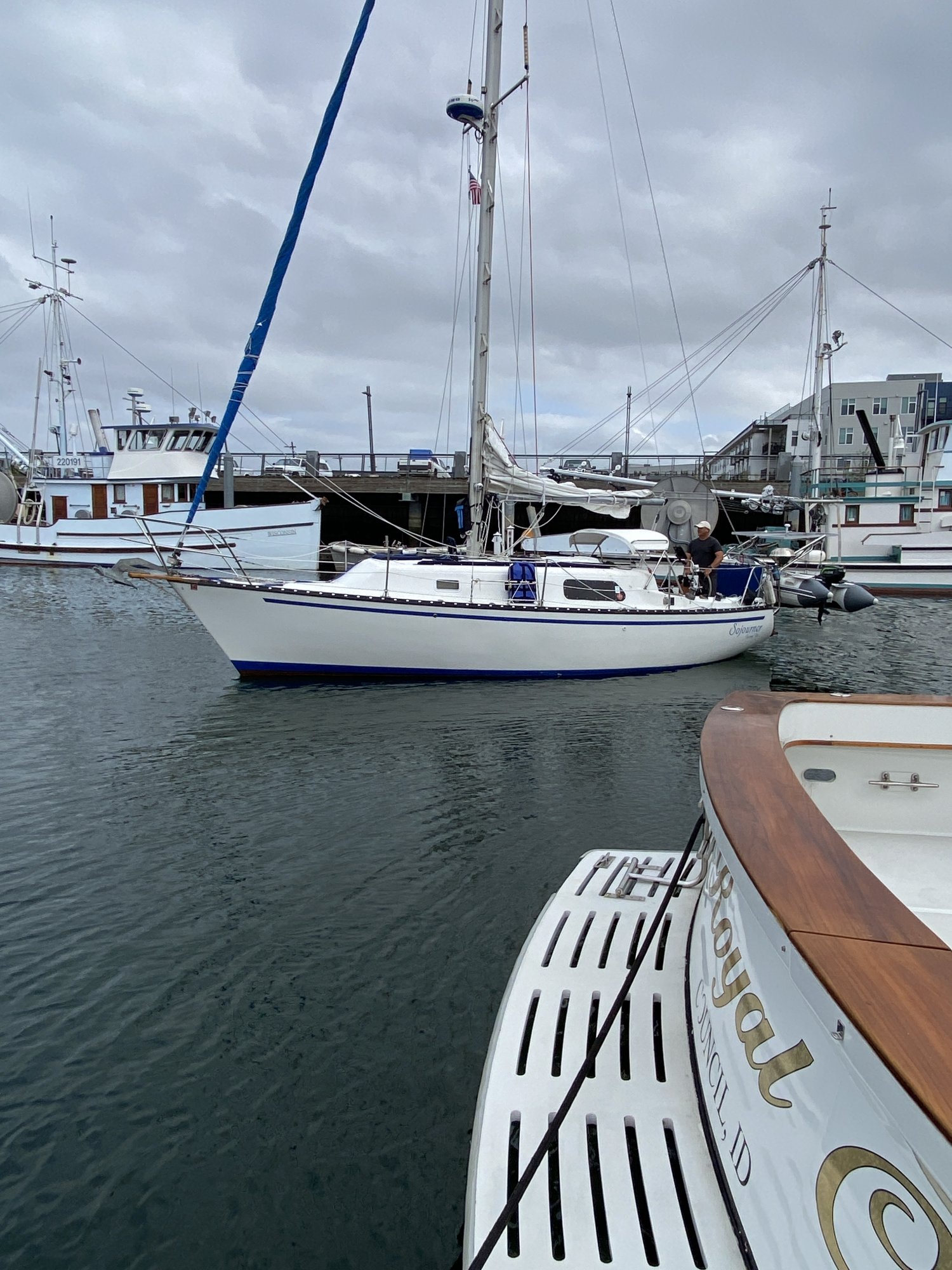

@MikeHoncho spent a couple nights in Everett. Was here on his way home from a much needed sailing cruise.
Here he is backing out of his slip heading for home.
As a visitor we made sure give him a bit of wind to challenge his boating skills in tight quarters.
Then we arranged for the wind to blow on his bow for the first couple of hours as he worked his way south.
That may be called "skill checking"....
