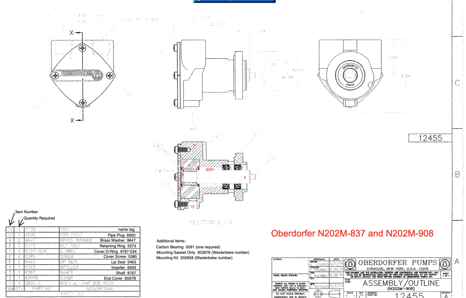

And when you add to all of the other advantages of the Oberdorfer that it doesn't require a gasket for the impeller cover plate due to the addition of an O-ring it is so much easier to service.
24,453
All the info about an "Oberdorfer pump" sounds great. I could not find a site with information about a match to the Perkins 4.108/4.107.

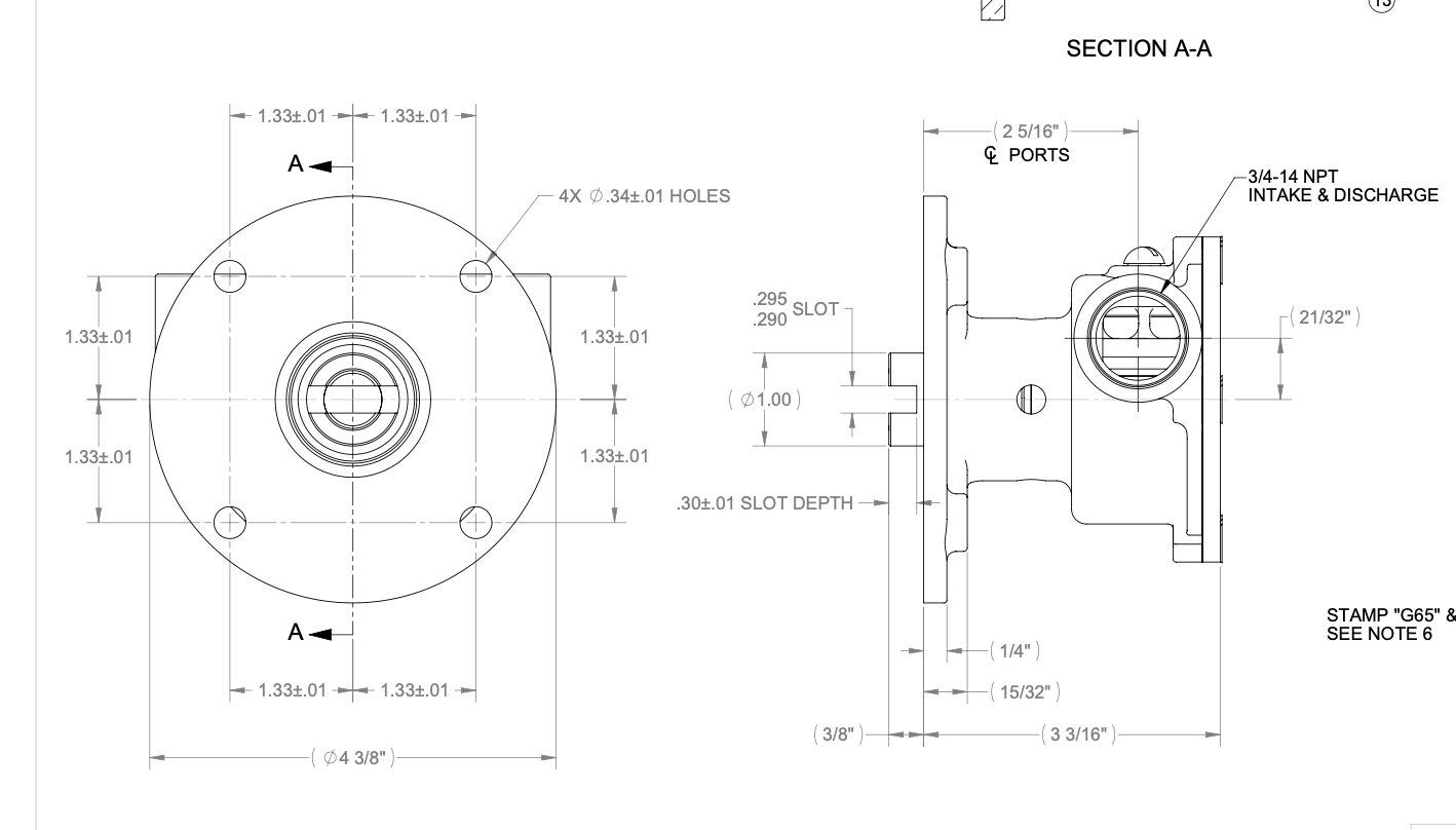

Here is the Sherwood G65 design drawing. Looks similar in simplicity to the design drawing of the Oberdorfer. (see attached PDF)
It is said, the devil is in the details. The Sherwood design has 4 bolt holes that attach the pump to the engine block. The pump is driven off the high pressure fuel pump shaft. That shaft is gear driven by the Engine cam shaft.
Sherwood G65
When reviewing the Oberdorfer pumps I can not find one that mounts to the 4.107 engine.

Kinda almost the same but very different.. In order to make it work, a new custom shaft (longer and with a male drive end.) would have to be machined then an adapter plate to mount pump to engine.(with a boss to engage the engine side seal). . I reckon that would cost $300-$400 to have that done at a good machine shop.
I rebuilt a couple of the Oberdorfers for buddies with Westerbeke engines.. we changed the bushing from carbon to oilite bronze and put an old fashioned grease cup on the bushing so we could grease the shaft by screwing the cup down a half turn or so every now and again.. We sourced the lip seals locally from Motion Industries once we had the dimensions. That was back in the day when I had access to some outstanding machinists..

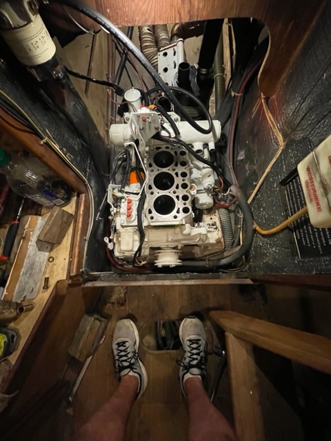

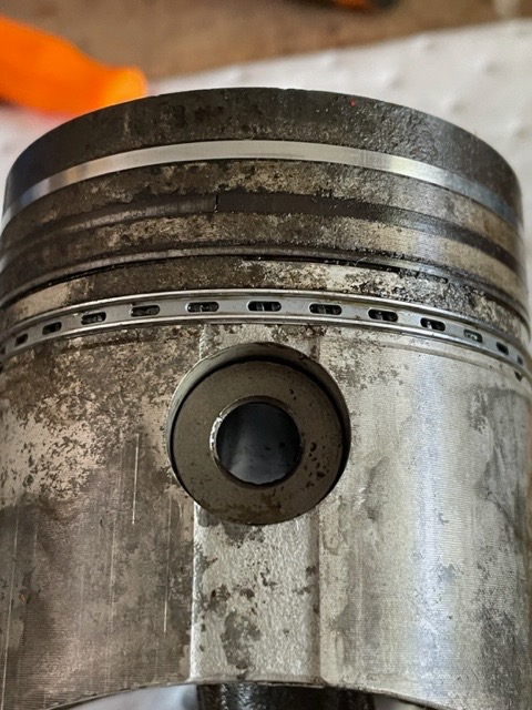

Wow, I'm way late on this thread but I found it while researching my own issues. I have a CD 30 with a Westerbeke W21A that had low compression. Had the head redone. Still low compression. Stuck rings? No way to pull this engine out of the boat. Most people offer that as suggestion #1. Not happening. I'd pulled the head 3 times before so I could do it in my sleep but dropping the pan and pushing the pistons out looked tough... it wasn't. A crow bar and a little manipulation of the engine mounts got the job done. Reversed the front mounting brackets to raise the engine higher and lower.
Rings were stuck in the grooves... big time! I soaked them for 2 months prior with Deep Creep, Mystery Oil, PB Blaster... compression got worse These rings were STUCK. It took hammers, and heat and chisels to get them out. NO amount of soaking would have ever freed them up. I'm about to hone the cylinders and install the pistons with new rings. I did it all in the boat. Sometimes you just have to be creative. I'll let you know if it runs.
