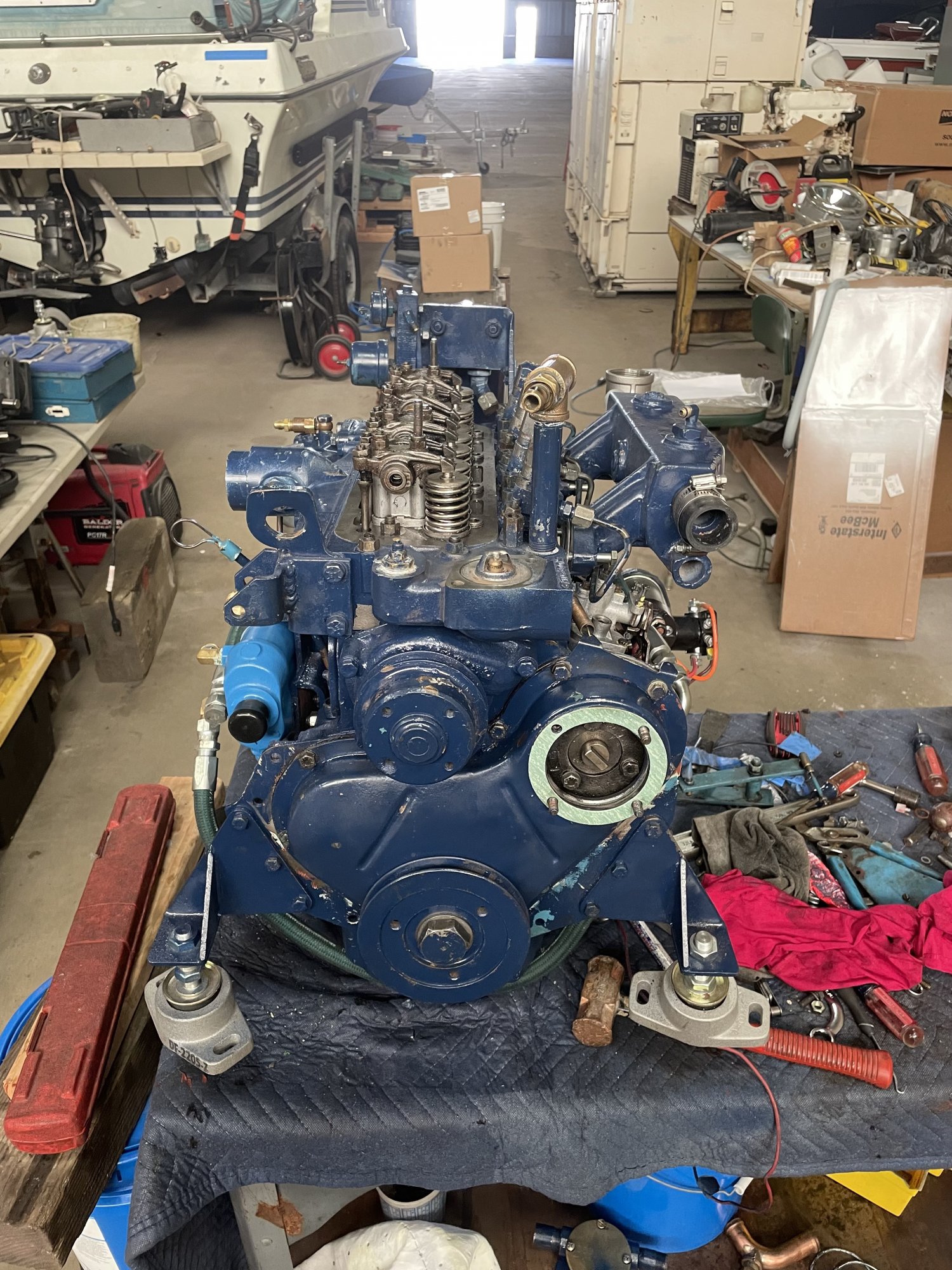

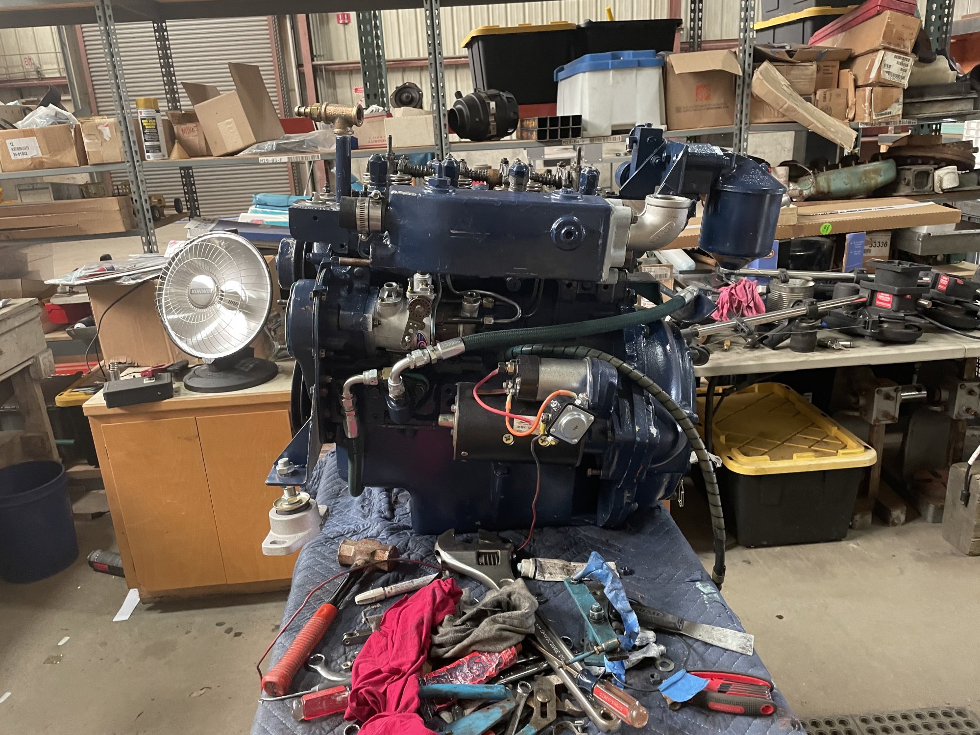

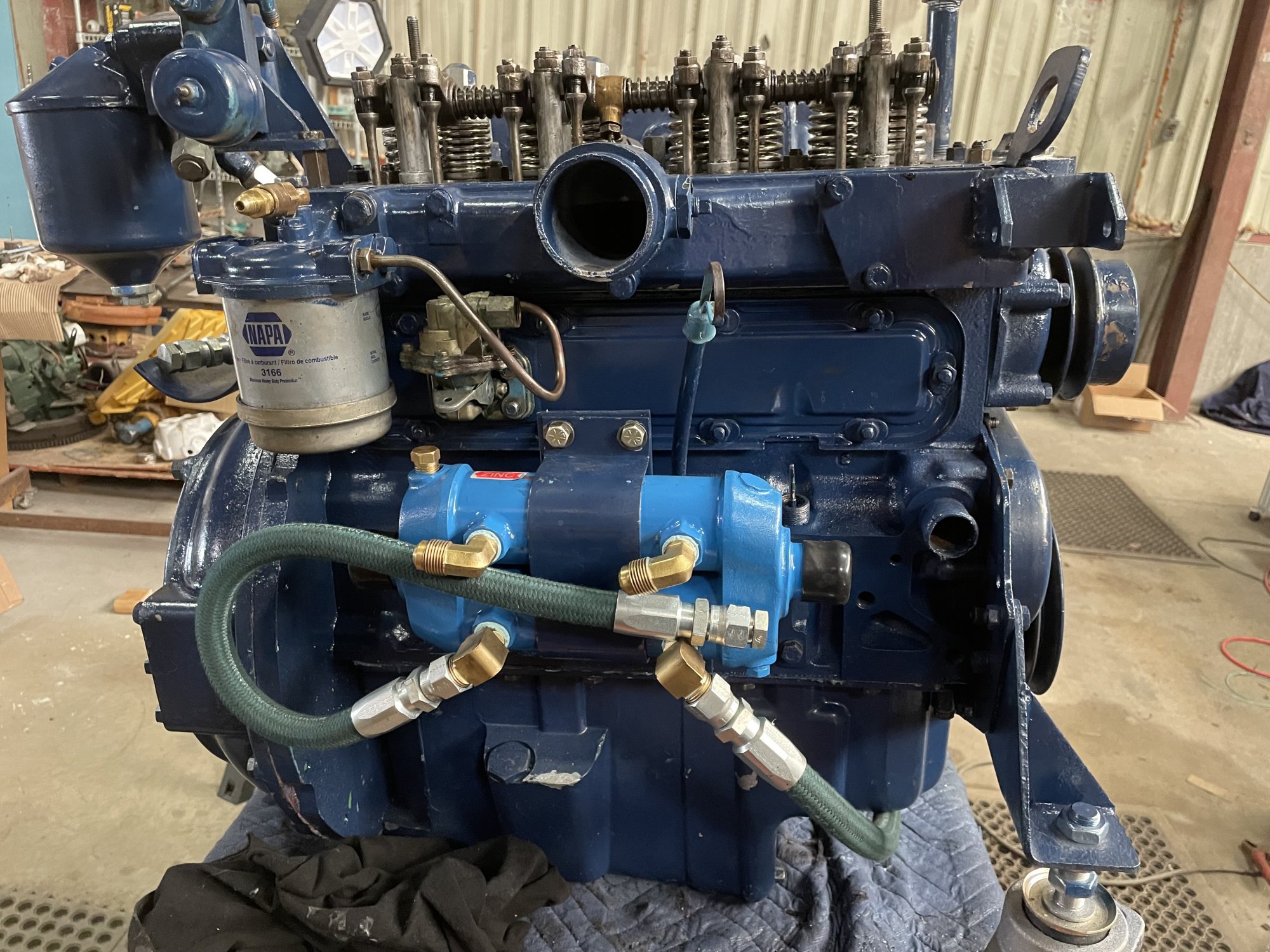

Well for the past several weeks I have been in a not going forward/not going backward situation. Kind of like the tides.
We spoke today and he has reassembled the engine. The injectors will be going into the engine this weekend. I told him to also add some of that magic smoke which escaped when the engine was in pieces.
My last post I mentioned the condensation/water that was found when the engine cylinder pressures were discovered low. He removed the pistons and sleeves, replacing them with new. The rings on two of the pistons were rusted in their slots. Reason there was no cylinder pressure.
By this time next week I have crossed my fingers in hopes of the Varoom return and a date to get the engine back in the boat where it belongs. Of course that would be a milestone, yet there will still be the installing of all the electrical and hoses. An of course alignment, testing etc before I can splash and get her back to the slip under her own power.
