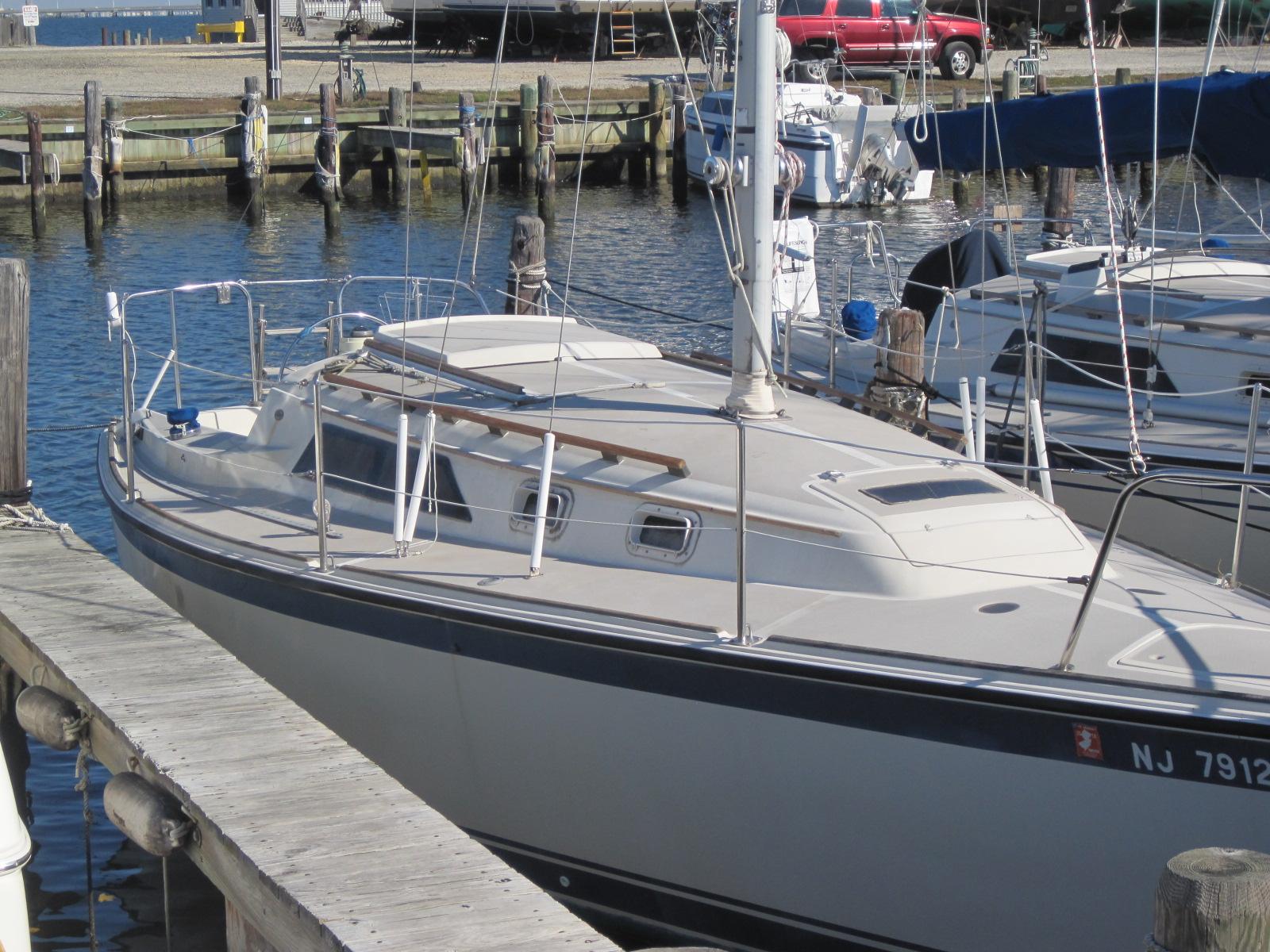

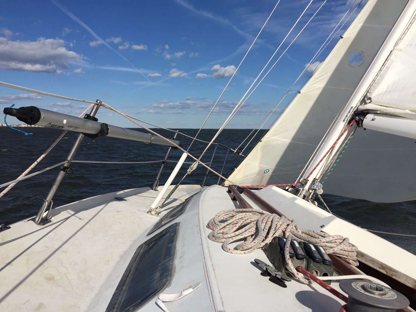

Correct, not everything has to come from WM. Shop at the SBO store first. For instance, this Selden telescoping spinnaker pole will serve you well. I bought mine from this store for less than $500. It is an excellent product. Sorry, I don't have a picture of it deployed, but here it is in my stanchion mounted chocks. If you have a ring or a track on your mast you are half-way there. ($4,000 is ridiculous). Although, while your mast is down, you may want to plan and install the exits and sheave for spinnaker halyard and topping lift to be run inside the mast.

This product is designed to be a spinnaker pole at the Design Length and it has 2 whisker pole settings. Read the info on it. I bought the one that is shortest for my boat so the spinnaker setting is just under the J dimension. I also did this for less weight. There are 4 positions: stowaway, spinnaker, whisker 1, whisker 2. I think the 14.7' length is adequate for wing on wing even with my larger genoa. On your boat, I suspect the model that starts at 9.8' length and ends at 17.2' length will work best. I almost did that myself because the spinnaker setting would be just slightly longer than J and if I really wanted to be race legal, you can use the stowage length (the shortest setting). Some folks don't like the push button settings because it can be dangerous to the finger tips. But OTOH, you shouldn't be adjusting the whisker pole under load anyway. Personally, I think this product is designed very well, it is plenty sturdy (if not a bit heavy), and I think that 2 whisker pole settings is all that is necessary. I don't like the twist lock features on other adjustable whisker poles and unlimited setting adjustments isn't necessary.

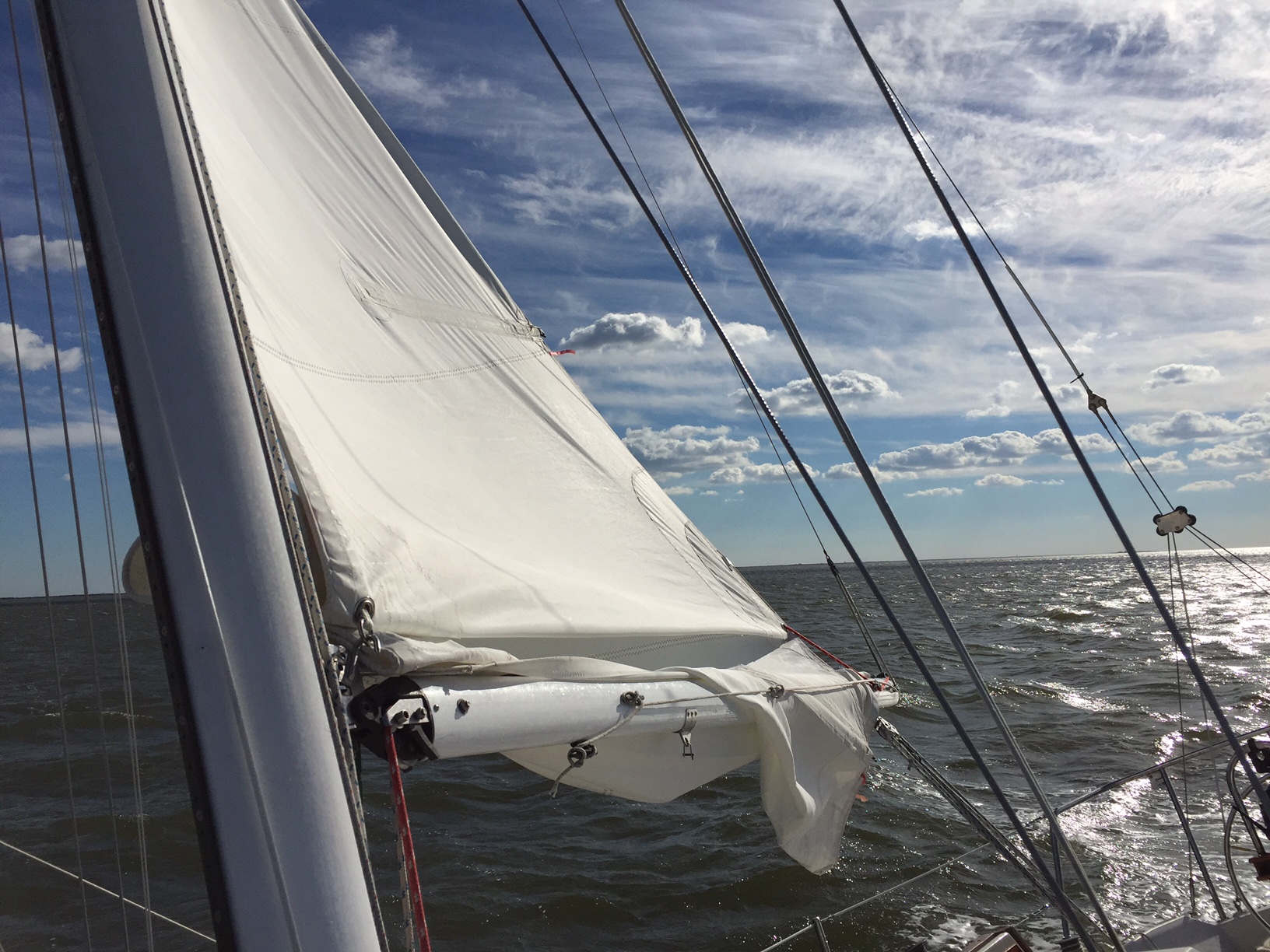

Like the others have said, to check what type of spinnaker it is just compare the long edges. If they don't match it's asymmetrical. No need for any pole if that's what it is. The pic below is what our 28 looked like with its
asym.
When looking for poles, if you do have a symmetrical spinnaker, be careful to get a true spinnaker pole, or one that is listed for either purpose. A pure whisker pole may be built lighter and may not be built to handle the compressive load of a spinnaker guy, especially on a reach.

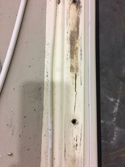

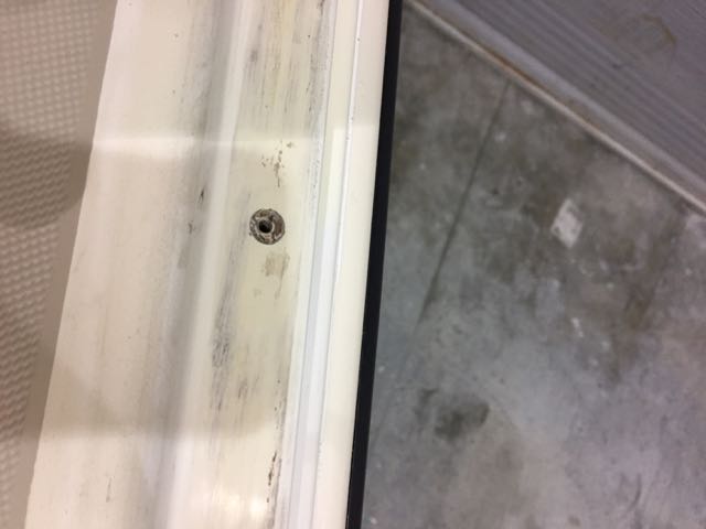

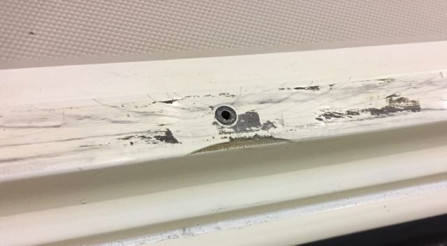

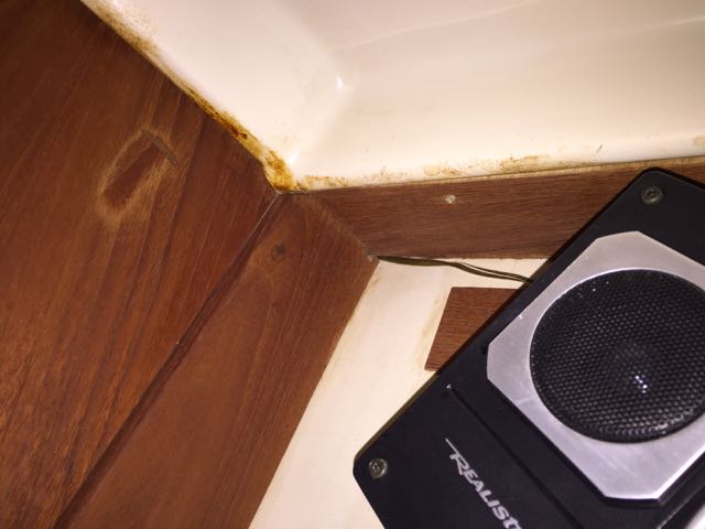

See the photos please. the toe rail holes show me some sort of flexible material residue around the inside of the hole where the removed screws came from. I might be able to dig this stuff out with a very narrow blade knife but it would difficult especially given the large number of holes to treat. U hate to make these holes bigger but maybe that is necessary. Do I countersink the top layer to remove the old flexible material? Also, i see some cracks in the fiberglass under the toe rail and some spots missing gelcoat. these areas will be sealed with caulk (or some sort) and a toe rail so how important is it that I regel coat them? do I need to do something
to prevent a crack from running?

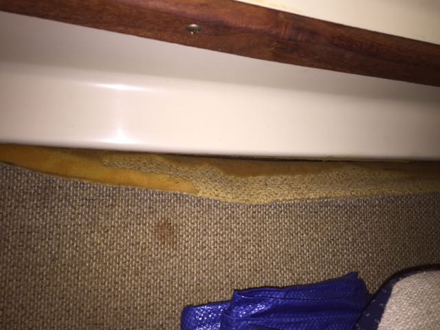

I had a beautiful inside of my boat's cabin. As I do the rebedding I'm finding to mess things up in and out of the boat. To get to the nuts under the bolts holding down the stanchions, I have to peel back the glued on wall carpet what was in very good shape. What do I use to glue it back when this all done? also on the mid-ships stanchion, the inside nuts are covered by a nice looking piece of wood. I unscrewed the screws holding it up and yet the piece is still lodging in place apparently by 2 vertical pieces of wood that must have installed after the wood that covers the stanchion nuts. I see wood plugs nicely finishing that vertical wood. Hate to remove them but I guess I'm stuck doing that. Any tips on how to cleanly remove them w/o damaging the look?

See the photos please. the toe rail holes show me some sort of flexible material residue around the inside of the hole where the removed screws came from. I might be able to dig this stuff out with a very narrow blade knife but it would difficult especially given the large number of holes to treat. U hate to make these holes bigger but maybe that is necessary. Do I countersink the top layer to remove the old flexible material? Also, i see some cracks in the fiberglass under the toe rail and some spots missing gelcoat. these areas will be sealed with caulk (or some sort) and a toe rail so how important is it that I regel coat them? do I need to do something to prevent a crack from running?
It is a little difficult to tell from your photos, however, it appears that the teak is screwed into a raised fiberglass toe rail like the one in this image. ‎imt.boatwizard.com/images/1/65/32/4496532_20131025123324821_1_XLARGE.jpg
If that is the case the question is what is under the fiberglass? If it solid glass, then clean out the old caulk and put it all back together. If it is a piece of wood, then it would be best to drill out the old holes, fill with epoxy and then drill appropriate sized holes. Drill out 1 hole to see what comes out. If it is wood cored you'll get sawdust. You will also know if the the core is wet. The sawdust should be dry and a light brown or tan. If it is wet or black, the wood needs to be dried out and sealed tightly.
Try using a utility razor knife to dig out the old sealant on the rail. The original holes were countersunk to form a better seal.
The standard method to fill the over drilled holes is to use thickened epoxy and a syringe to inject the epoxy in the hole. This is messy and tedious! I've been using West System SixTen epoxy. It comes in tube that fits into a caulking gun. It is a bit more expensive, but much faster and neater. Jamestown Distributors has similar product in their house brand for a few dollars less.

Yes it is a slightly raised fiberglass ridge that the toe rail screws into. How do you recommend I clean out the old caulk from inside the holes? it is too small a hole to fit a knife in. I'll try drill one hole to see as you suggest to see if I get sawdust. assuming I do not how do i clean out the stuff?
Use an oscillating tool with a saw blade and very carefully trim the end of the horizontal piece even with the vertical piece. When it goes back together fill the small crack with some brown caulk or just live with the 1/16" crack that will be there, only you will notice it. Those pieces are not structural, they just hide rough edges.
If that rail is solid fiberglass don't worry about the whats left in the hole. Clean the top of the rail and the countersunk area.

"If that rail is solid fiberglass don't worry about the whats left in the hole. Clean the top of the rail and the countersunk area."
Sorry, I'm confused. At this point, I've not counter synched these holes nor did the prior owner. You are not suggested I reuse the old holes, are you?
