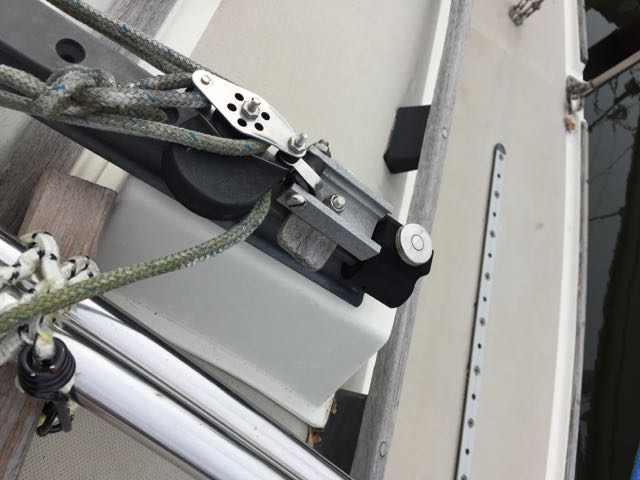

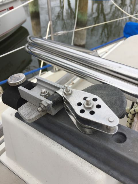

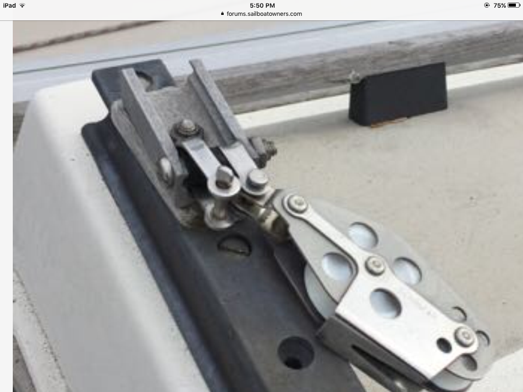

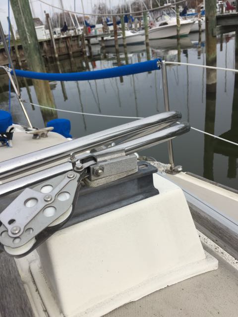

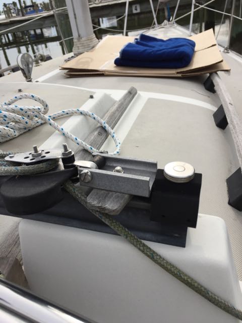

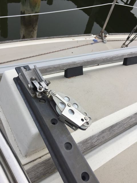

I heard back from Guido regarding a traveler for my 1984 oday 28. I like what I see and i just spoke with him on the phone. The next step is for me to go to the boat and determine how to remove the existing traveler. Does anyone have tips on how to do that? Here are some photos.

that is what I was thinking. Could it be that the bolts and embedded in the boat and stick up for the traveler to be attached and snugged down with nuts? That would be simple at least It seems too insecure

As for your traveller. Look underneath in the cabin, are there plastic plugs in the headliner? Or a plastic plate? If so, take them out and you will probably find the other end of the bolt.

You should have cover plates inside the cabin roof underneath that raised platforms the traveler attaches to. Remove the plates and you should have access to the bolt that holds the traveler on.
