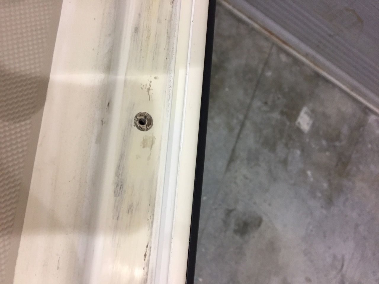

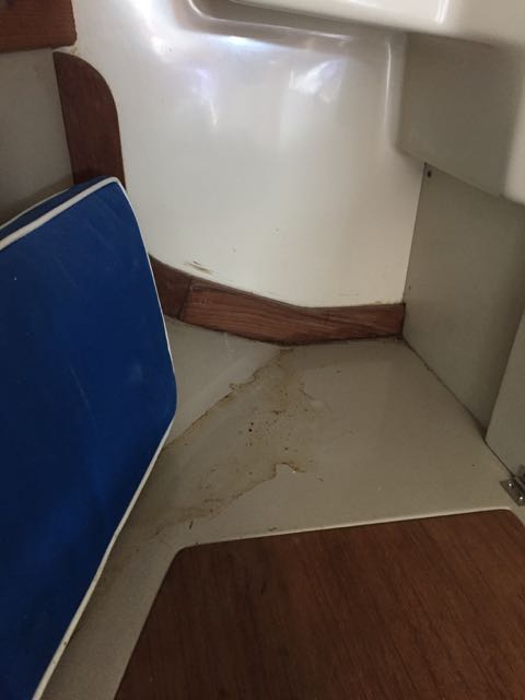

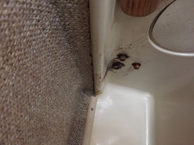

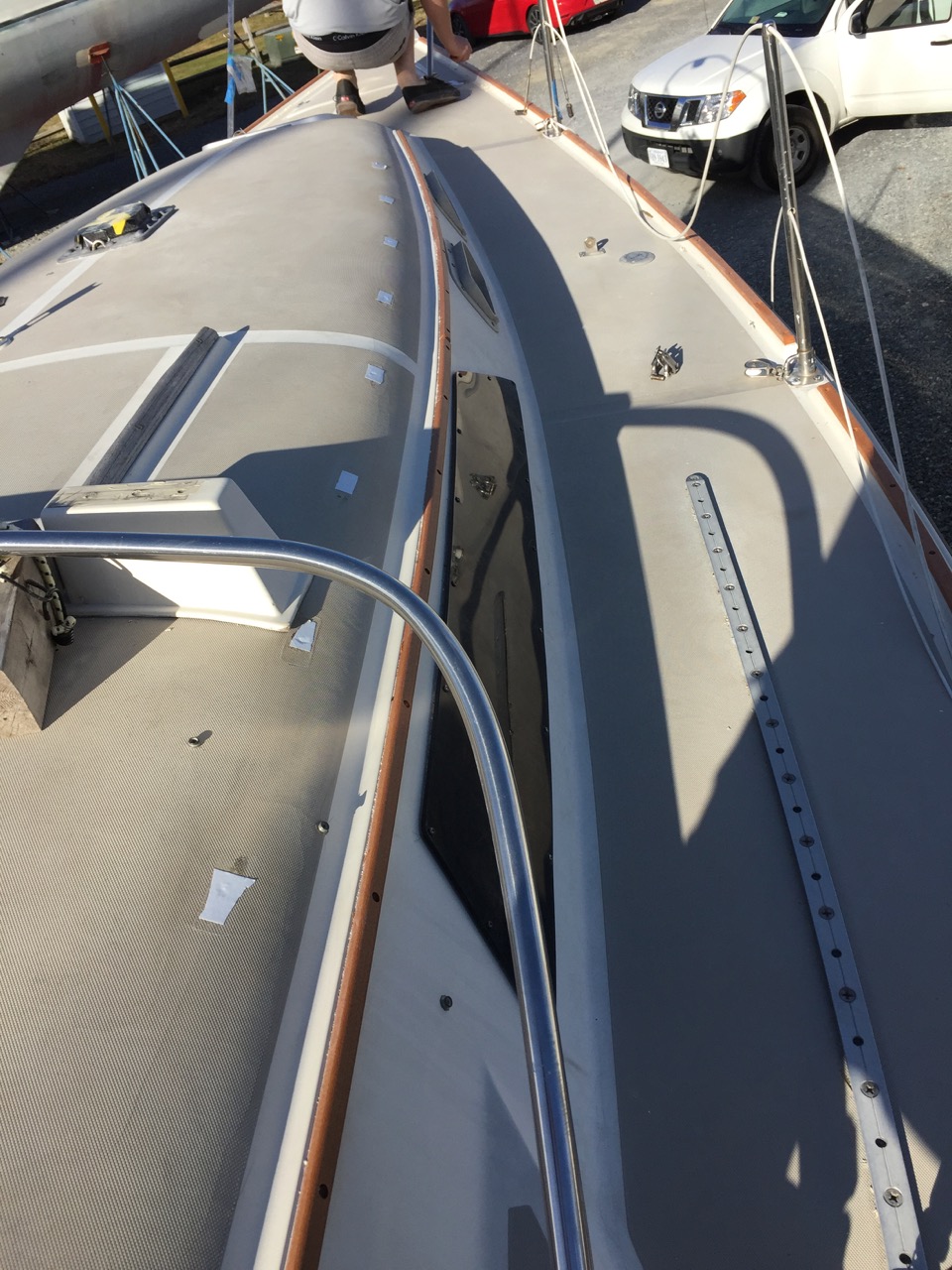

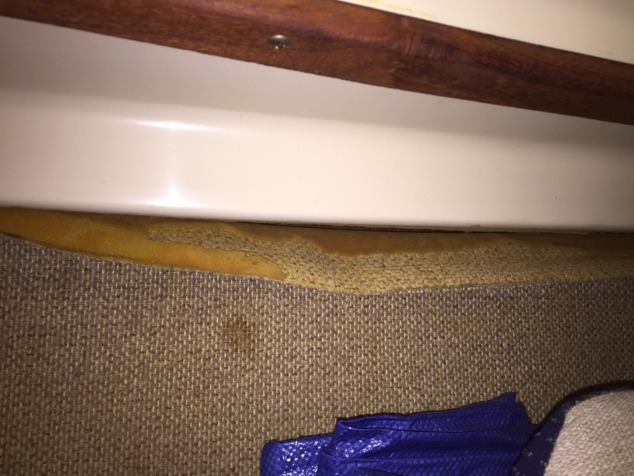

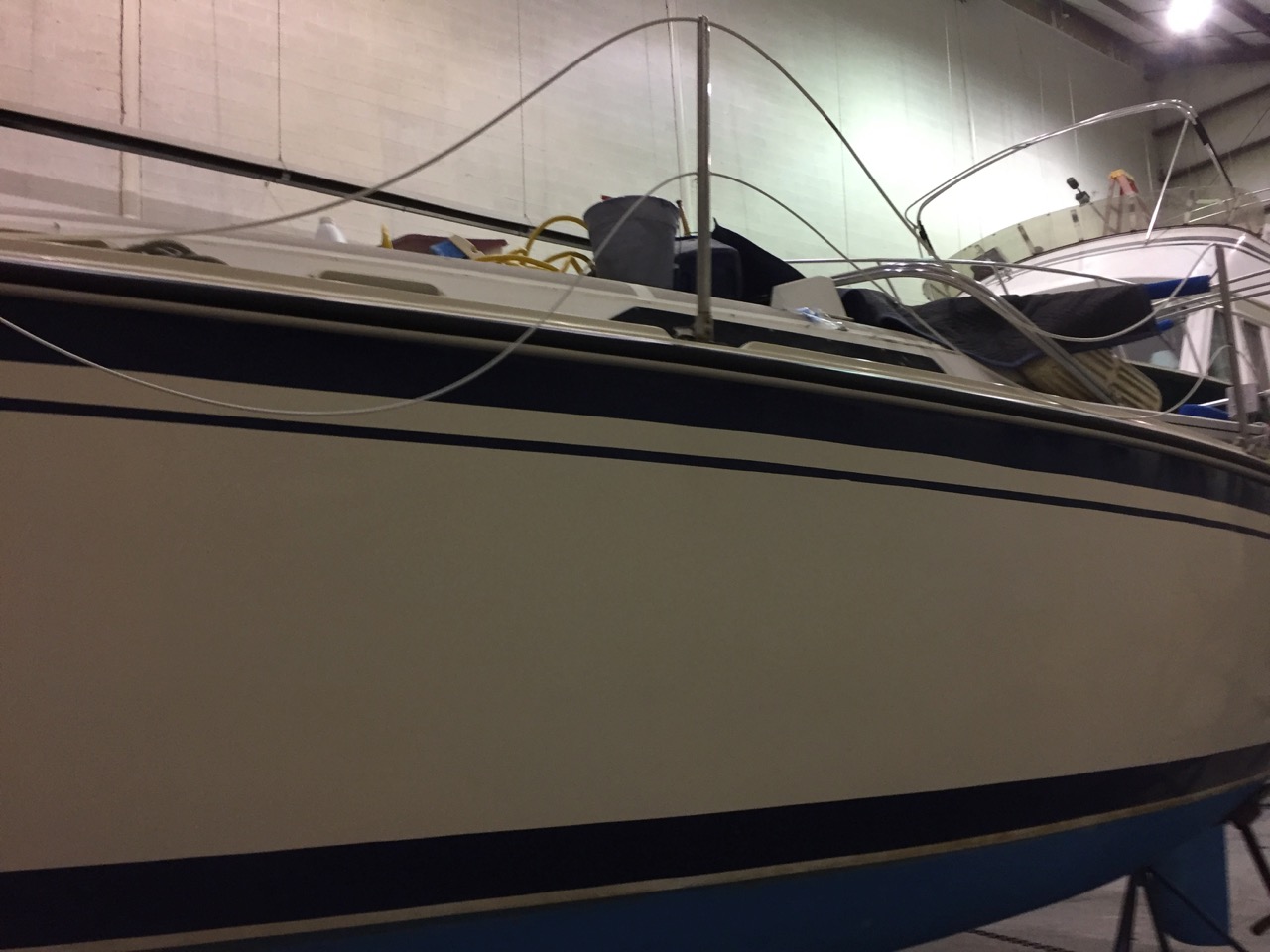

I just discovered a new leak under the starboard side forward most post of the stern pulpit. Photos attached. I can easily get to this inside the boat but 2 of the 3 aft-most posts on the stern pulpit are not accessible from inside the boat. The only possibility I can come up with is to open the tiny sealed hatch area on the aft part of the cockpit starboard side (an area made to store some ice and a six pack), cut a hole in the vertical aft side to get access and then cover it with a removable inspection port. This leaves only one post I cannot get under. For the moment I'm just finishing huge volumes of boat work and want to sail. Options I'd like to do (wa
nt your opinion on) are: (a) loosed and rebed just the one post I can access easily assuming there is sufficient flex in the stern pulpit to lift it off the boat and enable me to epoxy, drill out and caulk to reseal it; or (b) try apply sealant to the top most outer bolt heads and post mounting. Here are some photos.
