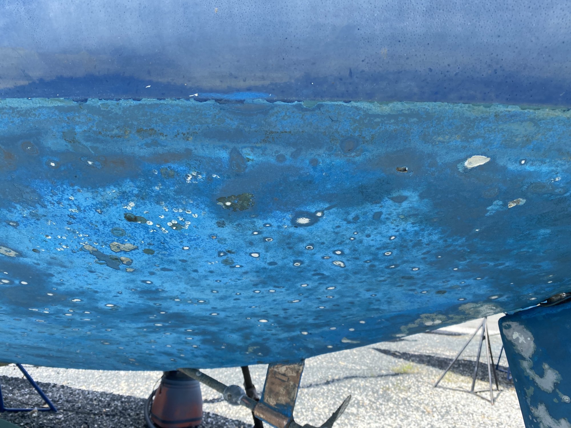

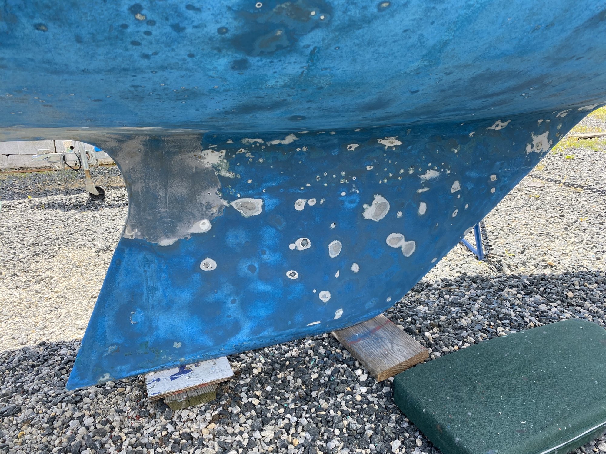

Hello all,
We hauled our Catalina 27 for its first power wash since we bought it - giving my wife and I our first clear look at the hull of the boat. As expected, it's got some blisters (no surprise there, as it was built in 1985).
My question is this: how do you know when a boat NEEDS a new barrier coat? The sanding is just about done, which has exposed numerous blisters. Outside of the time required, the marina is recommending around $3,500 to soda blast the whole thing and apply a new barrier coat. The alternative, I assume, is to let things dry out, throw some epoxy on to cover the exposed glass, and forego a complete bottom job. It doesn't sound like there are any structural issues at this point in time. What's the down side, outside of the tedious task of carving out and filling the blisters?
For context, we're not racers or anything. We're just looking to have a good time together, be as smart as we can with money spent on repairs (maybe we shouldn't have bought a boat, ha!) and avoid putting ourselves in any danger.
Thanks!

Ouch!! Is the blistering and loss of barrier coating on the keel only or also on the gelcoat? If limited to the keel, then that should be a lower cost repair and I would do it. If it includes the hull I would also do entire repair. To answer your question about how do you know when a boat NEEDS a new barrier coat suggest reading the thread entitled "Do I need a Barrier Coat" and other links below.
During the survey of my 2005 Hunter 46 in December 2018 I found the keel barrier coat had totally failed due to neglect. So the boatyard sanded it completely, put 5 or 7 coats of epoxy barrier coat then put 2 coats of antifouling paint. Of course, I got a repair allowance from the seller for sanding and applying new epoxy barrier coat. The forum will offer their experience, especially those who clean boat bottoms.

Look at glass bead instead of soda. Less residue left on the hull.

If your boat has or develops a significant amount of hull blister, time to do a barrier coat. I dont think that a barrier coat ages out.
