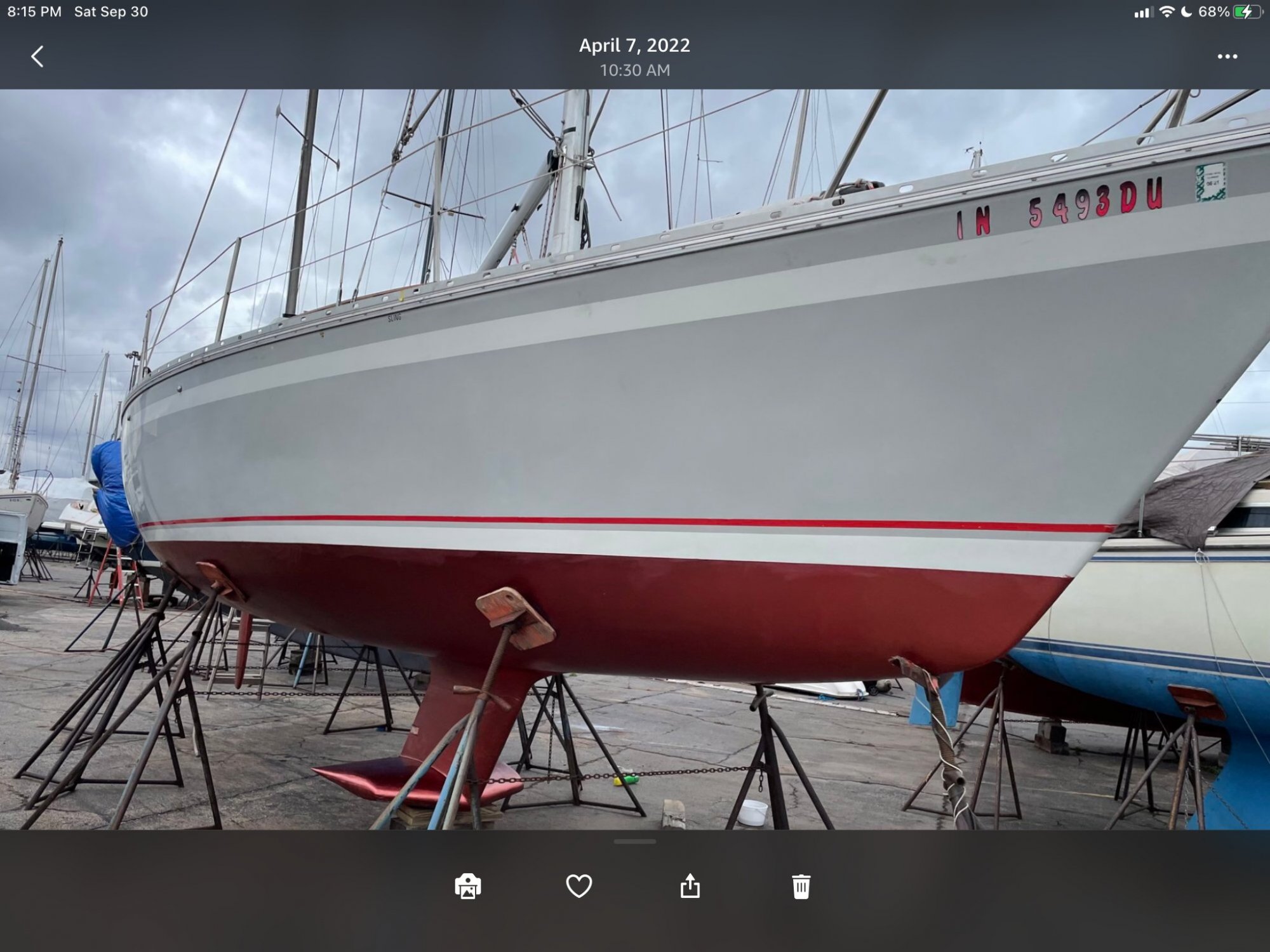

My lead keel (1988 O’Day 322) is fared. I have a few places where the faring is cracked and it is very evident it is covering the lead.
