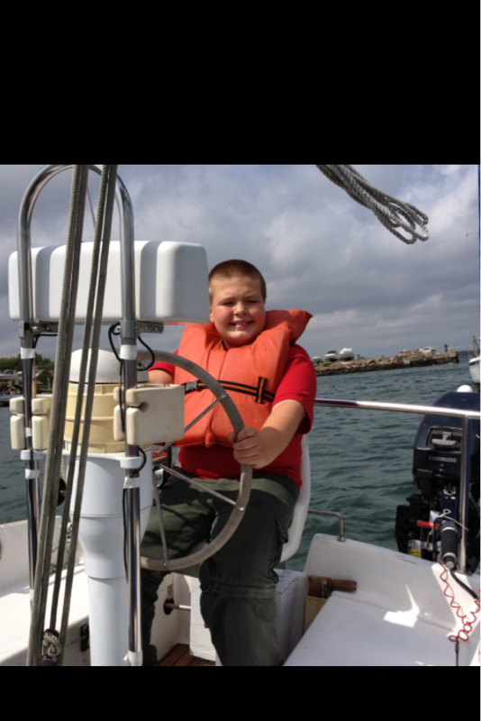

There are few sailboat manufactures that offer the Edson Wheel Helm as an option on small sailboats. Fortunately we have one! its a 1995 Seaward 23 footer, with Edson Wheel Helm, Yanmar 10Hp Diesel, Marine Head, Dodger/Bimini. As you can see in the attached picture the cockpit's environment is greatly enhanced by the Wheel's pedestal, we think it really neat. All the engines controls are at your fingertips, for easier and safer operation, not to mention the improved visibility from the Helm seat, looking straight ahead etc. IMHO you should buy what you want. If however you can economy modify your boat, while adding to its resale, then that is a good way to go also.
May 5, 2012

I forgot to mention that we recently added Edson's remote mount fixture, so we can easily remove the wheel, to temporarily mount it on the stern rail to gain more room in the cockpit, while we are either at the dock or anchor. Also, note the Teak Cockpit Table I made with the Compass Rose Inlay.
