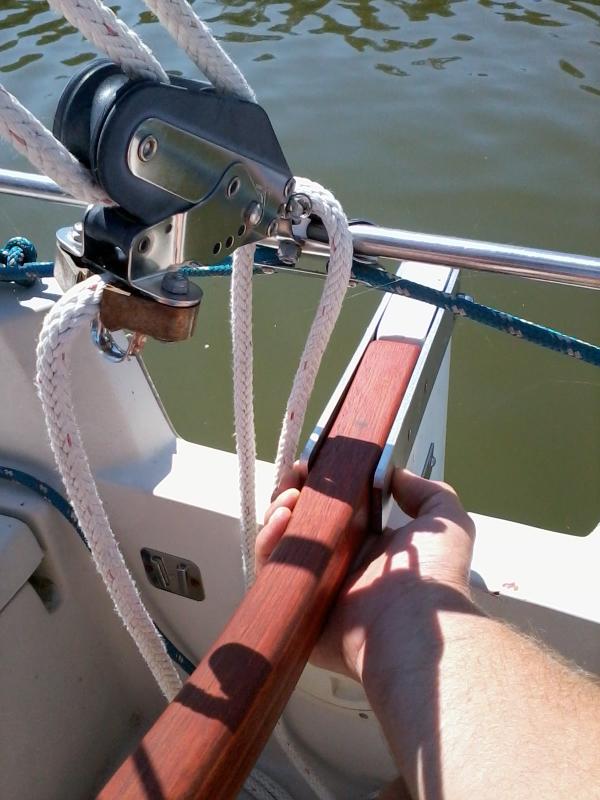

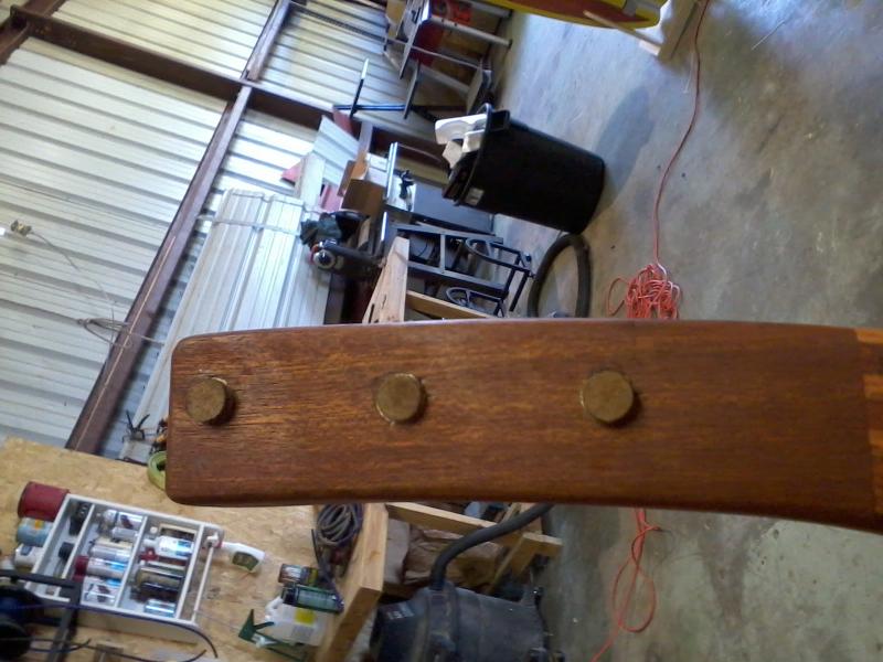

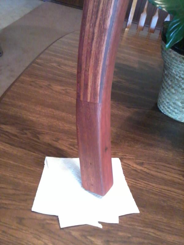

Back to topic. If a custom tiller will address an issue or perceived need for an individual cockpit, there is no reason not to go for it. A buddy of mine had a tiller that was split and delaminating. He also wanted it shorter. I took it and did a little rework. First I re-glued the thing back together. Without knowing the previous adhesive, I used some thickened West Systems as the adhesive. After it was a solid piece again, I trimmed it to the length he wanted.
Fully knowing that tillers often split because of the loading applied by the mounting bolts, I took the shortened tiller and cut away two wide rabbets, one on each side, and then added cheek blocks to both sides of the tiller, These two new pieces are glued on, (with Franklin Titebond II since it is flexible like wood when cured) perpendicular to the existing laminations, bridging them and spreading the load. Finally, just to be ridiculously anal, (I had time when I did this one) I cross-drilled the tiller assembly where the bolts would go through, drilling it substantially over-sized. Using a homemade die, I pulled custom dowell material to fill the over-sized holes and glued them in, (again Titebond II here). I then cross-drilled for the bolts, and sealed the drilled holes with thinned epoxy.
Now granted I spent more time in an effort to over-build the aft end of a broken stock tiller rather than creating anything truly custom, but again, as Chris shared, most of it is doable and well within the grasp of anyone who can run a jigsaw and a drill well.
There was that other custom tiller I made a few years back, but we won't go there... :D Integral internal tiller lock, horizontal steam bent curved laminations of oak and poplar.... Nah, nevermind.
Anyway, here are some pics of the restored tiller as it was being rebuilt.

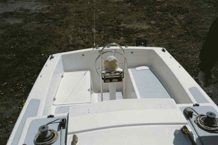

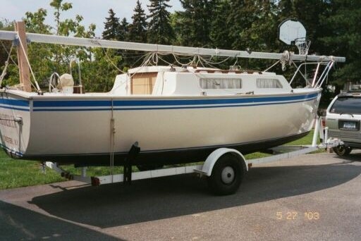

Here's an Aquarius 7.0 (an A23 with transom mounted rudder) I used to own, into which the PO installed a Yacht Specialties pedestal and wheel with push/pull cable out the transom. I took it off and put the tiller back on, as it just didn't look right, and it took up too much room in the cockpit. The tiller was high enough not to bang into anyone's knees, though, and got higher still when the rudder was pulled up the long pintle for shallow water.

Kid tested, and mother approved.
Very nice wood work Phil. A craftsman.
Besides the funky look, the wheel's functionality is minimal.... since the sail controls appear to be on the cabin top... a very long stretch if you're sitting behind the wheel driving your pretty boat. A tiller makes shorthanding much easier since you can straddle it and steer with your knees while working the sails.

Well Joe, you're certainly entitled to your opinion (I left out your first opinion on the subject). Here's my opinion: looking closely at the picture posted earlier it doesn't strike me as funky, controversial or any other descriptor that's been thrown about. In fact, it looks good. Darn good.
Well Neil, I was referring to the Aquarius 23 in tkansler's post. I have NO problem with a wheel, helm ... whatever.... on a larger boat. . but if you're happy with what you have....... that's awesome.
Yours looks great, congratulations.
