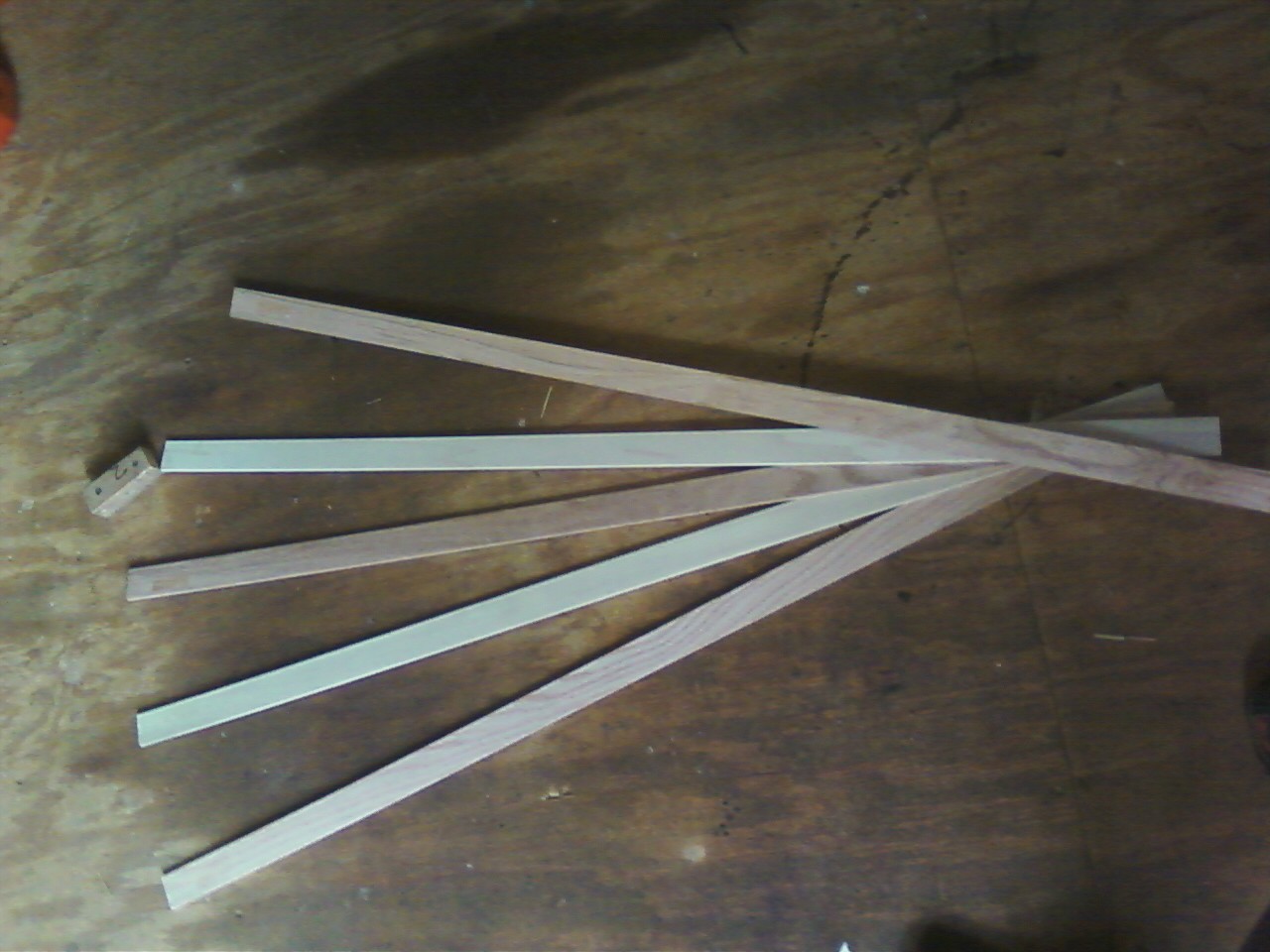

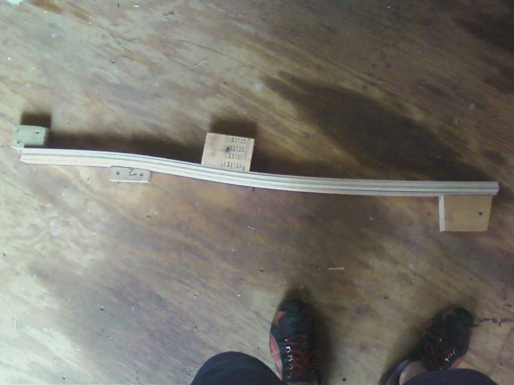

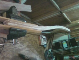

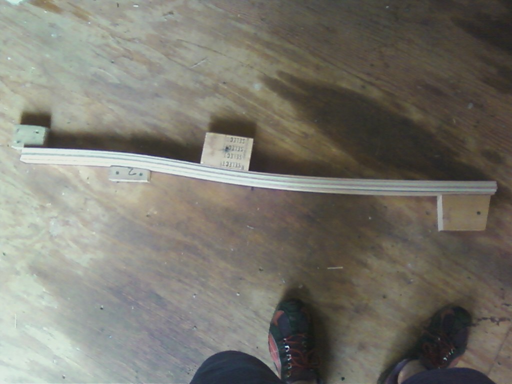

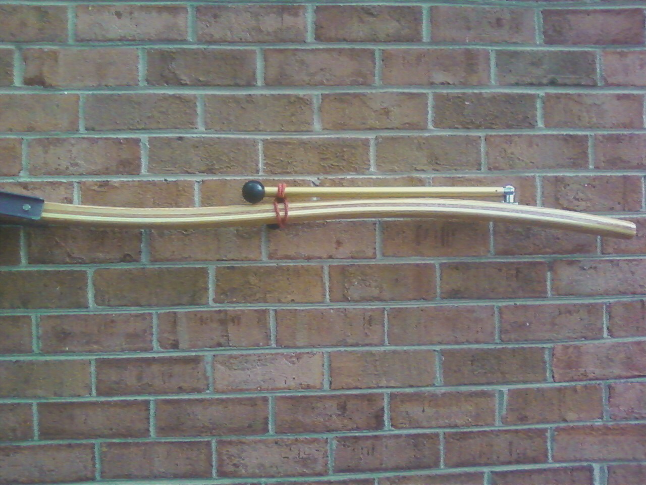

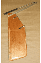

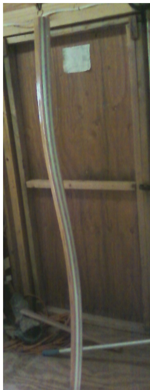

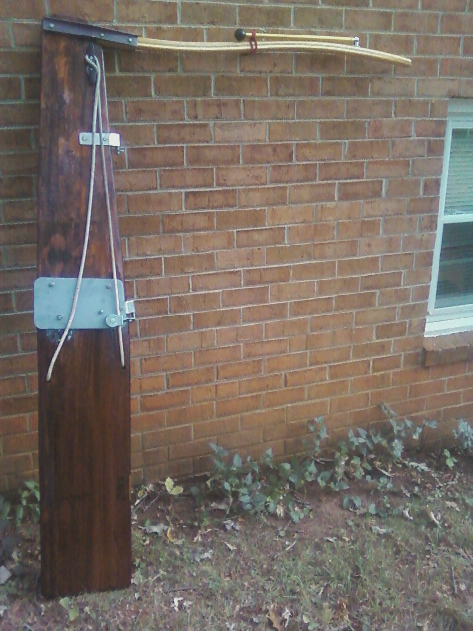

I ripped up enough strips from the cedar board to make a 1 inch thick laminated rudder. Looks like this stuff is the best for bonding the pieces together; looks to be fine for coating as well. https://www.jamestowndistributors.com/product/product-detail/336142

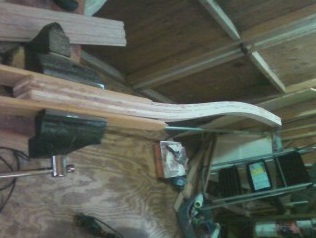

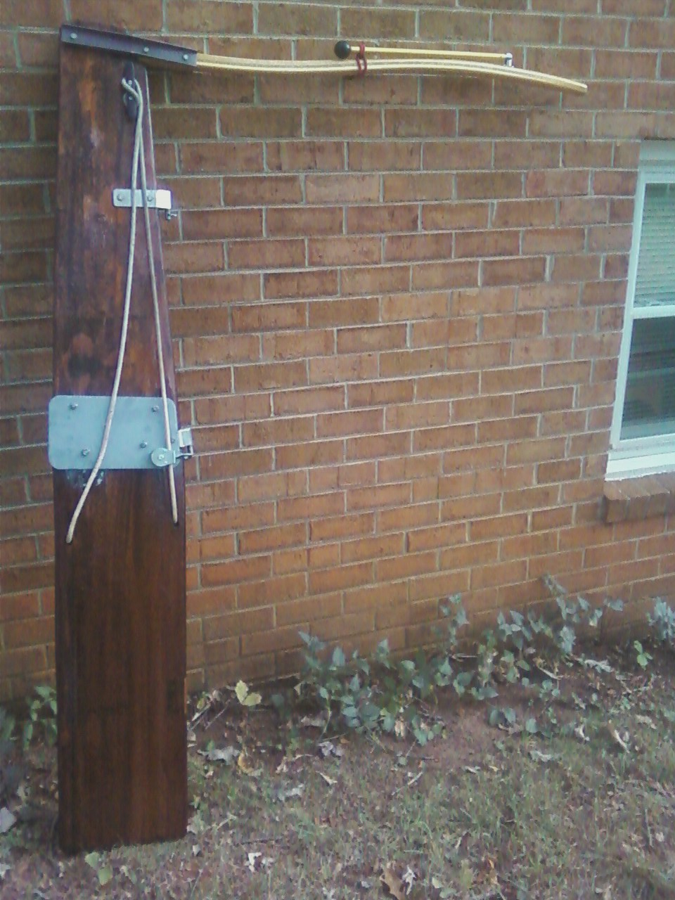

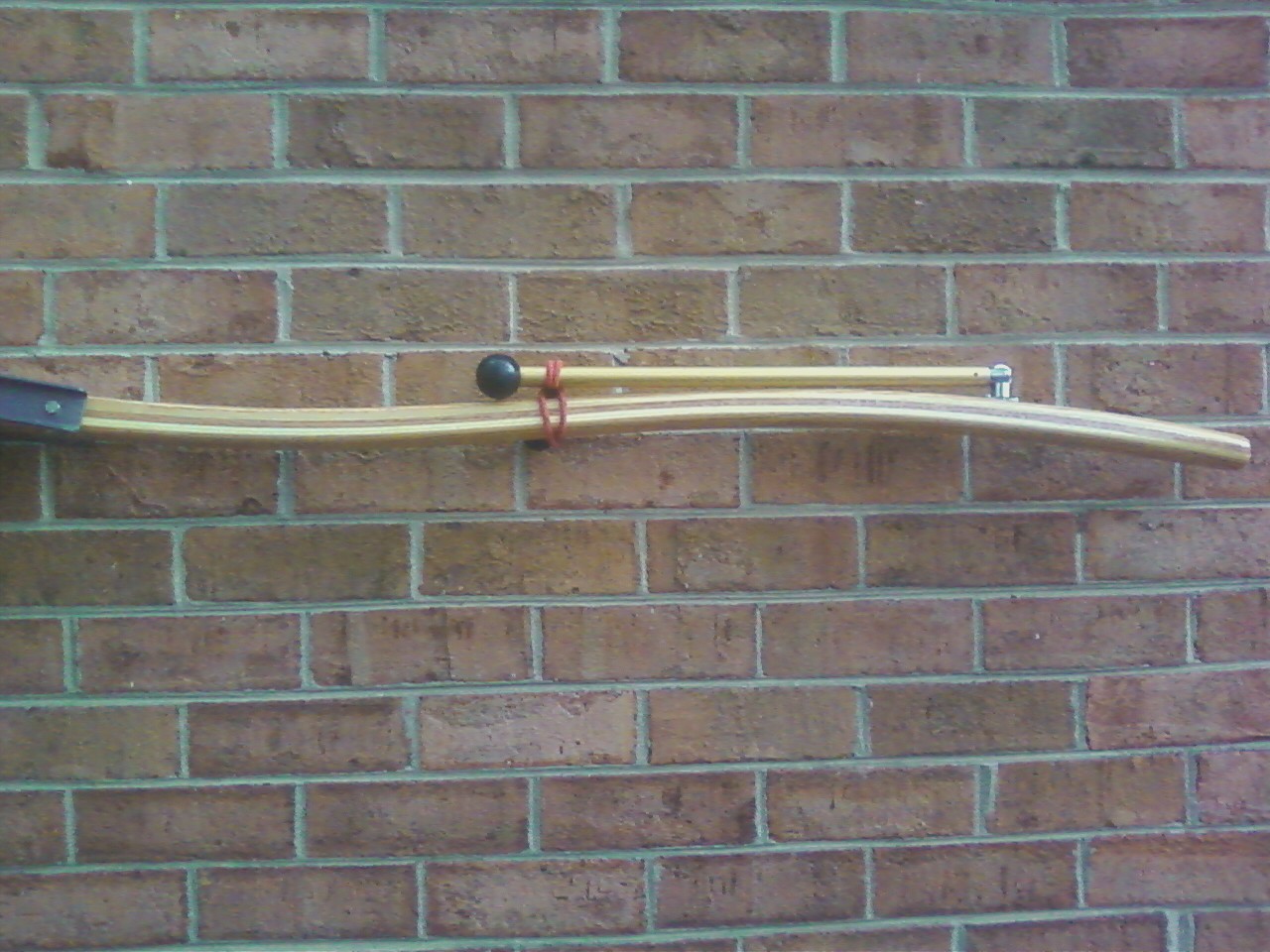

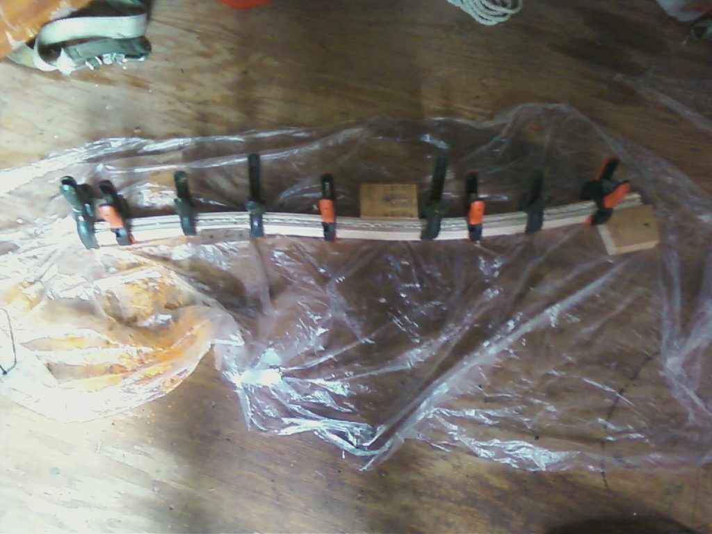

Please post pics of your build. That approach works well for tillers as well. Here are some pics of one I made years ago
The plastic was to ensure I did not glue the strips to the floor.

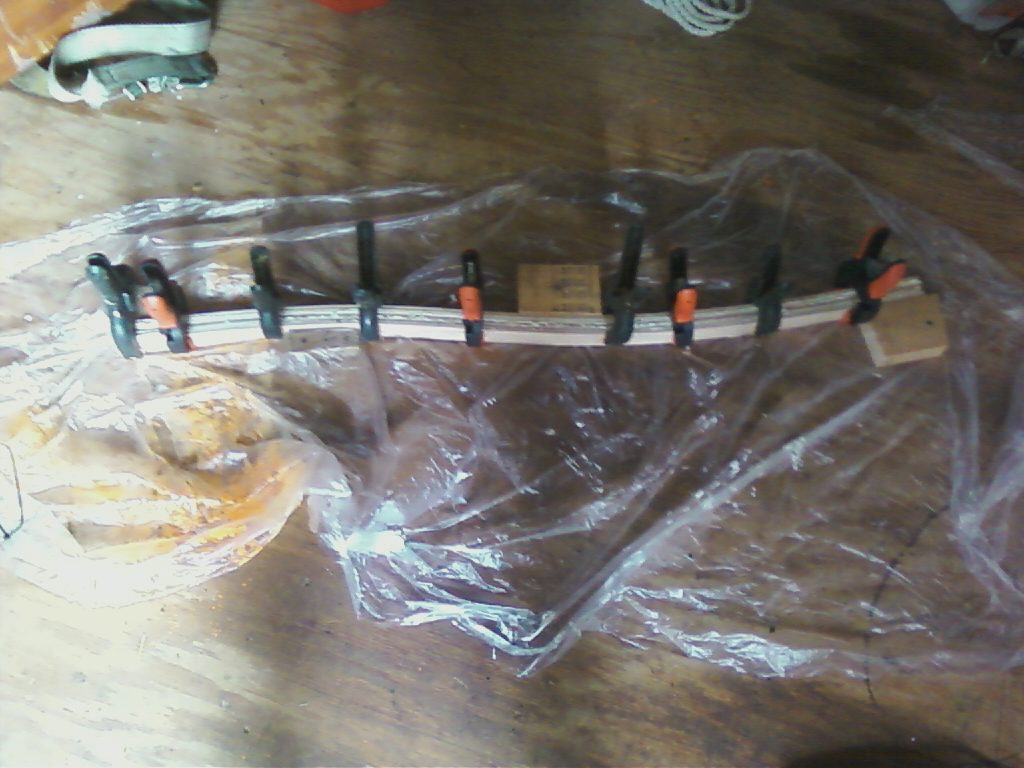

... and here is a clearer shot of the stips in the jig
... and clamped for sanding etc.
Seven coats of varnish
Installed...
View attachment 211212View attachment 211213
Installed...
View attachment 211216 View attachment 211219
What would you coat the rudder with, if you were building one? Varnish, as with your tiller?
13,076
Glass would protect it. Especially if you put an epoxy barrier coat and then painted, but where I sailed with the rudder in the pics above was very rocky. I was always repairing a ding or gouge. It didn’t make sense for me to cover the rudder.
