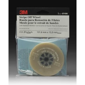

An easier option are the 3M Stripe Off wheels. They work wonders and are a lot faster than heat gun. Some of the lettering is very thin and fractures easily even with heat making for a tedious chore..
+1 for the 3M wheels. They make removing decals almost trivial and there is no worries about damaging the gelcoat.

BTW, I used a generic 3M stripe off wheel to remove some old vinyl lettering. Worked like a charm.
