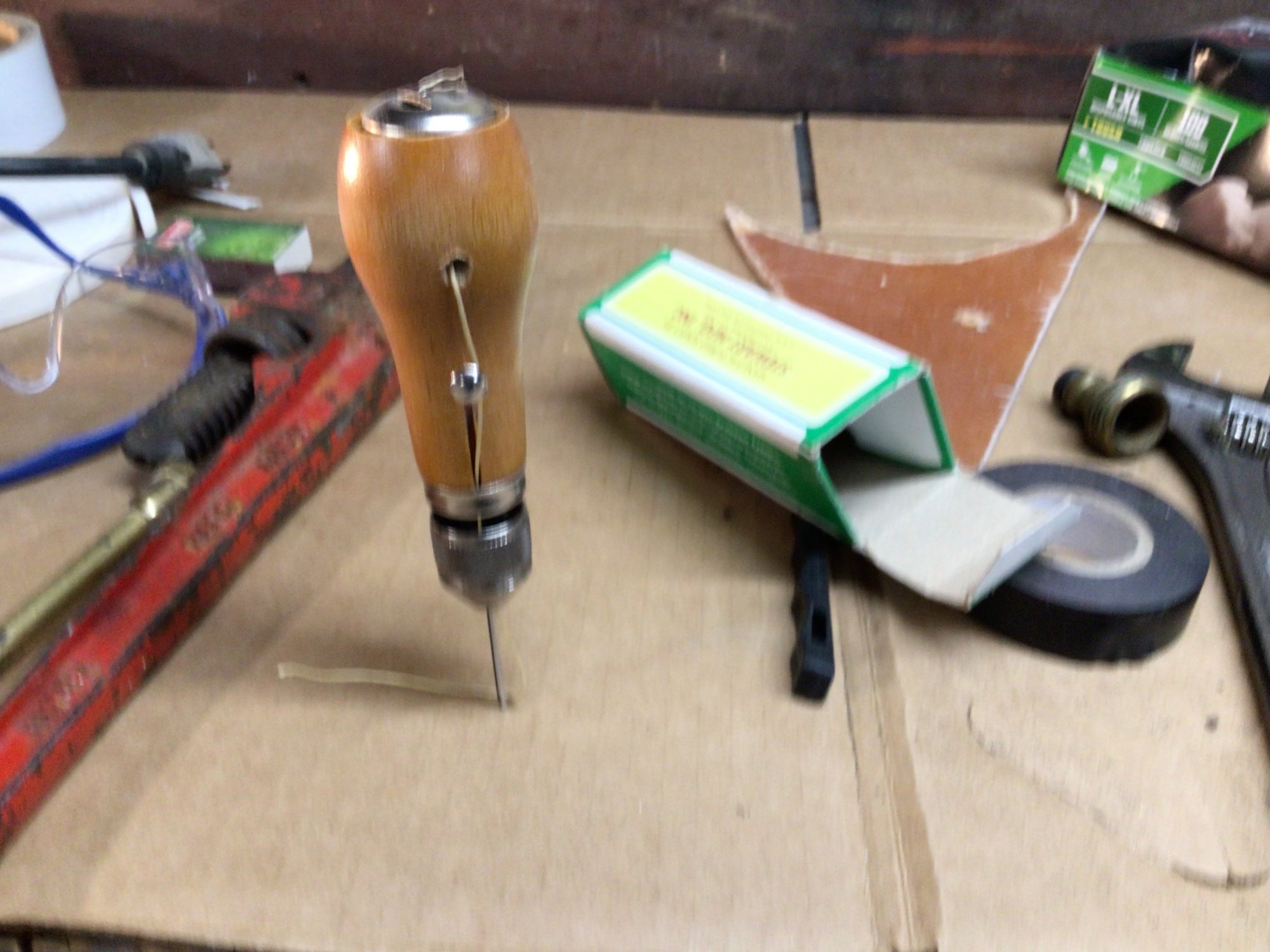

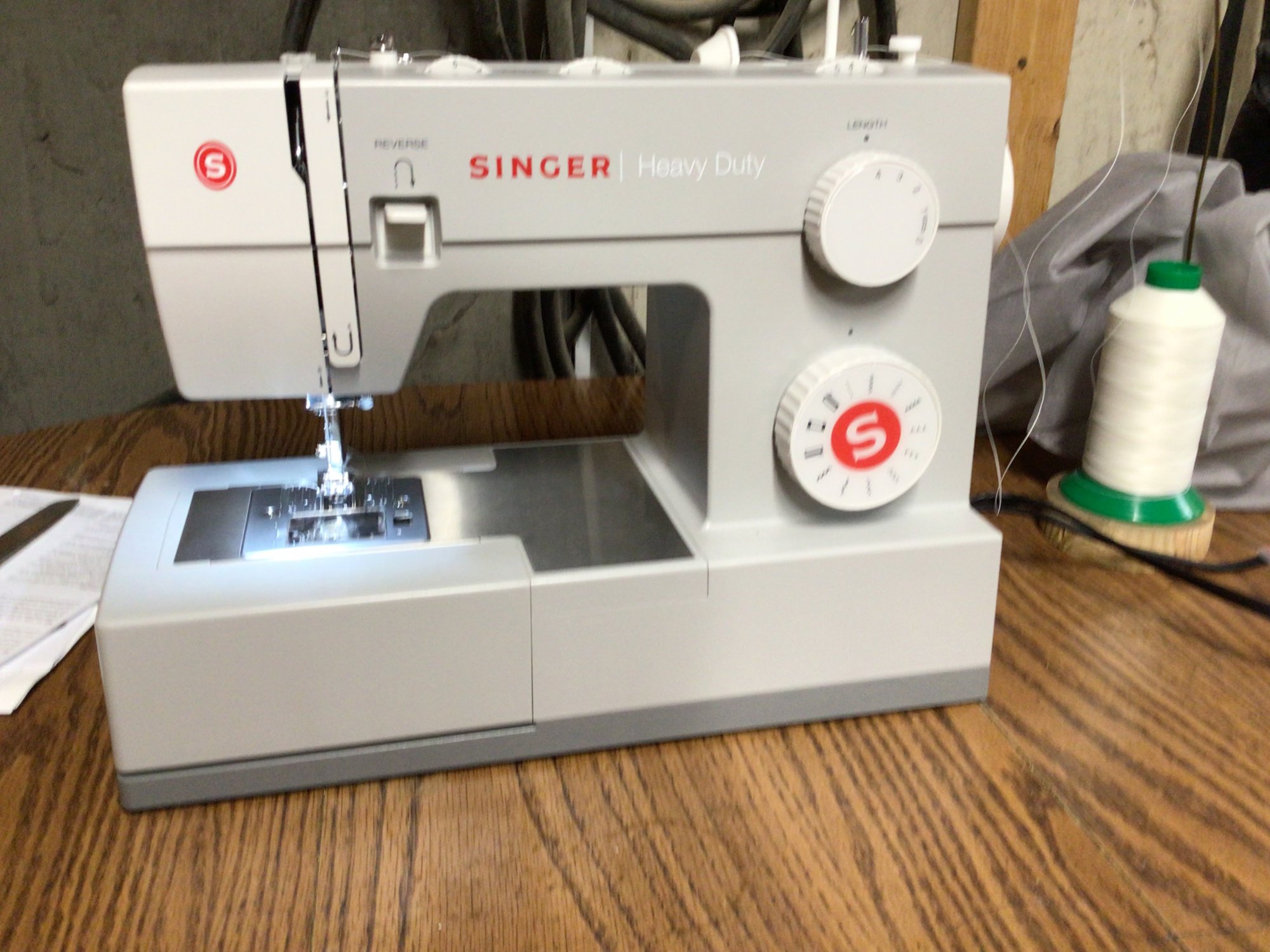

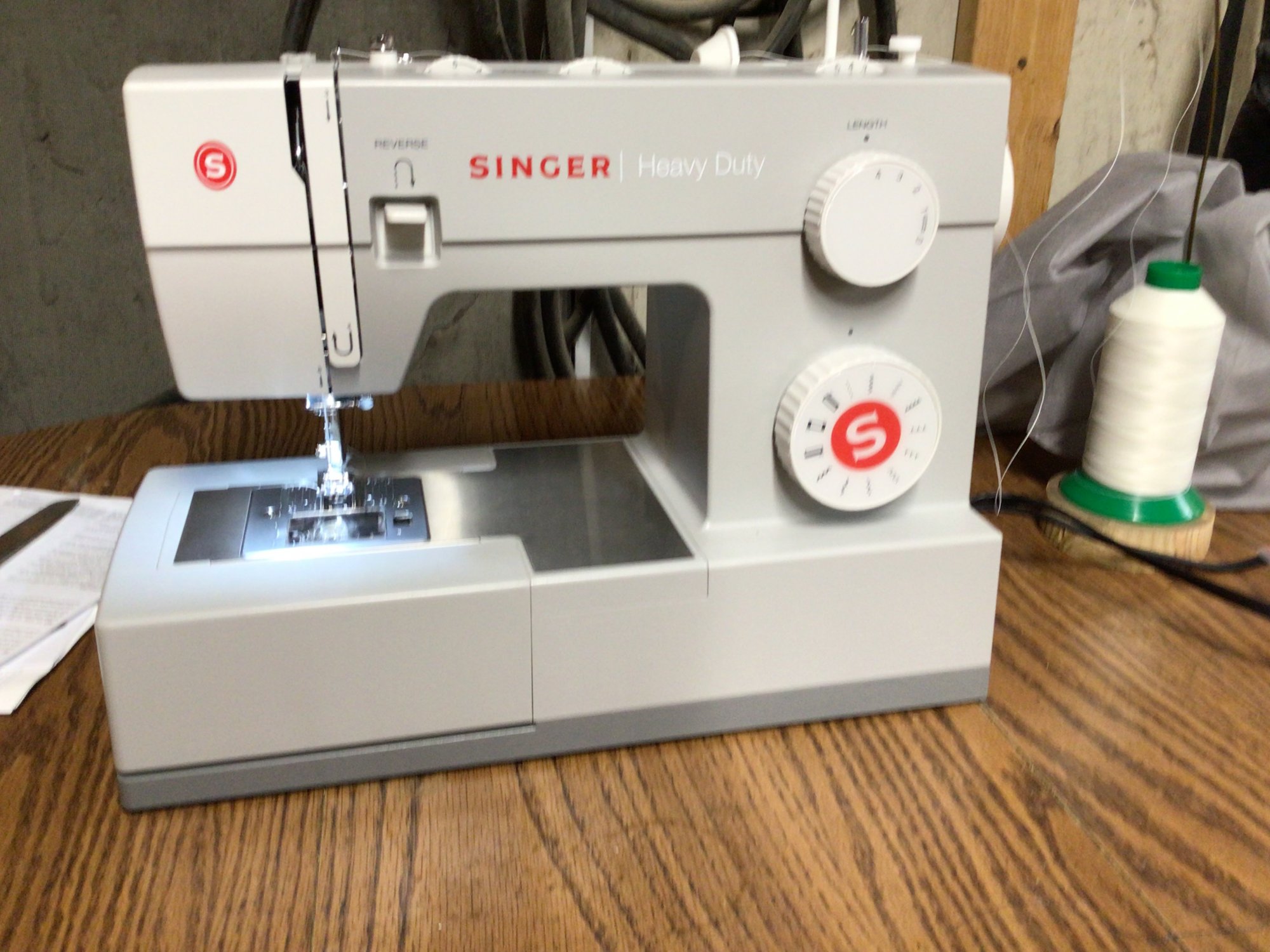

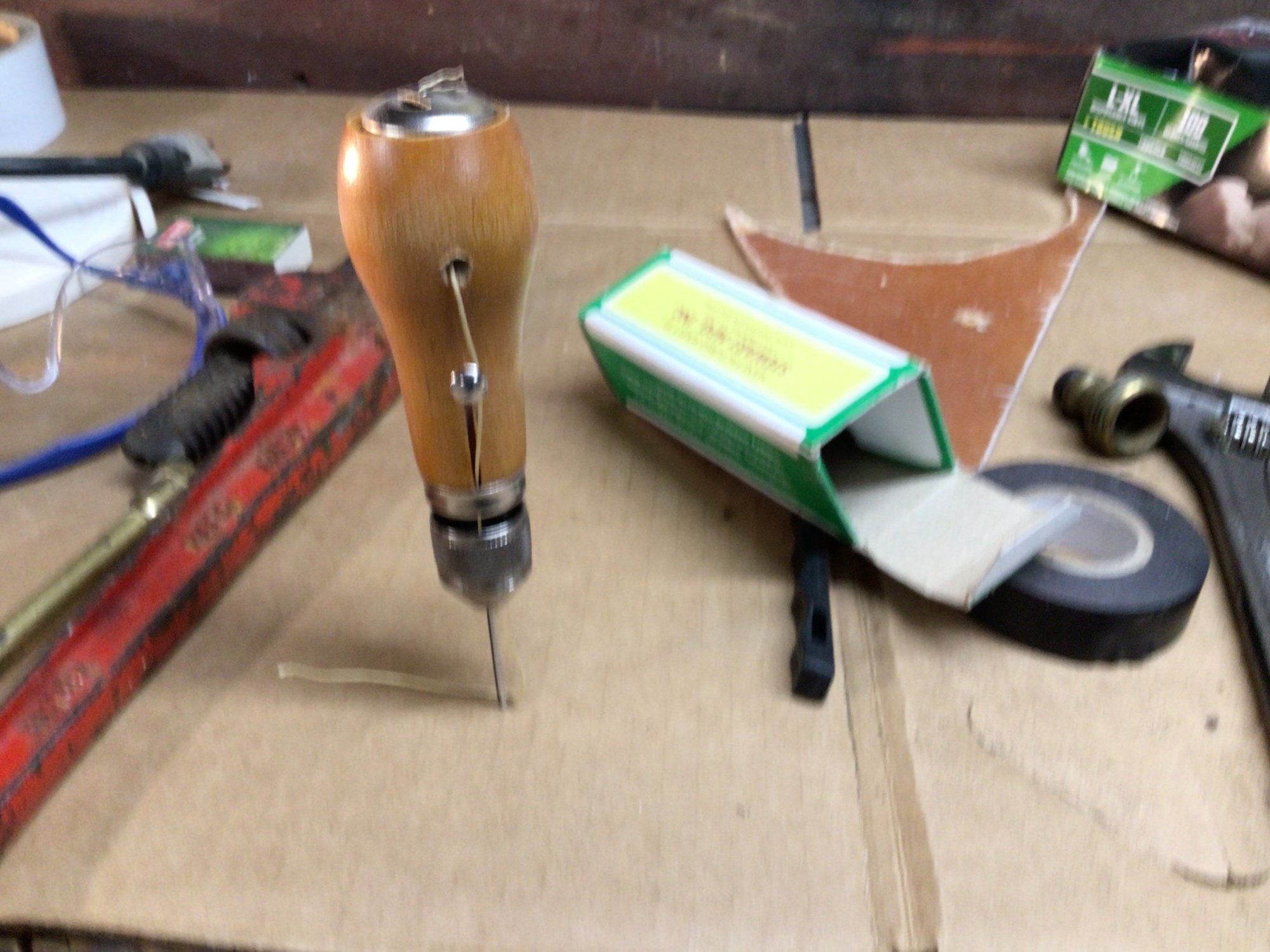

This was my sewing machine…
Great for single stitches, repairs to sail webbing, etc…but not for sewing very much.

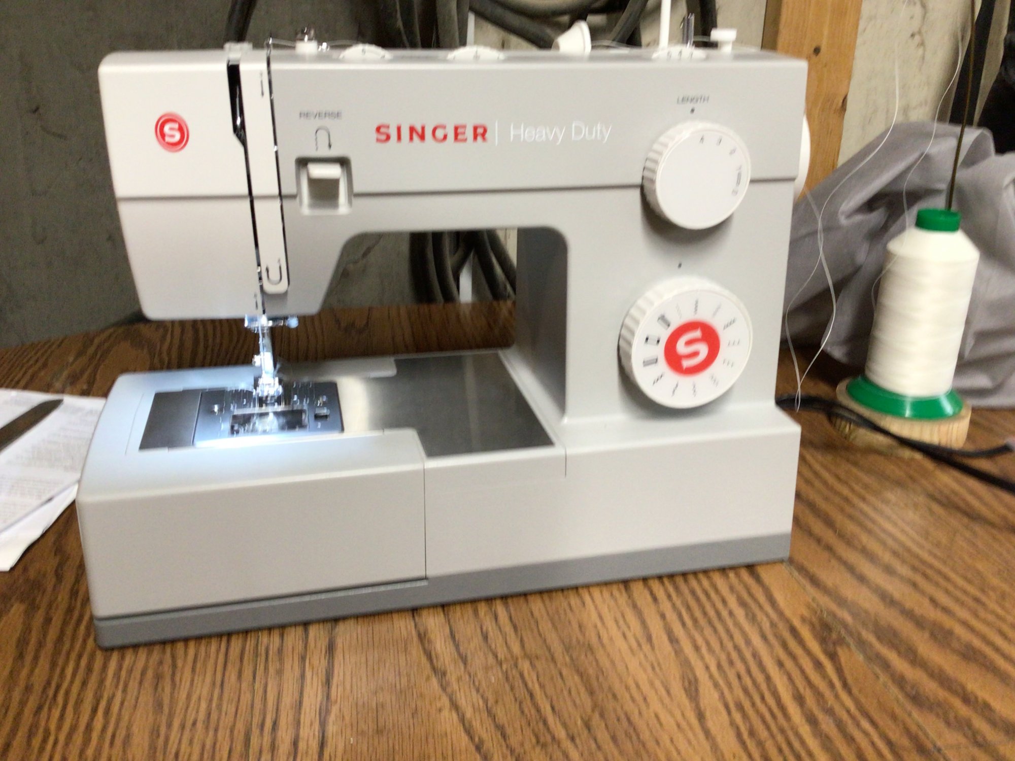

I was on eBay and saw this Singer HD for sale, and I put in a bid ~$87 IIRC. Didn’t really expect to win…but I did.
The housing is plastic, but the guts are metal. I have watched many videos comparing the Singer HD to older vintage metal machines or even a Sailrite…my Singer is no Sailrite! But I can sew multiple layer of sail cloth, multiple layers of Sunbrella, and my heavy canvas Top Gun boat cover.

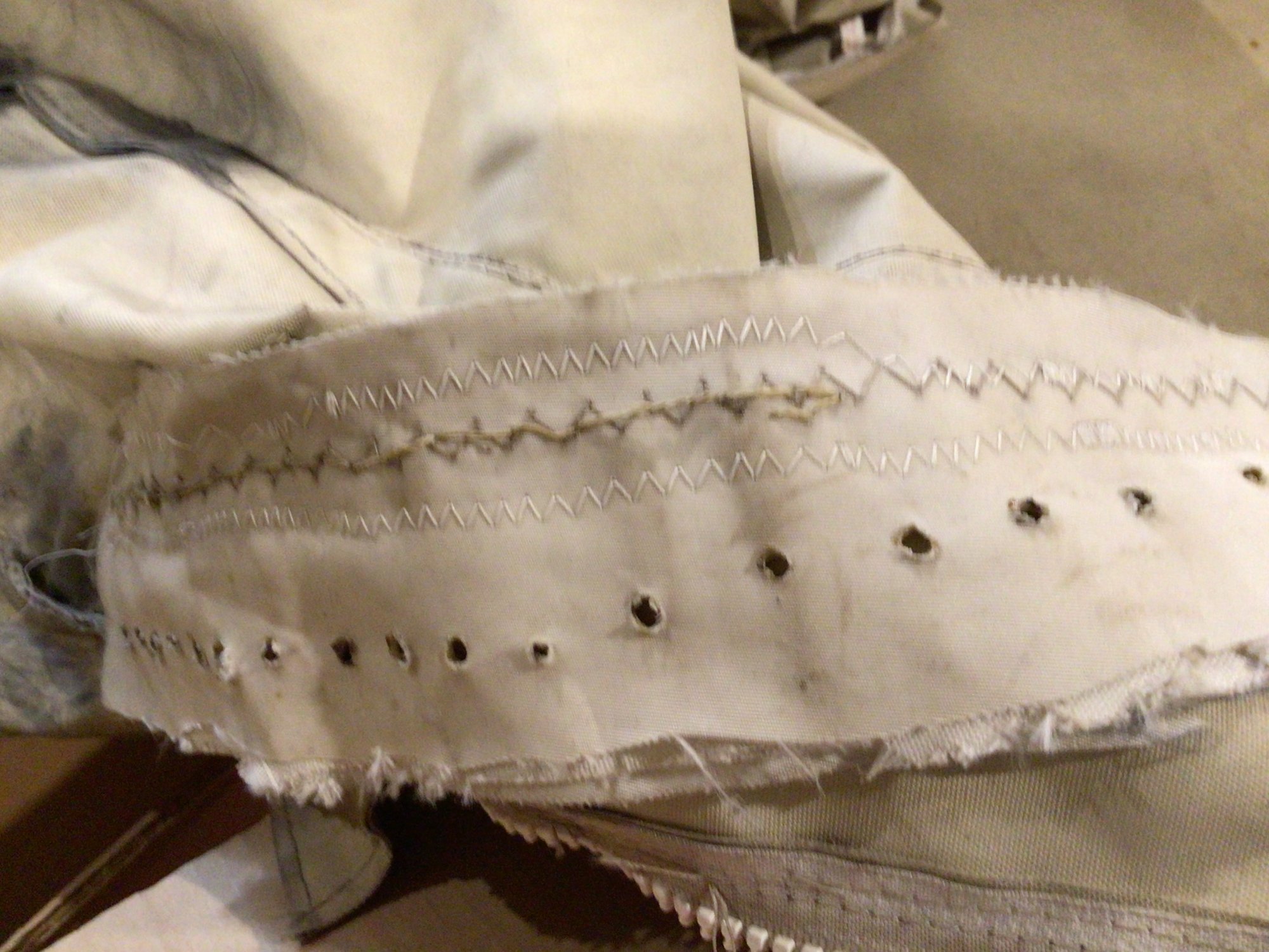

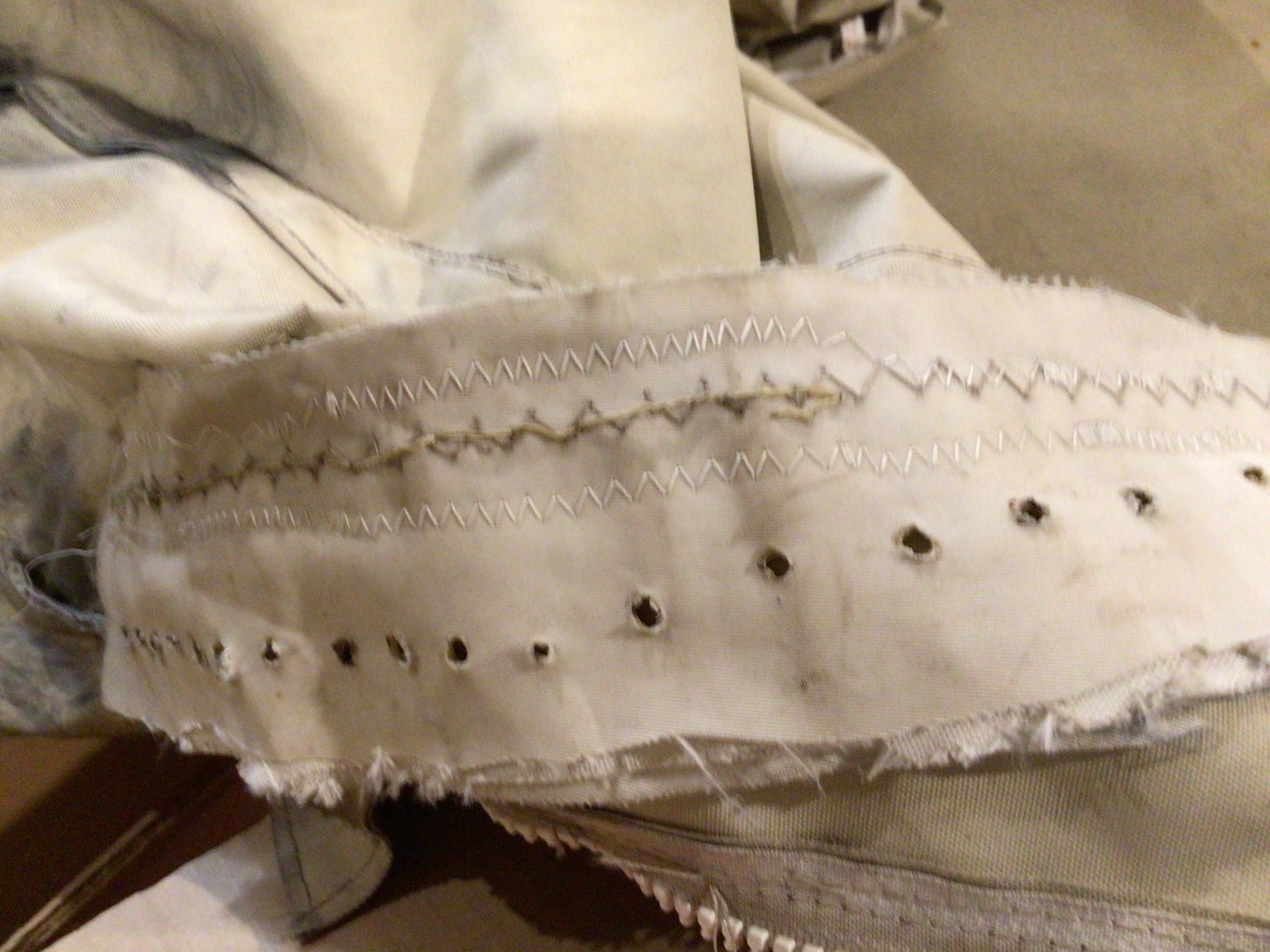

This weekend, I wanted to add a tab to my boat cover. I sewed it on a few years ago with the Speedy stitcher, but it needed to be redone. The tab is 4 layer of sail cloth, which I was able to sew on to the boat cover with no issues (besides my poor sewing skills).
You can the old Speedy Stitches, and 2 rows of machine stitches.
In case you are interested, the zipper in this part of my cover has pulled apart a few times, and the tabs on either side will get a shoe lace laced over the seam, so I can take the weight off the zipper.
I am looking forward to making a new helm cover, and trying to make new interior seating cushions.
I think my little Singer HD can handle those tasks. Maybe if I get good at sewing, I will upgrade to a walking foot machine.

Good for you! I am not familiar with that machine, but it's the second time I've seen a reference to it today. There are youtube videos on tuning it up, etc.
Sewing: you just have to do a lot of it. I do some tailoring, from simple stuff like blind-stitched trouser hems, to shortening sports coat and suit sleeves and making the cuffs functional (surgeons' cuffs). The more you sew the better you get. And the faster, too!
I just got some new PJ's that I may have to hem. :) I also add tabs for hanging them up like a robe.
What's the model number of your machine?

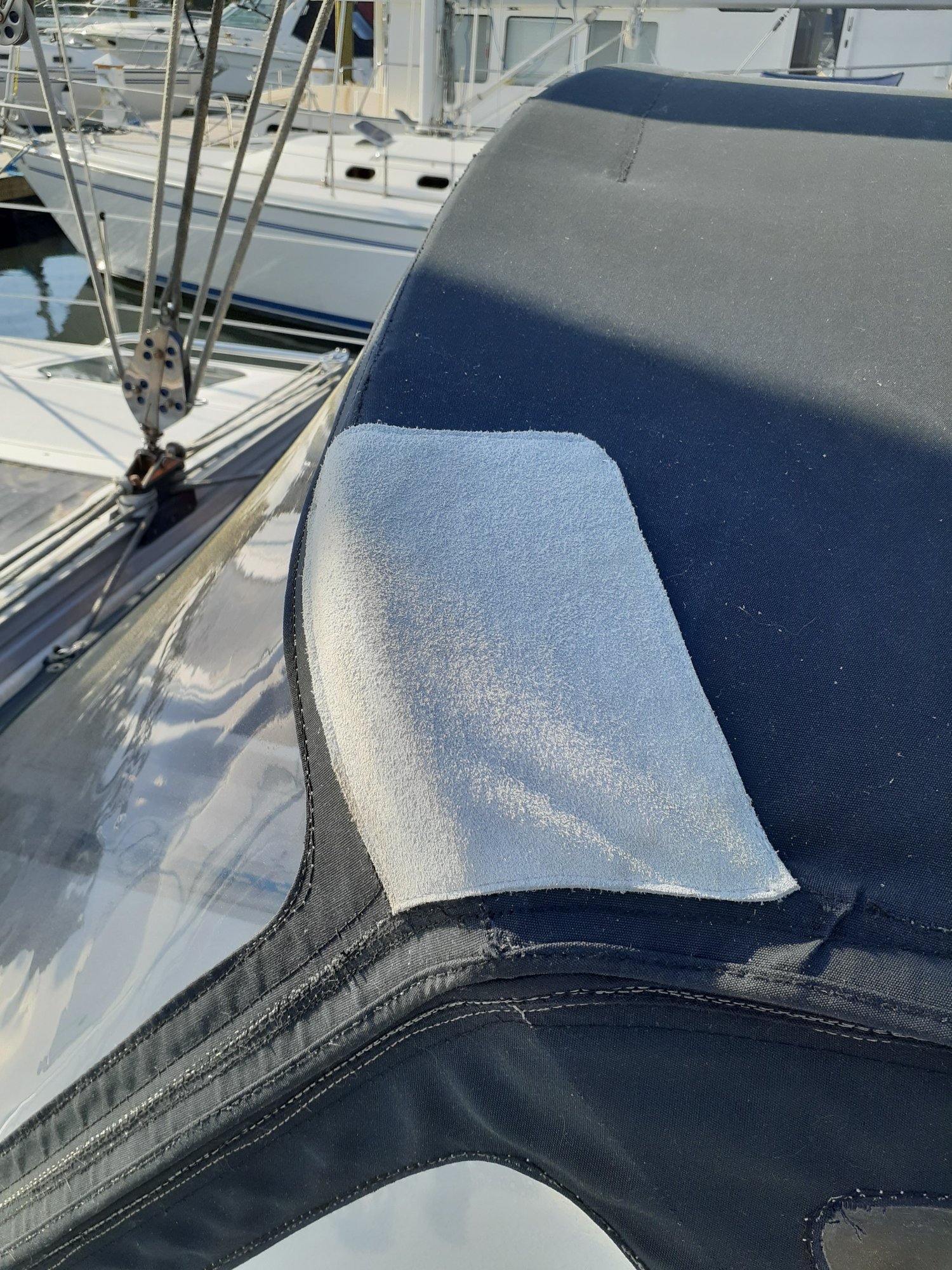

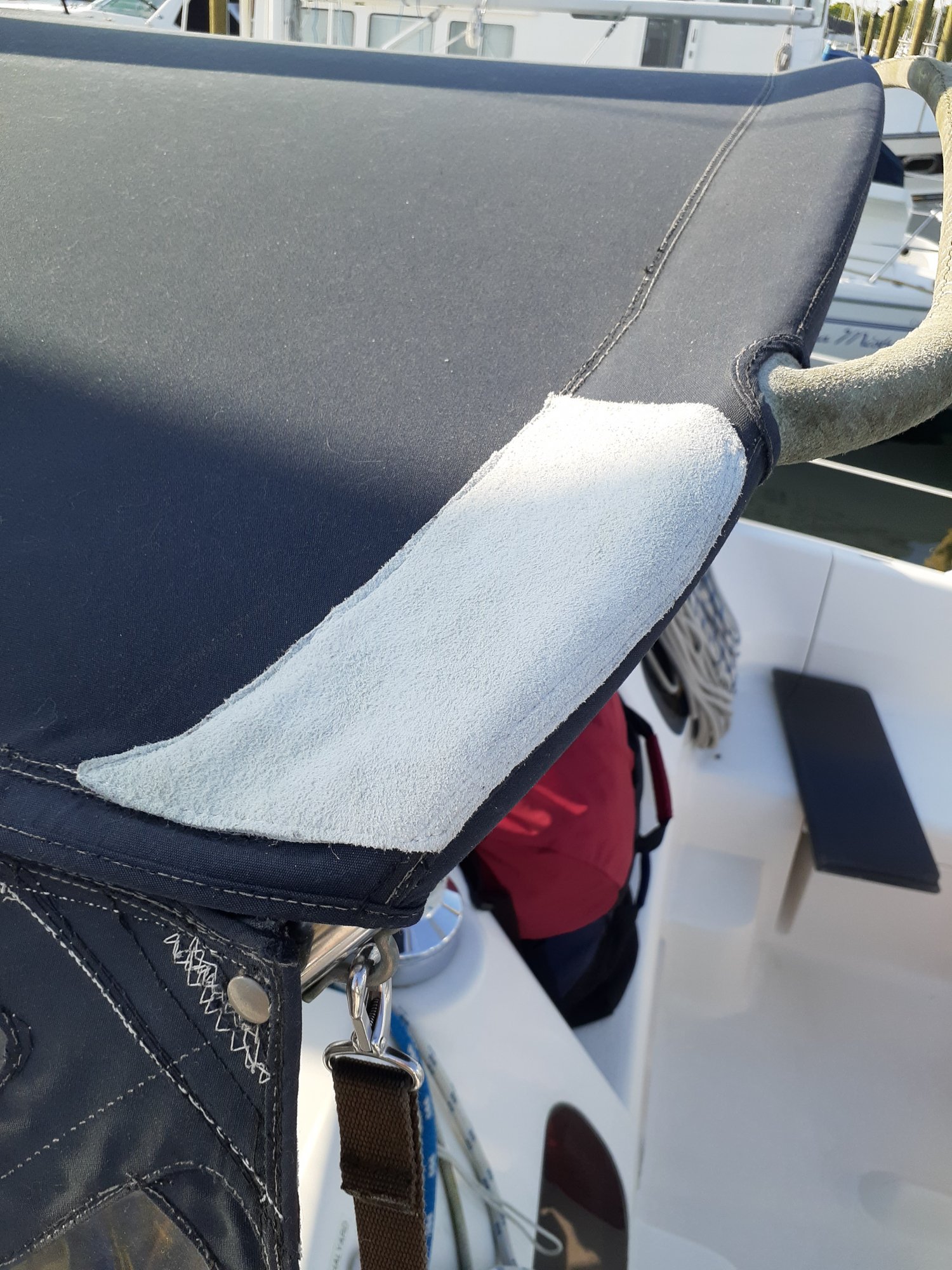

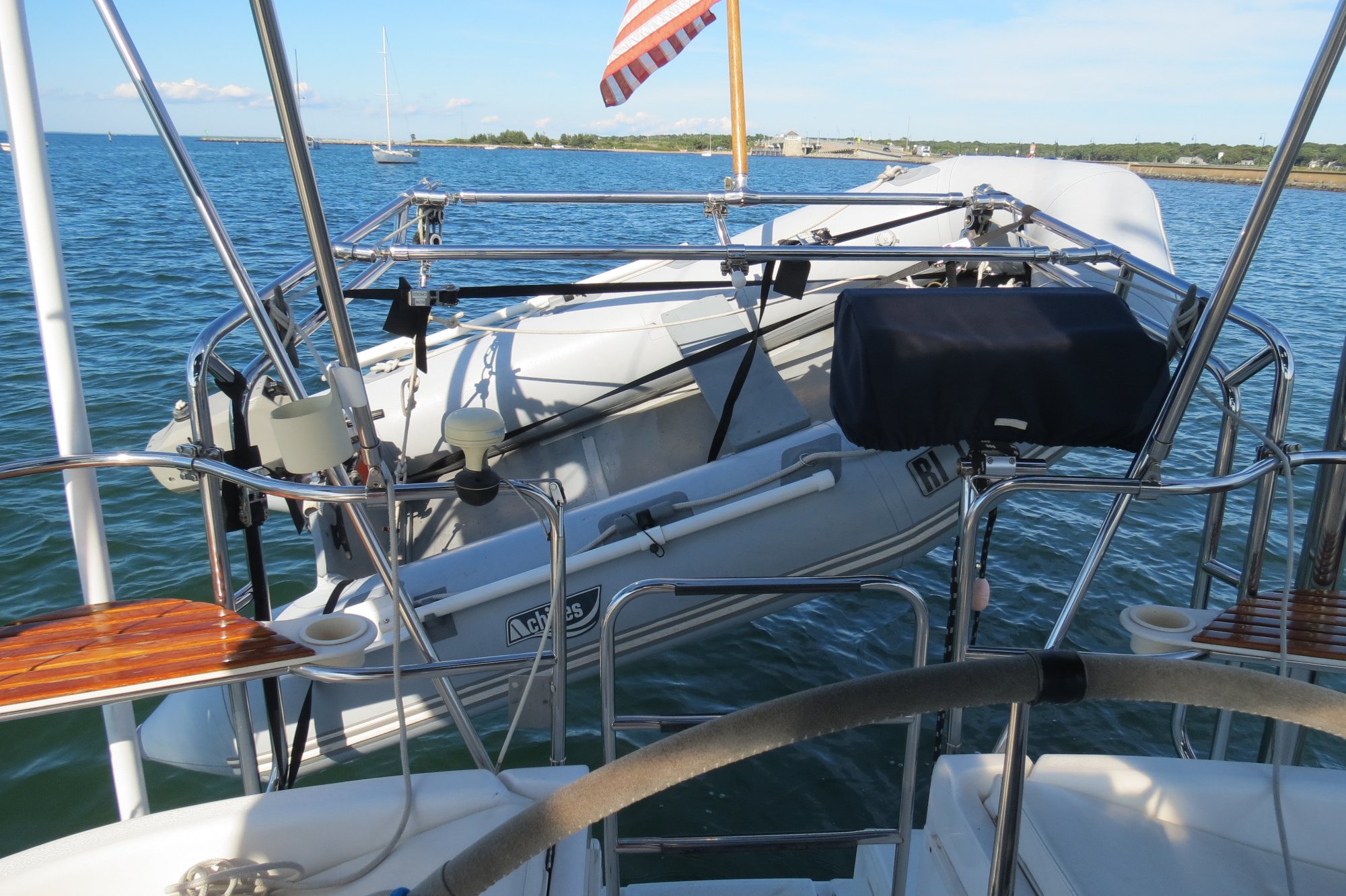

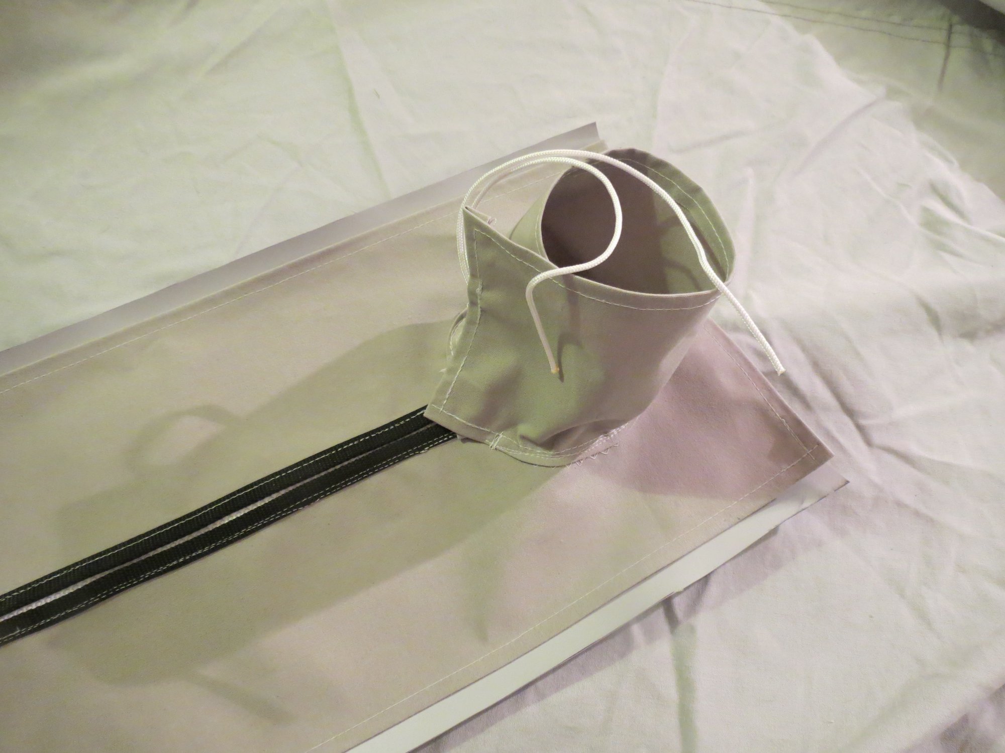

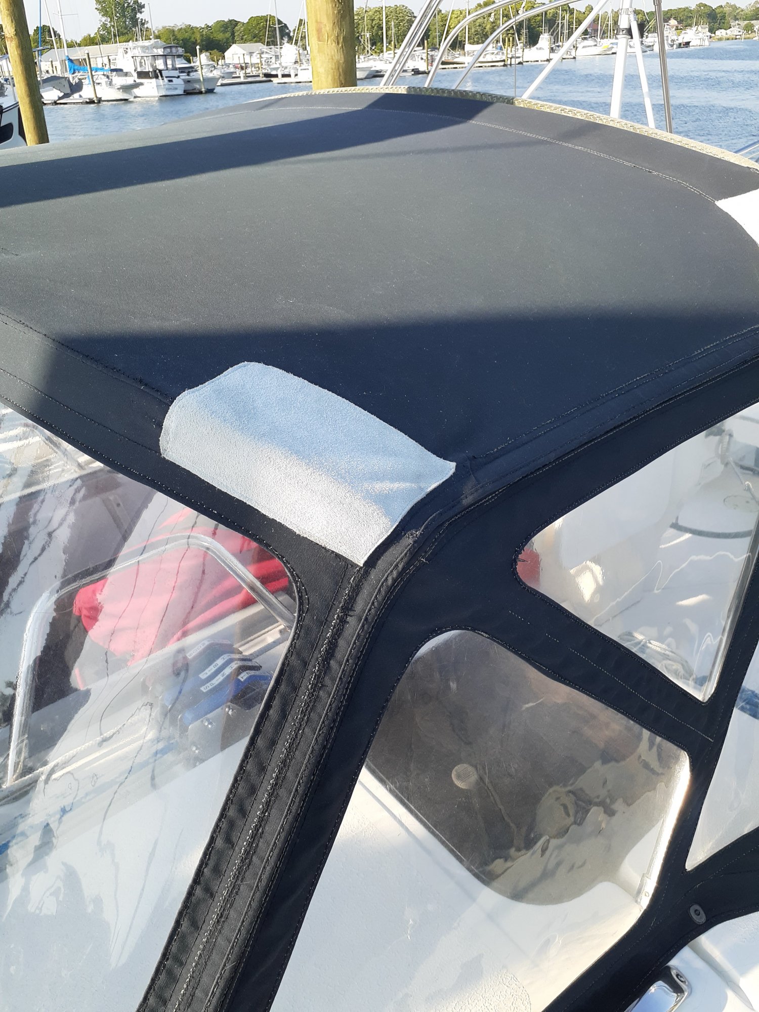

I have a friend who owns a Sailrite LZ-1. It has turned out that he doesn't do very much sewing, so I have custody of his machine. He comes to my home and does some sewing a few times per year and I use it the rest of the year. I primarily use it for repairs to my Fairclouth canvas winter cover and to repair stitching in my dodger and bimini. I have added zippers to my winter cover and split the winter cover into 3 pieces that zip together. I've added cutouts for my stern radar pole with zippers to close. I've added leather pieces to my bimini and to my dodger where hands come to rest transiting the cockpit, and I have replaced window vinyl in the dodger and bimini. I've made covers for my fenders and dock roller. I've made BBQ covers too.
And of course I hem my jeans.
The Sailrite LZ-1 and its sister machine that does just straight stitching are much better suited to marine work than a home machine. Their main claim to fame is the walking foot and the power to sew through many layers of Sunbrella and leather. I upgraded the Sailrite motor to the Worker-B system and IMHO it is the only way to power the machine. You can literally run the machine at 1 stitch per second at full power!
The only complaint that I have with the Sailrite is the short arm. It is a real challenge to get large pieces of work under the arm and it is definitely a limiting factor. And although it is billed as a "portable", the weight is far too much to lug around- I'm guessing it is about 50#.
Here are a few examples of my projects-

Singer 4411 HD. Paid $86 for it. Like new.
Not too sure I will do clothes, but I did sew a canvas bag and strap for putting stuff in while climbing the mast.

Does that machine have a walking foot?

No walking foot. You can buy an attachment, but it is not a true walking foot like the Sailrite. I saw a few videos on it, and wasn’t convinced It was worth the purchase price (not terribly expensive).
