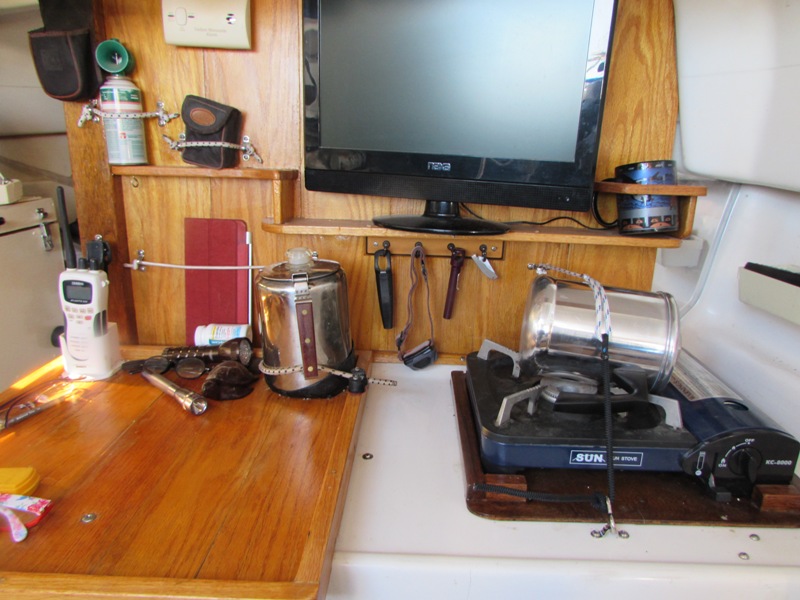

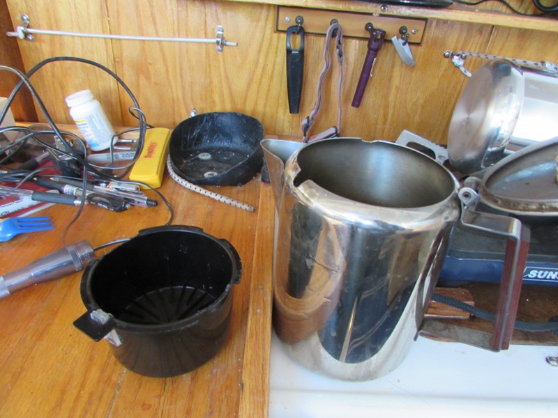

New coffee program..
My 26S "sink area" (sink is still there, just covered up) is mostly setup for making coffee as this is the most important meal of the day.. I have used a percolator with ground coffee for years but the percolator wastes a lot of heat running a very inefficient hot water "pump" (the tube and round base bottom). I love the butane burner.. but the percolator was going through the gas canisters a little too fast. What I have now,, I still have the percolator pot but dumped the pump and basket part where you put the filter and grounds. I modified a coffee filter cup from a home electric drip brewer so that it fits in the percolator pot. I put this new cup plus a filter and ground coffee in the old pot.
Then I heat water with a second pot (shown mounted sideways on the butane stove). When the water starts to boil, I manually poor it over the coffee grounds. Makes a bunch of cups of good coffee, doesn't waste a lot of fuel and is easy to clean up.. At least.. that is the plan anyhow.. I have only used it once this way so far. The second pot that heats water is also used to make tea, noodles or soup, etc.

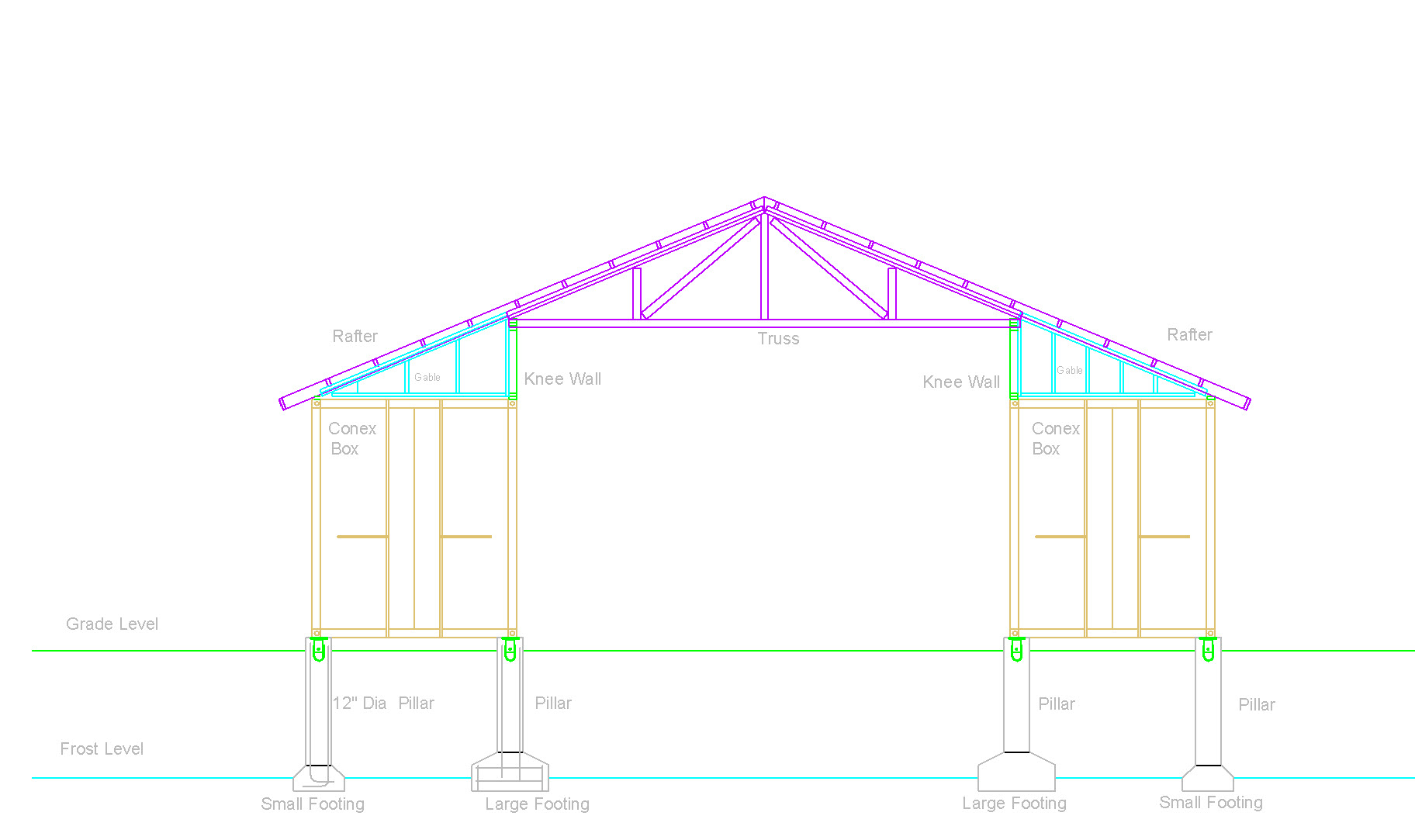

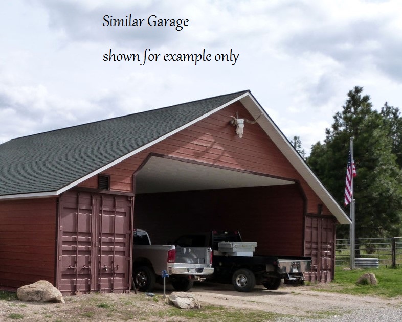

This is more of a “What I’ve been doing the past few weeks” rather than ”what I did ‘TODAY’” but I thought I’d post it here anyway. Since my wife and I will be moving into a new home once I retire, it seems only fair that Miss Behavin’ should get a new home as well. After all, she will be trading the warm California desert for the icy winters of Minnesota. My plan is to build a carport (garage, barn, boathouse, boatport, whatever you want to call it) by placing two 40’ shipping containers 19’ apart and building a gabled roof over the whole thing. Not only will this make for quick and simple construction but we’ll have weatherproof lockable storage as soon as the shipping containers are in place.
I’ve spent the last few weeks designing the building and producing a drawing package that I hope to submit for a permit when we move my wife there in April. I expect the permit will be ready for us to begin excavation by the time I actually retire in August. Considering that the foundation has to sit undisturbed for two weeks before we can place the shipping containers, I should be able to get at least a few days of sailing in while the weather is still warm. Even after we start building I hope to take the Mac out once a week or so for a few day sails or, at least, take a few hours here and there to sail the dinghy around.
It’s been over a year since I’ve been on the water and I’m getting more than a little bit anxious……

Thats a really clever concept for a garage. as long as you can convince the planning dept, which can often be pretty narrow minded. I'd love to have that setup in my back yard. ;)

I expect Bud will, if Minnesota is anything like Oregon. of course that may depend on weather or not it has a cement foundation or slab, making it a "permanent" structure. It will warrant checking into prior to construction, which may save grief later on.

Bud, I think you are going to have fun with that... So.. is that retirement on your mind a little bit LOL..

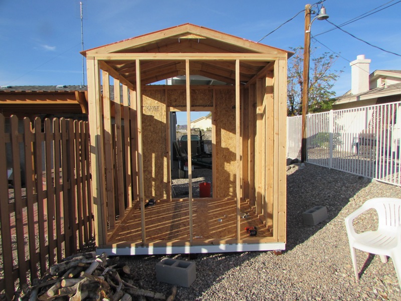

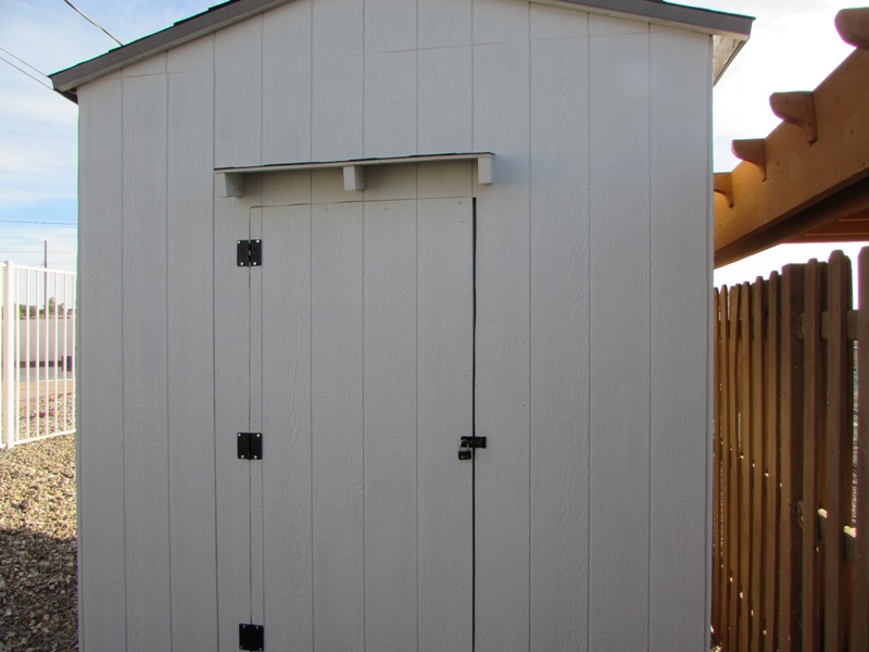

You can build without a permit but then when you go to sell, someone is going to want a serious discount on the shed if its not legal. Legal adds value plus reduces liability. Ive done some things in the past where I didnt get a permit when I should have but dont do that anymore simply because of the $$$ value of it being legal. In Arizona, if its over 200 sq foot, you need a permit/ built to codes. I built this shed this winter from plans I got on the internet - no permit needed because its way less than 200 sq foot.
not legal

Interesting project.
http://purplesagetradingpost.com/sumner/newhouse/newhouse10.html
You can buy stepped trusses so that you would only need the outside bearing walls. I used some when I built my house so that I'd have a raised ceiling over where my car lift is. They are on the top of the pile above and span the same 40' distance as the ones under them and actually cost a little less.
Being you are building in a very cold local I think I'd want those side rooms to be framed with insulation in at least one of them. Then you could also put in easy access where ever was best vs. using the end doors on the containers that could keep getting snow in from of them. How much are containers? Are you saving much vs. just framing those areas in?
Your building, so you for sure have to do what fits your needs best,

Thank you. I appreciate all the inputs and the compliments.
Considering that our property is quite a ways out of town I probably could get by without a permit but I'll look into getting one anyhow, even though I don't expect to ever sell the place.
Considering that I do plan to be putting all my power tools in one of the shipping containers and make it into a work shop I probably will insulate one of them at a later time but for now I'll be glad to be able to have a place to park my boat, Harley, and sleigh before winter comes. (Yes, Even though it rarely snows here in the desert, I do own a sleigh and use it from Thanksgiving till Christmas.)

Very true. I will be installing a foundation extending to below the frost line (5-1/2'). Frost heave in Northern Minnesota can tear a building apart if it's not on a good foundation.

Hopefully you don't mind a Minnesotan's opinion as I just stumbled on your thread. @BudGates I am not sure if you will be in northern, central, or southern Minnesota but location will have a lot to do on the temps you will see. In the south we only get a few weeks of -30 in the winter but in the north it can be a month or more. Shipping containers are ok so long as you will not need to open or access them in the dead of winter. I used to work for a Danish company that would ship equipment to MN in containers and we would use them for storage. You will need to keep the front clear of snow to open the doors and stay on top of it through the winter. But that's the easy part. In the fall and spring the snow will melt just a bit and then refreeze causing the hinges and door seals to build ice and freeze closed. You can use a torch to heat them to get them open but you risk melting the gasket and then it is not 100% waterproof. However if you are building a shed out of these then perhaps your not planning to use the end doors anyway and so ice build up may not be an issue. I will say though in the rural areas of the state (anything outside of Minneapolis / St. Paul) most large barns and sheds are built as "pole barns" it is a cost effective way to build a steel sided barn using basically telephone poles deep into the ground to support the roof trusses and then covered with Steel siding with a steel roof. They can be insulated and you can pour a floor in them or not its really up to you. It also allows for very large spans in excess of 80' across without any posts in the center of the building. Permitting is an absolute must though. I live in the southern portion of the state and we are surrounded by Amish. When they build a new structure even they need a permit. But no worries permits are cheep and plan reviews are simple nothing like there was when I Lived in San Diego. Hey when you get out here though drop me a line and perhaps we can get out for a sail. I have a C 22 and am always looking for someone to sail with.
