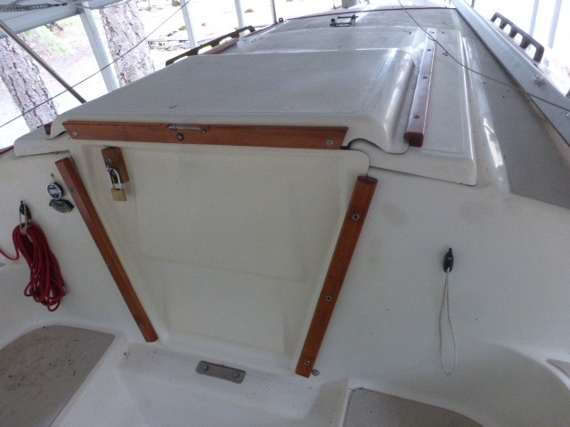

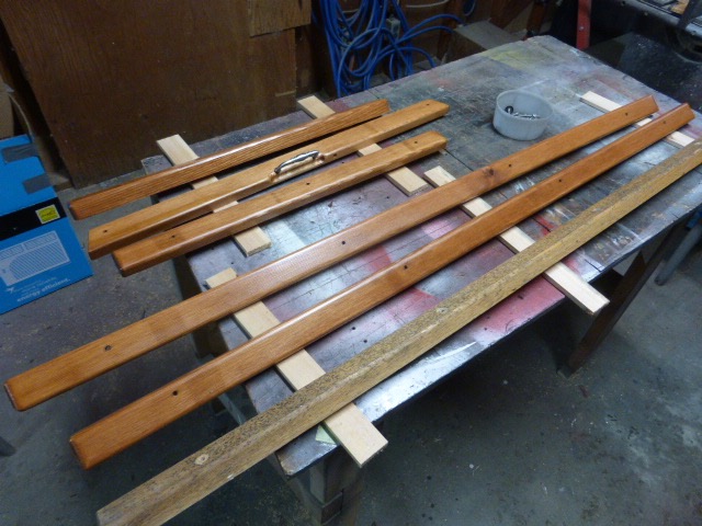

I've been fabricating replacement trim for a week or more now, whenever the temp gets above freezing. Just last year I had sanded and refinished the (oak or ash) trim that came on the boat (one piece shown next to the new stuff), but it was already starting to show mold spots so I made this new stuff out of cedar, stained it teak and sprayed multiple coats of polyurethane to seal. hopefully it will look good for a bit longer this time.

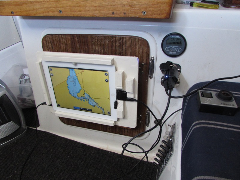

For about 2 hours per year I use my Ipad for Navigation and have been using it more on longer trips for email and internet because it uses way less power than my laptop. A while ago I migrated to 12 volt plugs rather than hardwired items and added another 12 volt plug just under the companionway so that I can use the Ipad/ Bad elf GPS powered out in the cockpit for my very seldom navigation application. Wiring the new 12 volt plug snowballed into a much larger job as I replaced several wiring runs with new 14 gauge tinned wire,. I also didn't have an easy place to stash the Ipad and after a good day sailing.. would find it somewhere on the floor so the Ipad also has a new place to store where its easy to get at and can also be charged.

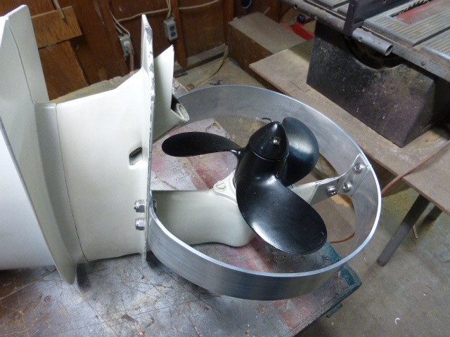

Another boring rainy day in Podunkville :( so I decided to build a prop guard for the "new" motor I bought this winter. I had built a guard just like this for the old 6hp Johnson, and it worked out well. 2' of 2"x1/8" aluminum strap and a handful of ss bolts/nuts for a total cost of ~ $15.00, which this titewad always likes ;) .

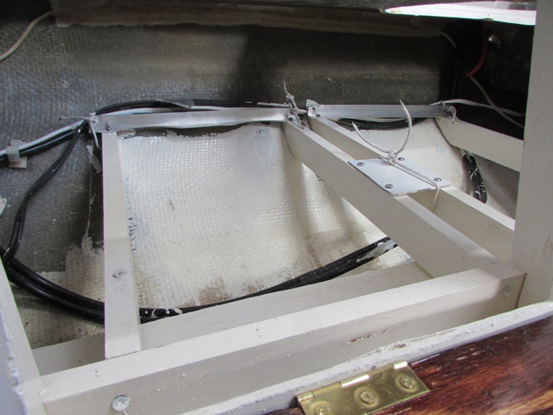

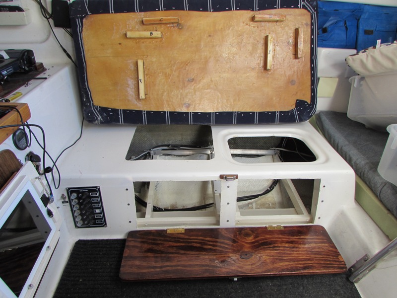

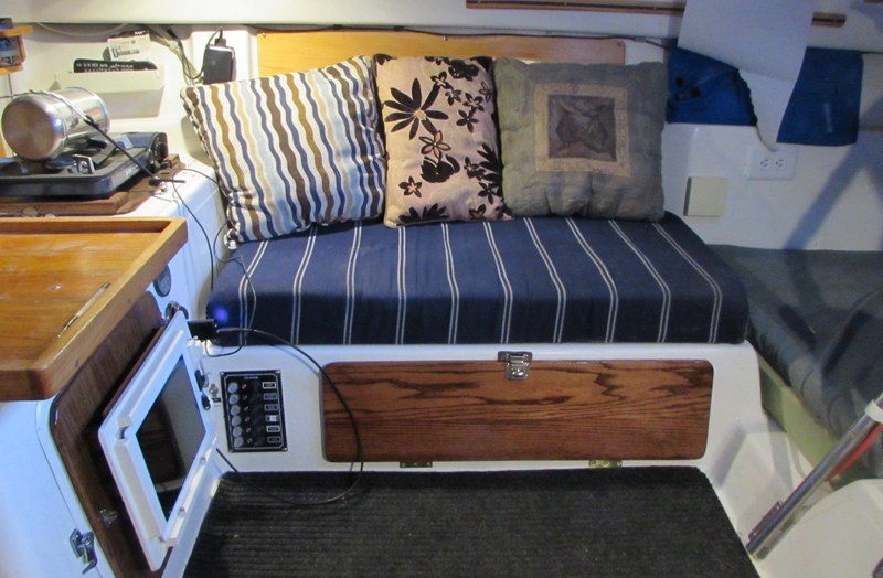

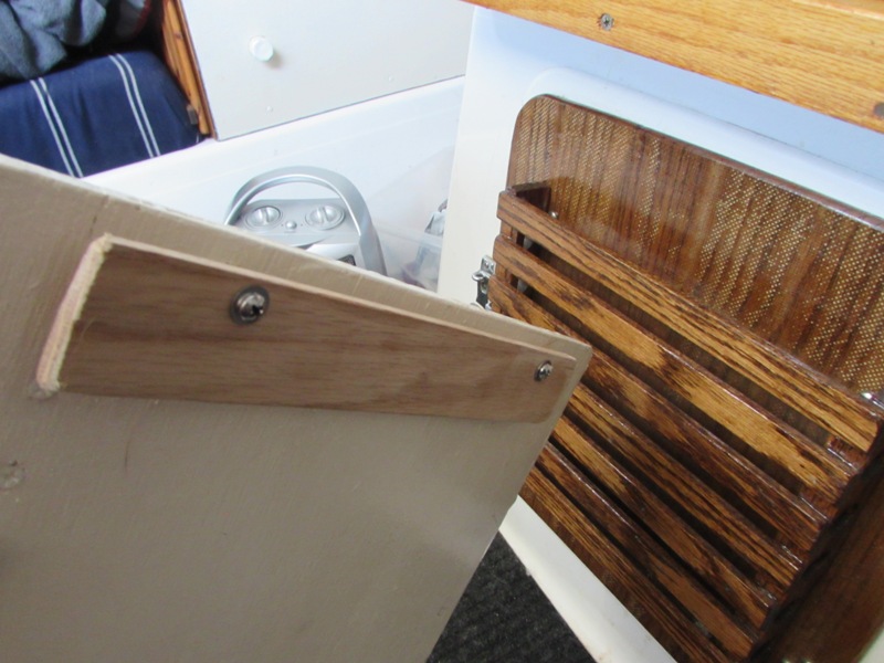

Getting ready for some summer one week camping trips and my wife and I mostly live out of three 18 quart plastic bins. Two of these bins have been stored under the starboard seat. Many years ago I used an idea I got from Timebandit that has worked out very well and that is to make the seat cushion with a plywood bottom, foam on top and then the cloth just stapled to to the plywood (first picture). This has been trouble free for many years. But.. since we typically get into the plastic bins at least once per day (sometimes more), I have to lift that seat up every time so I wanted to improve the ease of access to the plastic bins.
The plastic bins are each 18 quart. The frame had to be assembled inside the settee and in at least one of the pictures you can see how the plastic bin "drops" in and is held in place by the frame but its still very easy to lift the front and slide the bin out. The frame has the three vertical pieces which form "T" sections to support the seat and do a good job as the latch works if your sitting on the seat or not. The cabinet door added most of the weight as its a epoxy laminate of plywood and oak. Havent tried it yet sailing in wild conditions.. but I "think" everything should stay in place but be very easy to access..
walt
Jun 1, 2007
3,556
How are you securing the crossarms on the outer hull side?
With some 5/8 inch lag bolts..
JUST KIDDING.. that frame just rests on the outer hull as does one end of the plastic bin. The frame is held to the boat structure ONLY by the 9 screws that you can see in that first picture.
If I have any issue with front to back movement of the frame on the side that is just resting on the hull, I would just epoxy some stop blocks to the hull on either end of the frame. Its fairly rigid as is as all the frame crossarm pieces are tied together so I dont think I will have any issue. Hmmm.. maybe I will just epoxy in those stop blocks just to be sure.. the added weight will be almost nothing.
