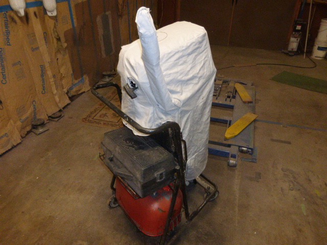

The recent snow and ice (and now flooding) has given me cabin fever I guess, so I'm desperate for projects. This converted shopping cart came with the new outboard. handy for making it mobile, but today I made modifications on it to also hold the fuel tank and a tool/spare parts box. I do quite a bit of spray painting etc in the other side of my shop, and have had overspray drift to this side before, so wile I was at it I sewed up an engine cover out of an old fleece lined car cover.
What's next? ;)

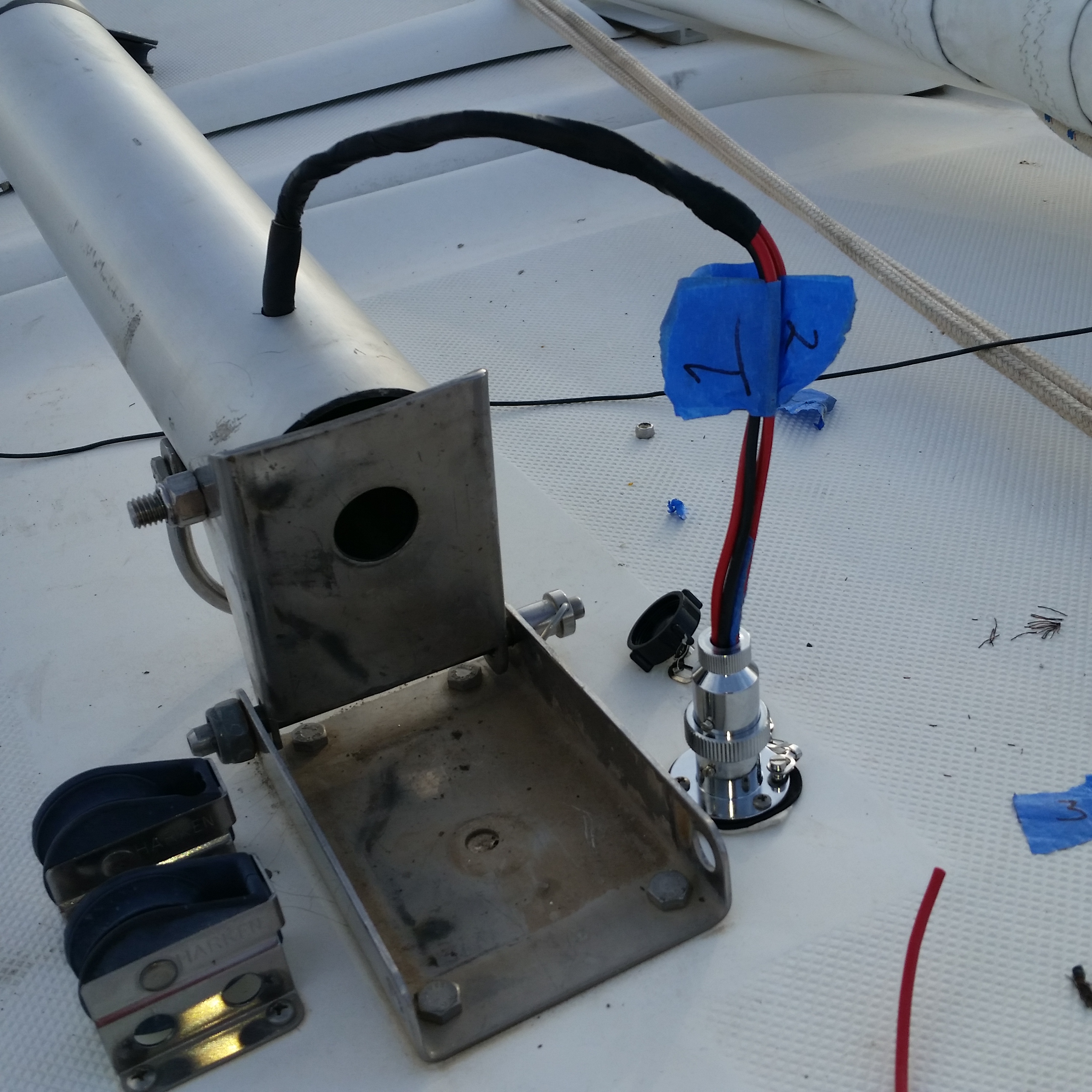

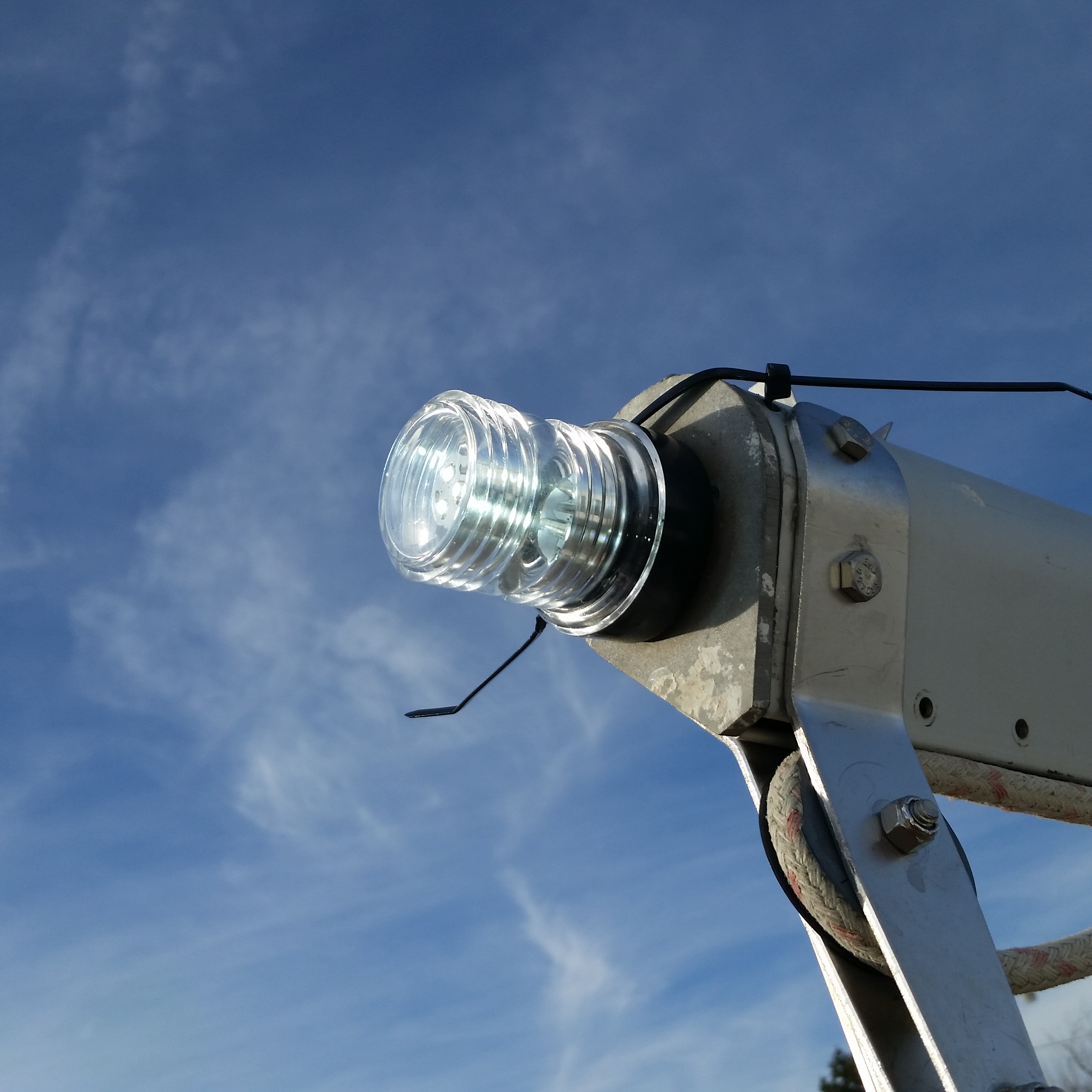

The mast got all new wire(marine grade) with a new anchor light(ignore the zip ties waiting on new fasteners) and combo steaming and deck light. Both came from Marine beam. I am really impressed with the brightness and efficiency of them. All run through a new through deck 4 wire plug.
New steaming light.
New plug

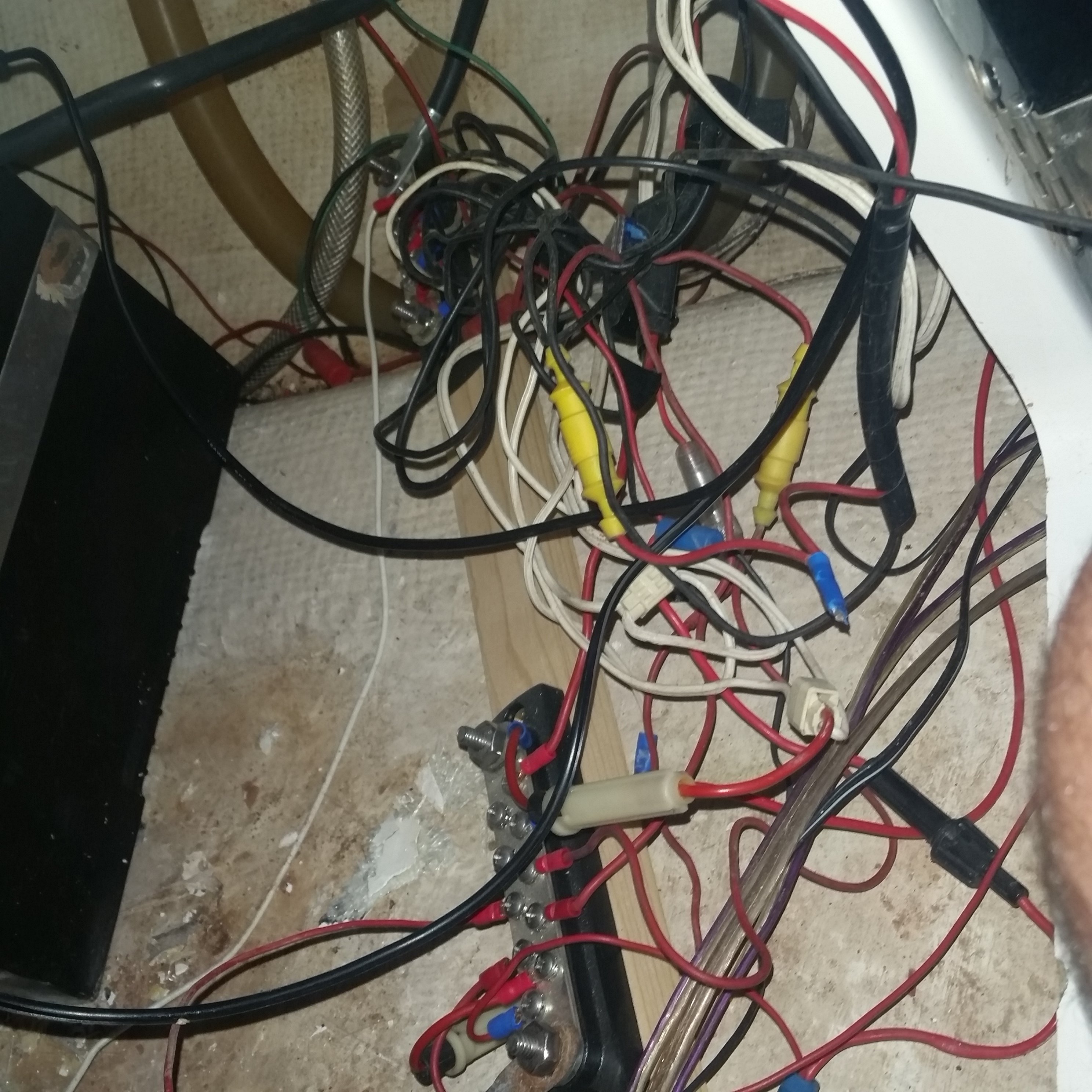

This is whats next on the project list. It looks like the 2 previous owners just kept adding to this ball and nobody took anything out. Funny thing is besides the 3 interior lights, a radio and navigation lights there isn't anything else that needs power. So it should be a hoot finding what these do.
You got over easy on your electrical system! I had everything from speaker wire to lamp wire to bundles of 12 and 14ga wire heading nowhere. I ended up finding 7 good leads and ripped the rest out. Now, every wire does something, and the majority of the lights have been changed to LED.
Nice steaming light. Where did you get it?
Sep 4, 2016
12
Macgregor 26s Rankin
Marinebeam.com is where i found it. They say they buy the fixture, which I think is aqua signal, then add their led lamps to it for a pretty good price. It replaced an identical one that was there that was worn out but had incandescent bulbs.
That's the plan for me all led inside and out. The last 2 that are not are the original stern and bow lights and hoping to be able to just drop in led's into them.

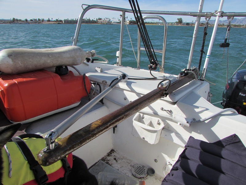

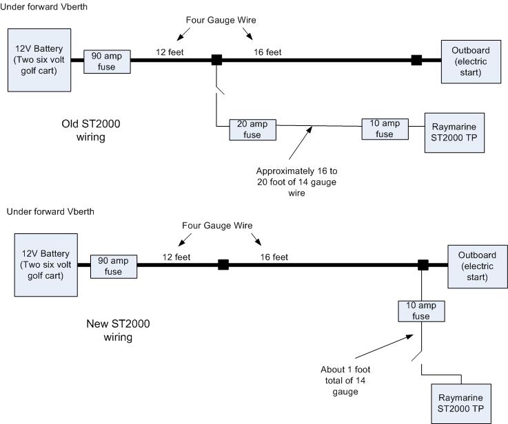

I am messing with my ST2000 tiller pilot and have found that if Im going out single had sailing - and really out to sail the boat (including some drag racing that always happens), I dont use the TP as it just adds one more hassle to control. Ive already been doing this for years but I can easily set up the sails, reef, run both main and jib single handed. When I first set the sails up, I lock the tiller in a fixed position with the outboard running and go forward and raise the main. The jib is on a furler, so easy to setup. I can easily get to all the sail controls (both sails - traveler, vang, sheets, outhaul, backstay) from a spot forward in the cockpit. For reefing the main.. just put the boat in Hove to. I have even set up the main in hove to by first deploying the jib, then put the boat in hove to. I think its good to know how to single hand the boat without needing the TP also..
However.. I sure do like having that TP!!! And of course it can be used to make single handing easier (unless its windy.. then I think it just creates more hassle). Ive done some long motoring runs down the local lake (like 15 miles) and the TP just makes this a relaxed pleasure. Intead of constant steering feedback, just hit that +/- 10 degree button every so often. Sometimes its also nice to relax with the TP sailing the boat. I have come to really like that instrument!!!!
This winter I started to have some problems with the TP where it would lose track and an alarm would sound. I think this was caused by a poor wiring job I did accommodating my batteries that are as far forward in the Vberth as possible and the TP which sits on the boat stern - ie, the TP and the batteries are far apart. I think I still need to re-calibrate. First picture below shows my before and after wiring for the ST2000. Note that the manual says that a max of 13 foot of 14 gauge wire can be used between the TP and the batteries. I was violating this on the way I had it wired. Fortunately I have a run of 4 gauge wire between the batteries and the electric start outboard that I took advantage of and very significantly reduced the impedance of the TP 12 volt supply run. Tested the new wiring out a couple days ago - pictures below.
Picture below - I use the tiller extension with a little ball socket to hold the tiller for short periods while performing other task (like initially setting up the main sail).
Picture below.. Dog looks pretty relaxed with the TP sailing the boat.

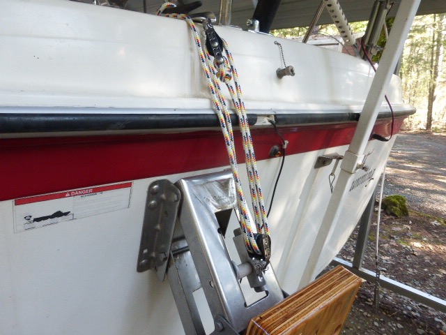

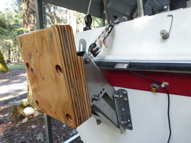

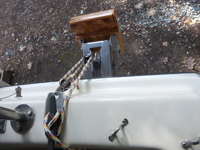

I've actually been working on this modified @centerline engine lift for a wile now, but just finished it up today, now that the snow and ice is melting away. "finished", that is, unless I decide to replace the horn cleat with a clam cleat in the future. I had originally intended to use a clam cleat with eyelet, but forgot to order it when I was ordering the blocks. the fabricated aluminum upper mount was sandwiched between an existing horn cleat and the transom, so no new holes needed to be drilled in the fiberglass, which I also like. This will make it much easier to lift and lower the engine, as it doesn't require leaning out through the rear rail to release that dang latch. also a nice additional benefit is that the engine can not only be raised higher, but also drops a couple inches lower when in use. my long shaft (20") Johnson will appreciate that. I replaced the multi-position latch lever with a fabricated aluminum strap that just has a slot. this gives a good positive up-stop and down-stop, without binding the lift.
