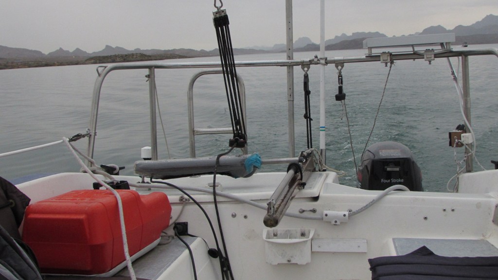

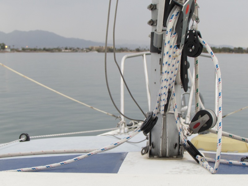

To put the pop-top up, I have to disconnect both the vang and the boom kicker. The boomkicker I have is about 10 years old and I think they changed the design but on mine, if you lift the boom up, the boom kicker "slides out" and I can put it over to the side with the pop top up. Some hassle.. but I use the boom kicker more often than the pop top. The pictures are from this morning so I just barely had to mess with this.

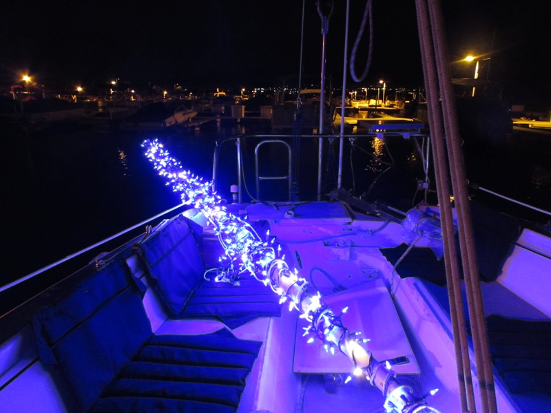

Today measuring currents @ 12 volt powering LED Christmas lights from an inverter..
walt
Jun 1, 2007
3,549

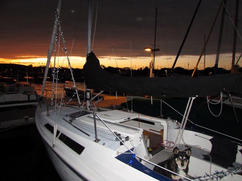

Im preparing for a boat parade next weekend. First time doing this, it just took me a while to decide that floating around with 110 VAC all over the boat in the water and at night is a good idea.
In the pictures are 720 LED bulbs on the boat and I just powered up the whole thing yesterday (parade is Friday). I am powering the LED Christmas tree lights (most bought at Walmart) with an inverter off 12 volts. The current draw at 12v is about 2.4 amps. This is under 30 watts so I can easily power the whole setup with a small 150 watt inverter. I have two 6 volt golf cart batteries for the power source so around 100 amp hour "usable 50%" capacity so if fully charged, I could power this whole setup for 41 hours or so just off the batteries. However, I will likely have my outboard running near idle and that will likely provide some of the charge for the lights. Pictures are hosted on FB

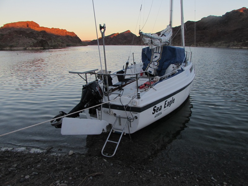

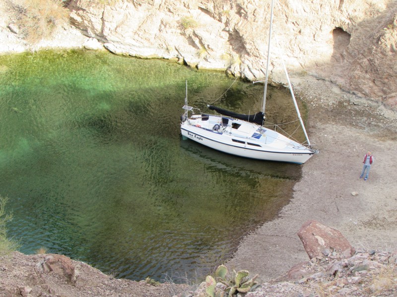

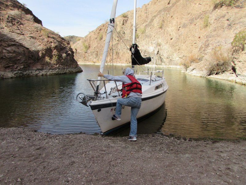

These pictures were all taken today - doing some exploring by boat on a light wind day. This post is done from the boat in the third picture (now) where we are camped for the night using a cell phone hot spot.

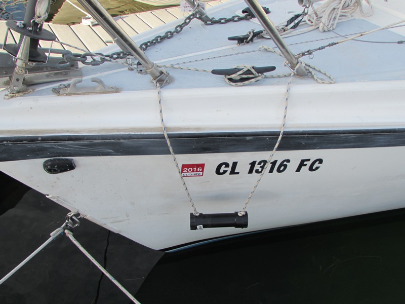

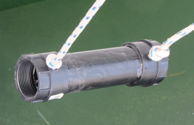

I posted earlier regarding a very simple bow step and have both used it more and revised it. I thought it worked fine but the wife recently used it and gave it the thumbs up (she is sort of easy to please.. puts up with me..). You dont want the plastic step to either rotate or slide on the line plus provide as flat as surface as possible. The old design allowed the step to slide on the line, this new setup is super simple, just the plastic pipe (I used ABS) and a couple adapter fittings glued on the ends to beef up the plastic where the holes are drillled.

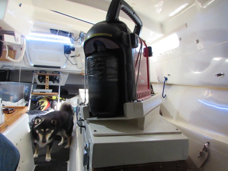

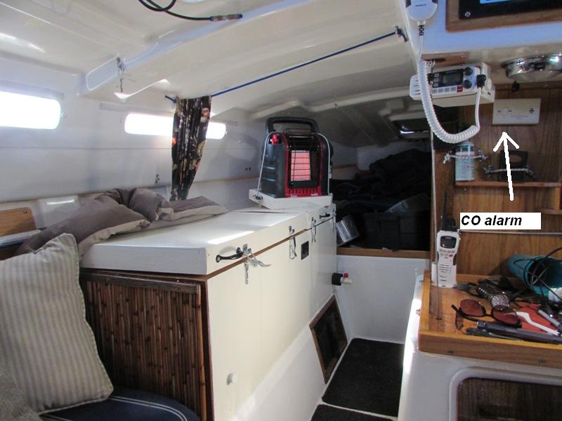

This Mr Buddy propane heater seems to work well with the Mac. I used to keep in on the floor but it was always in the way plus your worried about the dogs tail bursting in flame when he goes too near the heater. So I made a winter fixed spot for the heater (removable for summer) plus mounted the CO detector in a prominent spot about head level. I tested it today for about three hours with the cockpit closed up, no issues at all. The boat feels warmer when the heater is near your feet but this seemed like an overall nice spot for not being in the way. Heater can be easily removed but its pretty rigid where its at, .

I assume you only have the heater on wile at anchor? but either way, do you find the safety tip over switch to be overly sensitive? I haven't used our new Portable Buddy yet, but the previous mini job was so sensitive as to be almost un-usuable wile on the water.
walt
Jun 1, 2007
3,549
I was in the water but also in a slip and it was windy today so the boat was rocking somewhat, no problem with the tip switch. You can see its tilted to "aim" the heating face down a little since its mounted so high- that also didnt seem to cause any problem either with lighting or it staying running. I have had it go out on the floor when bumped or if your not careful moving it. Where I will use it is for beach camping and it will get used sometimes before going to bed and almost always (in the winter) first thing in the morning. Anyhow.. so far no issues. FYI, I used to have it on the floor about close to where the dog is in the second picture near my feet and often pointed at me.

Picture from today - I had left that Mr Buddy heater in place (I think mine might also be the "portable buddy"). everything stayed secured

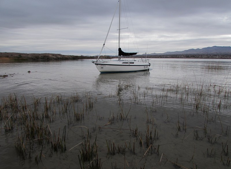

Second picture.. I got the boat stuck on a sand bar screwing around trying to find a place to beach the boat. I was about to go blow the ballast with a 12 volt air pump but the boat finally came off with a push. I walked from the boat to where I took the picture below.
