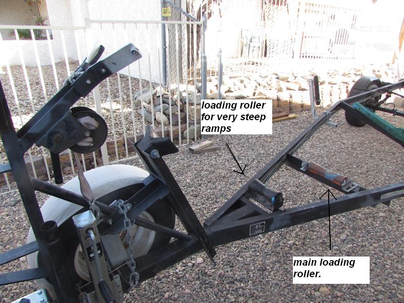

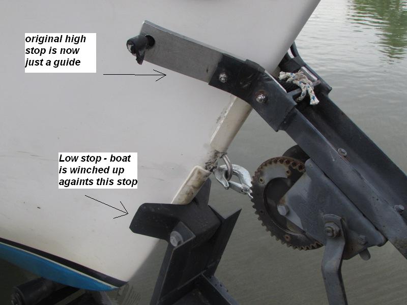

I pulled my 26S out today getting ready for a road trip. This ramp has about a 10% slope. Just before taking the boat over to the waiting trailer, I hooked up a high volume low pressure electric air mattress pump to the ballast vent port (pumps out the ballast water in around 10 minutes), then motored over to the waiting trailer.
Some of you have seen this before but I modified the stock trailer so that the stop bumper is below the winch location (stock position is above) and I have two loading rollers. The one that is way forward is needed if its a very steep ramp, it may not have done much on this ramp.

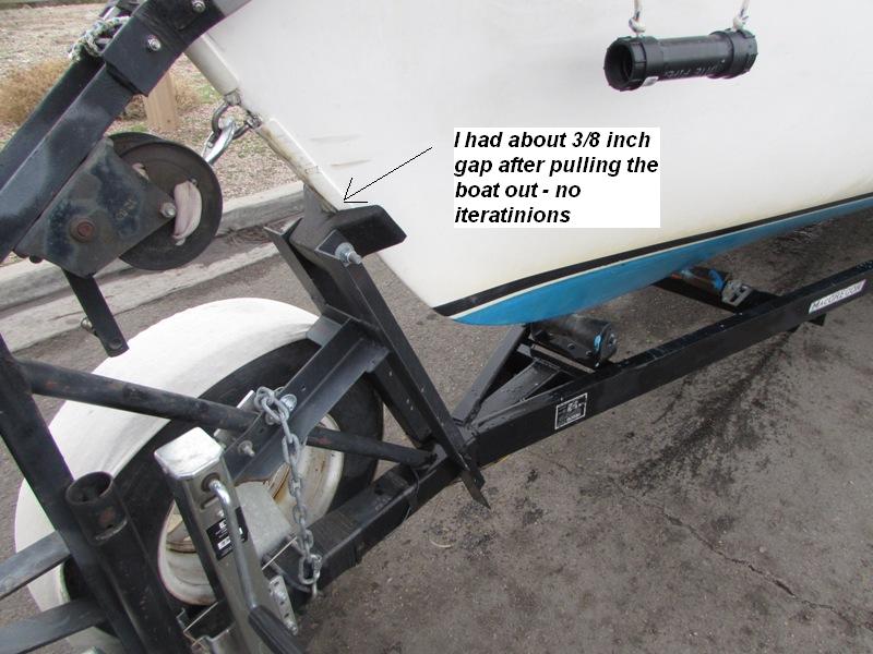

The boat was winched up to the stop one time, then pulled out. When I got up on level ground, I checked how far the bow had pulled back from the stop and it was only about 3/8 of an inch. My trailer is not perfect but its overall super easy and fast for loading this boat without any iterations of pulling forward a little then re- tightening the winch. I did do a "bump" when I stopped to take down the mast and it got rid of that last 3/8 inch gap..

Walt. have you tried winding the winch strap the opposite direction on the spool? it appears that the pull angle would be more direct if you had the strap coming off the top of the drum.
When I raised my winch ~3" it was a huge improvement in the way the boat settles into the nose block.
walt
Jun 1, 2007
3,556
Part of the physics of that is that the strap length remains fixed as the boat rotates with respect to the trailer as its coming up the ramp. So.. it might change things a little. You can imagine that above the strap, the boat rotates away from the upper stop position (which Im not using) but it sort of rotates towards the lower stop position. I dont have any trouble being able to winch the boat foward up to the stop with the way shown in those pictures so I really dont have any problem to solve by moving the pull vector upwards. Having those rollers up near the bow also help..
But.. it ends up being a complex problem.. maybe I should try your idea the next time I pull the boat out - which will happen two more times before the end of Feb. I also dont really have much of a problem to solve.. Ive gone from many inches of gap doing something like this to only 3/8 inch (0.375 inch) with just getting it up against the stop one time, then driving out.
