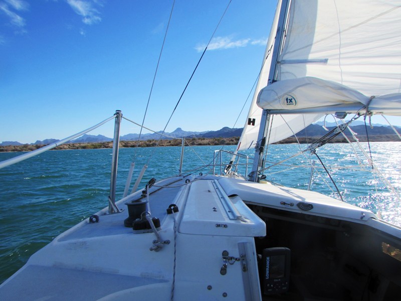

I tried something yesterday I had been wanting to try for a long time.. I was single handed and it was fairly windy. To set the sails up, normally I will set the main up first - with the motor running and the boat heading into the wind - tiller locked. This works OK especially in lighter winds but yesterday I also would have had to put the reef in the main while setting it up.
Instead, I first unfurled the jib (which was almost all I needed). I then got the boat in "heave to" with just the jib up. I was able to set the main up with the reef and it was a fairly relaxed process. I have discussed this before on forums and apparently it doesn't work on all sailboats (they need some involvement from the main to stay in heave to) but I thought it worked fairly well on the 26S. New trick for solo setup when its higher winds. The motor was not at all needed (it was off and out of the water).
All would have been well after.. except that when I set the main halyard up, I wasn't careful and had it around one of the jib sheets.. DOH! Getting that fixed was definitely NOT RELAXED. Picture below with a reef in both the main and jib.

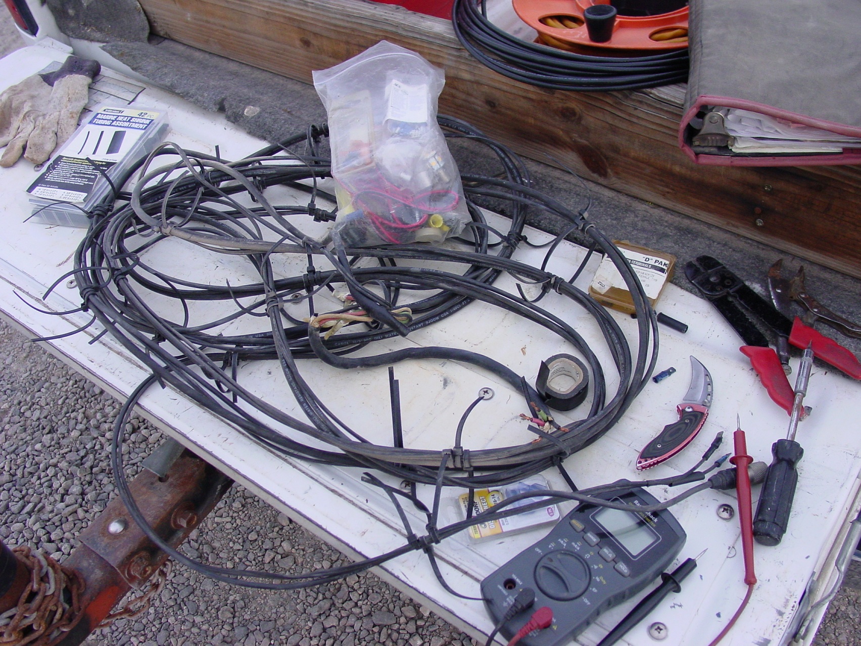

Over the last two days I've replaced the house battery, the VHF coaxial in the mast and cabin, and the corroding PL259 connectors. So I figured I might as well replace the original lamp cord for the anchor light, too.
You'd think that a fishing/shrimping town like this one would have at least a couple of places to buy marine-grade hardware, but Rocky Point (Puerto Penasco) has exactly zero chandleries. I spent some time driving from one hardware store to another in a search for some stranded wire. Thankfully, I was fortunate enough to meet up with a gentleman at the marina who said "I've got all that stuff over at my place".
So I followed him back to his place near the malecon, and yep, the guy's got everything.
I did pay a premium for the wire, good 16 gauge tinned, because it looks like he's the only game in town. He did lend me a heat gun for the day, for free. :wink:
