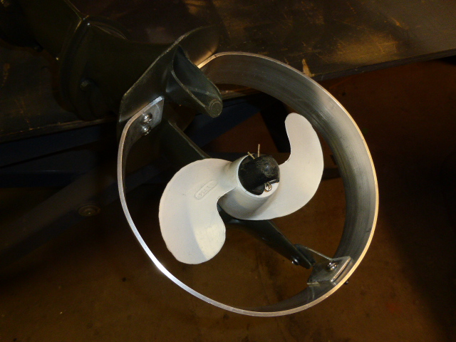

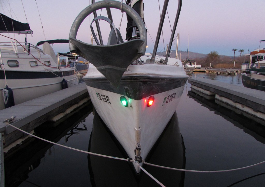

It's been high 20s and low 30s for a wile now, so getting the "new" boat ready for sailing has been a slow process. I build a fire in the shop and sometimes actually get it warm enough to work out there for an hour or two. brrrrrr.
Today I did get a prop guard fabricated. hardware store 2" wide alum 1/8" thick bent into a hoop and a small chunk of 1" x 1" angle alum stock for the lower brace. ad a couple ss nuts/bolts and wala. prop guard = under $30.00 and still have aluminum left over for the next project. ;)

Looks good!

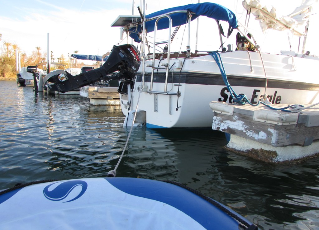

I think Im posting too many pictures here.. but went sailing today which is notable as its January 1. It was a little chilly but overall a very nice day.

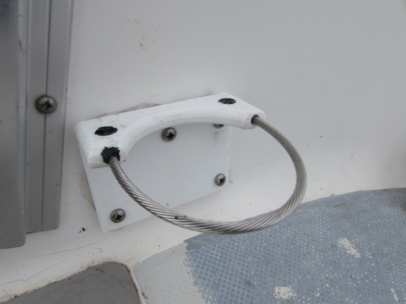

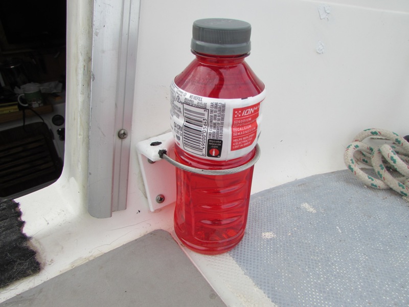

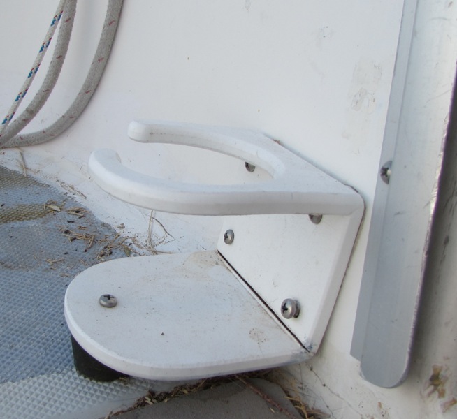

When sailing solo, I like to sit fairly far forward in the cockpit - also puts me near the traveler which gets a lot of use.
I also like a cup holder in that area and pretty much every thing Ive tried ends up getting stepped on and busted. So now Im trying a new idea that so far looks like it might work well.
Picture below shows what I had on the boat. This one has the base busted, the other side had both the base and the upper arms busted from being stepped on. This cup holder would also sometimes catch the jib sheet.
Picture below - I cut off the arms of the cup holder above (the second one already had the arms busted off) and drilled some "horizontal" holes for 5/32 SS cable left over from when I made a new forestay. Also drilled the "vertical" holes that you can see as a black dot on the top of the plastic. I used JB epoxy smeared on the cable and the top hole was also filled with epoxy which I hope forms a plug and keeps the cable contained. It seems strong.
I think I will be able to occasionally step on this - no problem. It also wont catch on the jib sheets.

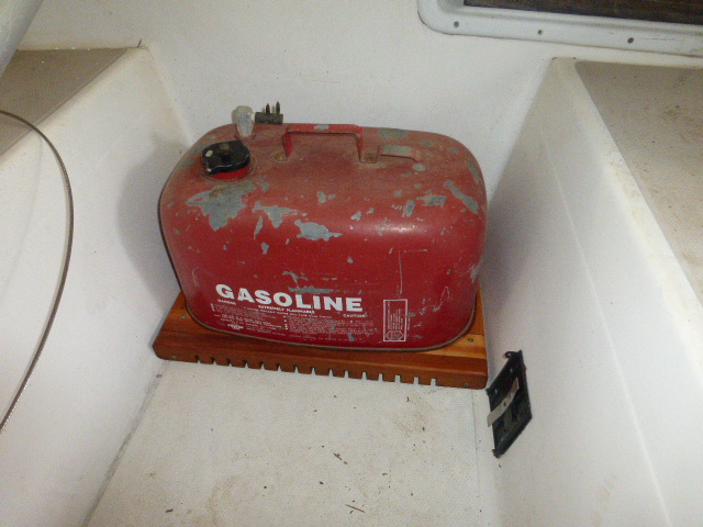

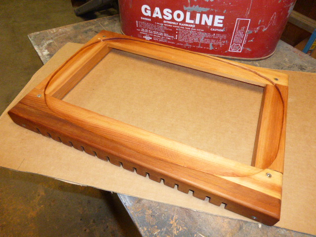

Whipped up a fuel tank support to protect the fiberglass, as well as the bottom of the tank. made from clear cedar and then oiled.

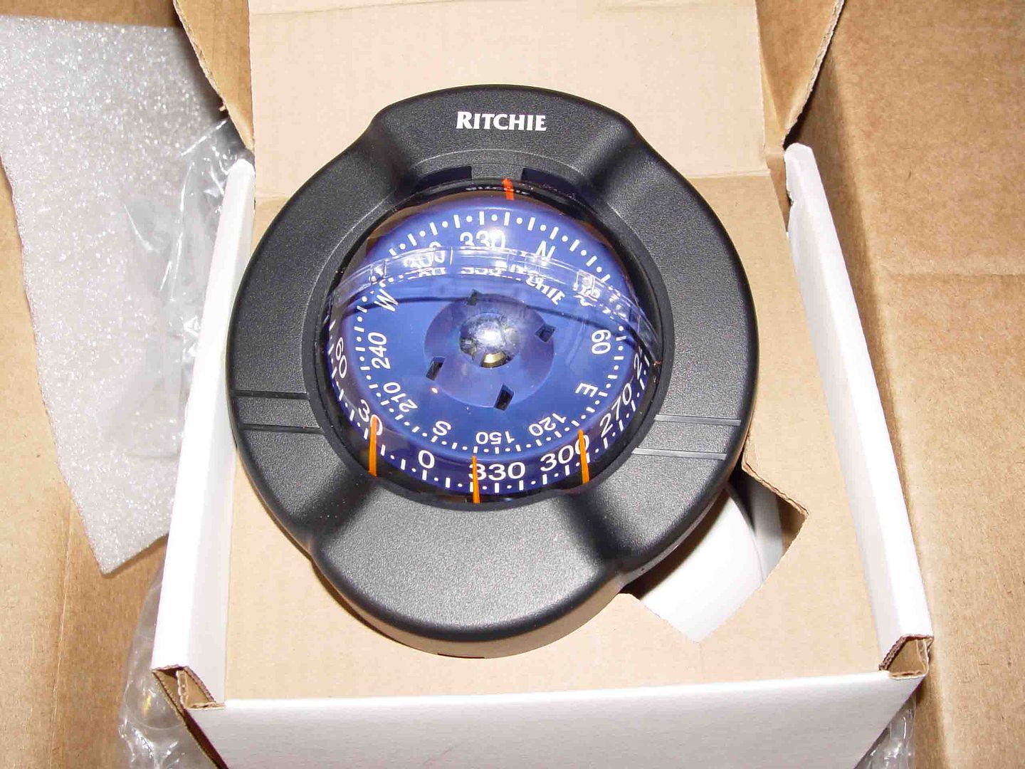

This came in today!
It'll replace the old compass which was cracked, crazed, and had no oil inside the casing.

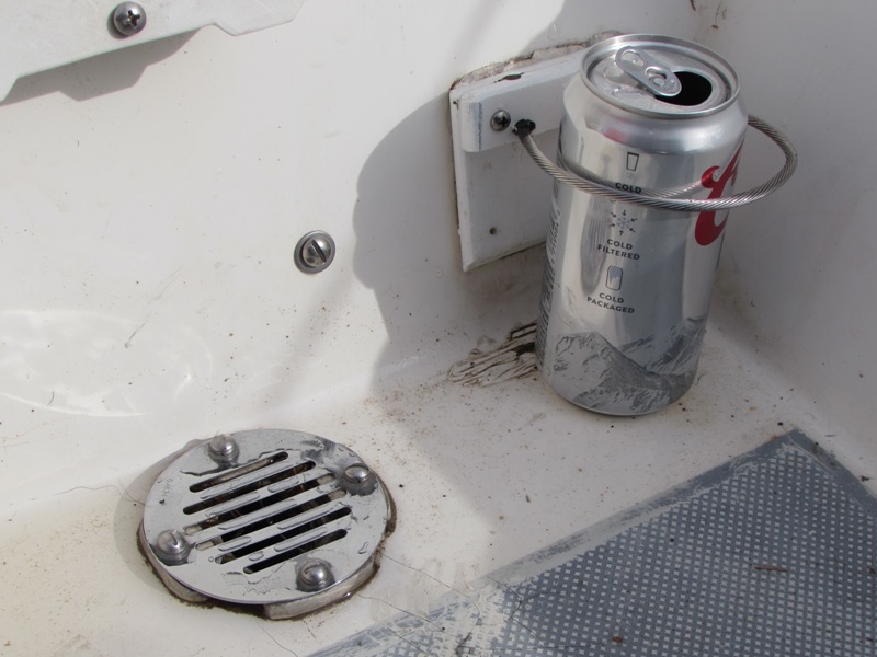

This is the cup holder in the back where I sit for motoring that I finished yesterday (just in front of the outboard well). This cup holder had been stepped on so many times that just the plastic back plate was left. I like this spot to keep a drink and same as before, its 5/32 ss cable.
Also in the picture below is the drain in the back of the cockpit. This restricts water flow a bit but in all the years of sailing this boat, I have never had water come into the cockpit. I put that cover over the drain after watching the lid from a gatoraid bottle go through the drain and nearly get stuck. This drain has been just like this for maybe 7 years now. I think the four standoff pieces that the SS drain grate sits on are 1/4 inch thick AL that were JB epoxied. No problem in all these years.

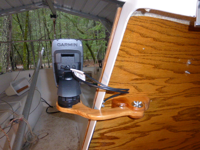

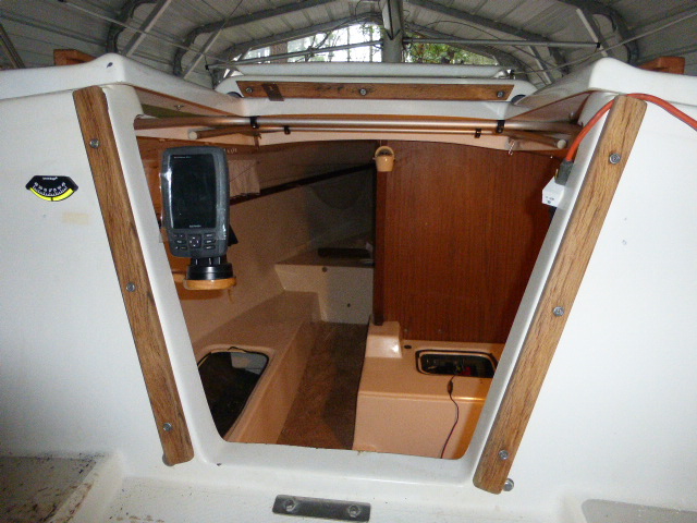

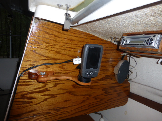

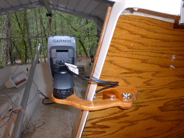

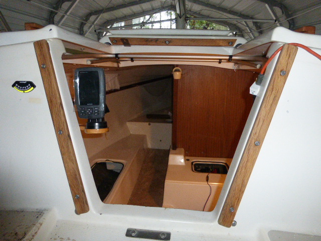

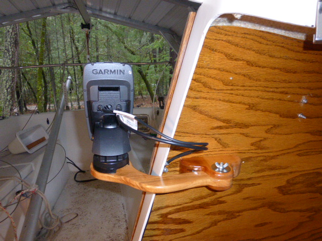

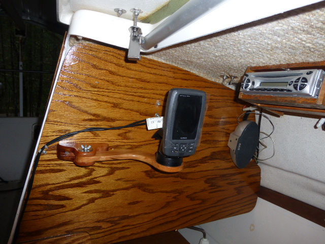

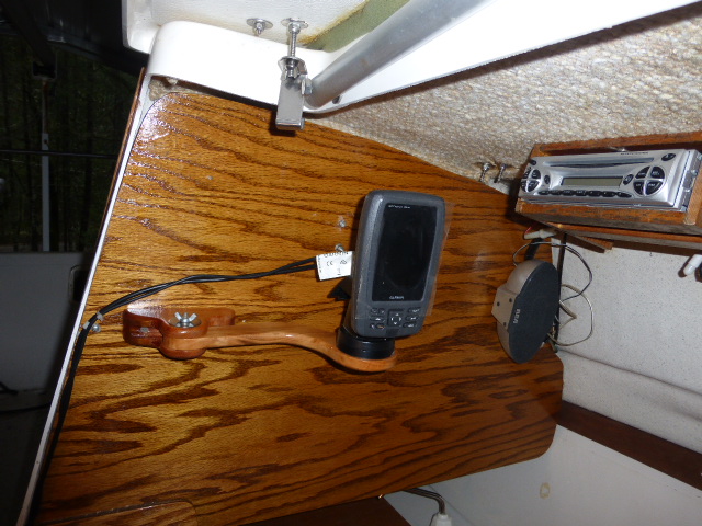

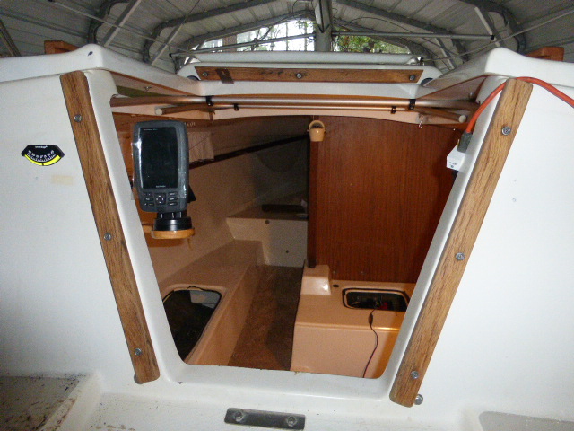

Got my new Garmin 43dv set up in the boat today. new folding mount made out of a piece of Plum wood that I've been hoarding since cutting the tree down about 20 years ago.
