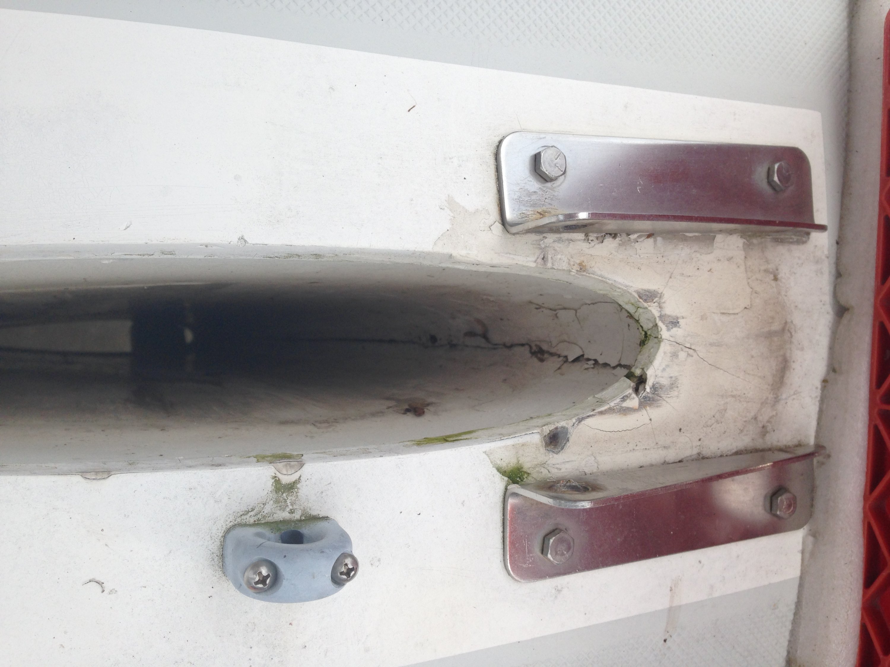

I have a similar problem to Willsnow. I have a crack in the trunk for the dagger board (see picture). Any ideas on how to fix this?
Willsnow, does the crack on your Mac continue down the trunk?
Some miscellaneous thoughts and notes:
No water coming into the boat from here as best I can tell
It goes about 1/2 way down the trunk or about 2'
Yeah, mine does have a crack down the trunk too. Haven't decided what to do with it yet. This is the winter of fiberglassing, sanding, painting, and re-bedding every piece of deck hardware. It's not as sexy as previous winters projects, but more necessary.
walt
Jun 1, 2007
3,547
Cant you see or get to that side of the dagger board trunk from inside the cabin? Seems it be about where the bulkhead is on the 26S just under the mast.. I suppose you could also just leave that crack in there and never fix it as its way above the water line. The worst thing might simply be a place for rain water to leak in??

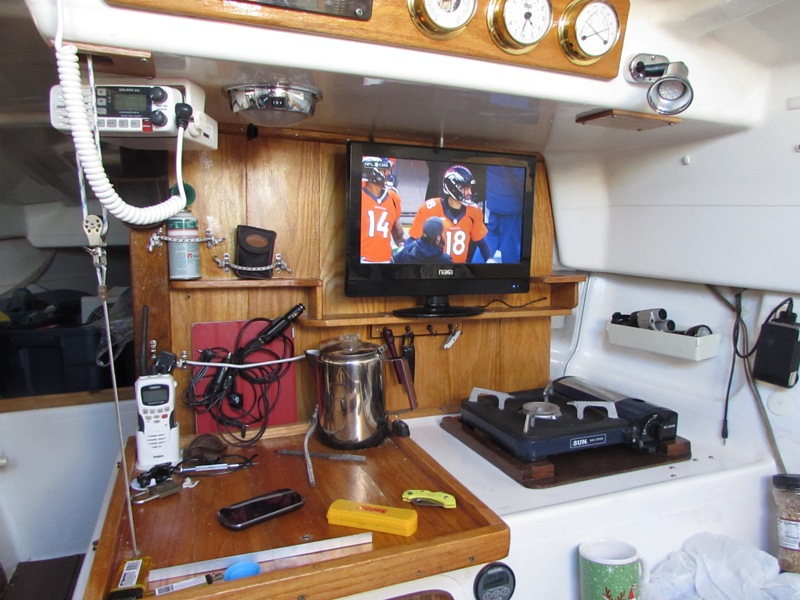

Went sailing today, put boat in "Hove To" and "we" watched the last nine minutes of the Bronco/Patriot game.
Pictures show the boat in Hove to for the last part of the game. Boat drifts at about 1.5 knots like this.

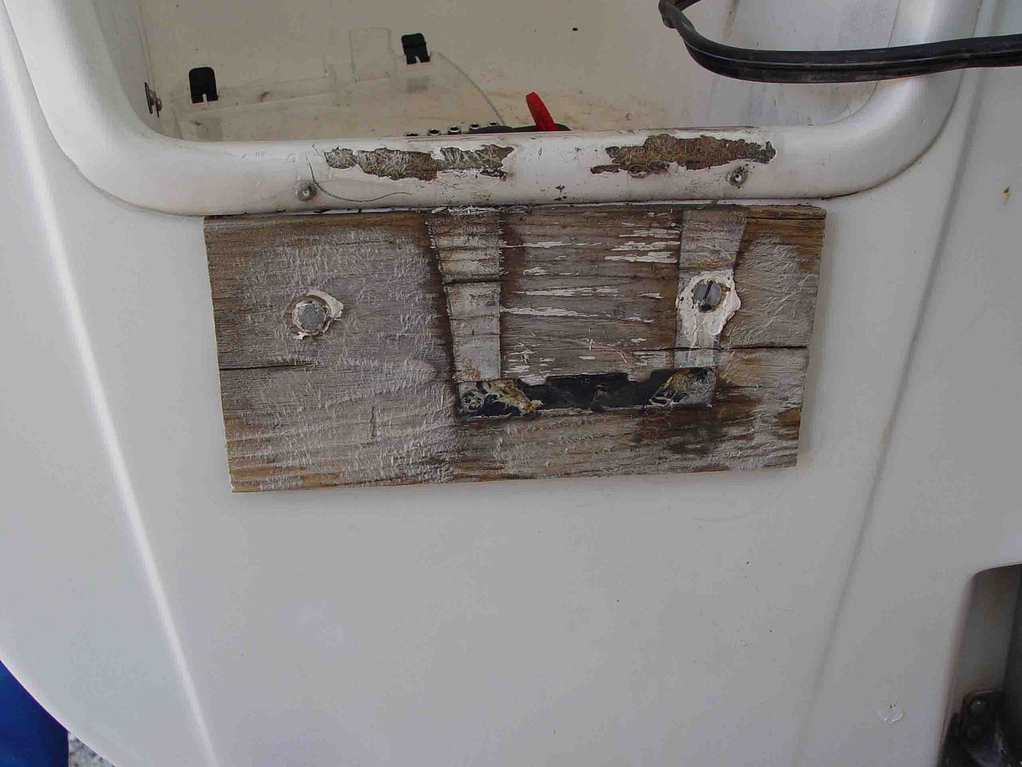

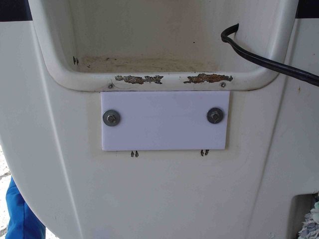

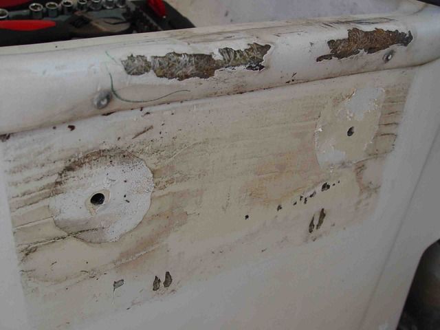

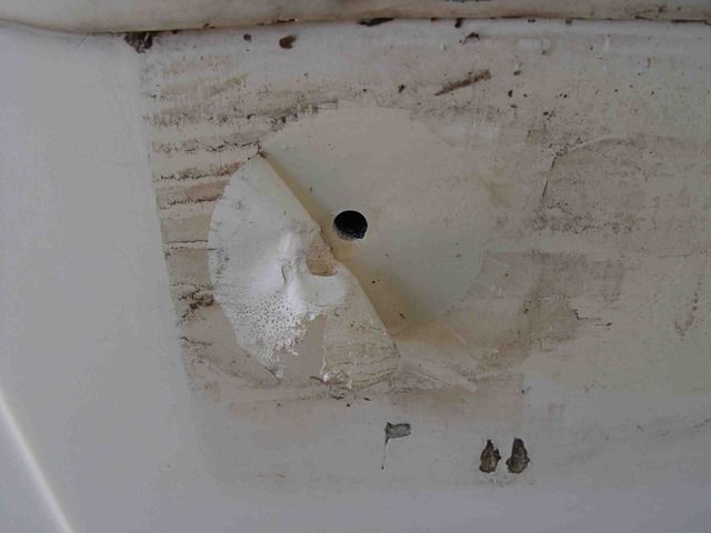

Actually, this is from yesterday:
The backer board that was on the transom looked like it was in bad shape. It was a piece of plywood that wasn't finished. It was rotten and crushed, and I found a couple strange little beetles living in it when I took it off.
Underneath, the mess was mostly cosmetic and cleaned up easily. That bare area on the rub rail is just worn through the gel coat, but below are a few shallow gouges.
The bolts looked like they had been bedded with a household caulking, and it peeled away too easily. Definitely not 3M 5200 silicone.
My fix was to replace the the board with a piece of plastic delrin cutting board, cut to fit. This has many better properties than the plywood. It won't crush and has better wearing properties. Yeah, it's not "marine", but that piece of plywood wasn't either.
The entire area was cleaned and inspected. Fortunately (knock on wood) I didn't find any evidence of rotting core material when I poked around in the holes with a dental tool. I merely drilled holes in the new backer board so it would fit in the same place. The backing plate on the inside of the transom (which I forgot to photograph) is a nice piece of stainless steel with two stainless washers welded to it. It's quite hefty, so it was re-utilized. The holes were filled with and everything was bedded in marine silicone sealant to make a waterproof seal. New bolts and self locking nuts were installed
This is what I finished with:
The area where the gelcoat was rubbed off will get a touch-up in the future, as will the small gouges.
