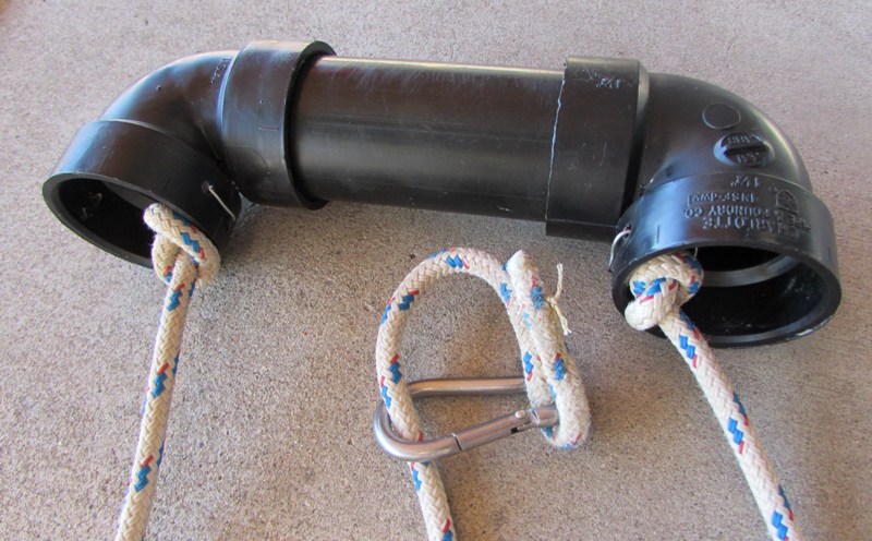

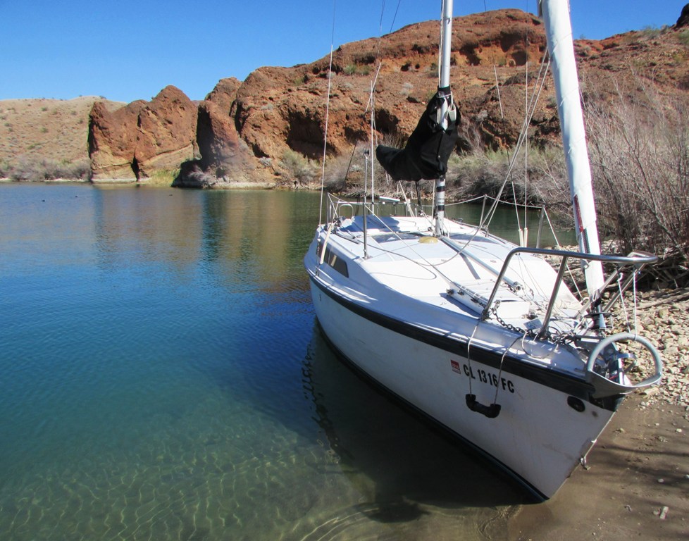

today. In the first picture I was trying out a PVC single rung bow ladder, worked "good enough" for how simple it is. 2nd picture is a 26D out sailing.
edit - this is the bow foot step. I will mostly use this for pulling into a sandy beach bow first to let the dog take a potty break. Just one step makes getting on and off the bow a lot easier. This is 1.5 od, and wont rotate under your foot and seems plenty strong. Inside width is just slightly wider than my shoe. I will have two quick clips to attach it to the bow pulpit when I need it. Light weight, should be easy to store.

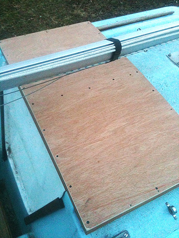

Trying to get the 1968 Venture 17 ready to sail. Made a new main hatch from cedar and mahogany plywood. Glued and screwed together; it seems plenty strong. I'll fill the screw holes, and varnish with several coats. Also cleaned out several years worth of dirt and mouse skeletons.
Ordered a new genoa from fareast sails today. I'll try and repair the main and jib for now. The mice found them and chewed a few holes.

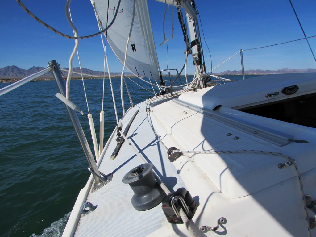

Wonderful sail today. I really like those new fairleads for the jib sheets single handed, makes it way easier to control the jib from either side of the cockpit. Long downwind with the centerboard almost all the way up, hit about 6.7 knots measured by watching the GPS.

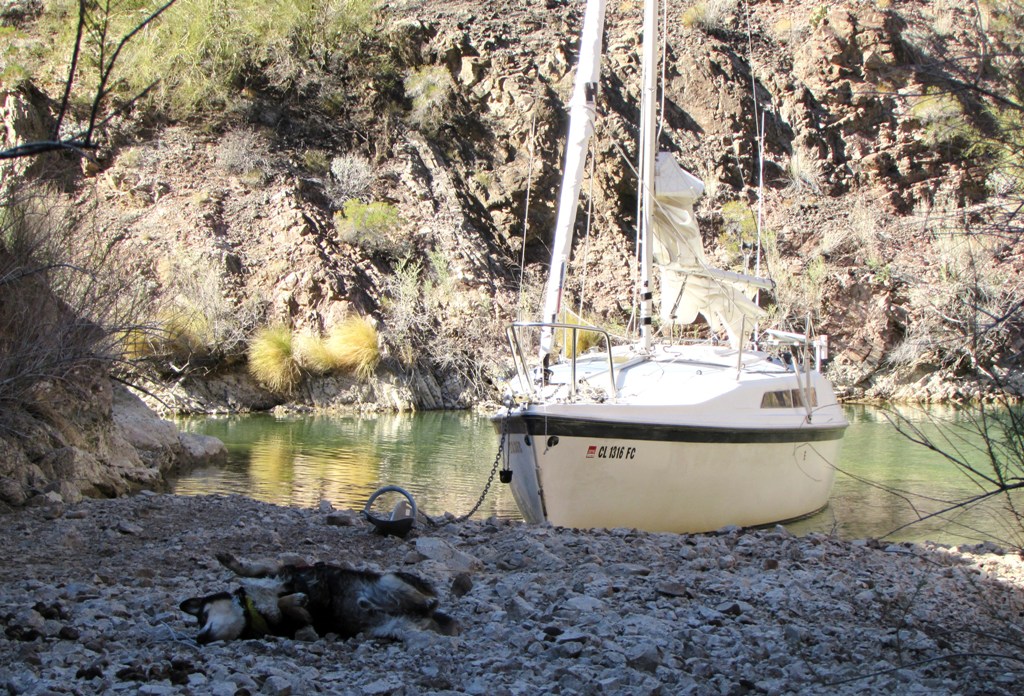

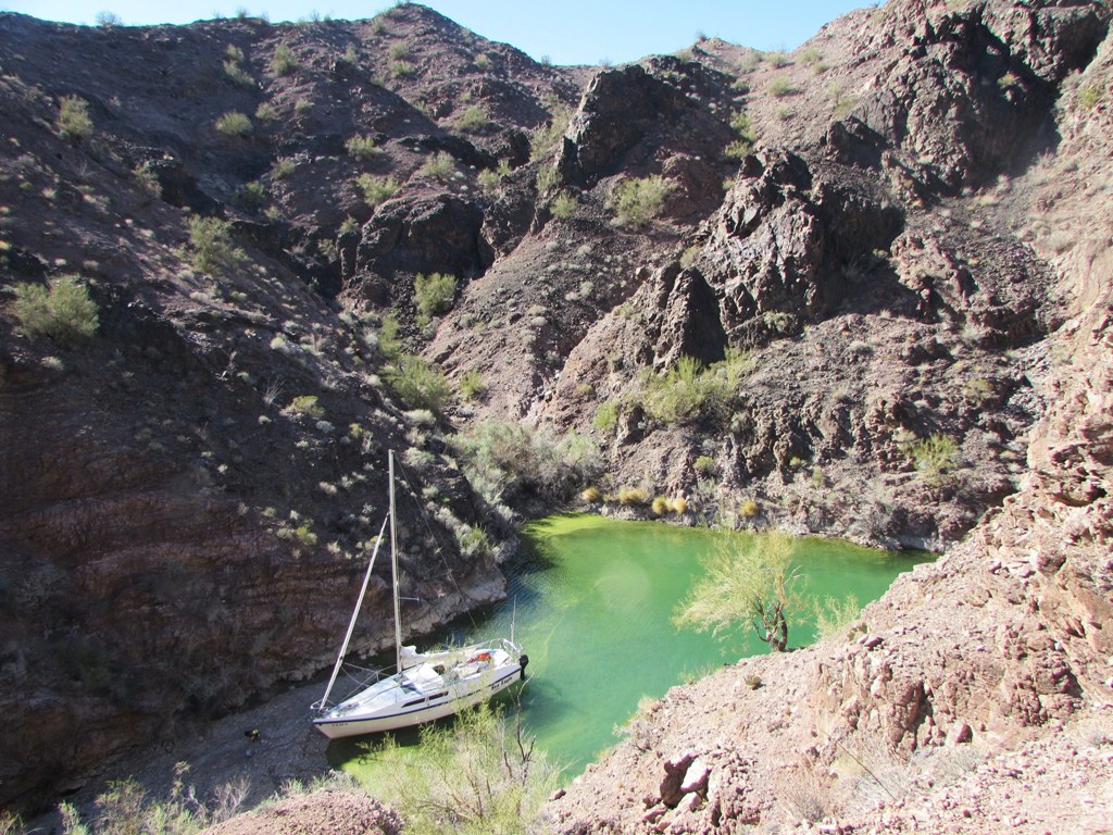

I like the odd places you can sneak into with trailerable boats.. some pictures from a couple days ago. In the second picture, pooch finds some really nasty stinky stuff to roll in during a potty break.

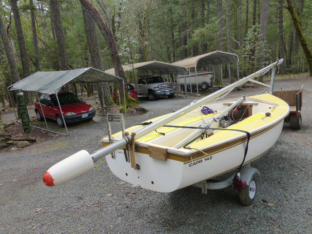

BTW: You might be able to help us with a dilemma. We still own our last boat, which is a Capri 14.2. very similar to your C15 I would think. everything on the boat is new, and I had ordered custom sails for it just before we happened on the Mac. they are due to arrive in March. So my question for you would be: why do YOU sail the C15 in the summer months? we (I) have really enjoyed the sporty nature of the smaller boat and being more intimate with the sailing experience. plus we're thinking it might be nicer to use on the smaller lakes for a quick summer splash. too cold this time of year to be that "intimate" however ;) .
So Is our thinking correct, and we should keep the 14.2? I'm curious to hear your reasons for doing so.

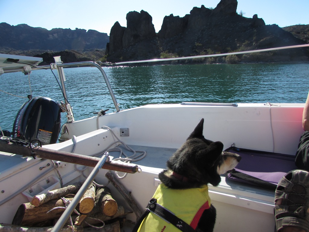

edit.. plus you can carry wood for a campfire with the pocket cruiser (two days ago)

The only time I had the 14.2 turtled was when I intentionally put it over to practice righting it. after that I built a mast float that prevents sticking the mast in the mud. I admit I'm anxious to try it out next summer with the brand new sails and some serious wind ;) .

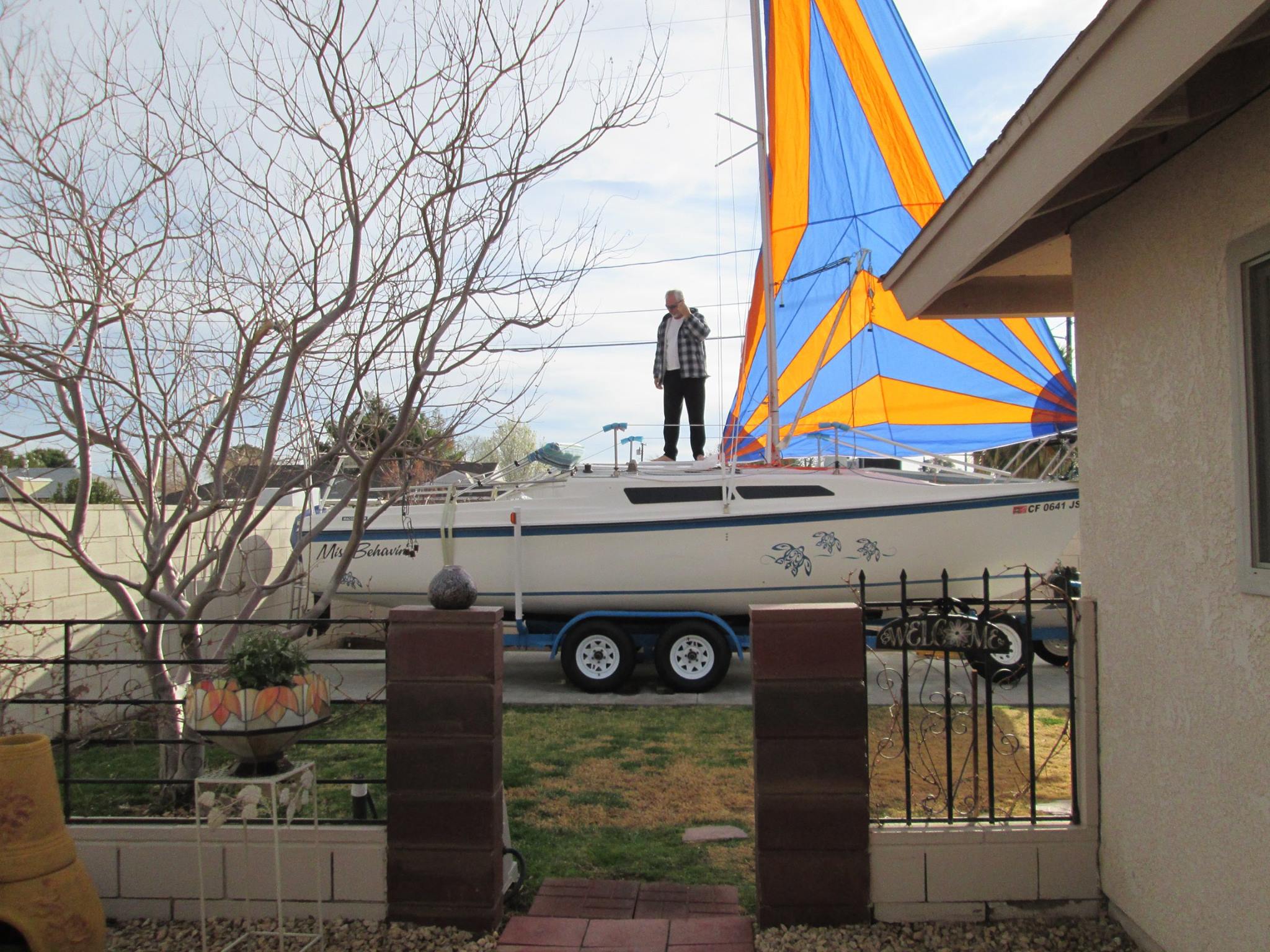

I finally got a chance to uncover Miss Behavin' and raise the mast so that I could rig my new masthead drifter that Santa brought me. She fills nicely with even the slightest breeze. Since the shrouds don't reach the top of the mast I attached the drifter to the halyard with two 120# tensile strength zip-ties to avoid over-stressing the mast. A quick calculation shows that the side load on the zip-tie will break before the side load on the mast reaches 50#.
