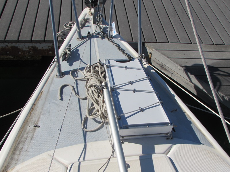

This is still a work in progress.. the 26S does not have an anchor locker or any place to store the rode at the bow (anchors often get stored in the Laz - not real convenient for a bow used anchor and also not a good place for weight). You could probably cut up the bow and add something but thats cutting the boat up more than I like (if you have to modify that much, you might have picked the wrong boat to begin with). Anyhow, I have had various "bucket" arrangements over the years that allow the rode to be removed from the bow and stored in the Laz.. which is nice.
This first picture shows my very stylish orange bucket that held the rode a few years back
The picture below shows the next iteration in the rode bucket.. It worked fine and the bucket is easy to store in the laz but it looks like Im getting ready to do laundry with it up there.

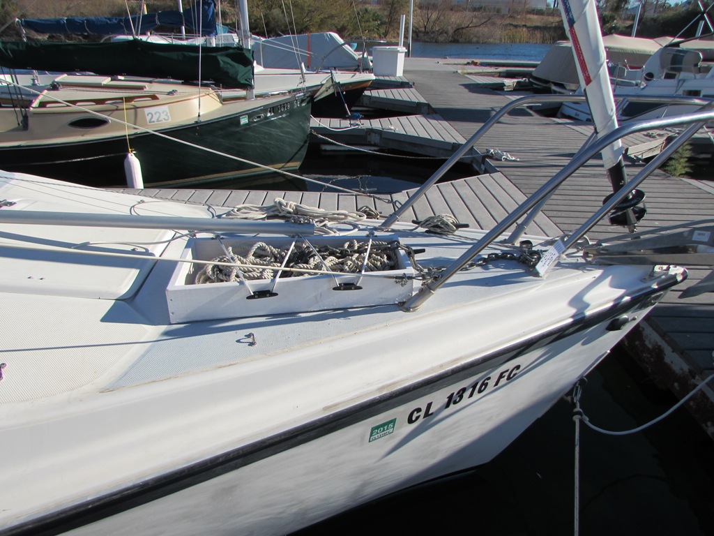

the picture below shows the new rode bucket. This is just a prototype to see how its going to work. Under the frame is a piece of Lexan plastic with holes drilled in it to drain any water. In the picture there is a bungee that is strapped over the cleats and I will add a lexan cover that is held captive to the bungee only with small ss straps.
Below - some improvement over the "laundry basket" look, lower profile. This rode box will also be easily removed and stored in the Laz. The white bucket in a few pictures back will hold the second backup rode set I keep in the Laz.

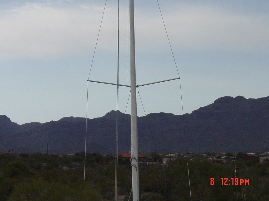

Replaced all shrouds and spreaders on Egret. Seeing that winter is dilly dallying and may not show up at all (vain hope) I decided that the weather was nice enough to do some work on our boat. Too bad I can't raise the mast because of our maple trees otherwise I would improve the lazy jack.
I have one question to anyone who owns a 26S, the manual specifies the length of the upper shroud from the mast bolt to the spreader to be 11 ft, my old shroud is 11'6", all other measurement being the same. Any suggestions? Split the difference ?
Feb 20, 2011
8,062
Any suggestions?
Without stepping the mast, you'll just be guessing about exactly where you want the spreaders. Conventionally, you want to bisect the angle produced by the shroud's intersection with the spreader tip.

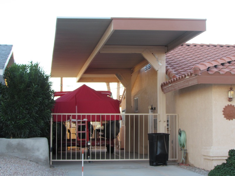

I sure do like that boat shed.. Unfortunately I dont have enough side to side room for one of those and have to deal wth a 5 foot keep out from the neighbors property for the shed support legs. The picture below is NOT my place but this is the sort of thing I will have to do. This type shed is supported on only one side and likely always custom. Sometimes these have a third leg in the back since you only need to get the boat in from the front.

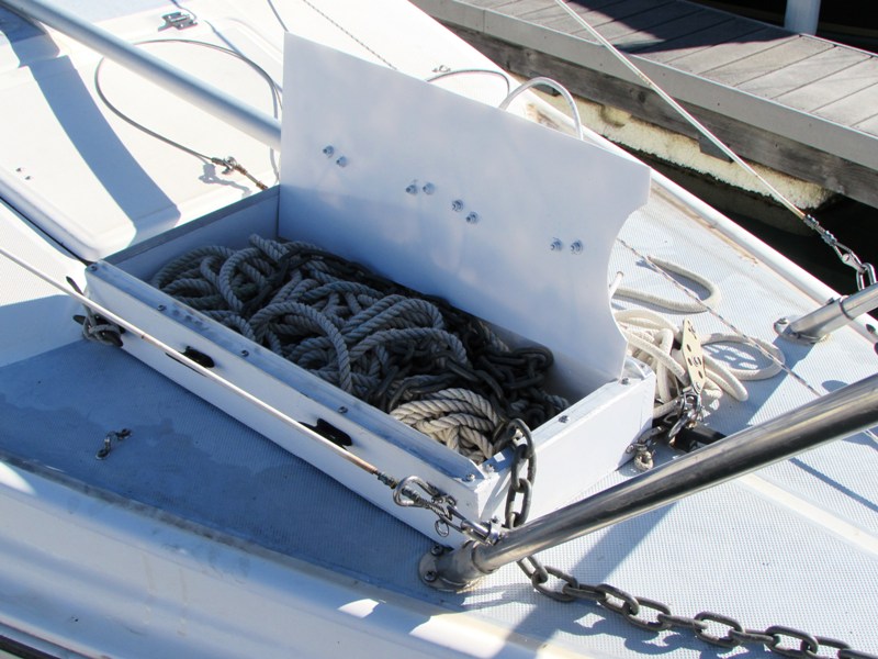

Today in Arizona trying out the new anchor rode box..

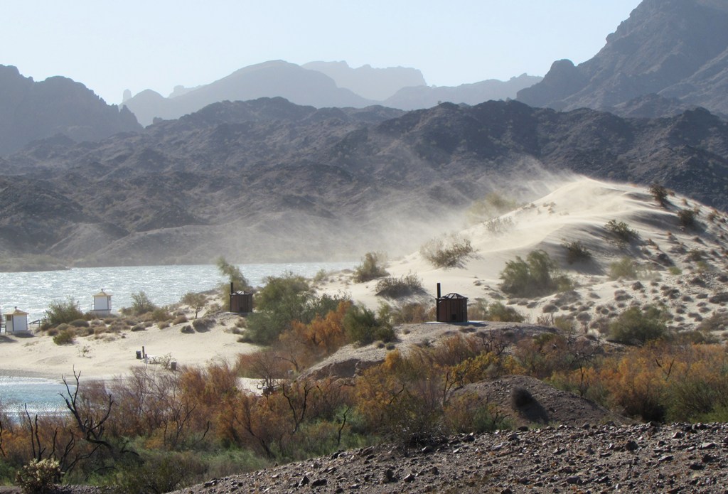

Lake Havasu today.. very windy. We didnt take the boat out but took a hike

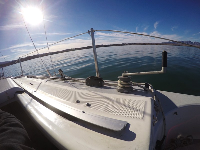

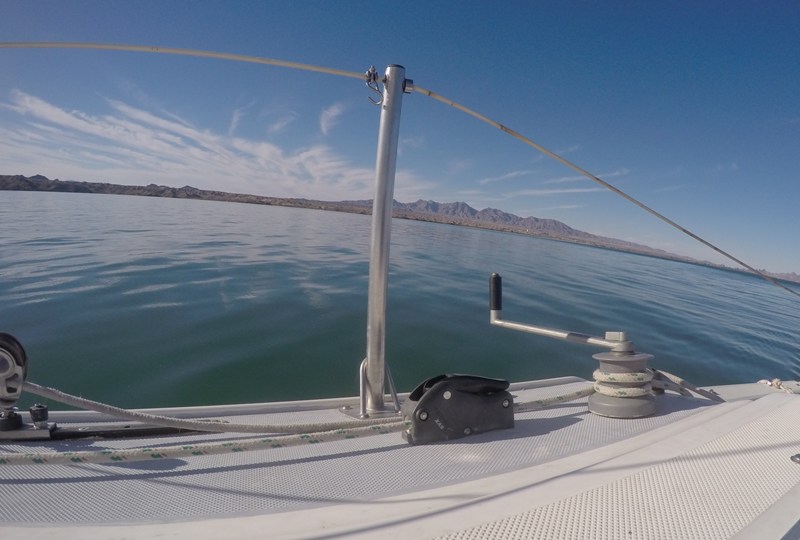

Son is visiting and we took the 26S out today. A little chilly but it ended up a really nice day sailing. I recently put a new jib/ furler on the boat that seems to be working very well. This furler has an external halyard and I just put a new Spinlock XAS power clutch for the halyard control. The "clutch" feature is nice as you can still tighten the halyard even with the clutch "closed" so it makes it easy to get whatever tension you want. Where I liked things was with the jib halyard pulled as tight as I could by hand then an extra "click" or two using the winch.
