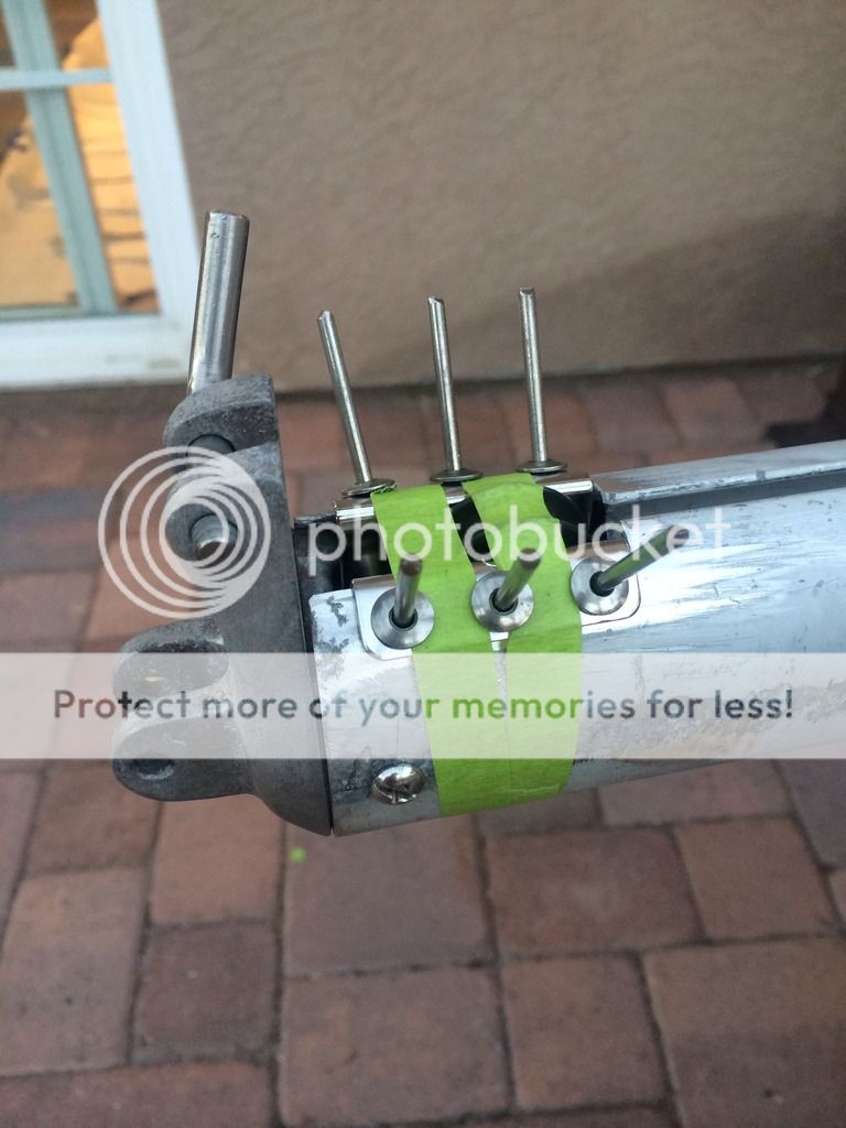

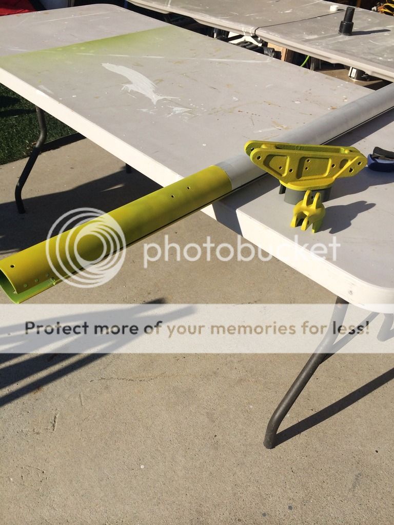

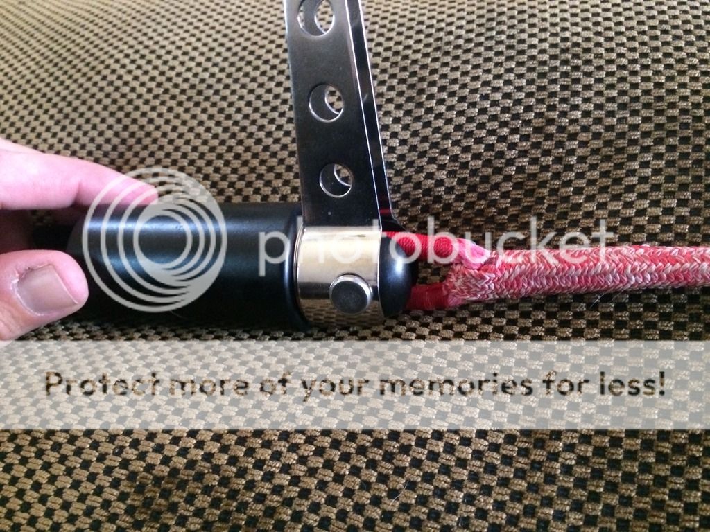

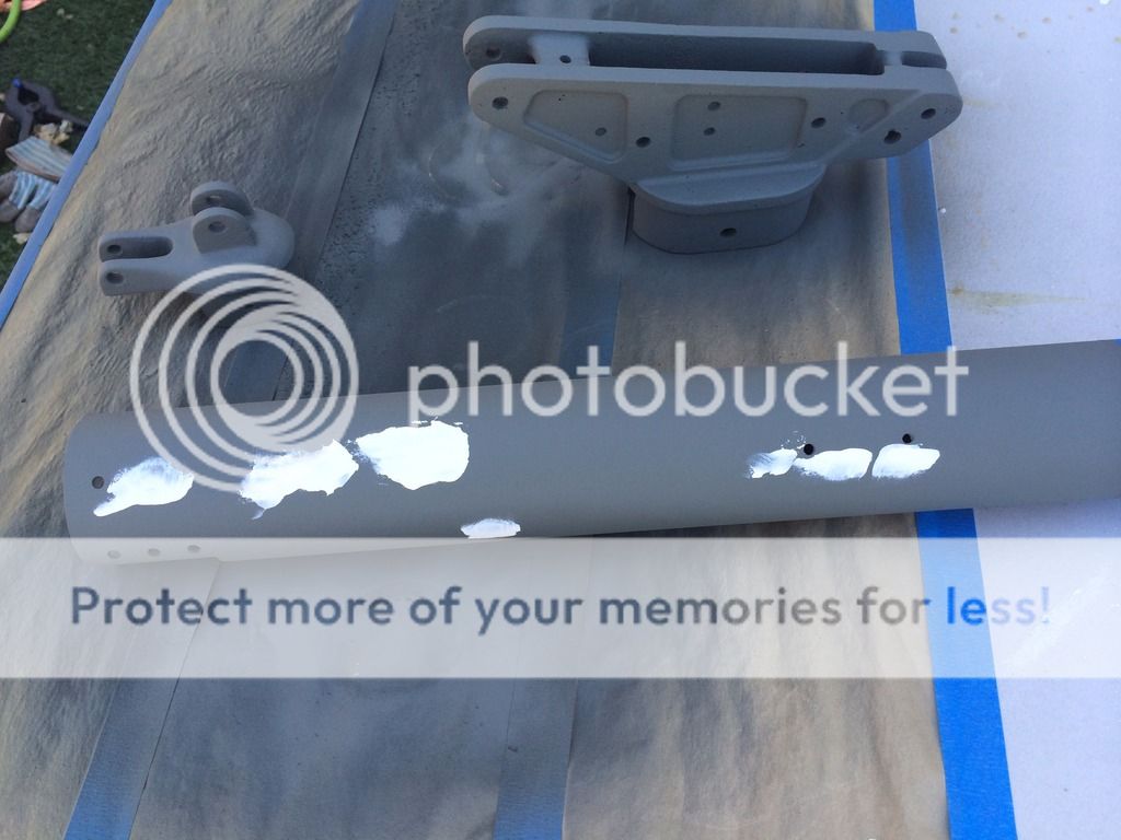

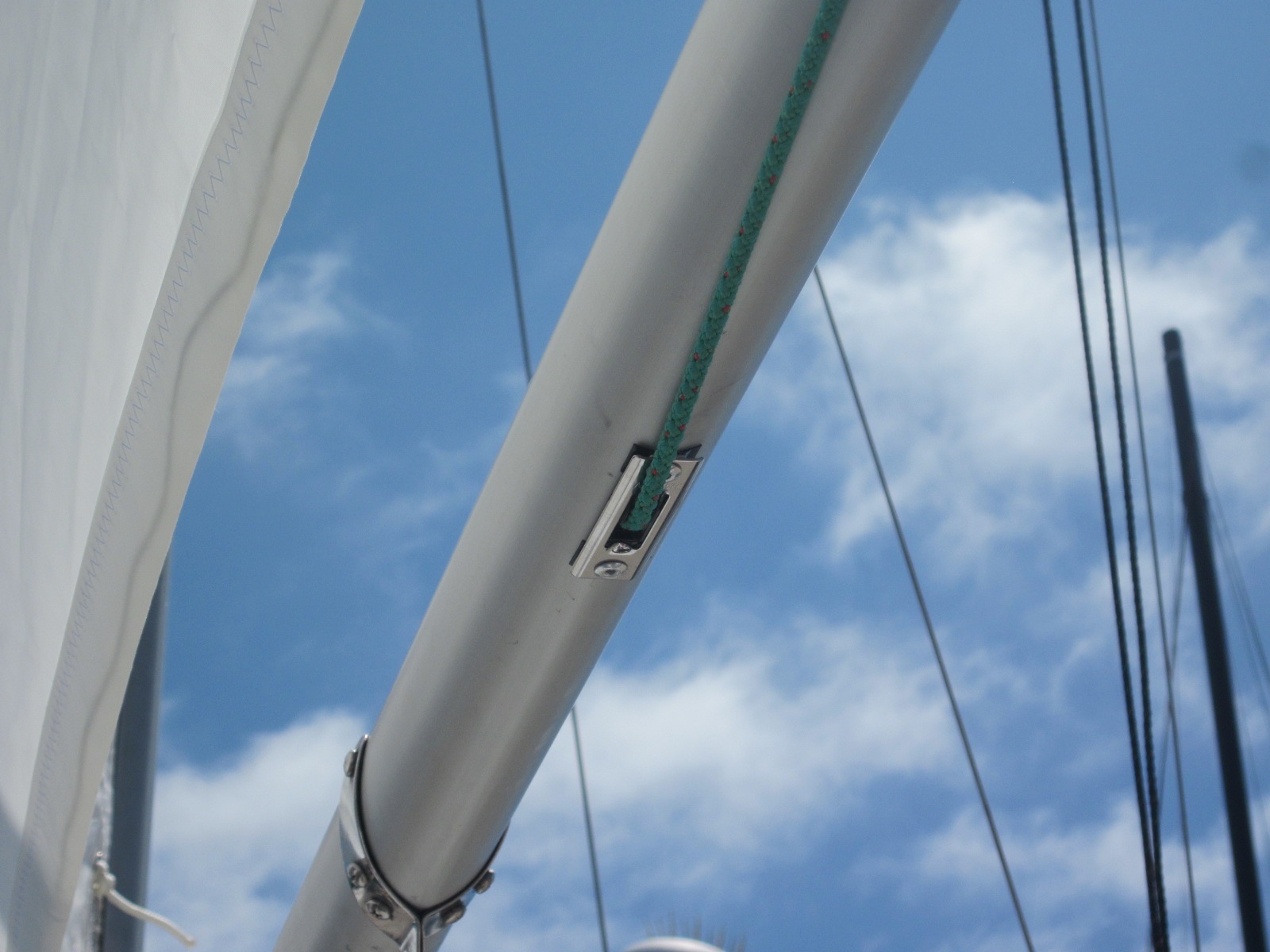

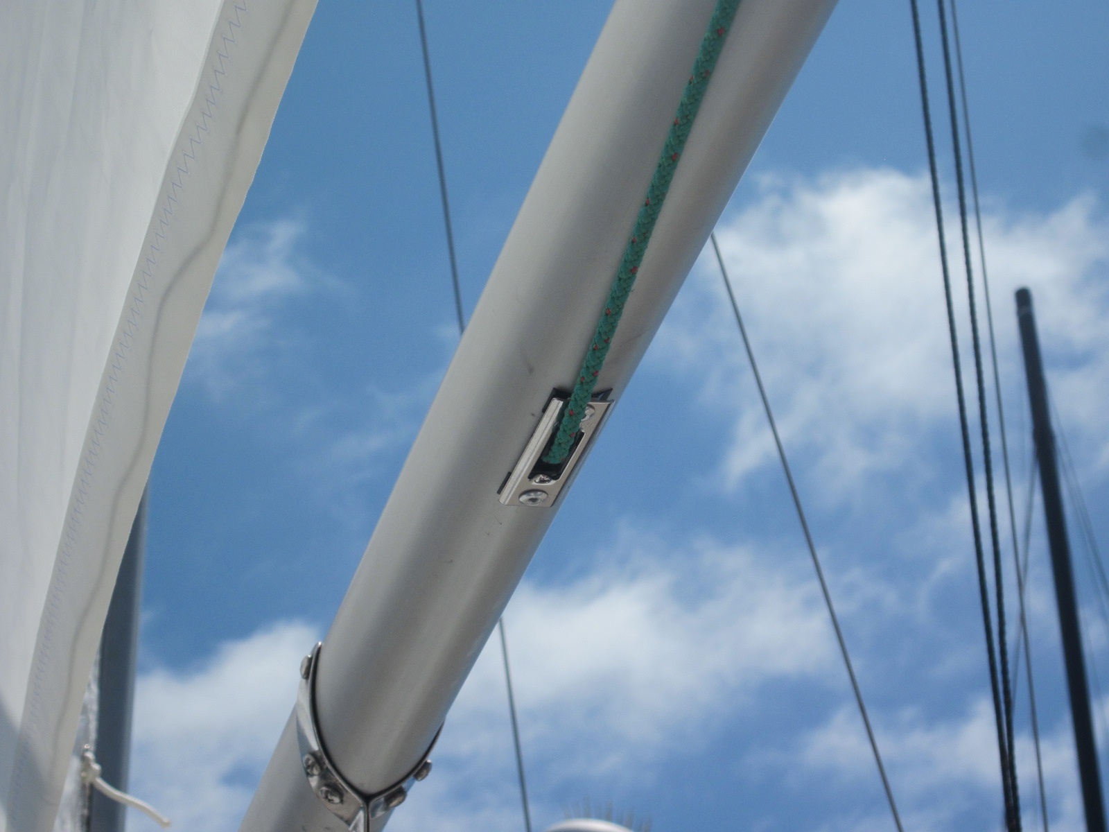

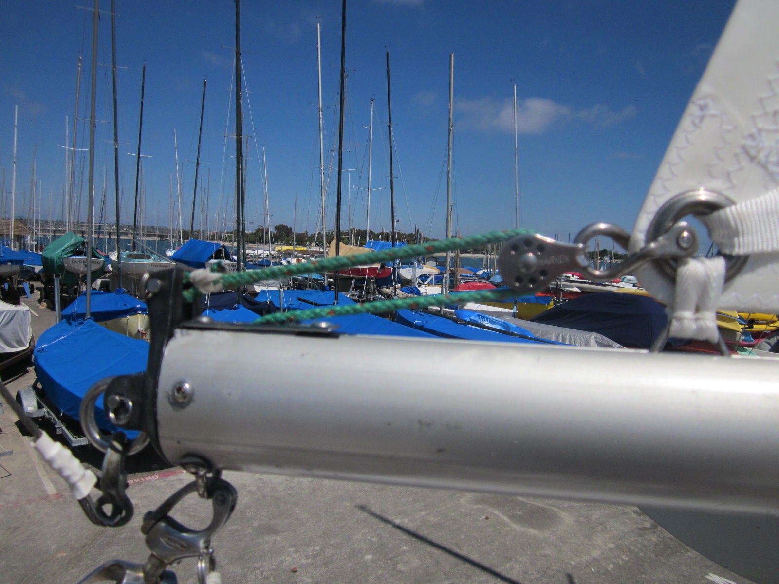

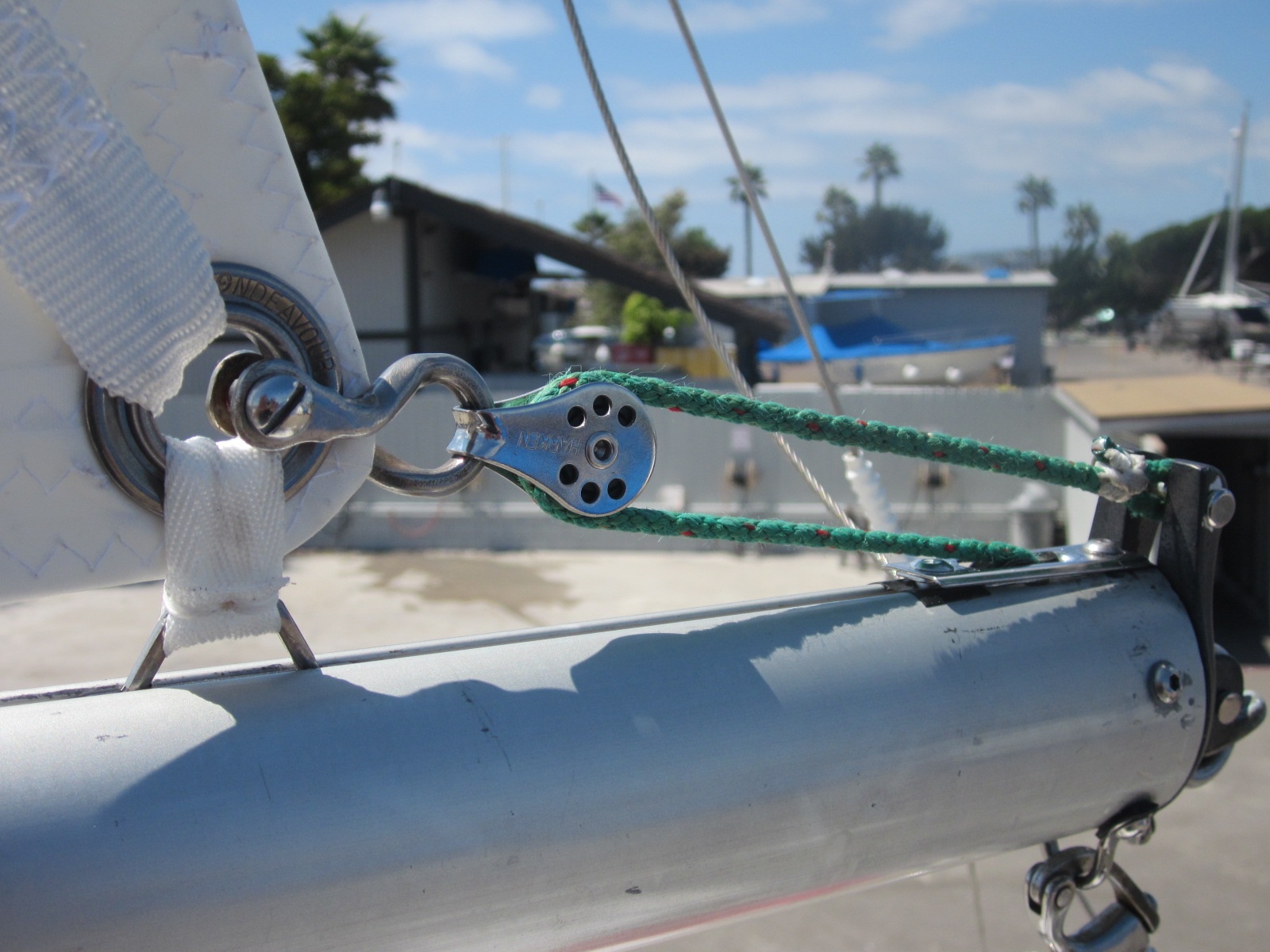

Spent some time working on my boom. The end cap had a bunch of corrosion and I had to cut if off, loosing about an inch off the booms total length. Thats not much, but I want to make sure I still have room for the outhaul to work properly. I am going to end up getting a new goose neck fitting, so the old goose neck has been repurposed as the new end cap, this gives a nice place for the eye splice of the outhaul line to mount, and removable when setting the outhaul line to the reef point. I'm using a Ronstan 31712 exit block to run the run the outhaul internally, its a much better block than the tiny one that the CD kit uses. I'll end up with another exit block on the bottom of the boom where the outhaul will exit and go to a cam or cleat, I'm pretty sure I'll have enough purchase.
